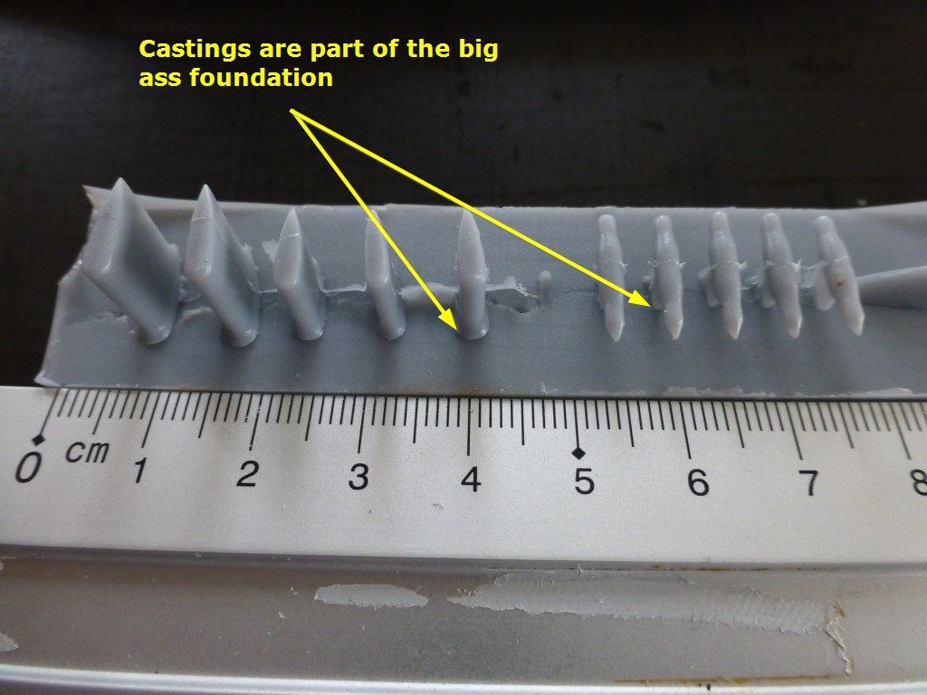

    Excellent presentation, Bart. Showing the screw-up gives perfect context to the 'improved' tool. Great photography and the call-outs makes the discussion crystal clear. Good stuff, sir (I now secure from nice-mode, and run to the kitchen to kick the cat).
    Casting
    I gave it a thought while making the molds for the small stuff, and some of you will have thought the same and were too polite to tell me (you’re getting soft HWSNBN).....IT WILL BE DIFFICULT TO REMOVE THE PARTS FROM THE BIG ASS FOUNDATION (I have been told this is the appropriate name for it).
    Well I was right about it and so were you……...............so I did the molts all over….........and now they are perfect ......…..damn I’m getting good @ this stuff.
    I made stand-off pieces for all the parts so I can snap them off from the big ass foundation easily after casting.
    The trick and exercise is to design them so they do not affect the quality of your cast……you need the part to come out perfect not with deficiencies (air bubbles, partly casted,…..).
    Below you see the difference between old and new and some overall pictures.

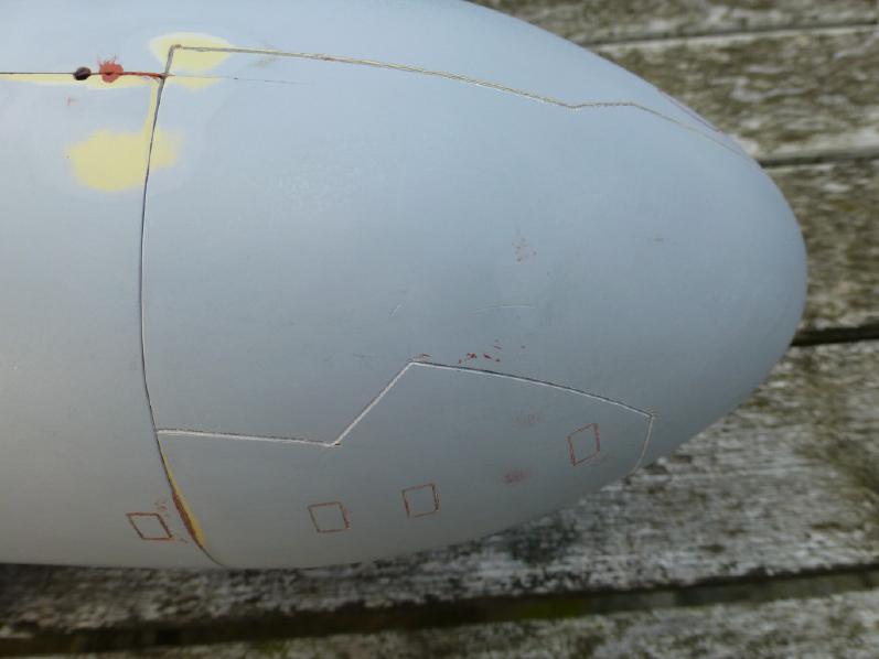

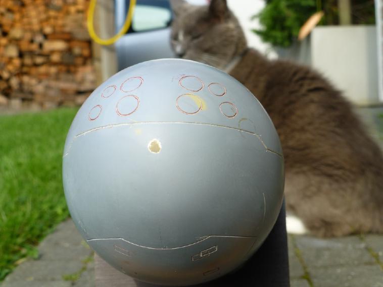

    YES scribing is all done.......left the most difficult for the last the fwd sonar dome. I spent quite some time on that thing. Needed all my skills to get the job done. Curved lines to show up as straight lines, tight radiuses on curves surfaces.
    Used tools,the stencil (most left) is made of 0.15mm brass sheet and cut with exacto knife.
Name:	Akula (712).JPG
    Work in progress
Name:	Akula (716).JPG
    Sonar dome all scribed, the seem of the lower hull is integrated in the scribing lines of the sonar dome. yes I planned it like that when I made the cut, eand I think it worked out fine.

    Red glazing putty here I come,
    Yep........I will do some more scribing today Tom,.....when all scribing is finished I go around with the red glazing putty :-)
    There is some touch up needed, but wow that is looking great.
