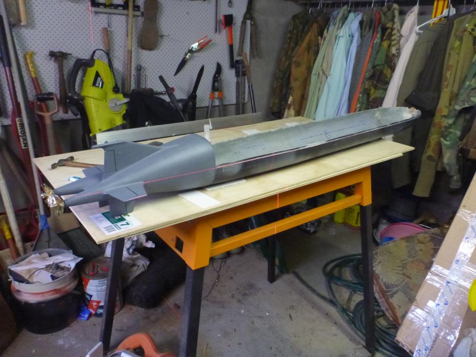

I attached the arse to the nose today - thats nautical talk for sticking the back on the front. Alignment seems OK and bits went together quite well.

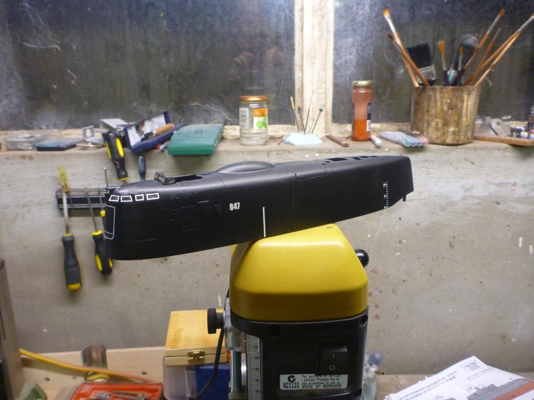

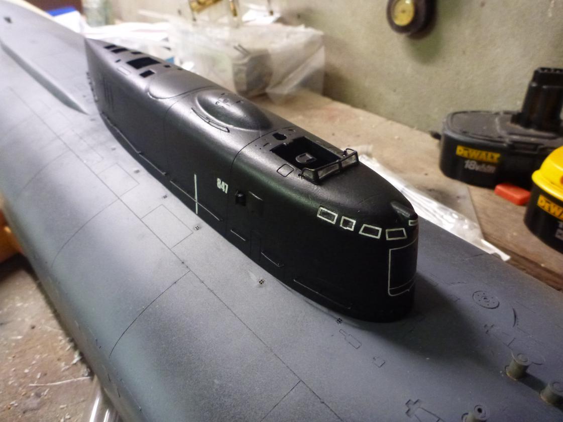

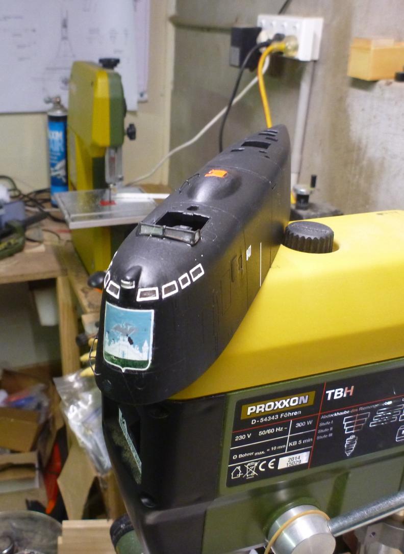

And did some work on the sail. Enjoy it now; it won't look this clean ever again!

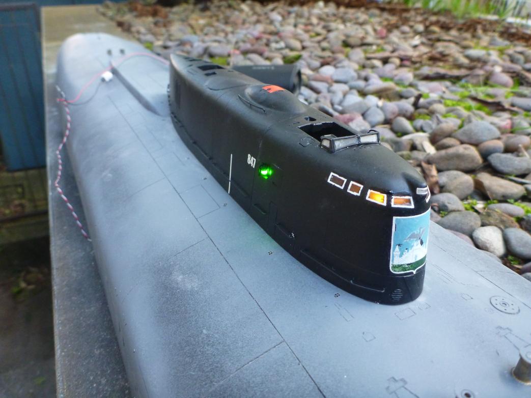

Spot the obvious mistake. For some reason the white window outlines are arranged in the wrong order on the transfer sheet. So, naturally I applied them that way without thinking, until I looked at the photograph in the post which is several times life size. Oops. So this is how its supposed to look!
Today I cut and fitted the rear flange and sorted out the power for the sail lights. In hindsight (which is clearly, the BEST sight) I should have split the lighting system so that the running lights and the anchor lights were separate. It wouldn't have been a big deal at the time but it is now, since all the wring is buried in fibreglass. Oh well,...live and learn.

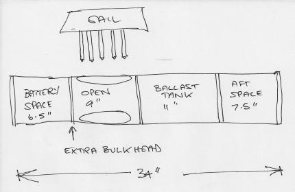

Interesting email from Caswells today. I had ordered an SD for this beastie in April. Having had some time to think about how it would all work I decided that the best solution was to ask for a slightly extended 3.5" tube and an extra bulkhead. The idea was to do this:
The syringes that operate the masts extend quite a long way down under the sail and so I wanted to have a free flood area within the tube that the syringes would sit in. The plan was to keep everything rigid within the SD. To do this I need an slightly elongated tube (34" rather than 30") and one extra bulkhead.
Didn't seems like that big of an ask but I am told that "at the moment we are not able to make special order Sub-Drivers, sorry we already have too many on back order. I might add that two of the eight on back order belong to me! Come-in International Rescue. I have wandered into a nonsense vortex. I need help, International Rescue. Over.Comment
Hardrock, If all else fails, You could make your own. Order a length of 3&1/2" tube, use the parts from a standard 3&1/2" plus Im sure Dave would come up with two extra bulkheads. Ive done three of them......its fairly quick too.IT TAKES GREAT INTELLIGENCE TO FAKE SUCH STUPIDITY!Comment
Hi Mark. HWSNBN has contacted me on the sun-bather net with a fix. I've already ordered the stuff from Caswell so at this stage I'm just looking for some intercession in getting the order (very slightly) modified.

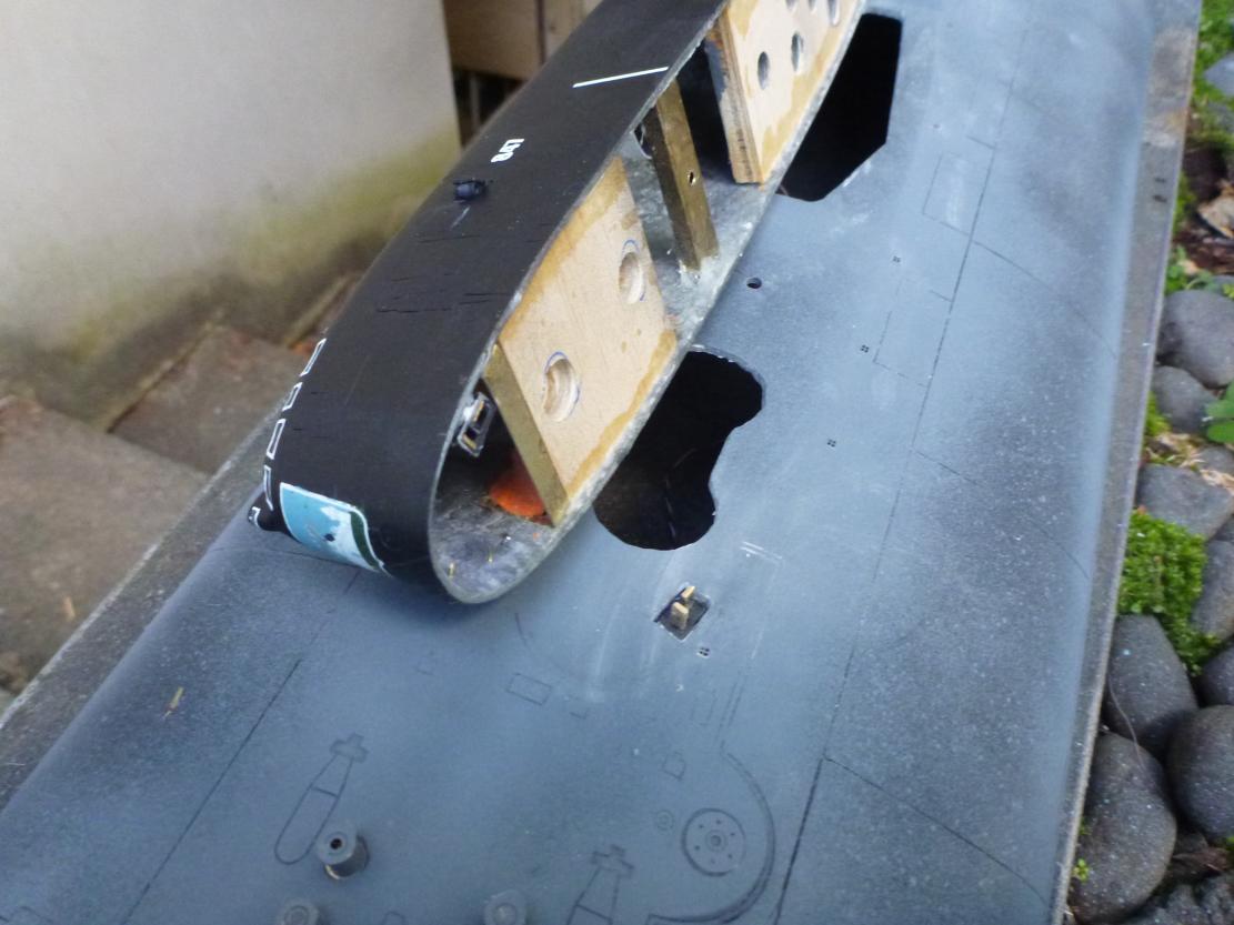

Did a trial fit of the upper and lower hull this afternoon. Not too bad. Won't fit in the Ferrari however!
