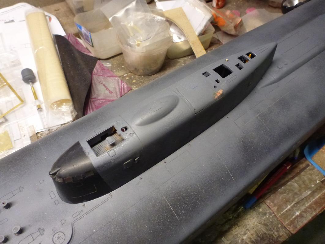

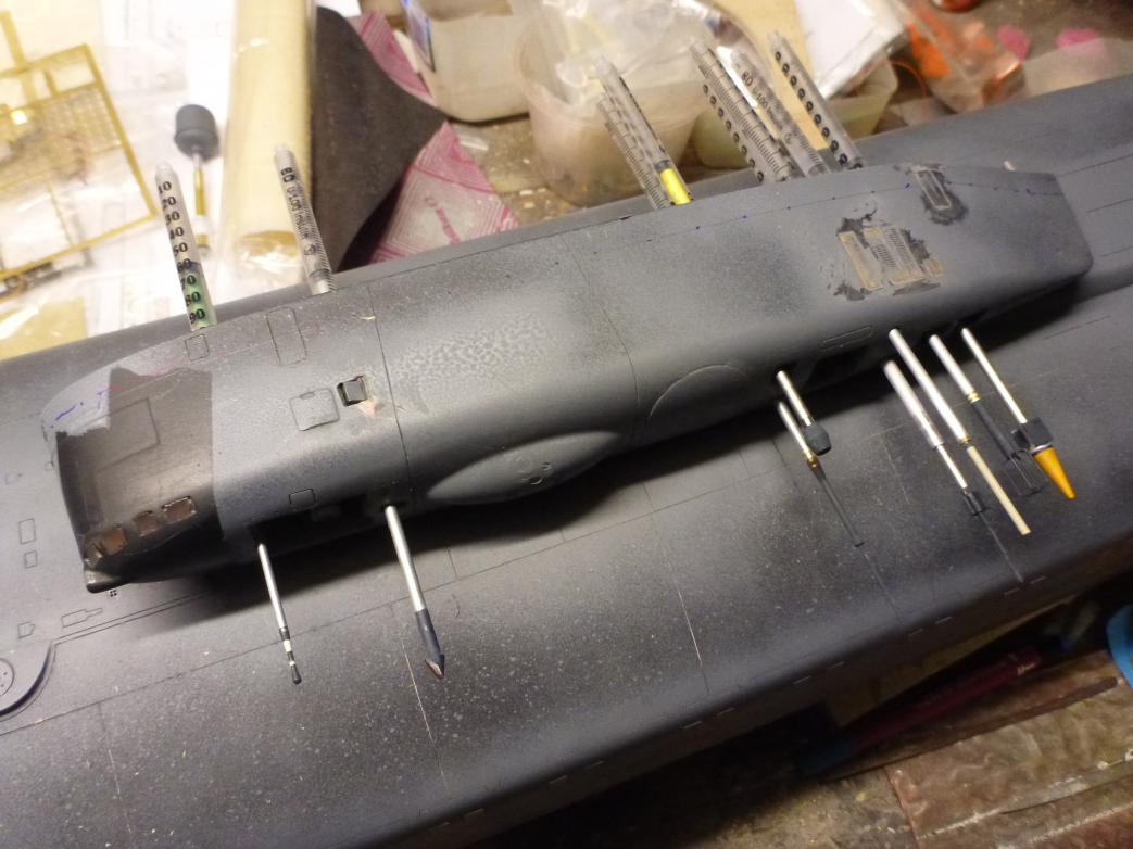

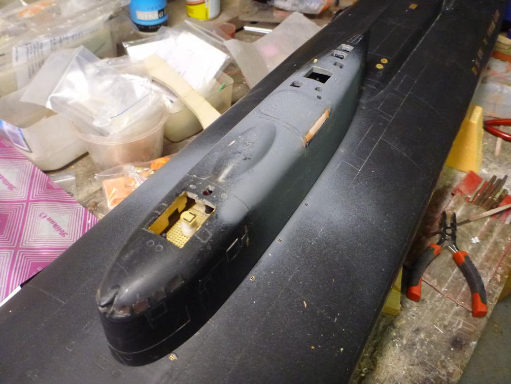

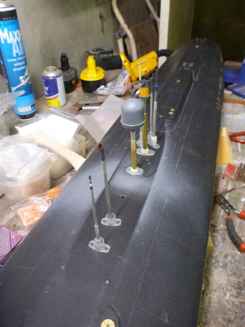

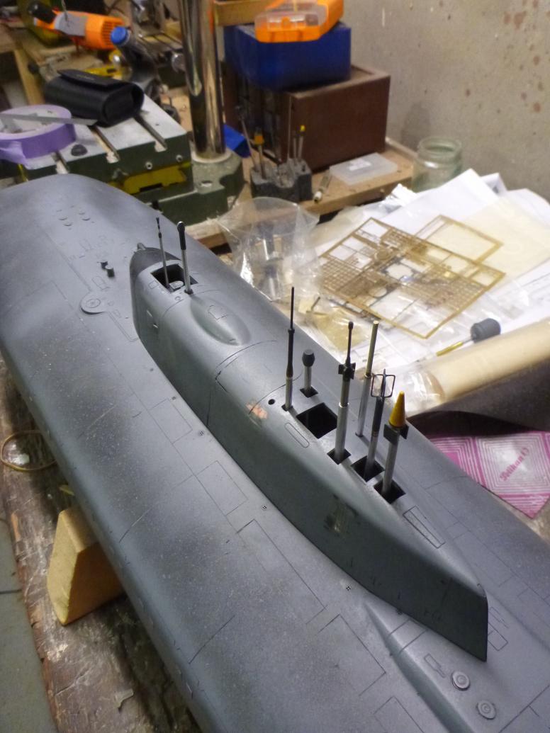

              Some work today on the masts. These are all going to be hydraulically operated via a set of pumps in the forward WTC. Click image for larger version

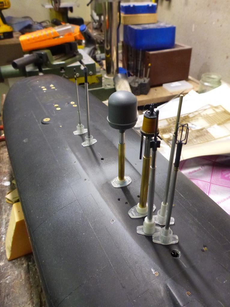

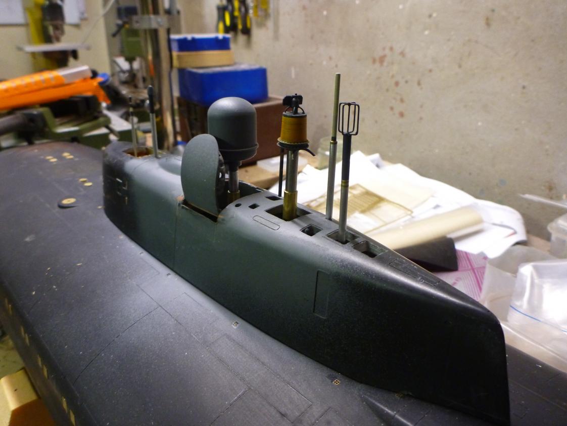

                        Some more work today on the masts. Each of the smaller (3mm) masts is mounted in an insulin syringe; the two larger, 5mm masts go into a 3.5ml syringe. Eventually the two forward masts will be couples with the torpedo doors so that the doors open when the attack periscope goes up. The other masts at the rear of the sale will be run from a common pump but they will go up and down at different rates.

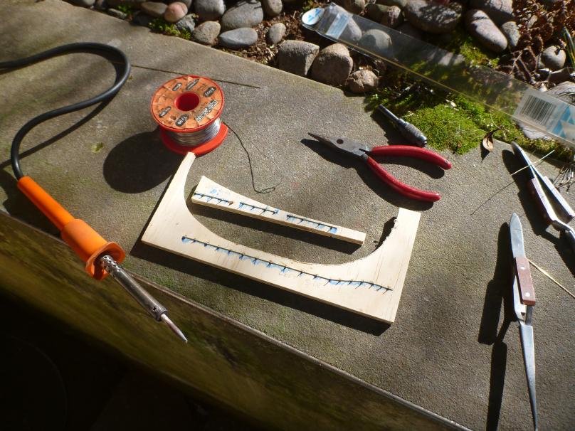

                          Making railings.

                            The dunce cap shaped mast, is it supposed to be Yellow? I left mine white for some reason, and I dont remember why. I dont see any paste flux in the picture of soldering rails. As you are probably aware, flux will make it flow and whet in better.
                                Yellow in several the photographs that I have. Here's one: Click image for larger version
                                I'm using a liquid flux - thats what made the blue marker pen run. It wasn't hugely successful. Paste might be a better idea. Thanks.
