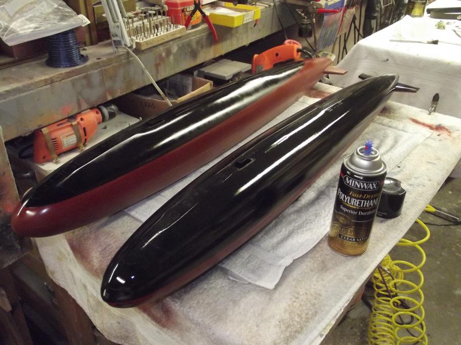

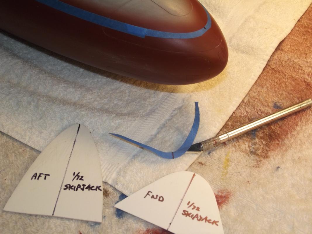

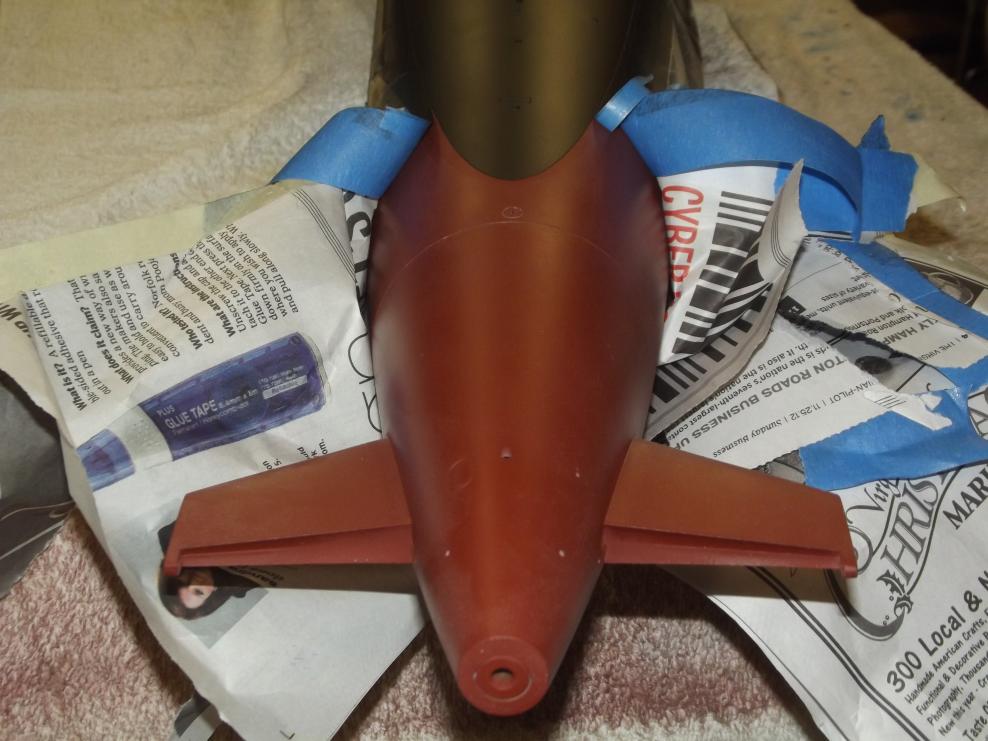

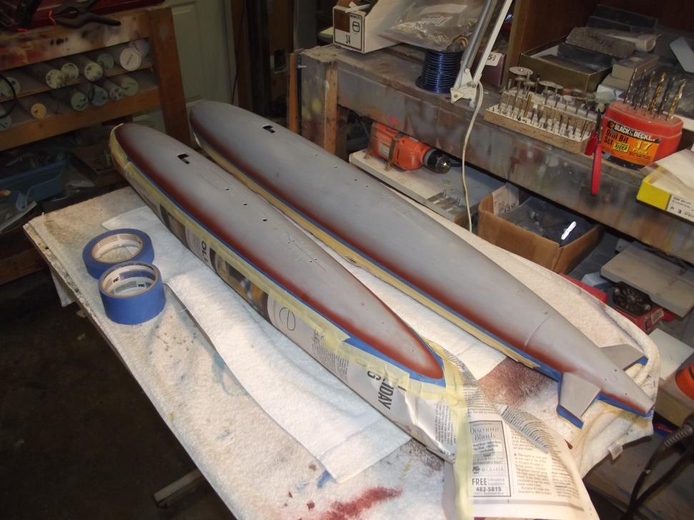

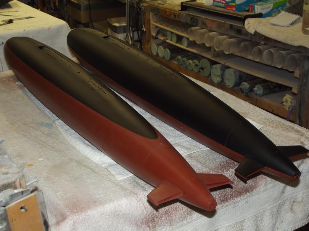

                                #90

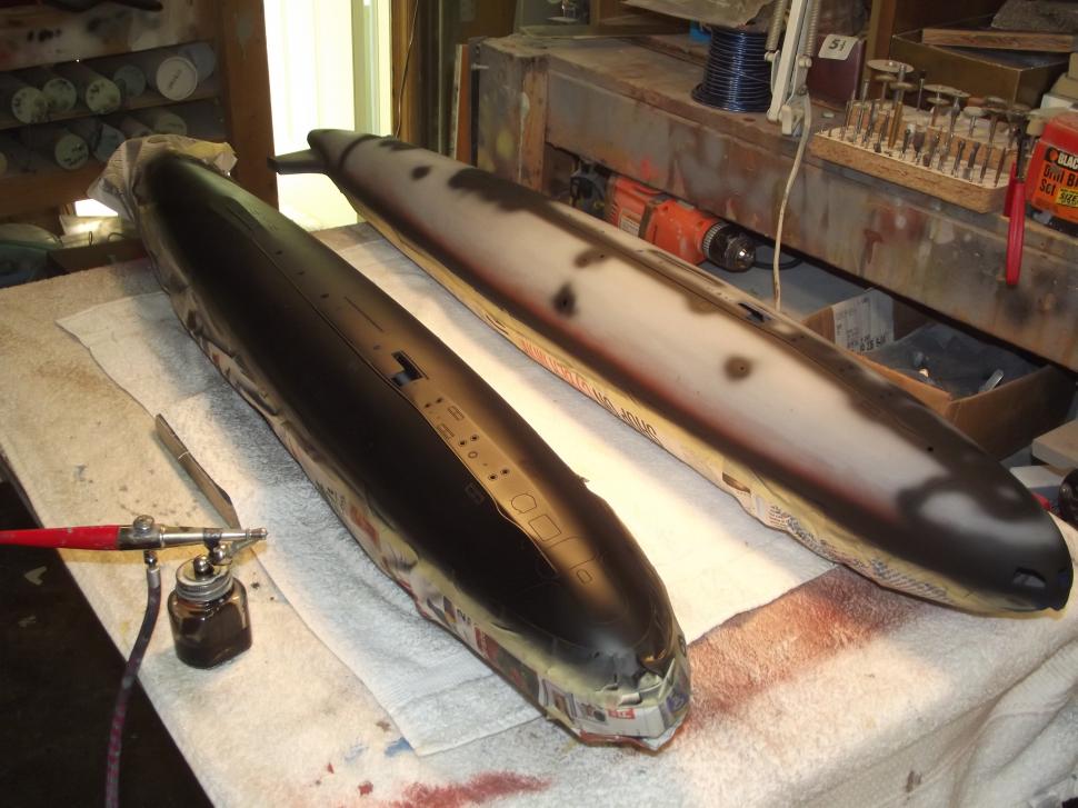

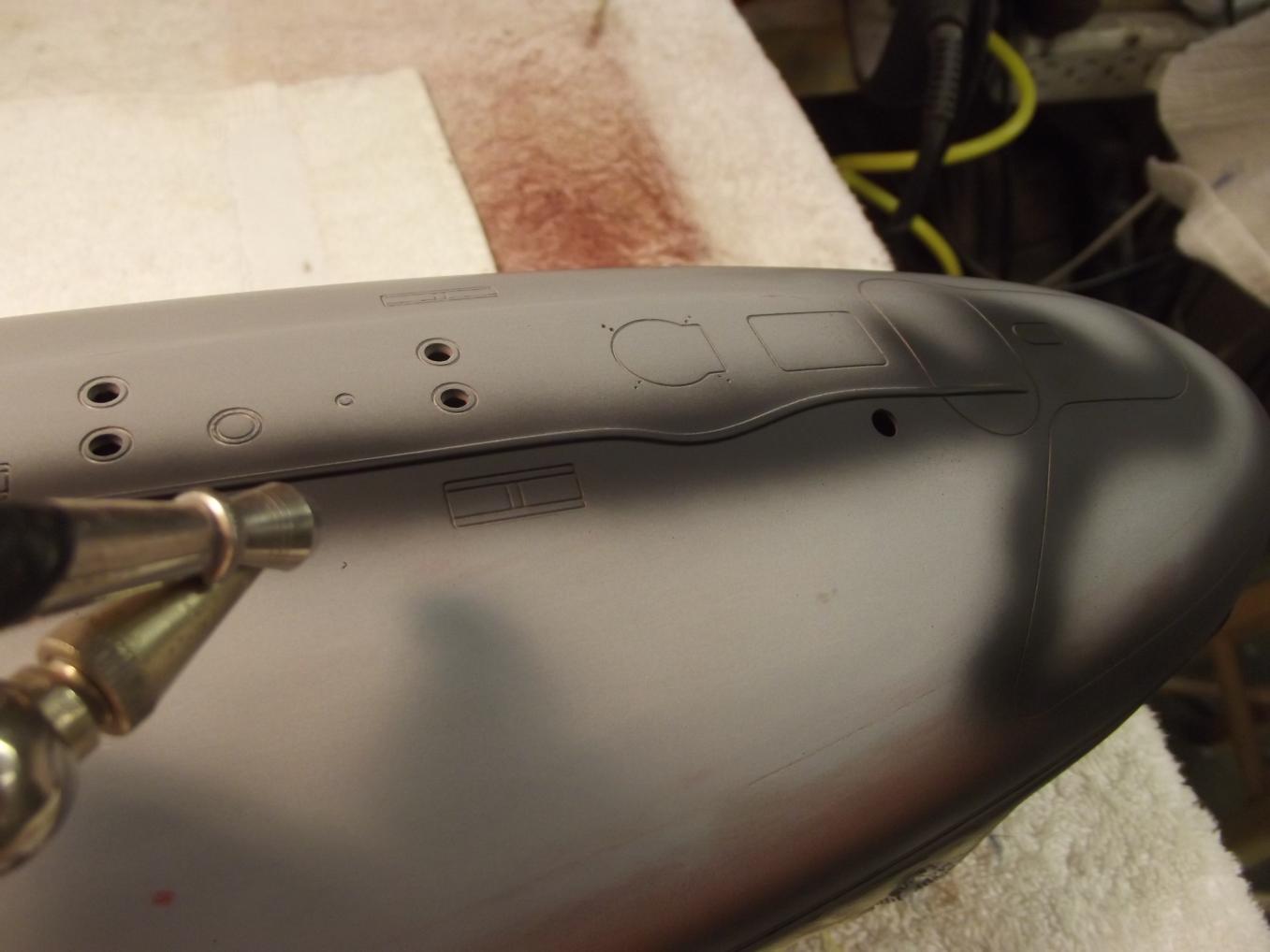

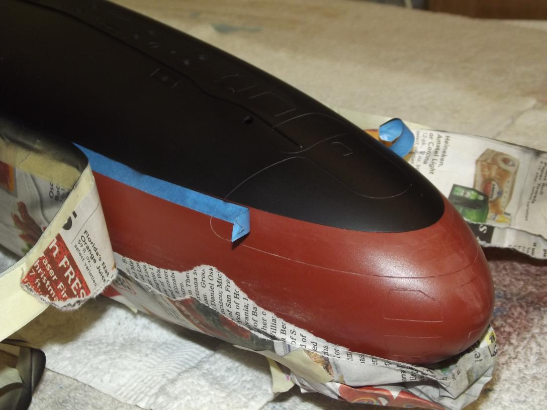

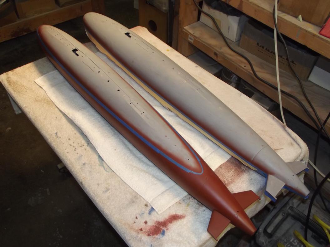

                                Some painting pointers for you guys. I'm showing off both the pre-deployment and operational red-black demarcation lines on the hull.
                                Note the use of big-box store paints and clear-coat. The trick is decanting the paint from the rattle can without painting yourself from head to toe!
