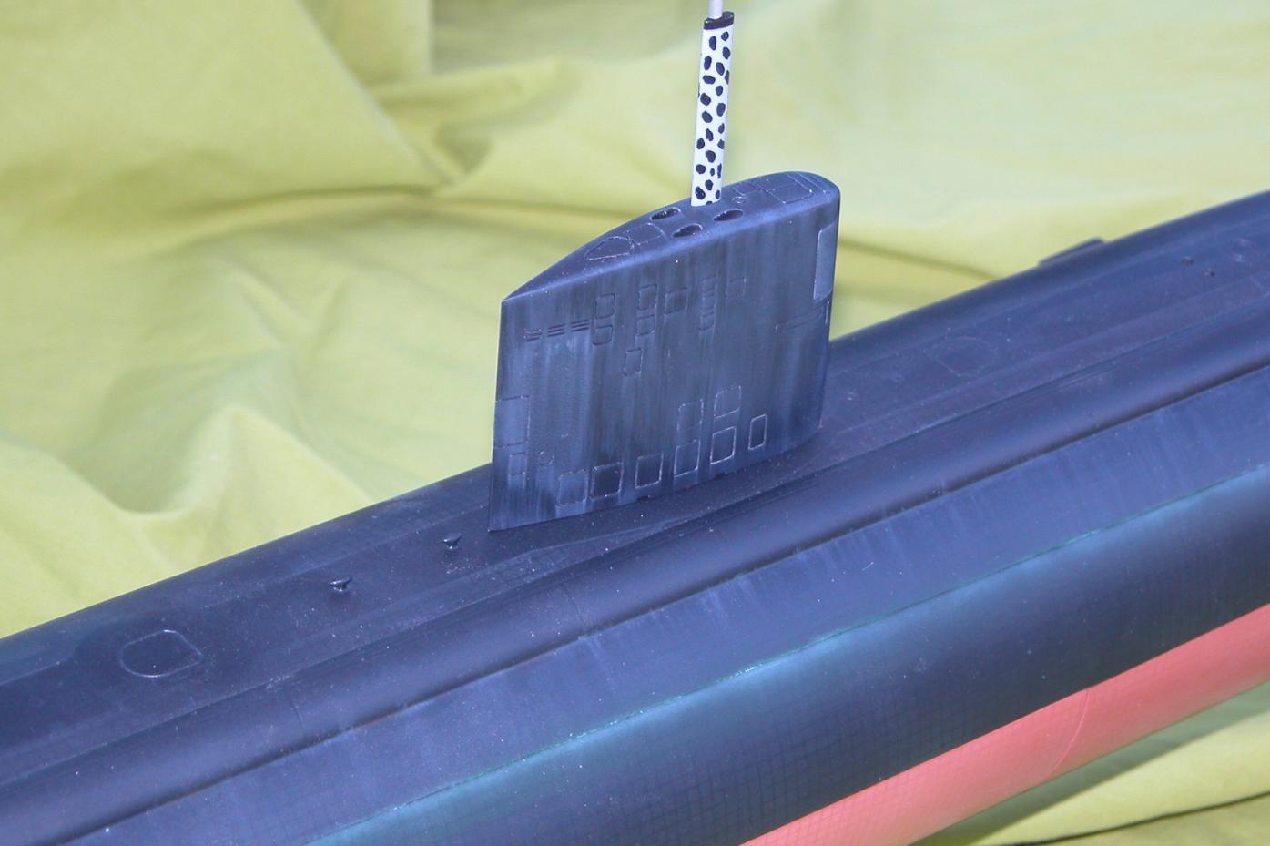

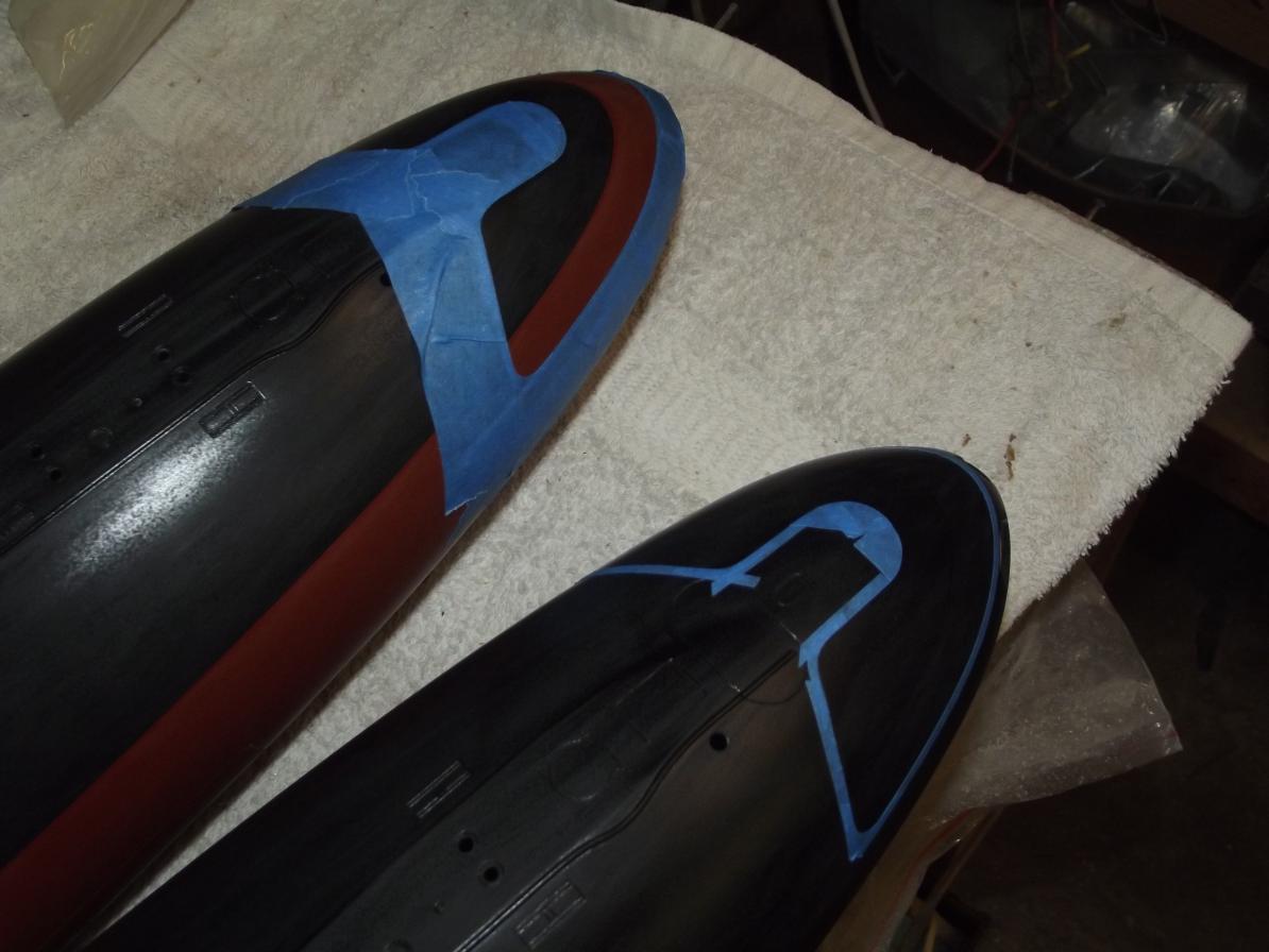

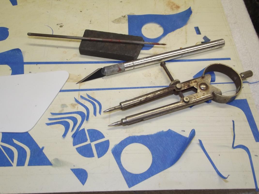

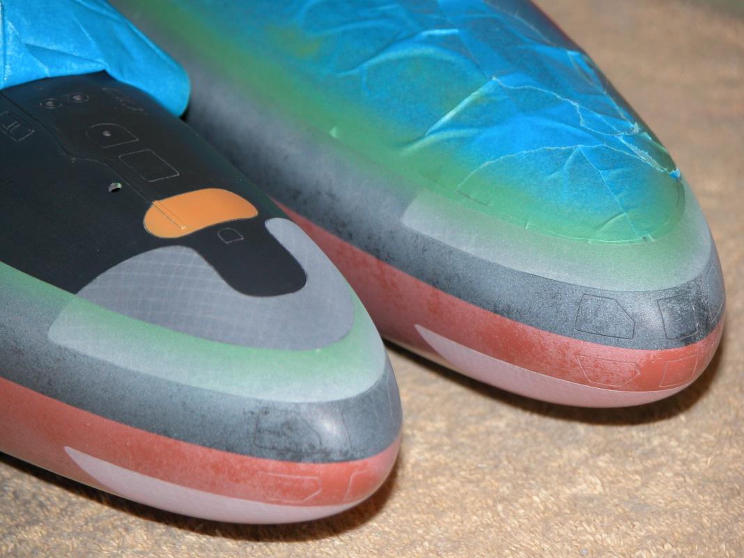

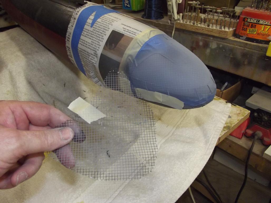

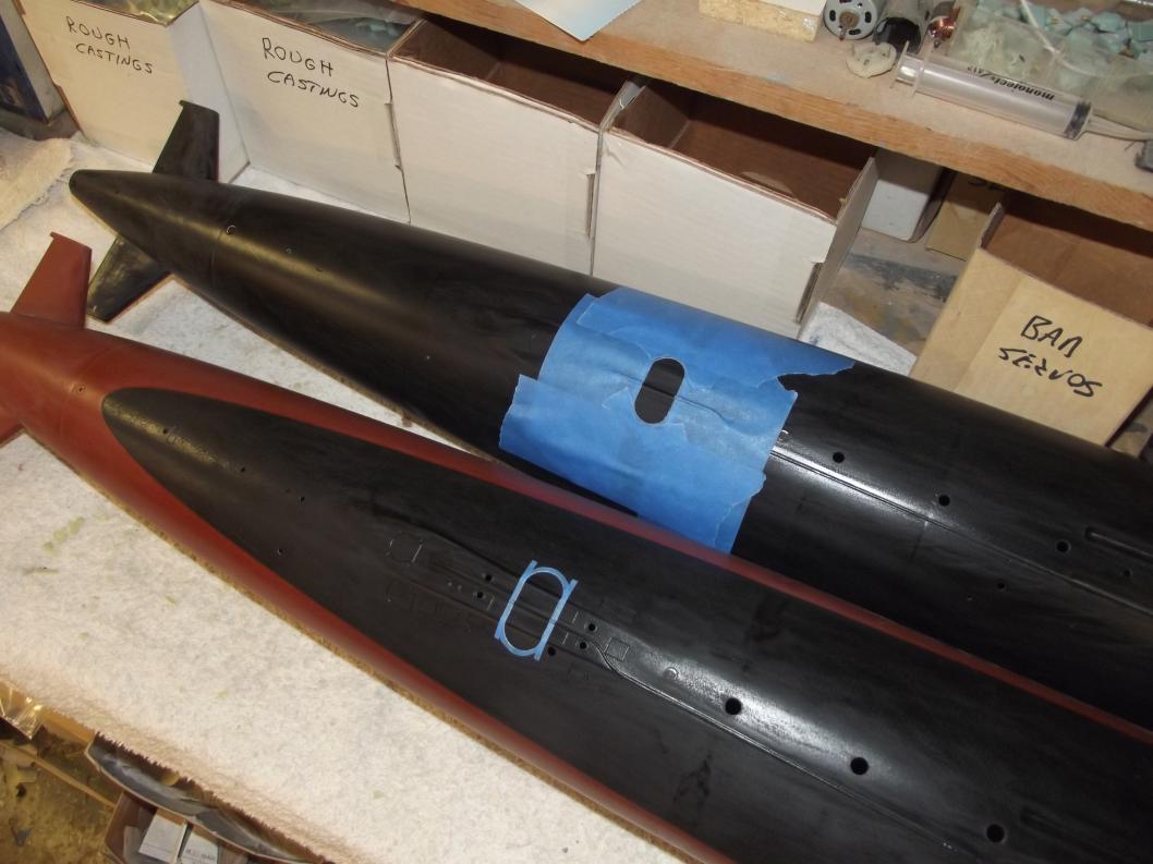

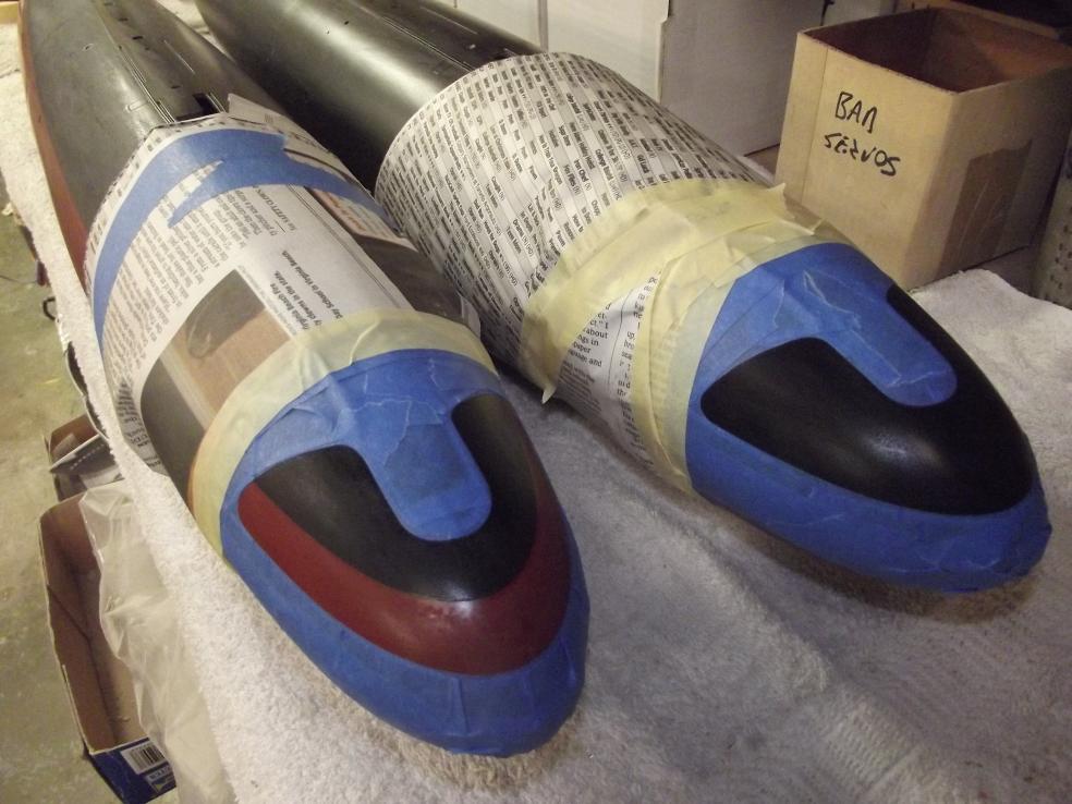

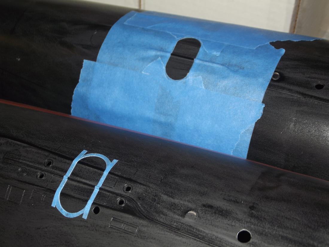

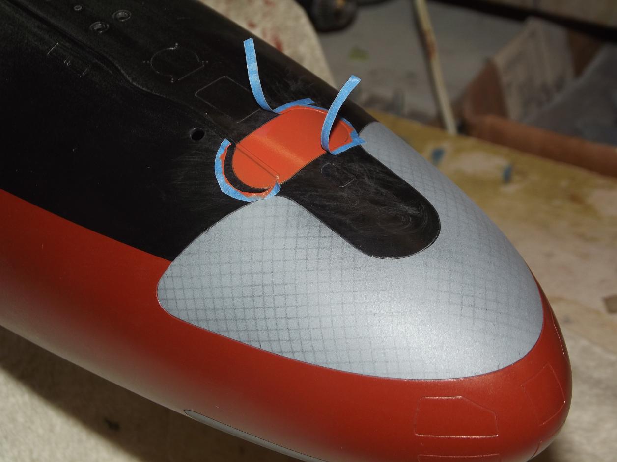

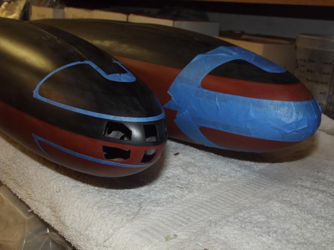

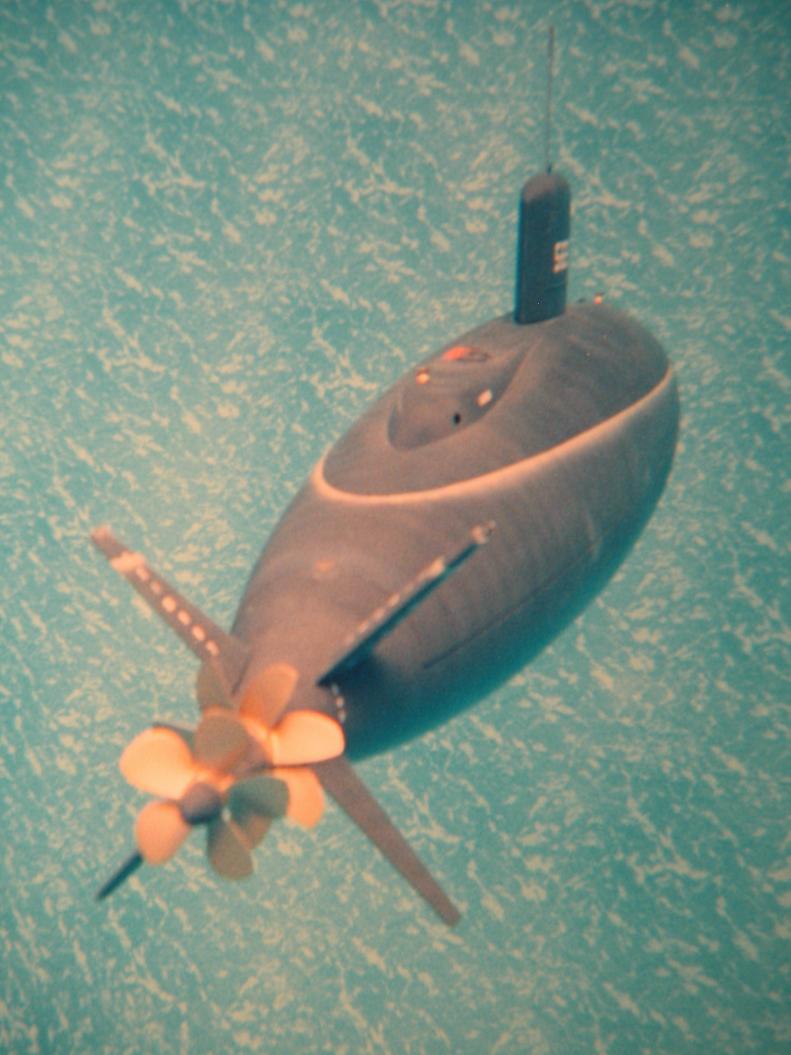

        Todays work to make the 1/72 SKIPJACK's pretty:
ID:	81686Click image for larger version
ID:	81687Click image for larger version
ID:	81688Click image for larger version
ID:	81689Click image for larger version
ID:	81690Click image for larger version
ID:	81691Click image for larger version
ID:	81692Click image for larger version
ID:	81693Click image for larger version
ID:	81694Click image for larger version
ID:	81695Click image for larger version

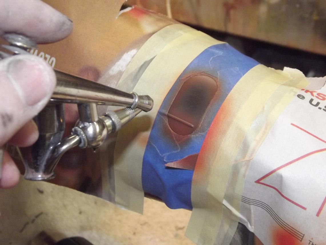

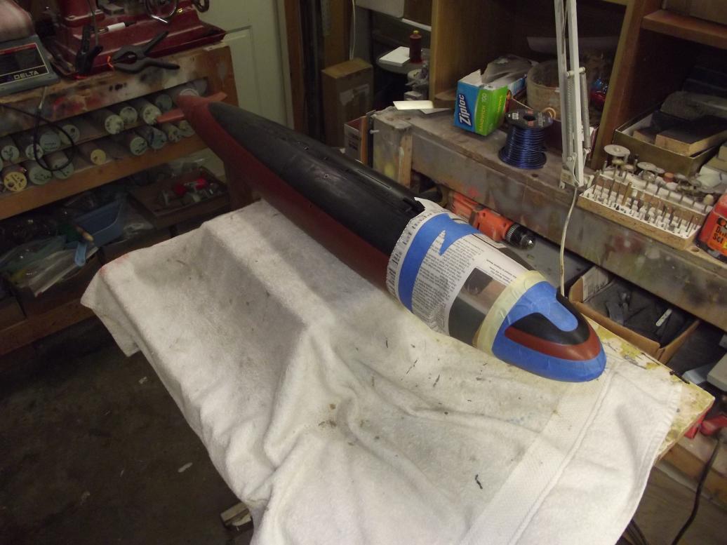

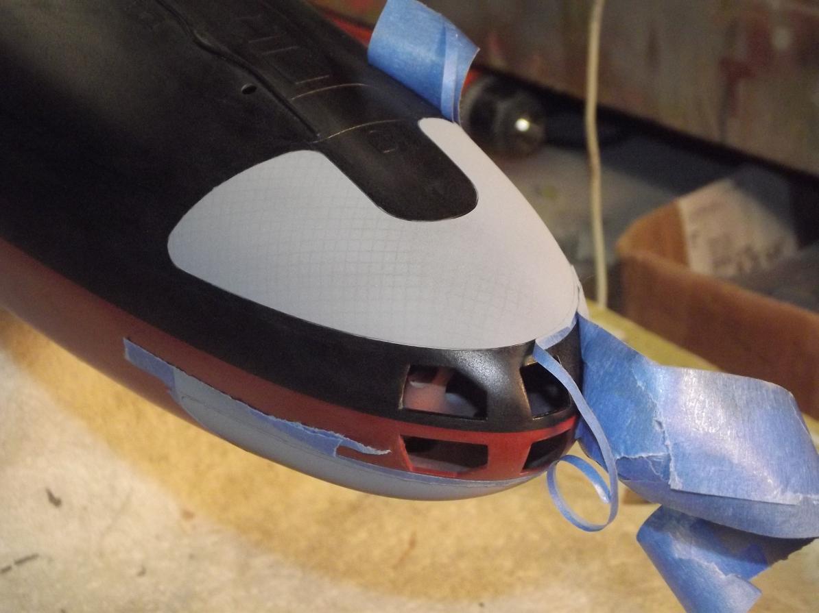

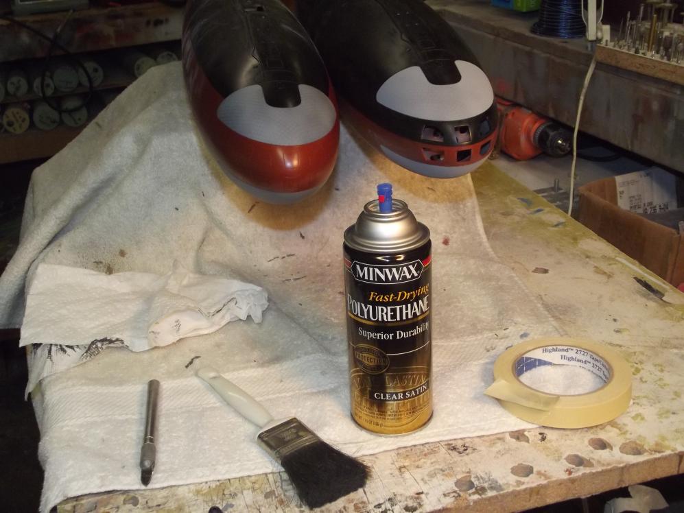

          Today's work on painting these beasts. Custom mix to produce 'international orange'.
ID:	81704Click image for larger version
ID:	81705Click image for larger version
ID:	81706Click image for larger version
ID:	81707Click image for larger version
ID:	81708Click image for larger version

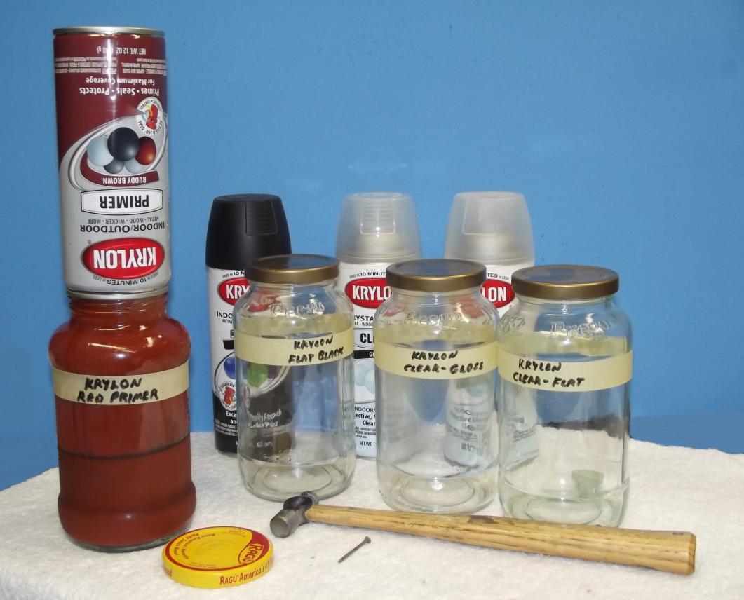

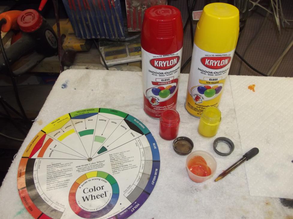

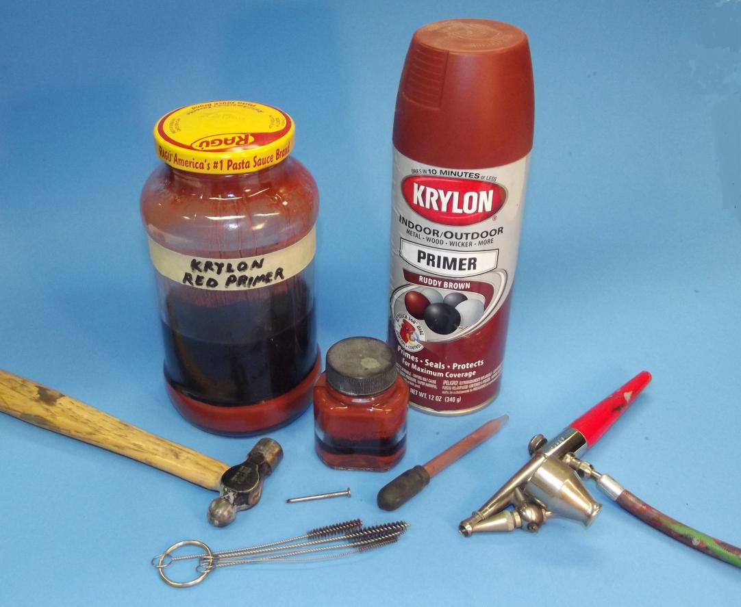

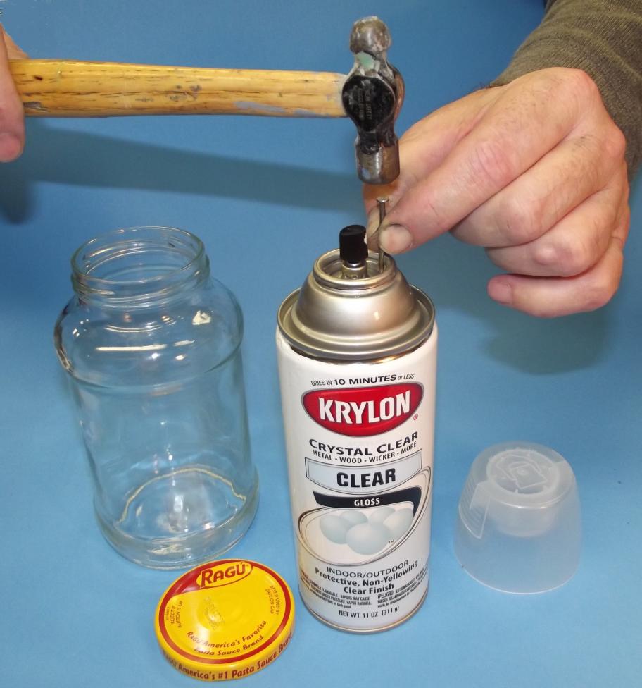

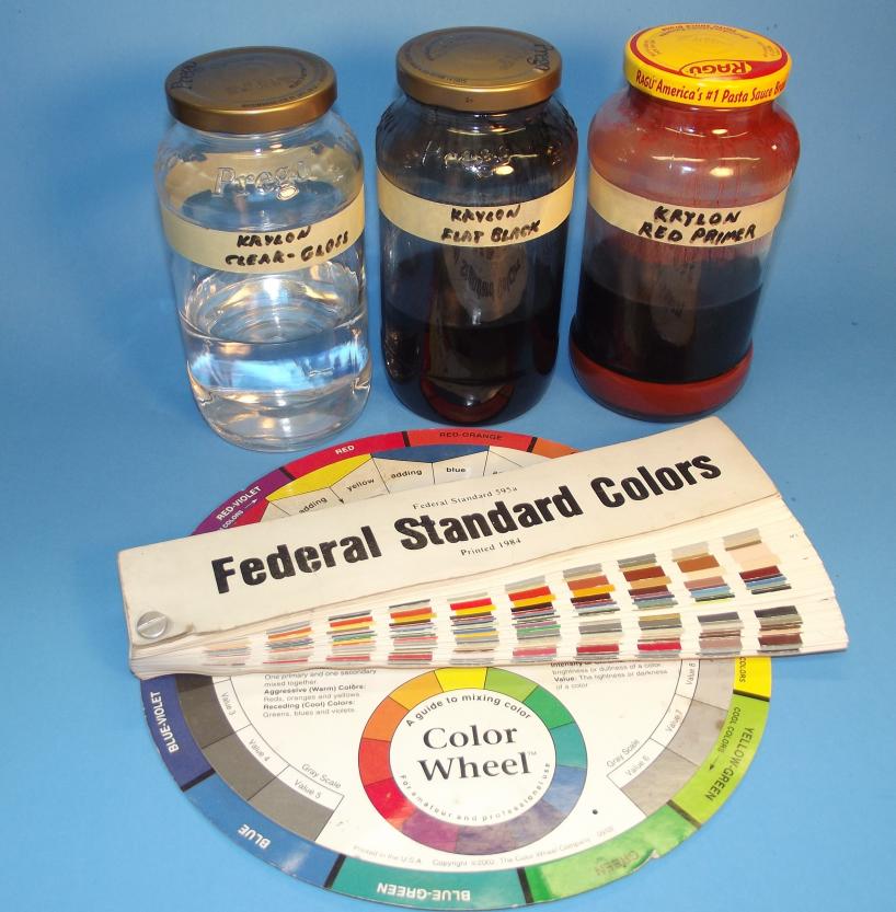

            I'm interested in the technique you employ for harvesting rattle spray can's paint? Most of the sprays I have used here seem to be so quick drying that they don't lend themselves to filling up separate vials of paint without some degree of "lumpy paint". I have tried thinners but still find problems. I notice your Krylon brand paints too "dry in 10 minutes".
            So is there a knack to this?
            Thanks
            J
            sigpic
              • 13994
              #96

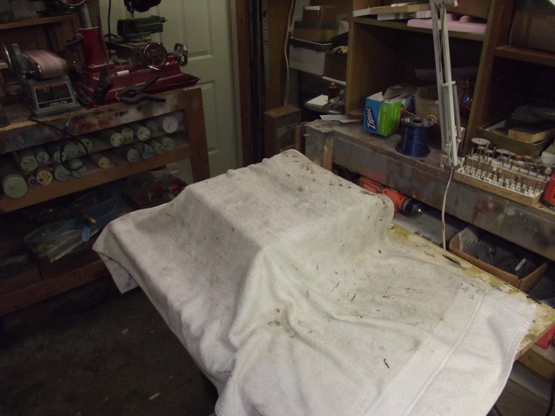

              John,
              I find that once decanted, the Krylon paint will keep for a substantial amount of time in the glass jars I use to store the decanted paint.
              here's how:

                #97
                A picture may be worth a thousand words - but not this time.
                So you take a nail and puncture the top of the spray can and then you do...what? How does the paint not come shooting out of the nail hole? - or maybe that's the whole idea?
                Or...
                If you do it very carefully and make the smallest of holes, the propellant bleeds off but the paint stays in the bottom of the can and then you take off the top of the can and pour the paint off. Is that it?
                Please, more words.

                    • 13994
                    #99
                    Only reason I've gone the Krylon route, Joel, is that I'm doing a tutorial and have to present techniques and consumables that are within the reach of the average-Joe. I use the professional coating systems, but it's too much to expect a hobbyist to do the same. Hece the discussion on box-store rattle-can paints.
                    OK, Roedj, what you do (and do this outside, away from the house and cars ... guess why!?), is sharpen the tip of the nail, and tap it with very, very slight blows of the hammer -- the idea is to punch a very small hole atop the spray-paint can. When you pull out the nail, listen for a slight hiss. Invert the glass container you are decanting the paint into, and place it atop the spray-paint can and quickly invert the container and spray-can, as a unit. The paint squirts into the container. leave things alone till the paint is transferred and the spray-can stops hissing. Put the cap on the glass container, but unseat the lid so the propellant still in solution has a chance to bubble out of the paint and to atmosphere through the unseated container lid.
                        Thanks David - this where I believe I have stuffed up previously. I sealed the container with sufficient propellant left in the mix. - The result has to be a contributor to the slaggy lumpy paint I find when I open the jar a week or so later. Either that or its ****ty paint. Thanks

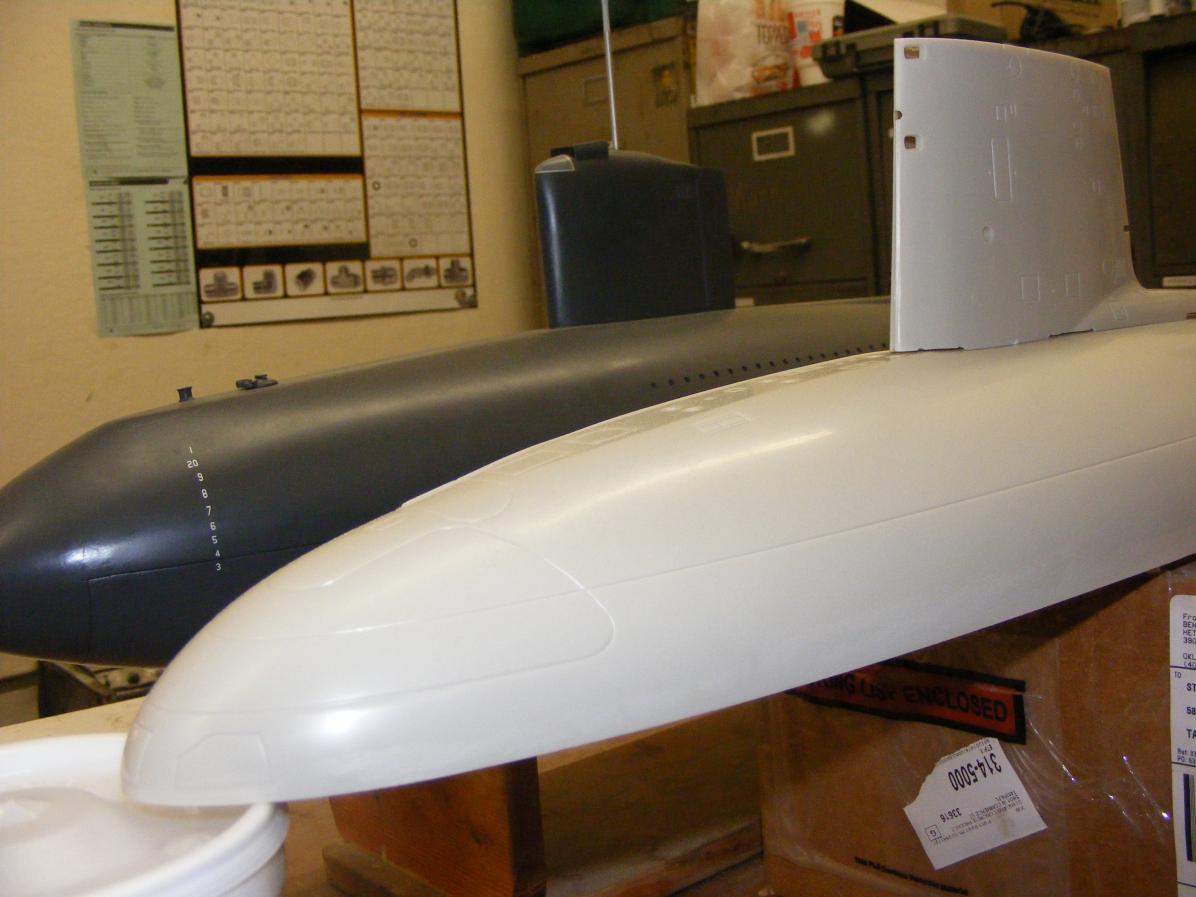

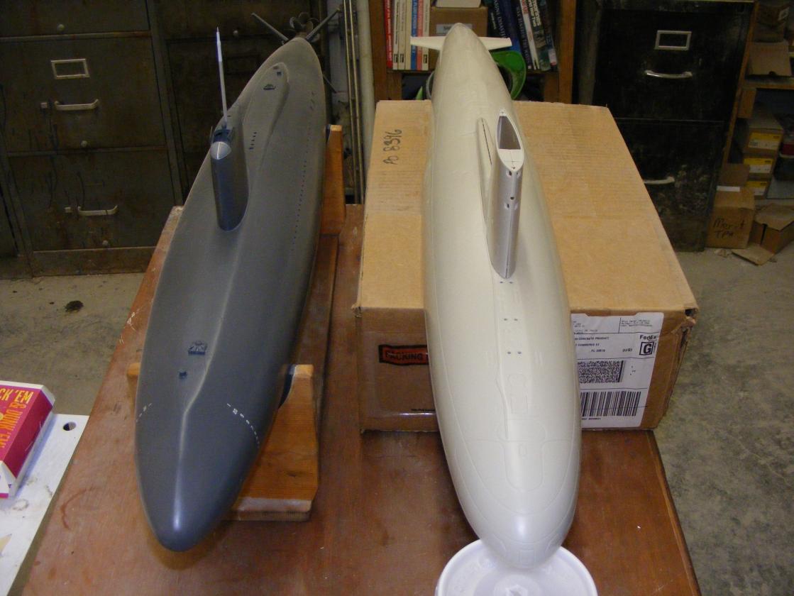

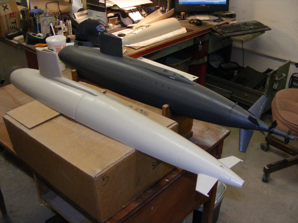

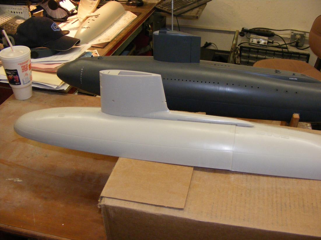

                                I took these series of pictures the other day to show the relative size of the 1/72 Skipjack and the 1/60th Albacore. You might not be able to tell but the length of the hull only of the Skipjack is the same length as the complete overall length of the Albacore including both propellers. Also the Skipjacks sail is much bigger.
