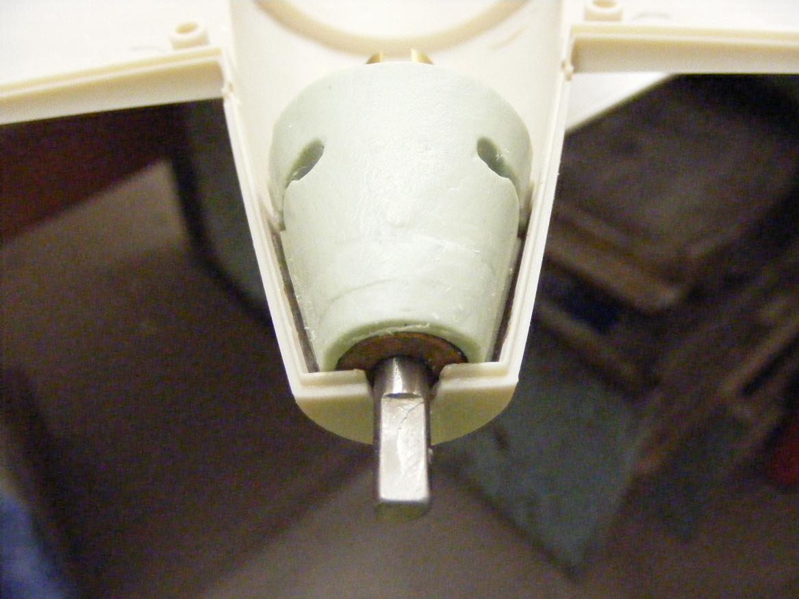

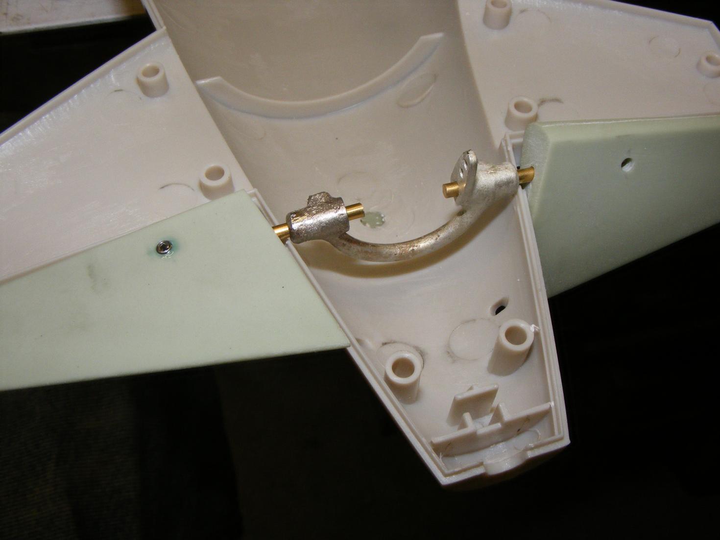

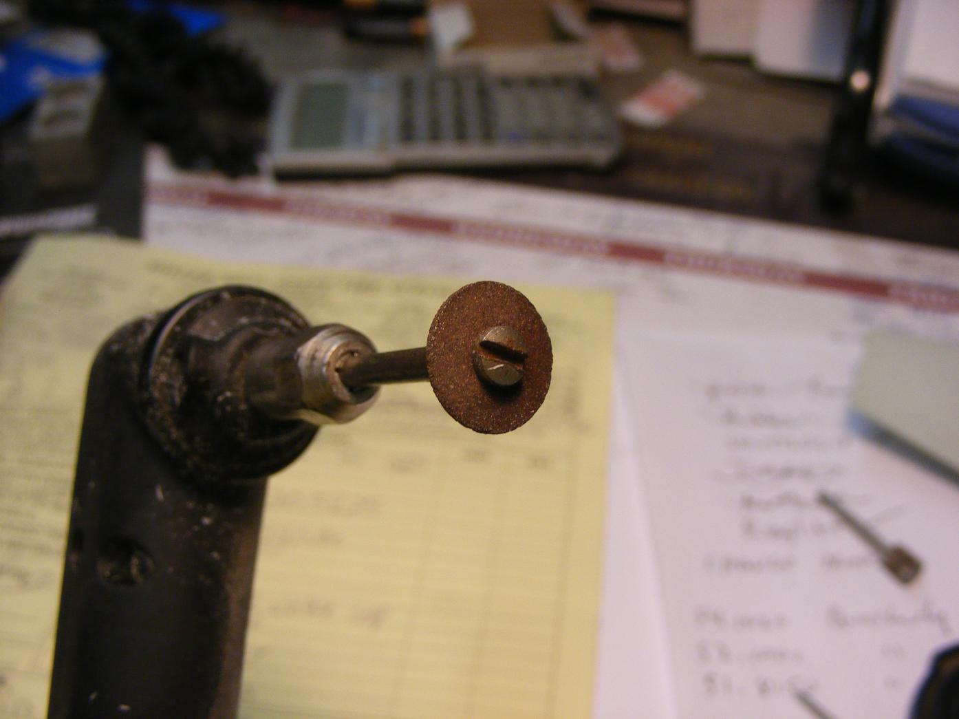

                    I drilled my 1/8" holes as instructed 1/4" back from the center of the old rudder shafts. Test fitting the dive planes should be carefully done taking the time to blue loctite the set screws and carefully centering the control yoke and the planes so that there is no drag. Carefully carving out the rear of the hull with a dremel and endmill can be finished up with a worn down cutting wheel like so. Looking good Dave. I think.Click image for larger version

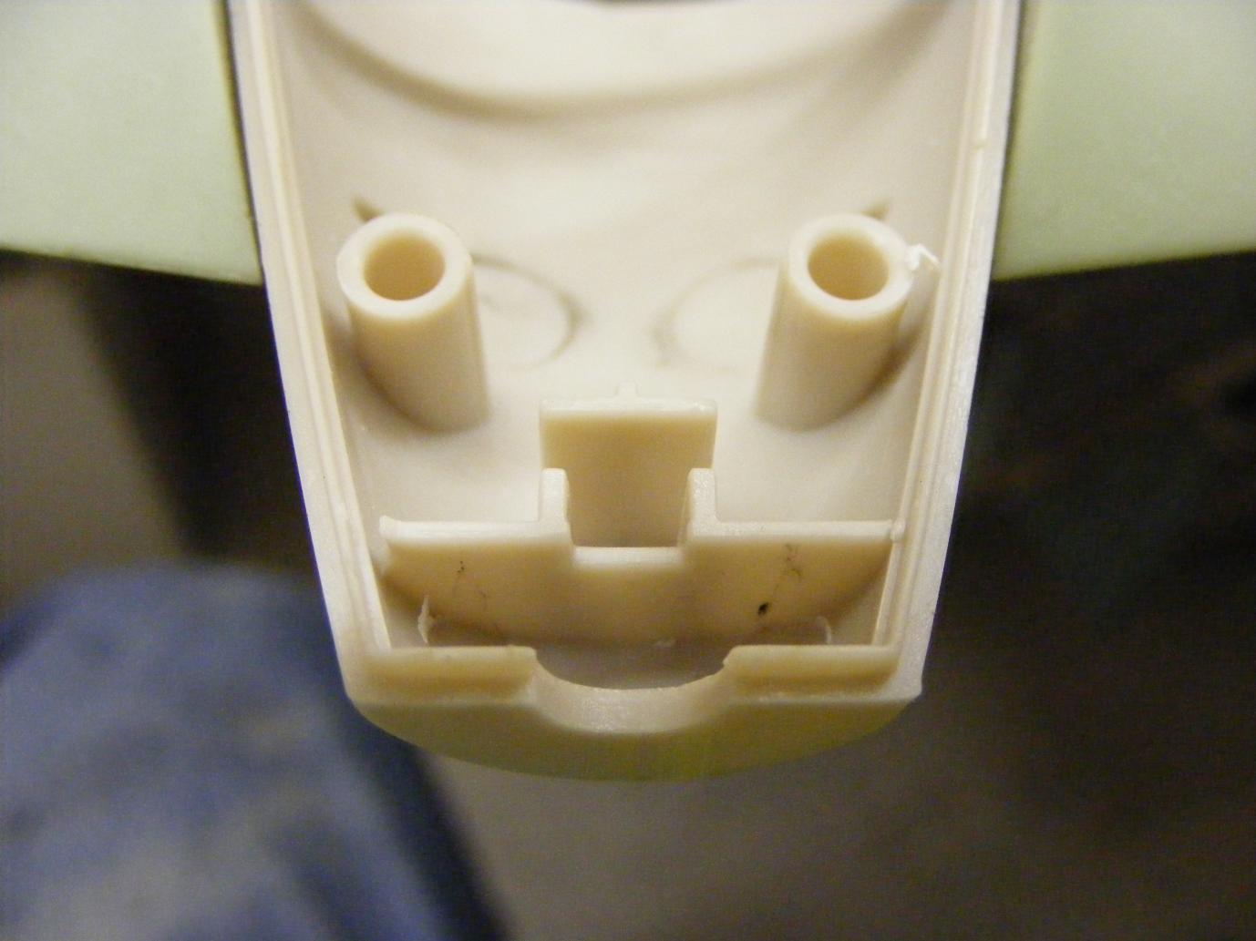

                      You dope! you knocked out those transverse alignment pins back there didn't you?!!!!
                      The ass end of the propeller shaft, stern tube assembly extends back all the way to the end of the hull, you have to knock out the sternmost transverse piece on both hull halves. The after face of the after Oilite is the rearmost part of the hull and it's where the thrust washer sits between Oilite and forward face of the propeller hub.

                        OH MY! Well , the instructions stating " after grinding away the radial and longitudinal raised braces", seemed to indicate those pins removal, since they are radial in shape. Oh well, I dont think we will throw it away, Im sure I can salvage it. Thanks for the heads up on the washer and the rear bulkhead.
