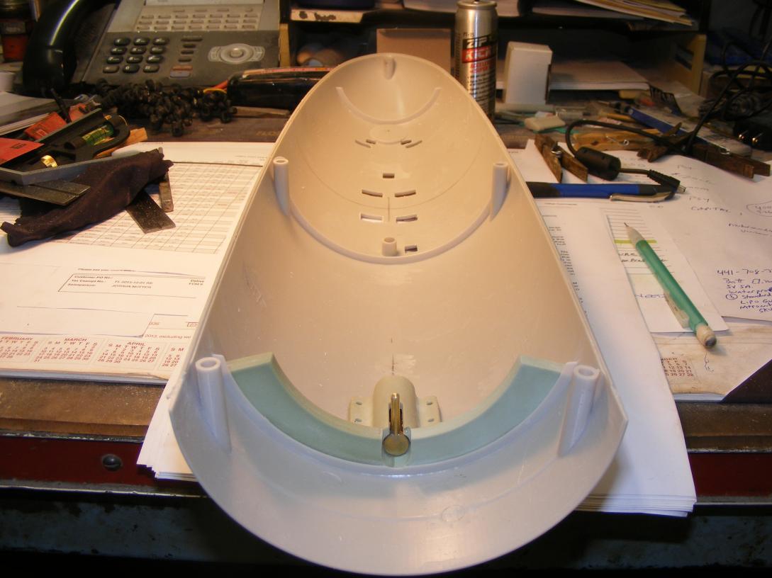

    Make sure however, that before you tape them, make sure everything is right where you want it, because after you tape them, you cant double check. Also earlier we talked about fileing out the bushings for a loose fit. This becomes all the more necessary as the bushings, out of necessity, are being glued to the inside of the sail walls that are slightly sloping(not perpendicular).
      #152

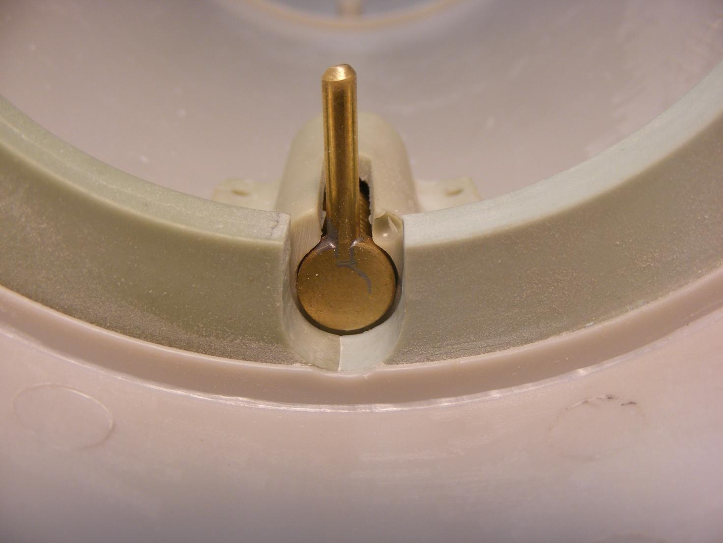

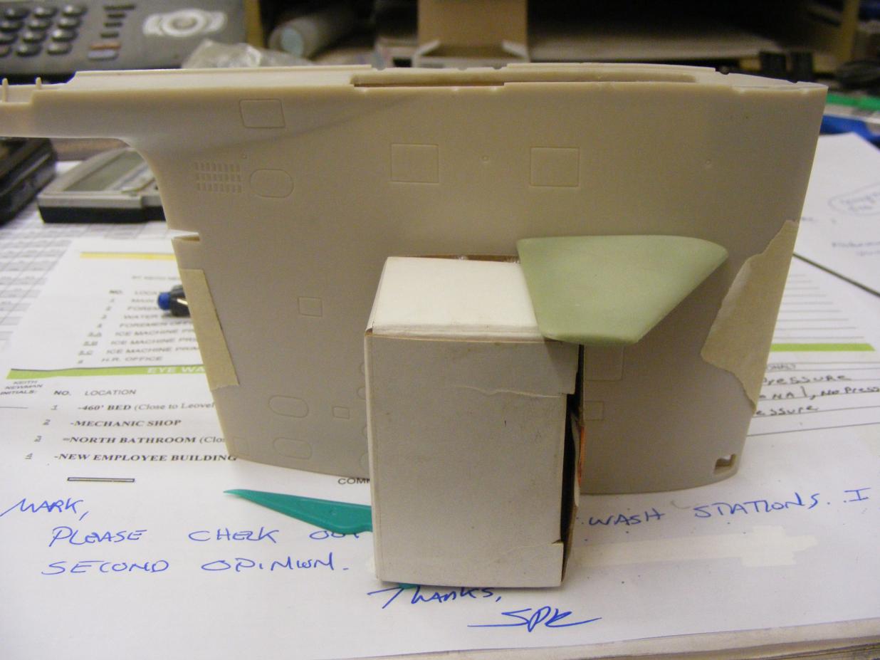

      If you dont like the tape idea(like I dont) you can always prop it up like so. Also put some light machine oil on the shaft on the ends where they ride inside the bushings, that way if any CA gets in there, youll be able to break it free.

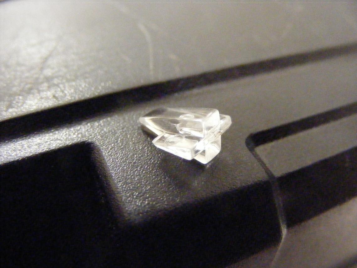

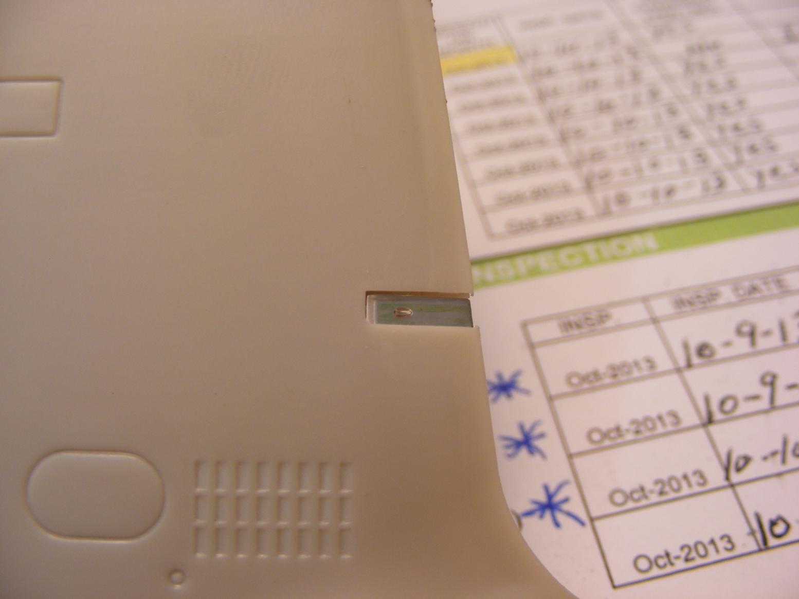

          And what a well formed lens it is too. Be careful, dont lose it.
            • 1660
            #155
            O Boy, you're in deep, did you ventilate the glue fumes enough?
              #156
              Fumes?.............fumes?................One thing I just noticed, watch that you dont put the lens in upside down. If you do then the lens wont match the contour of the back of the sail. Nice touch.

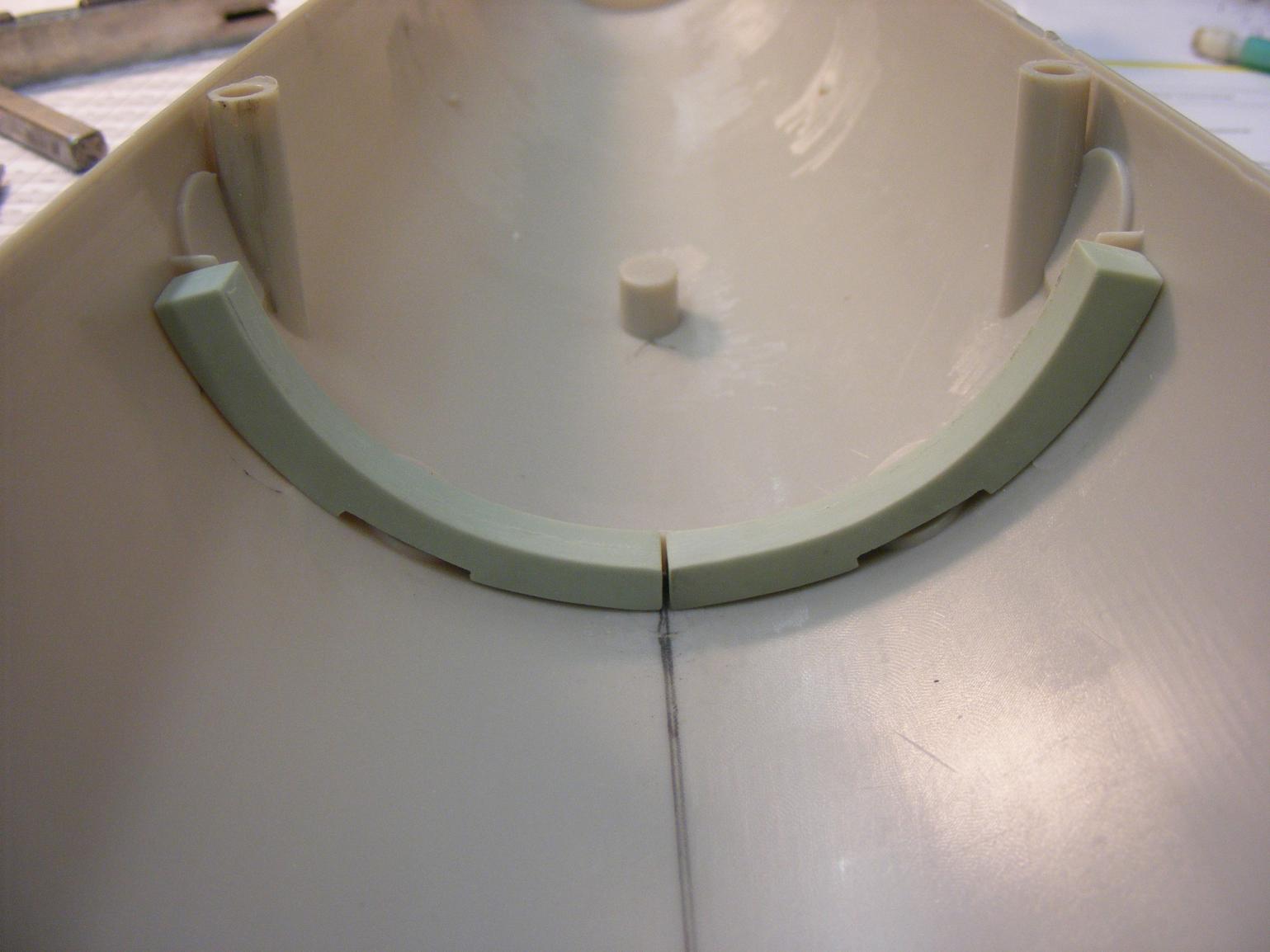

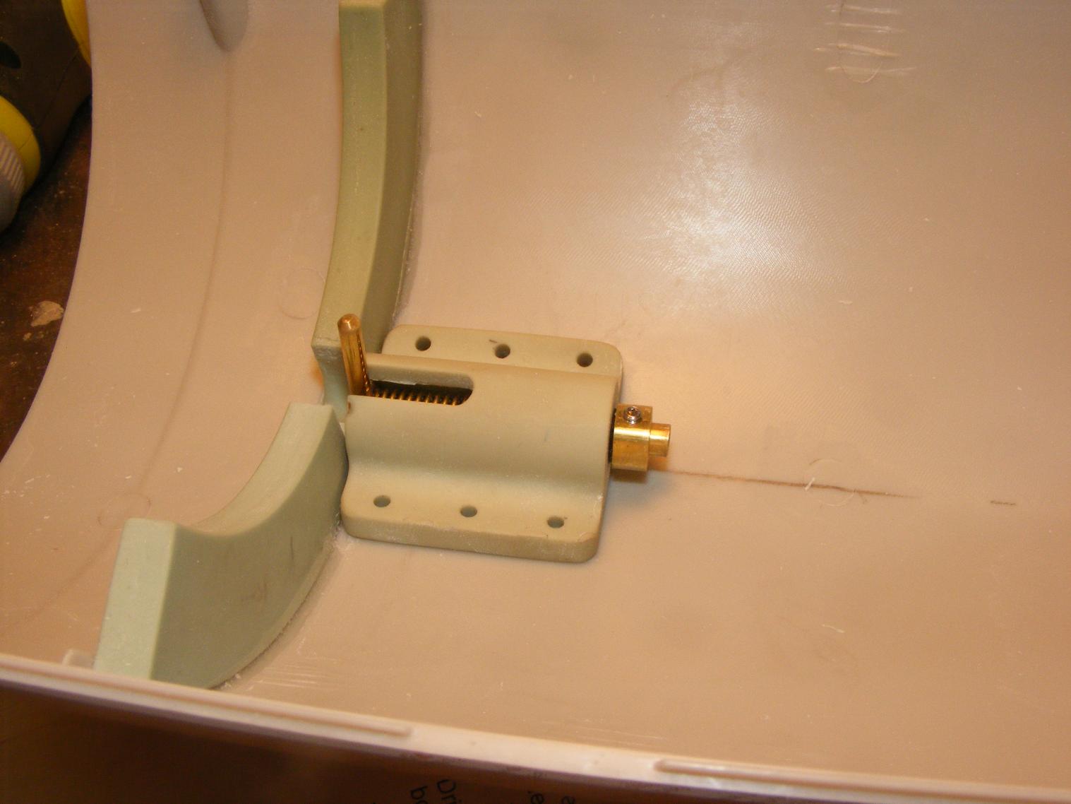

                    The foundations for the Subdriver are comprised of a smaller set for the rear section and a larger set for the front hull section. Note the cutouts for the cast in doohickeys on the face of the hull. Some kinda casting spot. Anyway you can still put these things in backwards if you are not careful. Test them both ways and stick to the way that fits the best. Just remember that the smaller set goes in the rear hull section bottom up against the small bulkhead thingy. GOT THAT???!!!Click image for larger version

                        Then the forward set must go on the forward side of the rearmost bulkhead in the front lower section, as seen in the included pictures. Its a good idea to work from a centerline, which can be established using a compass as HWSNBN suggested or by using a wrap around. You can make your own wrap around by using a womans sewing tape measure(do they sew anymore?) or by cutting a strip about 1" wide out of a cereal box and lay it along the inside radius of the hull starting at the very edge of the hull and wrap it around to the other edge and put a mark there. Remove it and using a tape measure mark the distance that is exactly half of what you just measured. Then put it back in and then transfer your mark. To check your work then turn the wrap around around and do the same thing but start from the other side. You get the idea. Just a different way to make the same wheel.

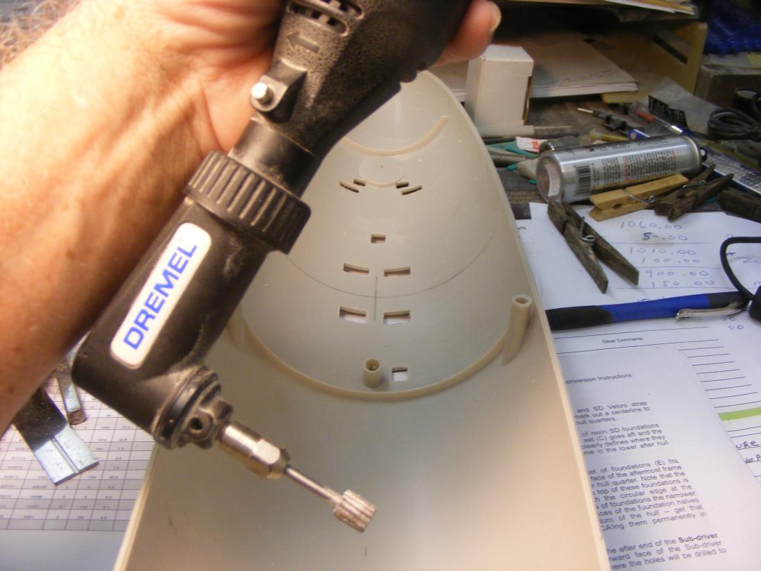

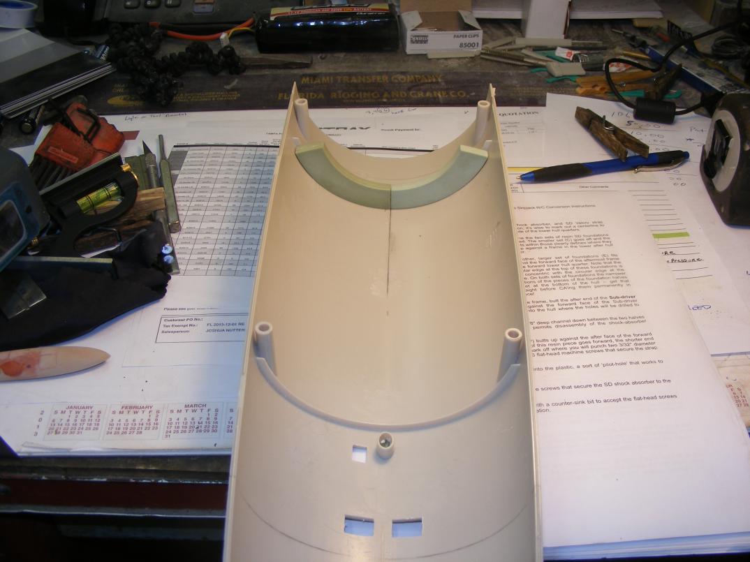

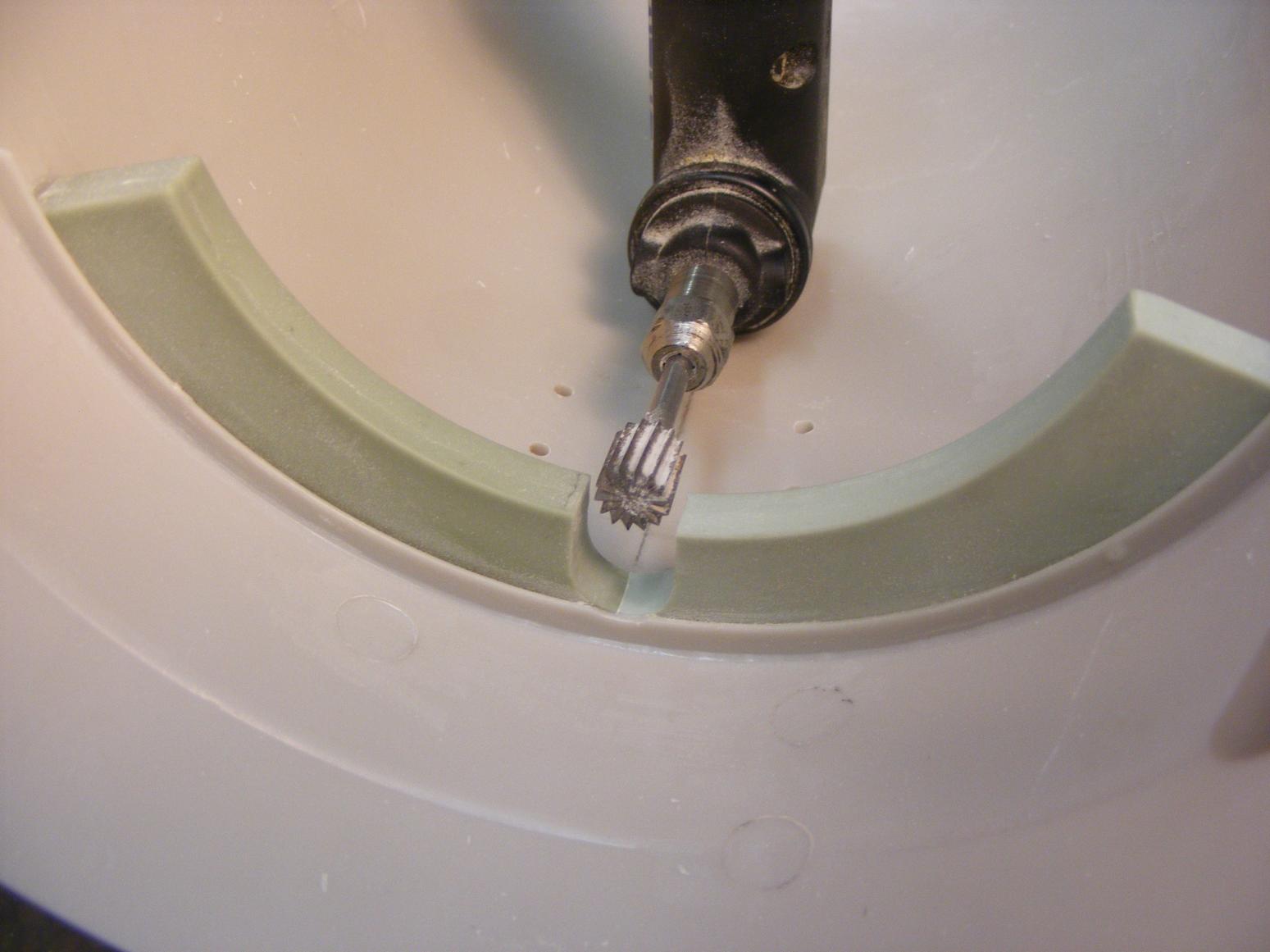

                                Continuing on following Davids instructions(thank God) the cool spring loaded shock absorber goes in next. Keep in mind youll need to cut out an opening in the forward foundation in the middle, about a 1/2" wide all the way down to the top of the factory strip bulkhead. This for the reason of being able to take the shock absorber apart in the future without having to "dig" out the screw heads on the other side and mess up your paint job. You see here my trusty Dremel with right angle drive and cutter. First mark it out so that you have some lines to guide you. If you are really smart you could do this before you CAed the foundations down(DUH!)Click image for larger version
