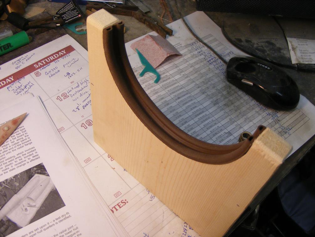

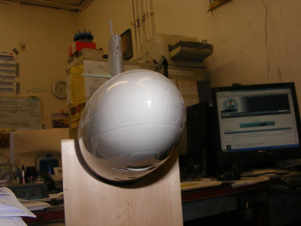

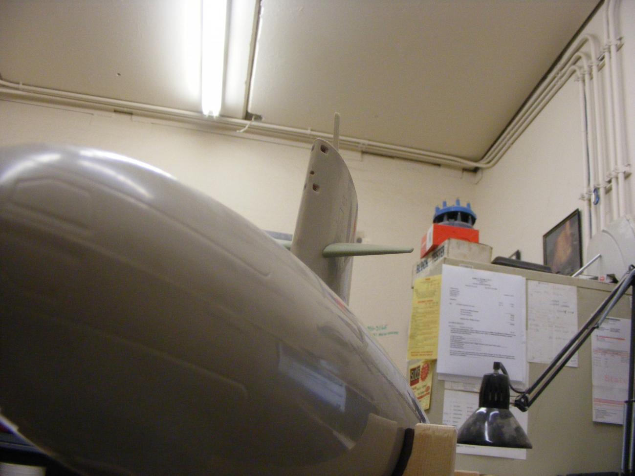

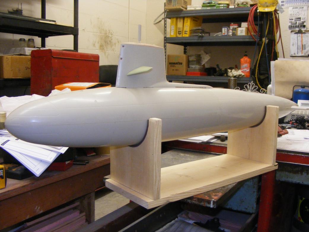

            Using 1" x 8" spruce, I made this stand for the sub. No more rolling around on top of the work bench. I lined the radial supports surfaces with stick on rubber weatherstrip.

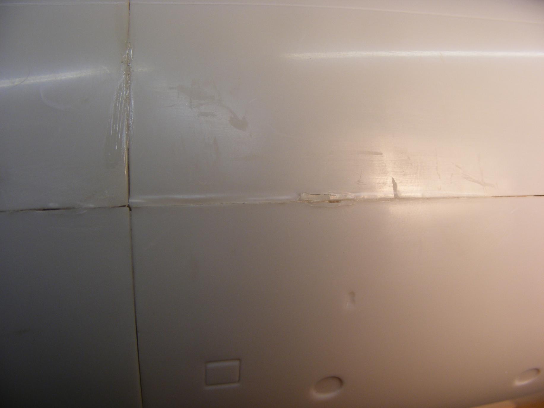

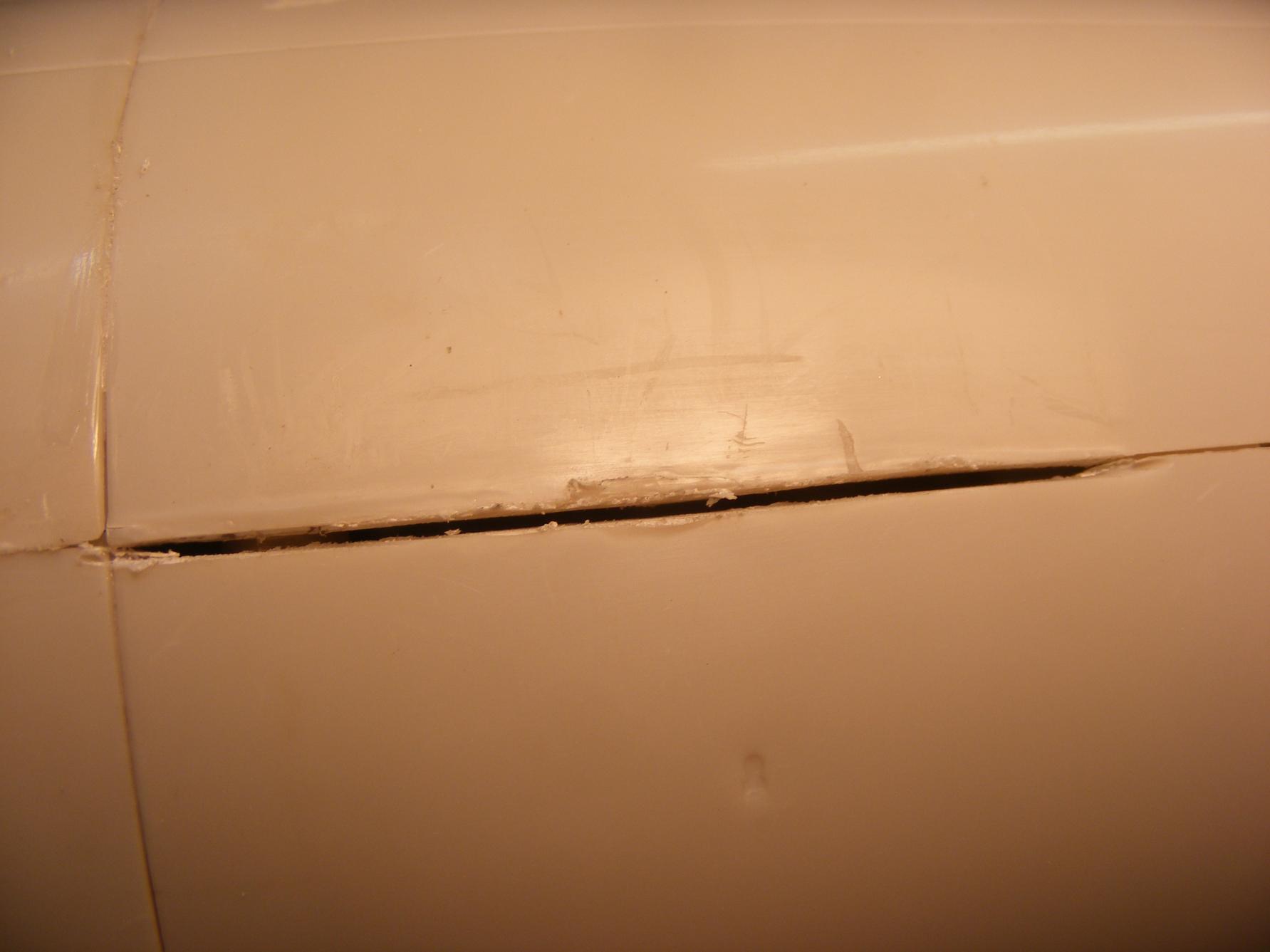

              DANGER WILL ROBINSON............DANGER!!! In Daves instructions, he mentioned about putting Wax paper on both sides of the joint to keep the glue from going where it ought not. AND WOULD I LISTEN?.........NO, I only put the paper on the forward side because it was easier. Guess what happened? You got it. Some thin cohesive wicked into the cool little channels on the bottom hull that mate with the top. For about 2" on both sides. Kinda disappointing but Ill slip my Dremel diamond wheel blade on the lower side of the joint and open it up. That way ill only have one side of the joint to mend with Evercoat. BE WARNED!BLUSHER
                #202
                AND JUST LET THAT BE A LESSON TO YA..........HMPH!!! Its not so bad, As my Dad always used to say...."Ive had worse places in my Eye Before".

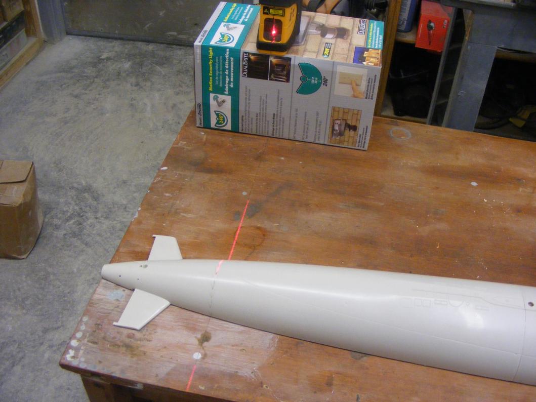

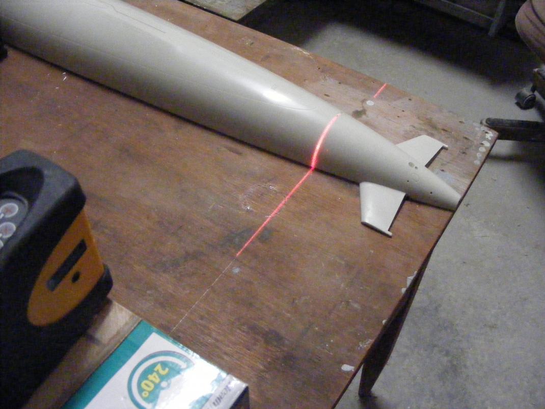

                  Here we are. The aforementioned BooBoo can be addressed when its time to paint and otherwise make it pretty, operational considerations first ya know. Moving right along in our instructions, the next step is to dissect our hulls by cutting off the back cone of the upper section and the same with the front section of the bottom hull. The Classic "Z" cut. Ive used this cut on both the Oscar and the Albacore. The only way to fly. Not really a big deal, except I didnt care for the line I had established for the cuts. So I decided to cheat. Out came the company laser level.
                  Here you can see were back on the table that I used to glue the bottom halves together. Using the previously established centerline , I marked where the cut area would touch the table and using a framing square, marked out a 90 degree long line. Putting the hull down on the centerline I then set up the level to shine a red laser line to line up with my 90 degree line.. Then using a fine tip pencil I made marks on the hull. Then moving the level to the other side and carefully lining up on my 90 degree line, I marked the other side as well. I will do the same with the front piece. I bought a brand new Razor saw blade as the last one got dulled cutting GRP on the Oscar.

                    The good thing about this level is that its pretty inexpensive, about $100. Also, its self leveling, just make sure that your table is level. Mine was not so I used a couple of quarters under two of the legs to get it level.
                      #205
                      A wrap around could have been used to mark the hull, If the hull was the same diameter all the way. But since it tapers, itll throw you way off!
