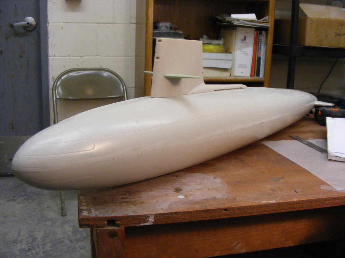

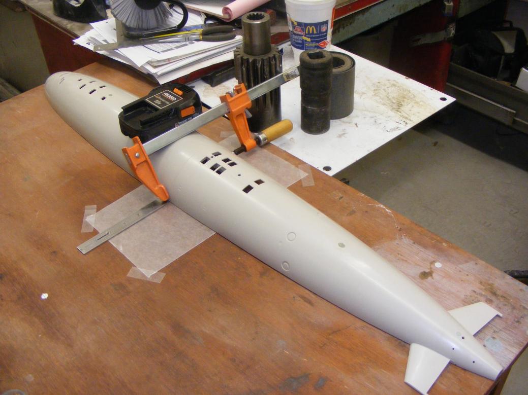

            As far as the "glueing" of the two lower hulls together, This is what I have at my disposal. Notice the old wooden desk. I used a long straight edge to first determine that the table top is indeed ,flat. Then I marked out a centerline in pencil on the table top and center marks on the ends of the plastic hull for alignment. This handy little adjustable clamp squeezes the front hull together at the joint to mate with the rear hull piece. The clamp wants to fall over so I use various odds and ends to prop it up. The rechargeable cordless drill battery is used as a weight to apply downward motivation. Put your eyeball down at the joint so that you can see if everything is in alignment, so that you can make minor adjustments before it hardens. I followed HWSNBN instructions on first, applying the thin plastic weld liberally at the joint and then applying the model airplane glue generously but not excessively after that and then putting it all together. Now for at least 12 hrs. dont move it. Oh...and please note the wax paper under the joint and the large Mcdonalds sweet iced tea nearby, both essentials to this operation.....Kapeesh?:biggrin:

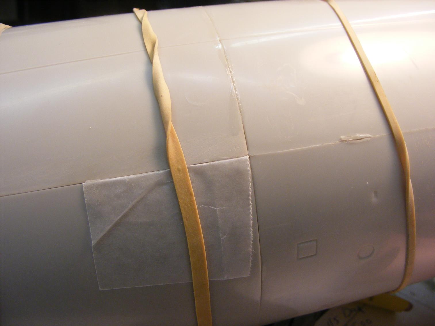

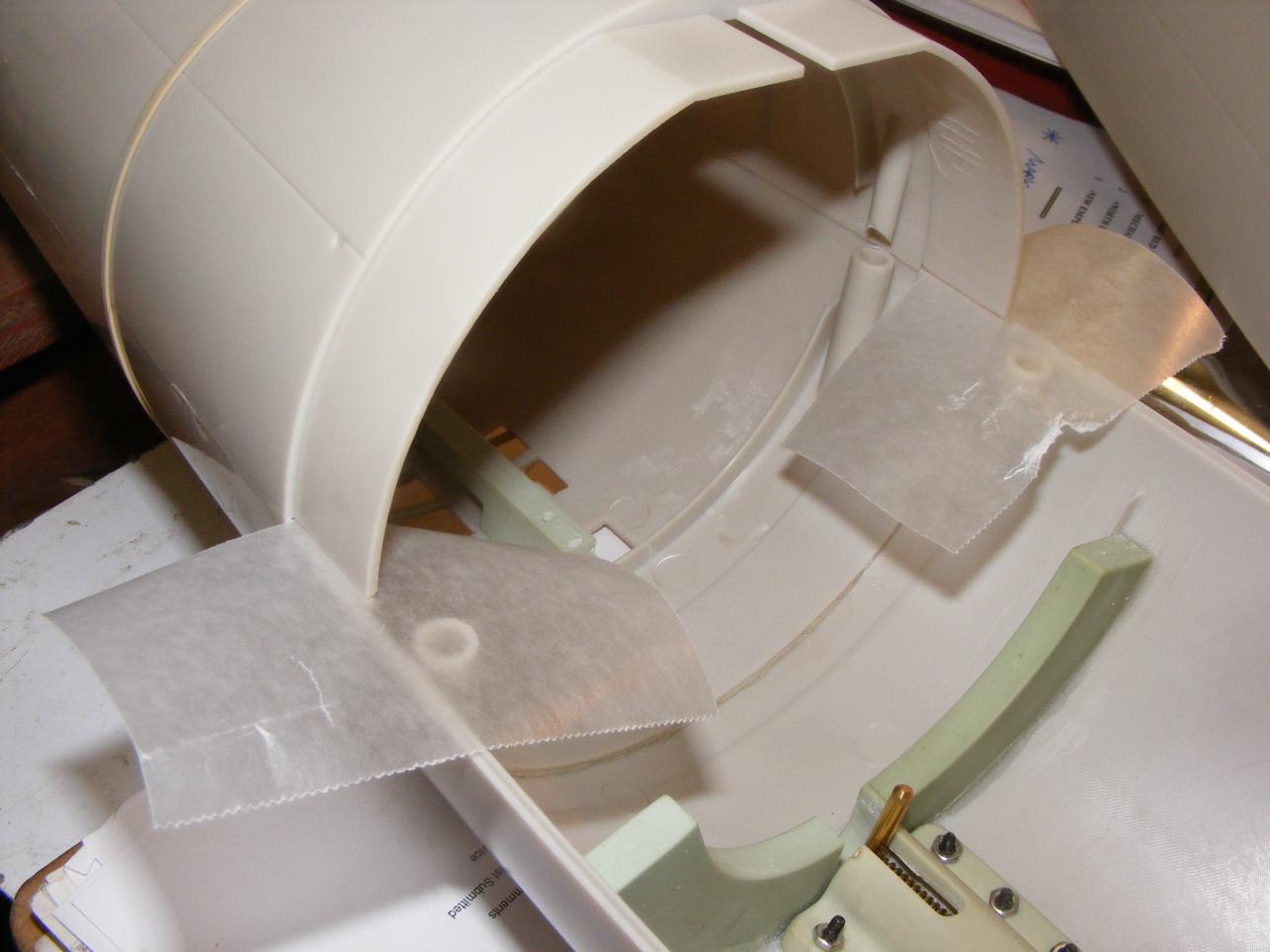

                        Today at lunch I assembled the two top sections on the bottom sections and glued using the same procedures as before. Holding it in place until overnight dry using rubber bands. As has been suggested, I used two small pieces of wax paper to keep glue from dripping down into places that it dare not go.Click image for larger version

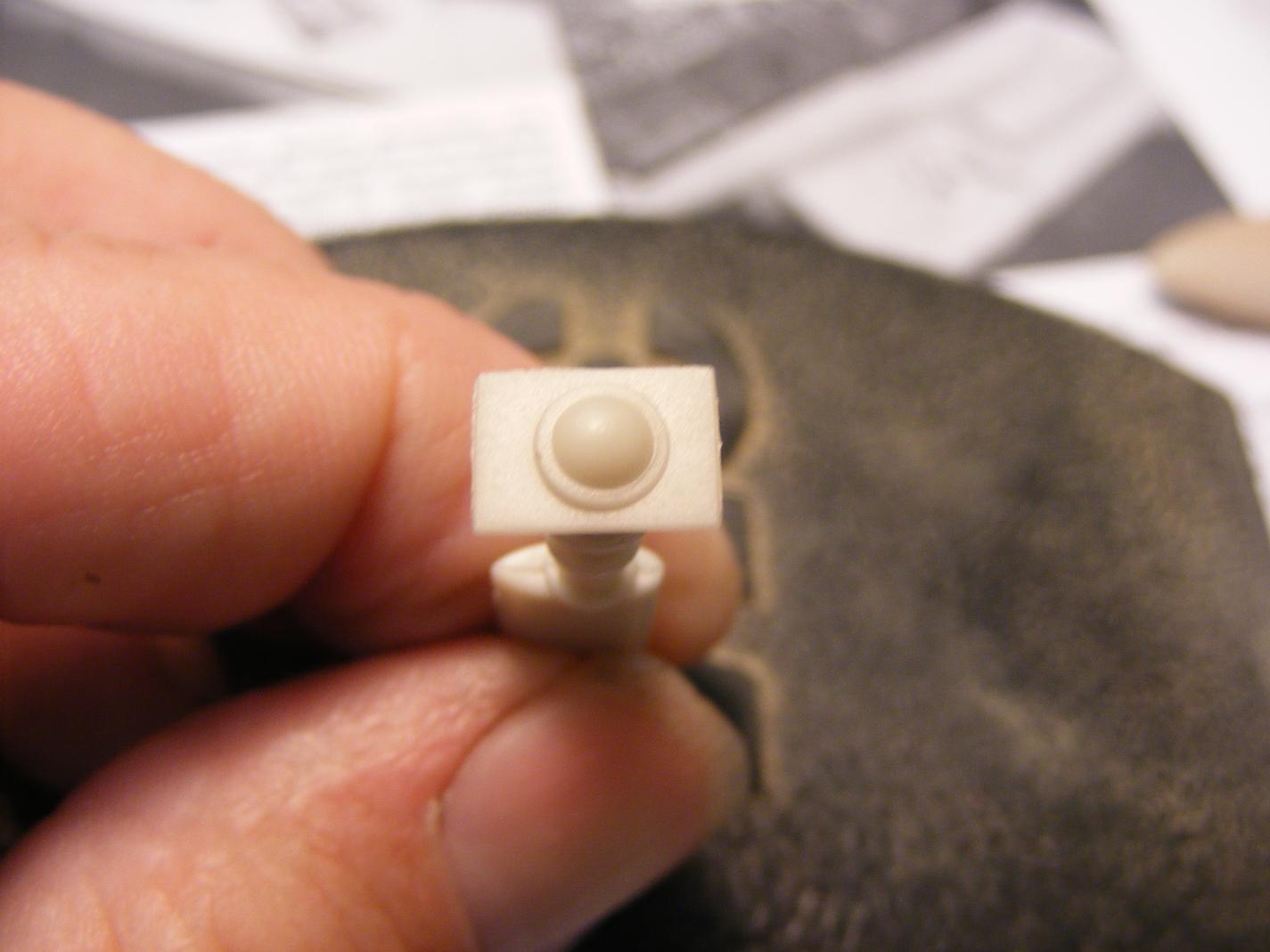

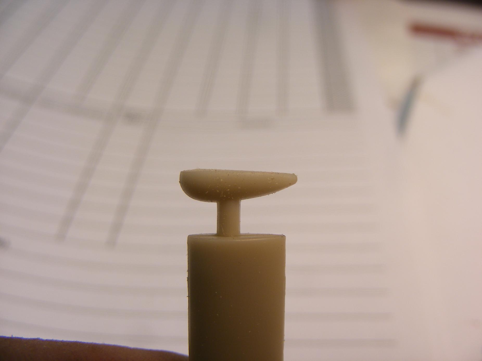

                          Using Alecs and also Toms build threads to copy from, and from some pictures Ive seen Im endeavoring to add a little detail to the top of this sail. As you can see Ive already added the top of the ECM/DF antenna. As for the VLF loop antenna, that was an accident waiting to happen. I wanted to sand it down a bit to give it the illusion of being somewhat recessed(sneeky). I could see that going awry so I left the antenna atop the mast for sanding and gluing. That will make it easier to hold and then I can just snip the mast off when Im done. Im also going to leave a stub sticking out of the forward retractable whip antenna to imitate a picture that I have seen and to add a bit of variation. HEY! All these Skipjacks cant look a like ya know.Click image for larger version
