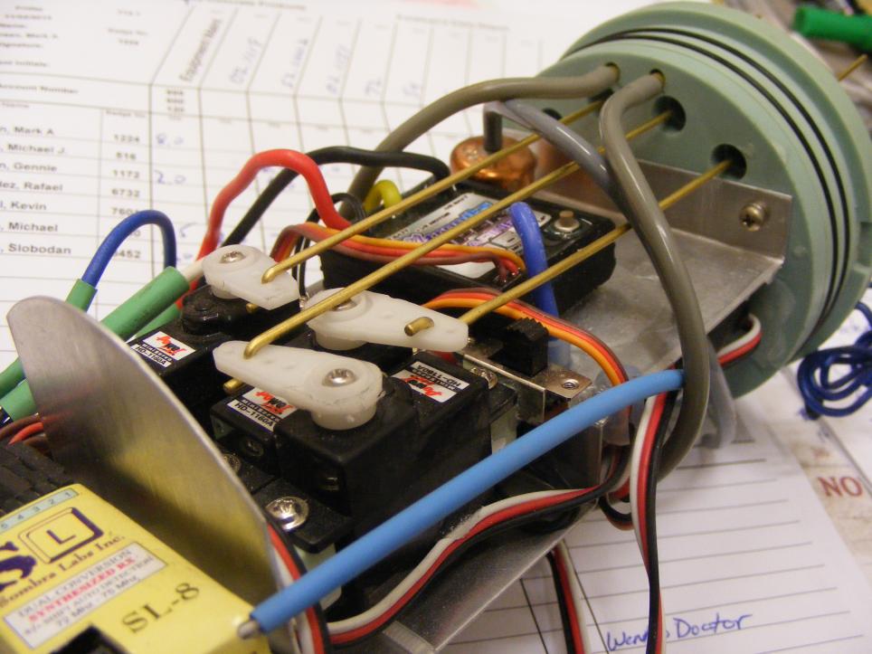

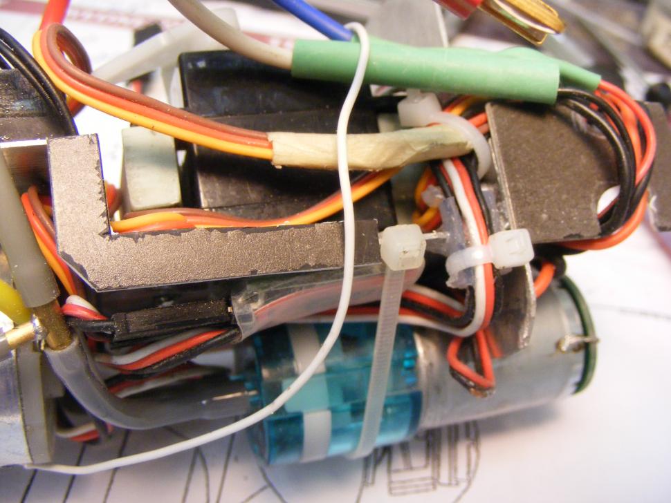

      #332

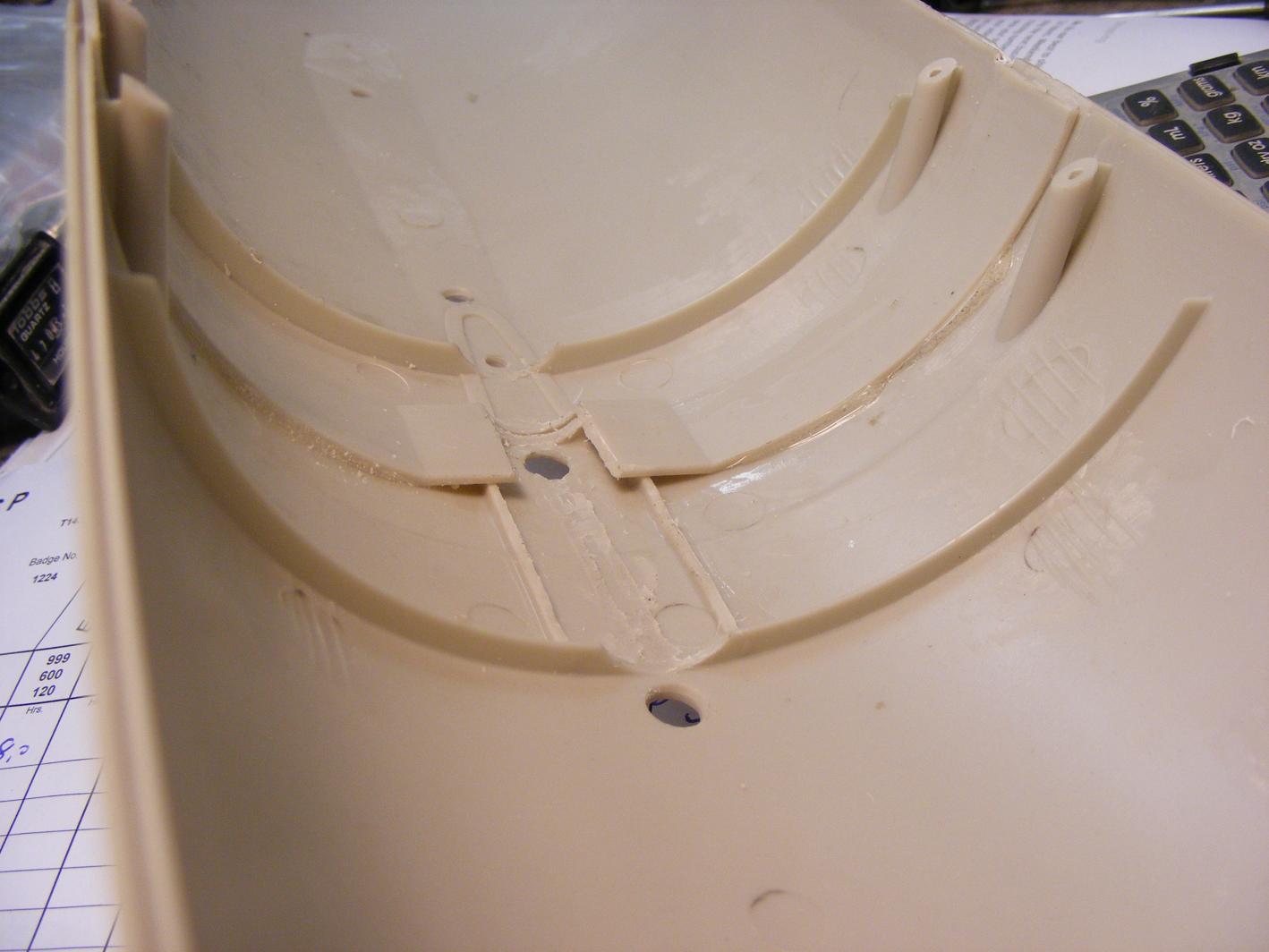

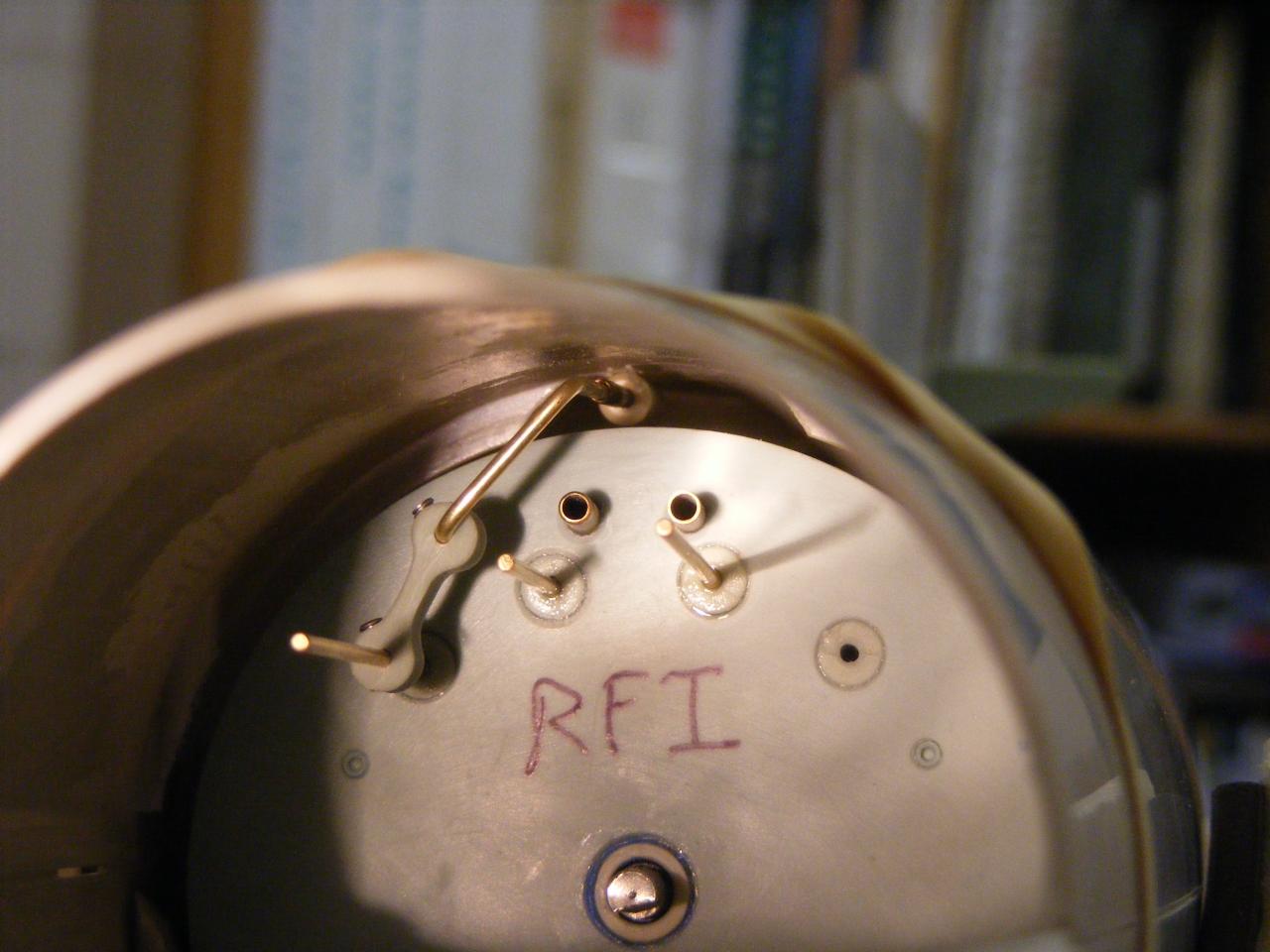

      To keep important wires from chafing and possibly shorting out against the Aluminum servo and appliance mounting trays I have CAed sheet plastic in several areas where wires will come in contact with those trays, as you can see here in the first picture. In the second , this is how I plumbed the CAN BUSS connections for the SAS pump, LIPO Guard and BEC. I attached them directly to the Deans plug terminals, via an intermediate connection wire, so that its not too busy at the plug. Spread it out a little bit, Ya Know? Maybe its neater than another alternative. The deans plug that connects to this one , of course, runs up into the forward Battery compartment. In order to have easy access, the wire is made long enough to allow easy access to the plug connection and to get the equipment tray out where you can work on it. After the connections are made you just pull the extra wire up into the battery compartment before sealing up that end. Plenty of room up there.

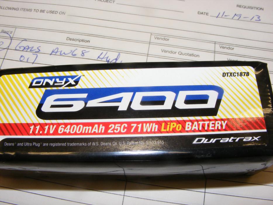

              With new LIPO in hand I thought I would share some info about these things. First youll note the 6400 Mah rating. If you move the decimal place 3 places to the left, that will give you your Amp Hour rating of 6.4 Amp Hours.
              The 3S symbol denotes 3 cells adding up to 11.1 nominal volts. For safety sake, do not exceed 4.2 volts per cell nor go under 3.7 volts per cell.
              Store your LIPOs at 30% to 50% capacity for longest life.
              2 cell lipos should not go below 6.4 volts and 3 cells should not go below 9.6 volts.
              The C rating is the batterys Mah rating divided by 1000.
              1c charge rating is the safest, although some can be charged higher. Consult the paperwork that came with your battery.
              In the picture you will note a 25C rating. Thats discharge rating. Do not exceed this.
              71 WH is Watt hours. Thats determined by multiplying your Amp hours by Volts.
              Do not exceed 115 degree Fahrenheit during charge.
              Do not exceed 140 degree Fahrenheit during discharge.

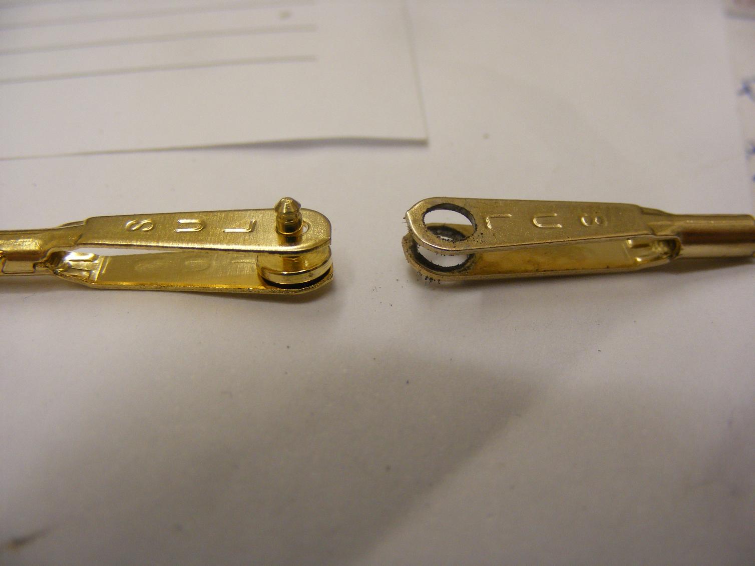

                    #339

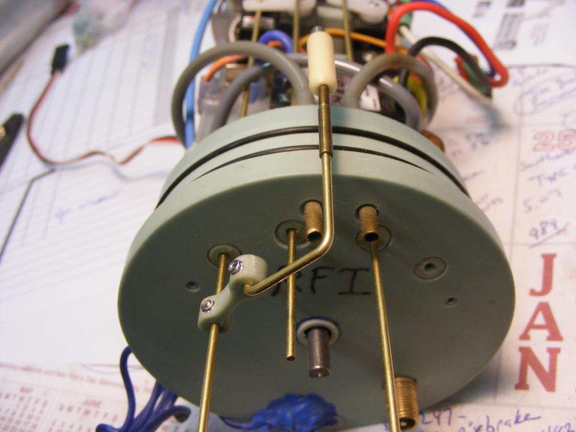

                      #340

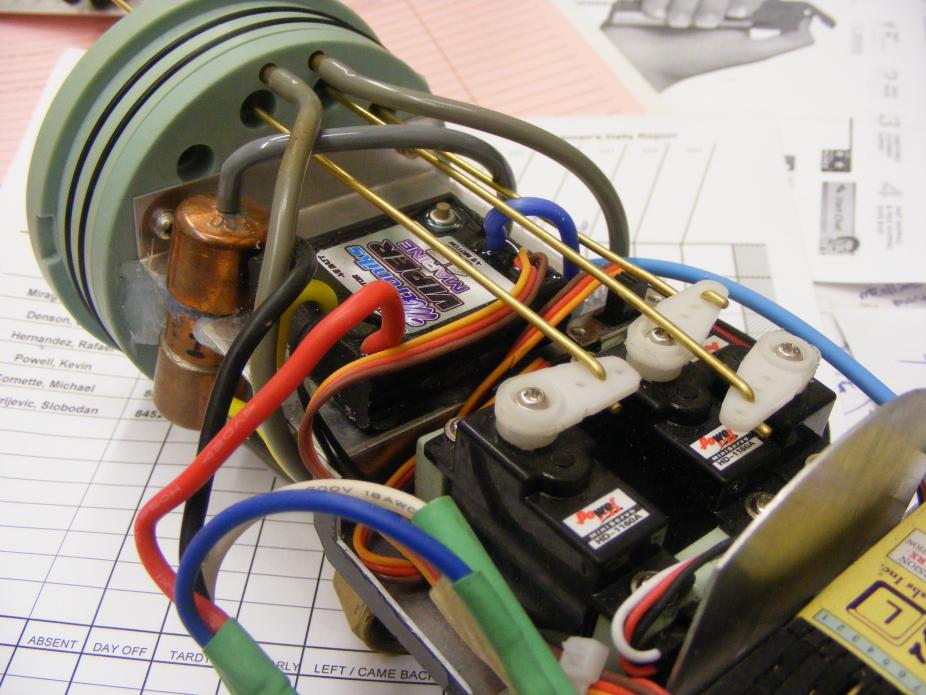

                      After installing the supplied and suggested sail pushrod end at the subdriver, I have mixed feelings. A good system to be sure, but Im afraid that when you go to remove the hull top section, there will be a tendency to bend the pushrod where it exits the subdriver as well as at the allen head bracket joint. Im proposing installing a hold down. Ill have to make one and install it with two small screws to the top edge of the motor bulkhead. Picture soon.Click image for larger version

                        #341

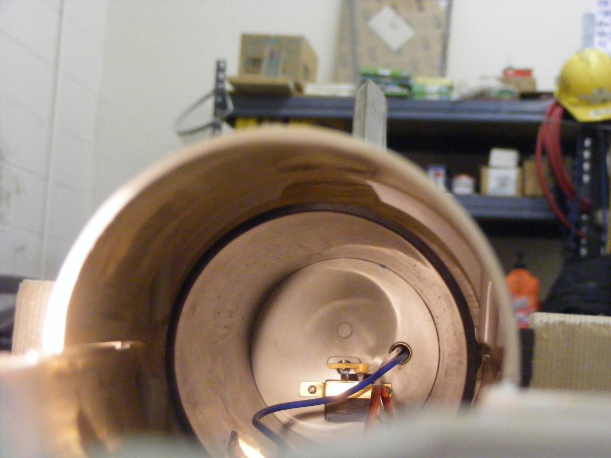

                        This picture gives us a better idea how much room is available and where to set your pushrod. Really, for all intents and purposes, it couldnt be any better. Youve got very little play, and thats good. You almost cant go wrong by setting it close to the underside of the hull. As far as setting the length, youve got a lot of adjustment. If you use a threaded Klikon then there is adjustment there. You have two adjustments on your pushrod bracket where the pushrod exits the subdriver. If you use a threaded clevis at the sail, then you have adjustment there. Im thinking that upon assembly for operation that you would move the radio stick to the full up position and your sail set to the full dive position. After top hull is attached move radio lever to down position and sail plane to surface position. At that point your magnets will...."click". .....Uh....that is ...of course how I think its going to go.

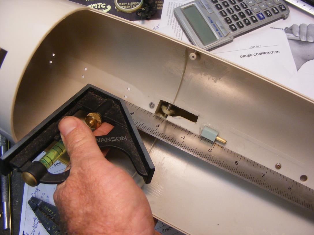

                          #342

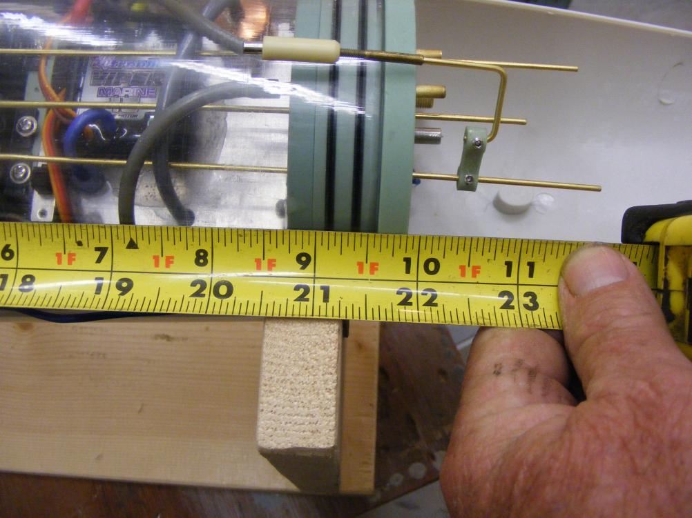

                          How long should your pushrod assembly coming off the sail and extending back to connect up be? Easy! Carefully measure from the front lip of the seam where bottom hull joins top hull to the aft end of the sail magnet(do this at sail plane neutral position). Right that measurement down. You can use a small tri square to be accurate.
                          Then , measure from the lip of the seam on the bottom of the hull back to the inside of the motor bulkhead, looking thru the clear acrylic. On mine Im looking at close to 20&11/16". Then the Klikon is sticking forward of that by 7/16". That is at radio stick neutral. So subtracting the two gives us 20&1/4". Remember the number we got using the square? Subtract that and you have your distance, in this case 17&1/4". Thatll get us real close..end to end of control cable including magnets. If your using the clevis hookup that I am on the front then it would be to the rear of the drilled 1/8" hole in the clevis.Uh...........duh!(no emoticon available)

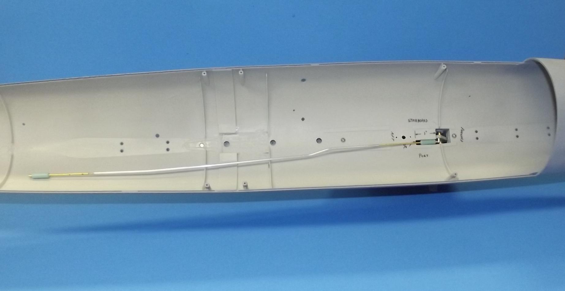

                            Here is Daves setup. I believe in this picture, he has yet to install any hold downs for it.

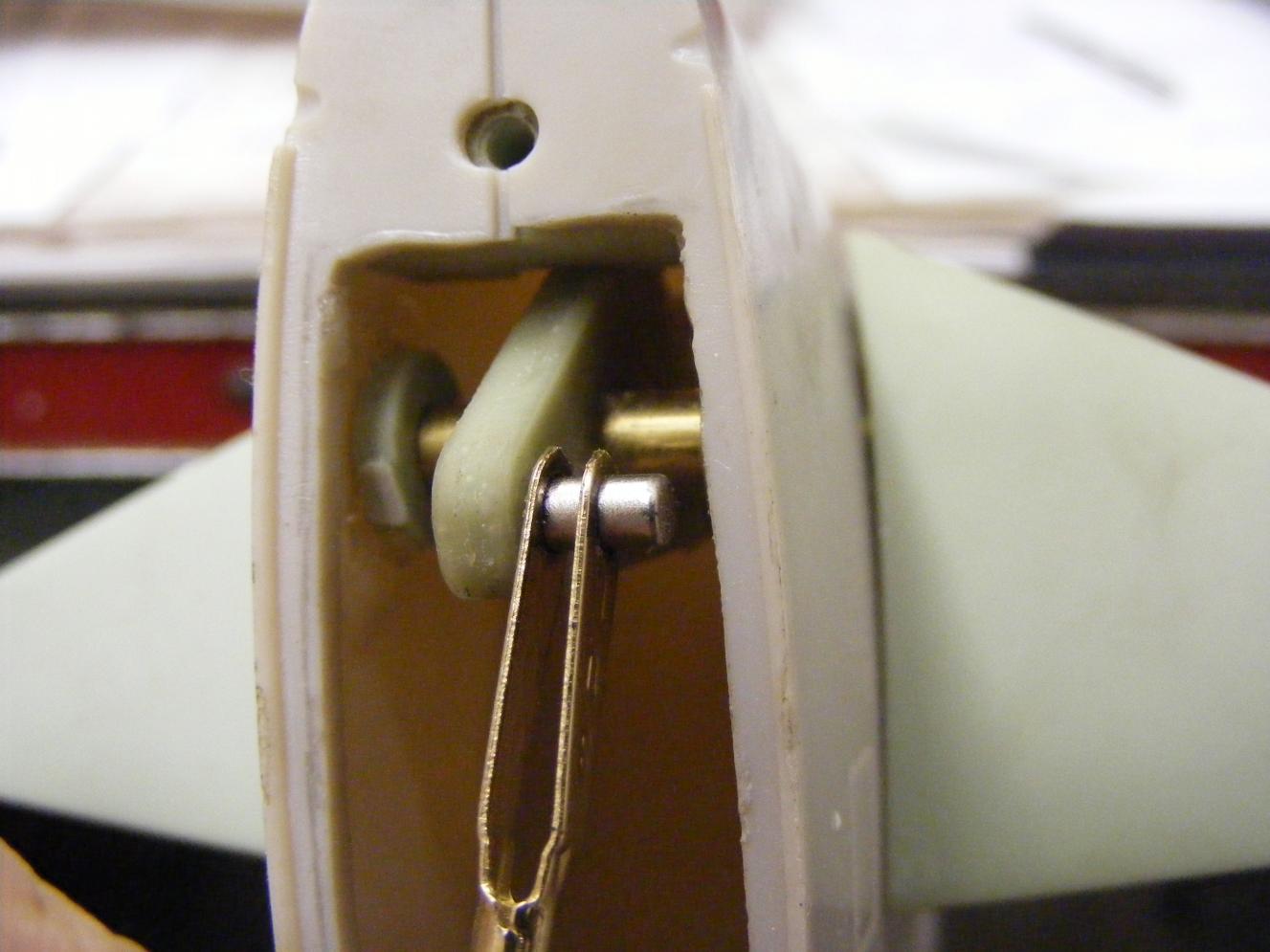

                              #344

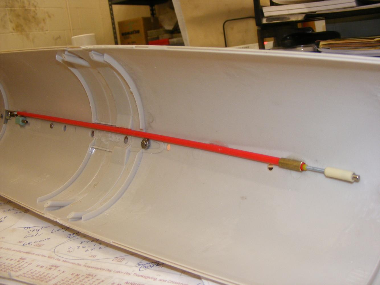

                              I have elected to use this ready made pushrod cable for aircraft, just cut to length to suit you. If it doesnt work, ill just take it out. No harm done. I just tack CAed it in a couple of spots just off center to line up with my Klikon on the Subdriver. Notice that I used a brass short section as a holdown at the tail end. If I end up using dual magnets at this joint then I will add another one all the way back to better support the cable so that when you lift up the top hull to remove it, youll have no stress put on it.

                                #345
                                The length worked out perfect. I can already tell you that Ill have to use two magnets. I can grab the sail planes and with little effort , I can break the magnet loose. With High Speed water breaking over them, I dont want it to disengage. However, the sail planes are not critical to operation as most of the control, I believe, will rest with the stern planes. Sail planes are just the icing on the cake. But, I still dont want them coming loose.
