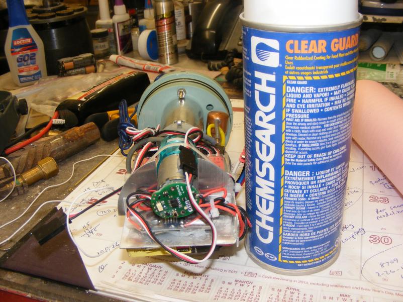

            Thanks Guys. Since water ingress is always a possibility in a submarine, Im on the lookout. I noticed that the SAS pump is really close to the bottom of the Subdriver. It will therefore get wet if any amount of water above a tablespoon gets in there. Since the most fragile component of the motor is the printed circuit control board soldered to it with its various electronic components attached, Im going to spray it down with this stuff. National Chemsearch Clear Guard. Its made to seal water out of such devices. Another thing Im going to do is what I have done for years is put a small sponge in the bottom. As far as water droplets getting past the safety valve, Im not too worried about it since the closest component to it is the waterproof speed control. But just for "reasons of good form" Ill put a hose out of it to drip into the bottom area.
