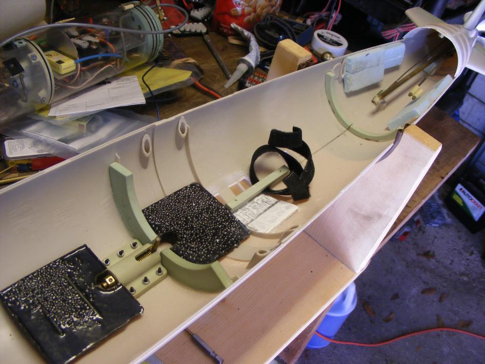

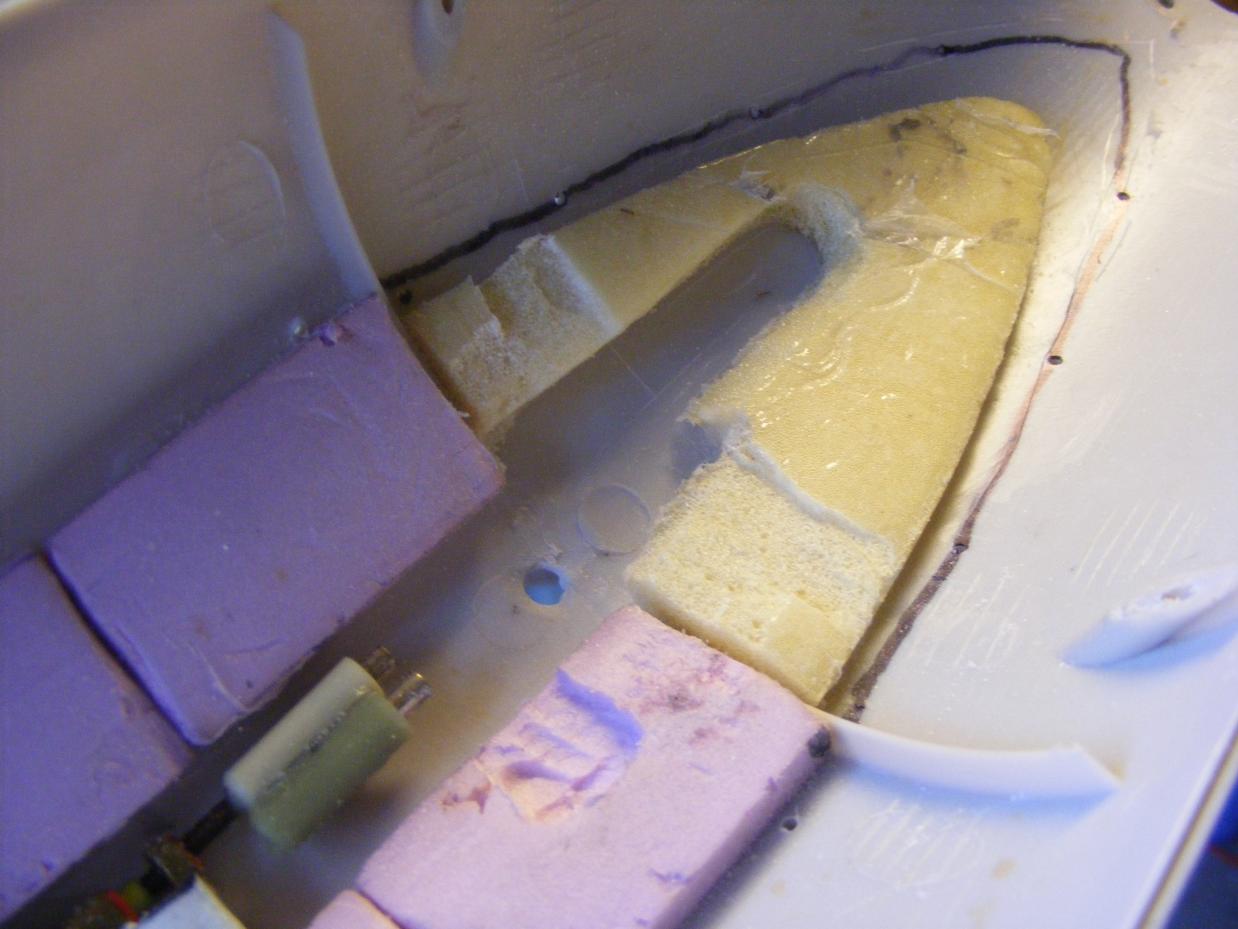

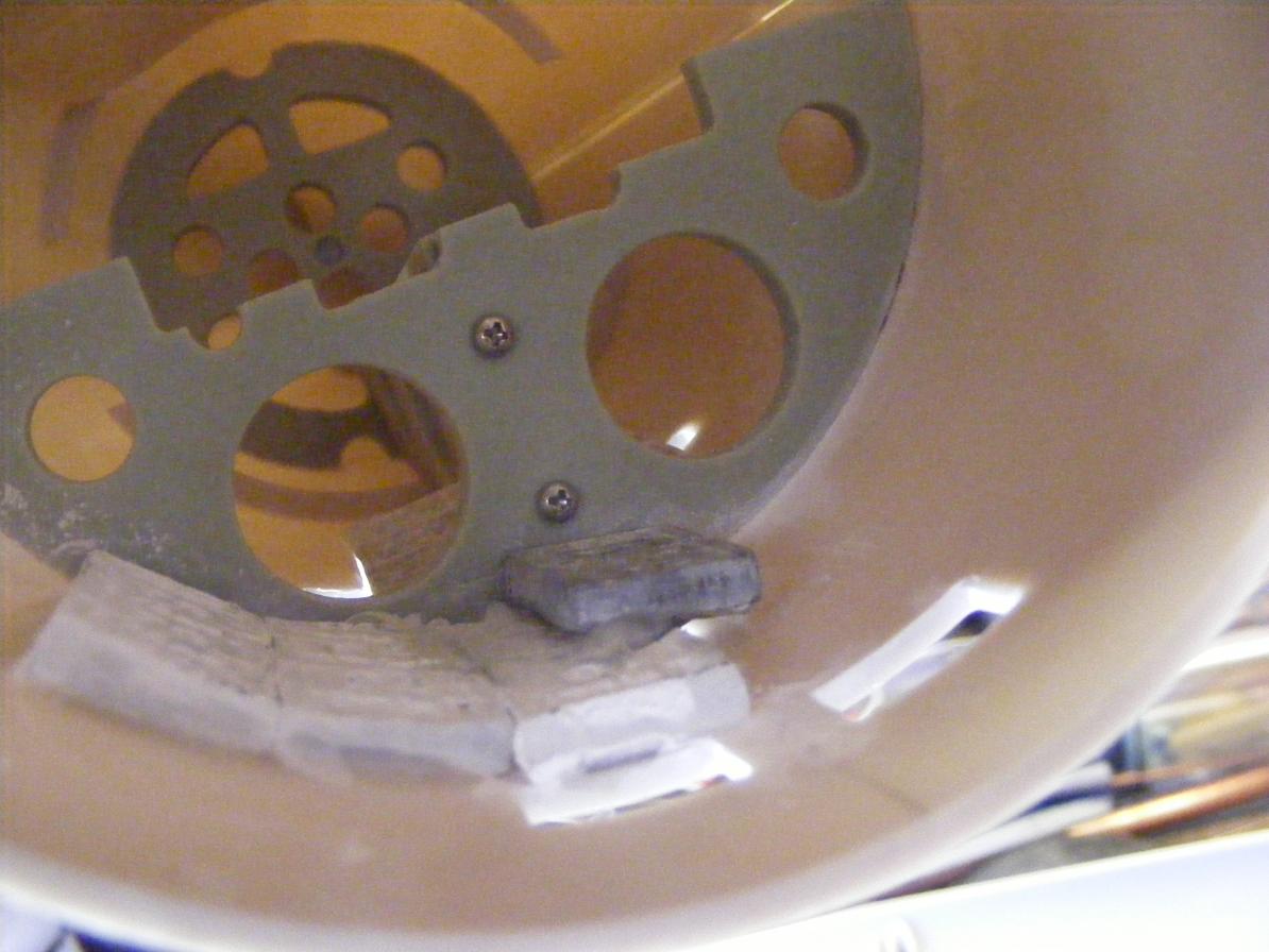

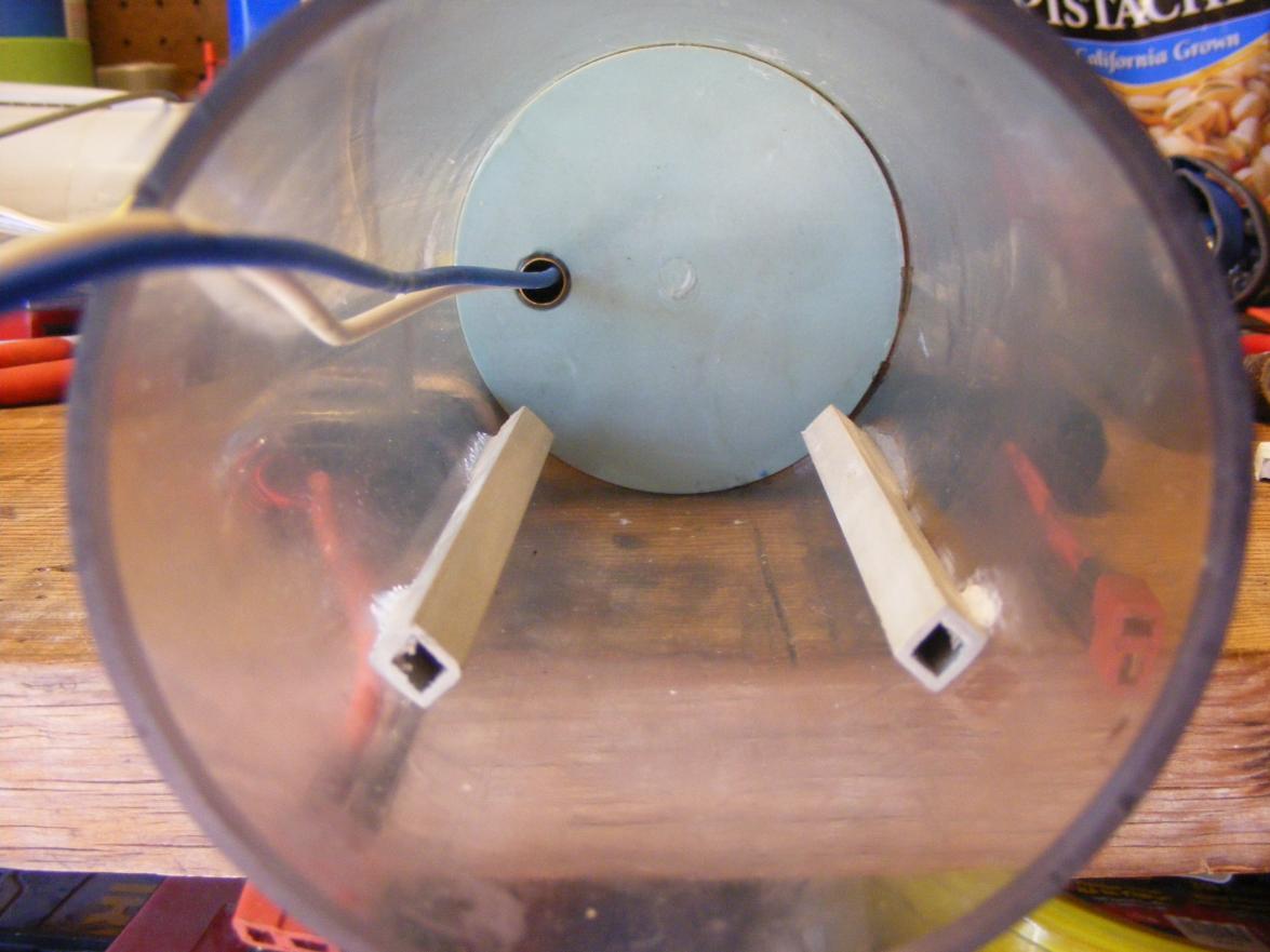

                OK, I am happy to announce that all is well with the Scampy. The Bellcrank mech. is a success. Since the bellcrank hit some of the foam installed under the upper hull in the rear, I had to cut a groove in the foam. Ill need to refloat it to see where, if any, ill need to put a little more foam back.
                Just a side note. The foam that comes with the "Foam and Weight " kit appears to be of the open cell type. Which means that if you cut into it, you open up those cells in that area. Which means that it will absorb water at that point. Make sure that you put a thin layer of silicone seal over those affected areas.

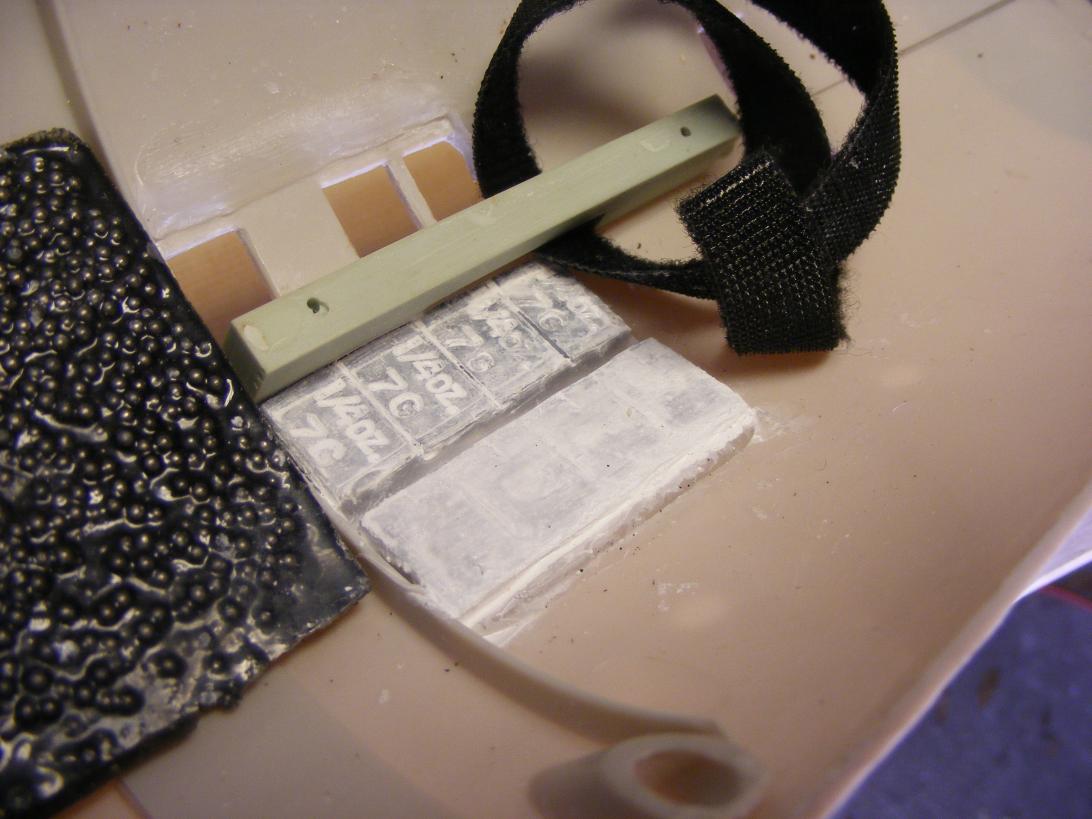

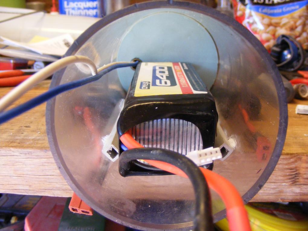

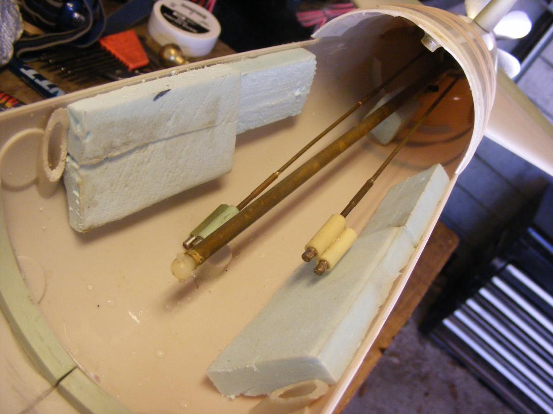

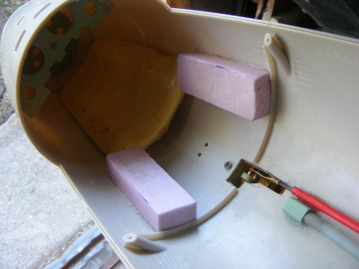

                The following pictures are the final state of weight and foam placement, just in case someone with limited experience would like a starting point. The first two are the rails to hold the battery from shifting around.

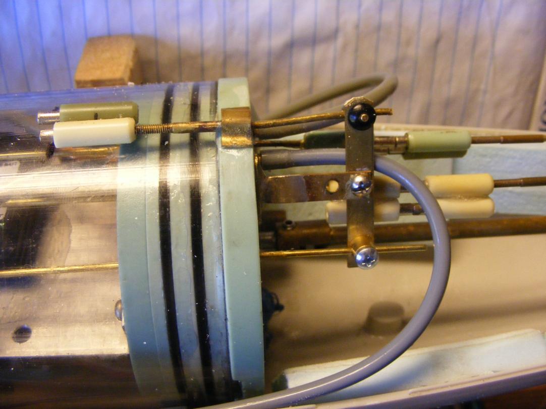

                  The next ones are of the bellcrank assm. The picture you see of the vertical arm , well, it had to be cut down a little more as it was hitting under the hull, not allowing it to go down all the way for attachment. I took it off and used the Dremel to shave it down some what. After some fine tuning and servo reversal, I now have a much more positive command of the sail planes.
                  I will give a full report of the Scamps performance with and without the use of the sail planes.

                      Thanks. Obviously the purpose of the bellcrank is to eliminate the bending forces on the pushrod exiting the Subdriver. This way, those forces are taken up by the central post that the vertical arm pivots on. I CAed it to the back of the motor bulkhead. Knowing this I soldered on a foot plate so that there would be a greater footprint for attachment purposes. The only disadvantage that I can think of is that when you need to pull the motor bulkhead off the Subdriver, youll need to remove the upper magnetic connection rod. Best that I put some kinda mark on it for easy reattachment and alignment. Also, Ill put some kinda indexing mark on the motor bulkhead for radial alignment.

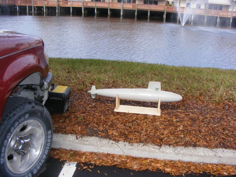

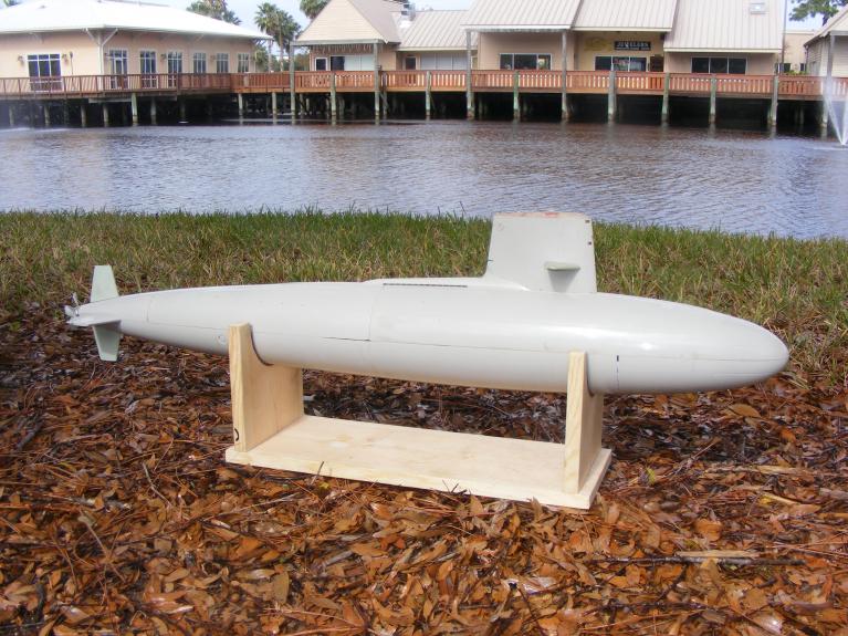

                                Good as my word. Look at the pictures first, then I will tell you of my adventures.
