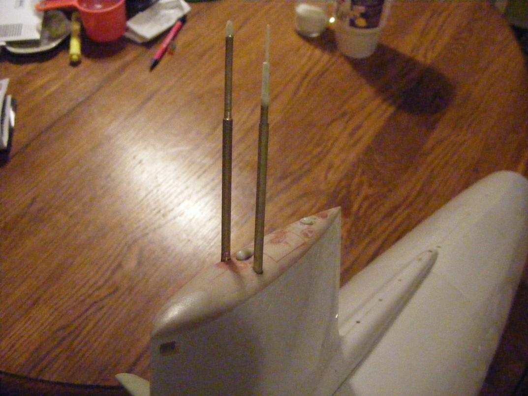

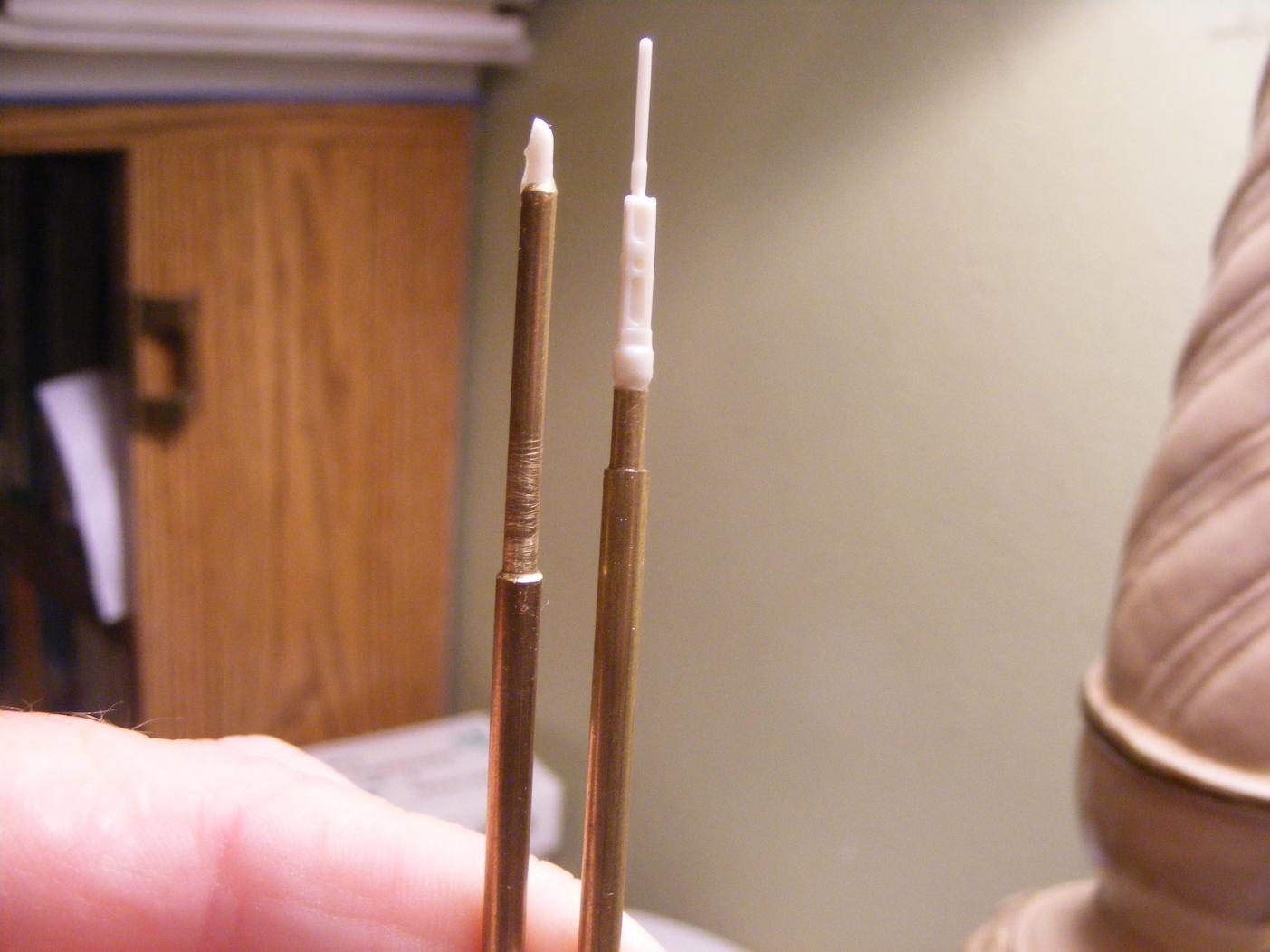

        Its quite obvious to me that the factory periscopes arnt going to cut it from a durability standpoint. Fast water will almost bend them in half. So, using some brass tube and just the top portion of the factory periscopes I have constructed and installed a reasonable but more durable facsimile.

          #439
          Will that extra weight up high cause problems?
            • 14014
            #440
            Go to aluminum instead of brass. To limit the topside weight, as Tom suggested. But, also because you want those scopes to bend when you hit something with them ... AND YOU WILL!!!! Better the scopes fail than the sail get knocked off the hull!

              #441
              Nice job on the scopes but actually Mark the kit ones on the whole are pretty durable. Sadly though the thin aerial atop the scope will be the first casualty That would be one that shoud be replace with aluminum wire or such.
