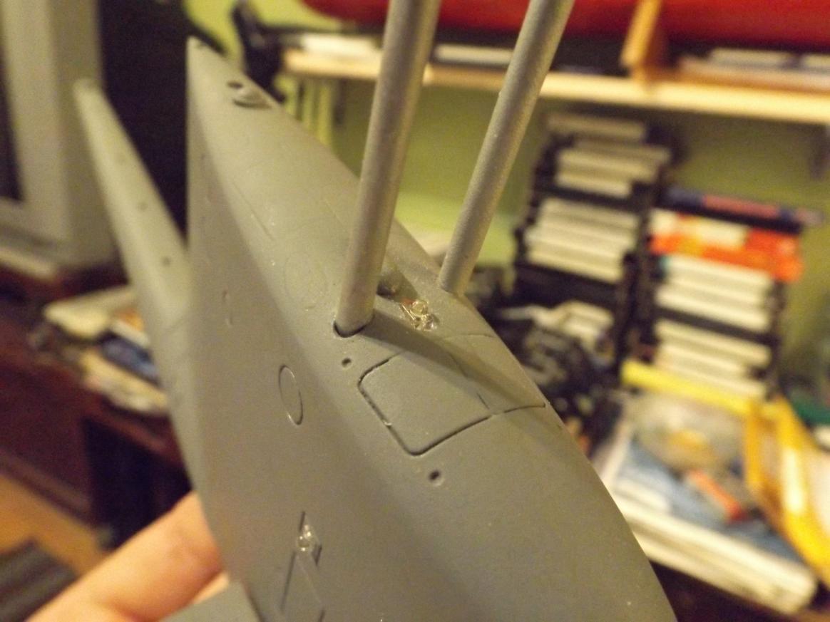

          Speaking of alummminnuuunium powder ... Click image for larger version

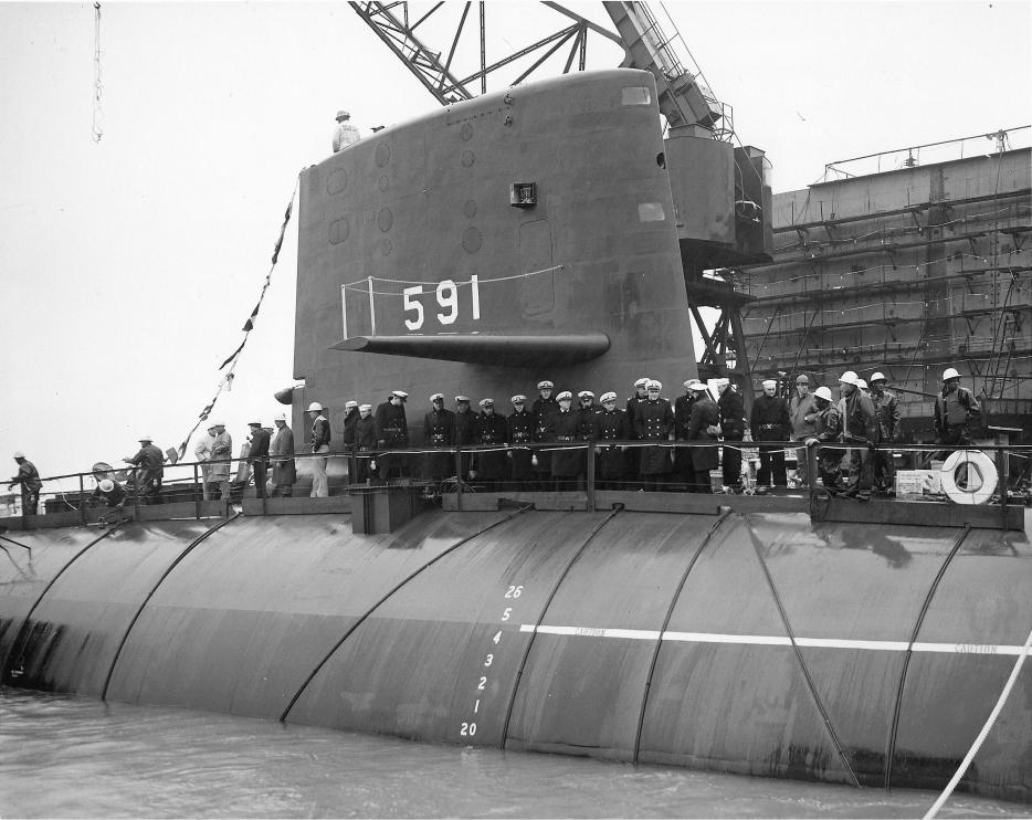

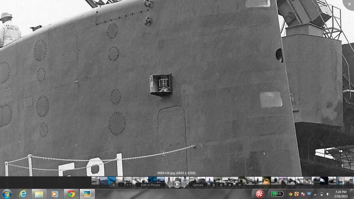

            Notice this picture. The marker light is inside this huge hulking fairing that will cause all kindsa drag. I think that there is one in the photo etch kit available from Caswell. I dont know if I want to do that. Also, with the snorkle valve taking up most of the room inside the sail in that area, I dont know if I could get LED lights in there. We will have to see.

              Here are a couple of closeups:

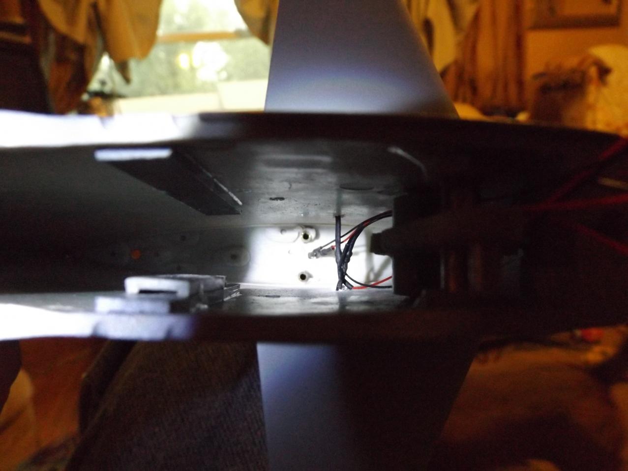

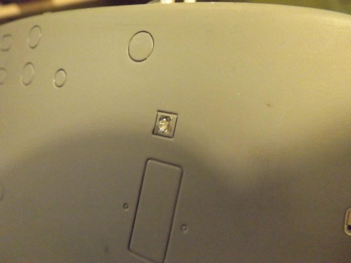

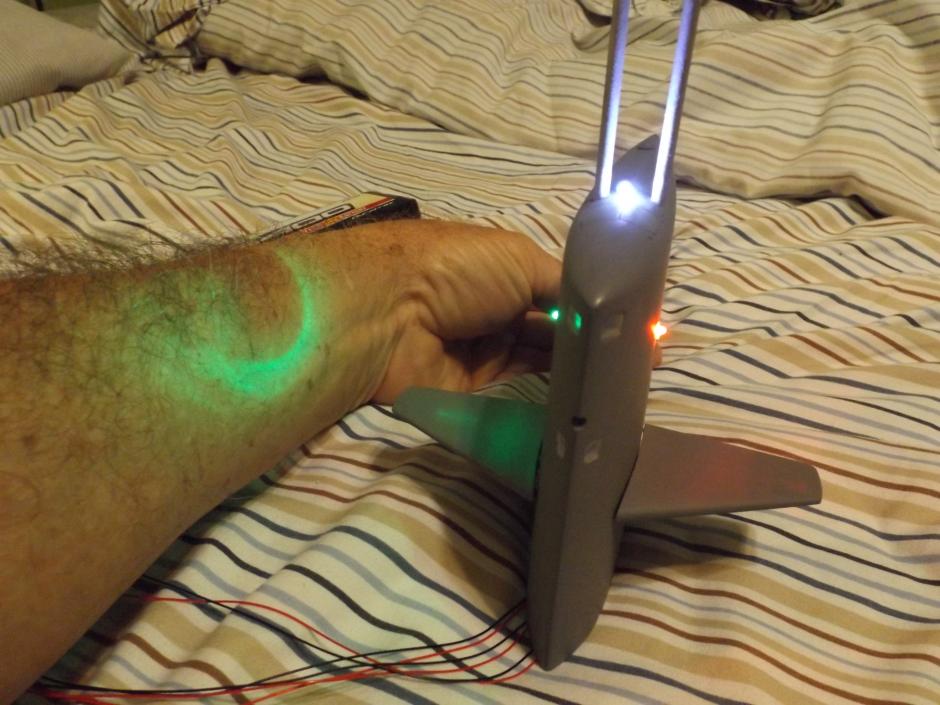

                              I got the LEDs installed in the sail. That will help with visibility underwater. If the sub gets lost then the LEDs will help locate it. I used a jewelers file of the square cross section variety. With care I was able to make an opening that is an interference fit with the rectangular shaped LEDs. That way they dont need to be glued. With the installed resistor they are good for 13 volts. Just right for the main power of 3s.
