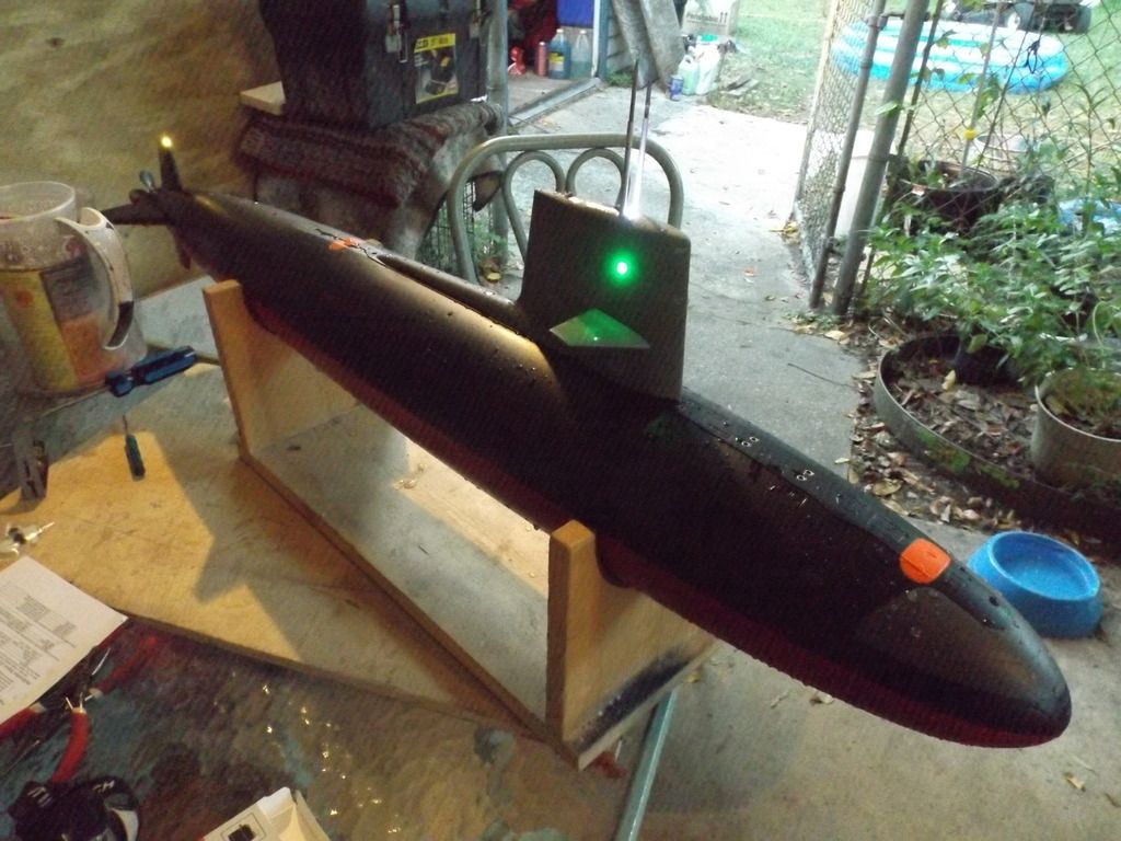

              Love the paint job Mark ! I assume that it is a Pacific boat based on the colour of the sail ??? No wonder those things are fast that prop is all business !
              Peter
                #637
                If youll recall, I almost lost it last time out. Now with this paint job, itll be even harder to see. Thats where I am hopeing that the LEDs will shine thru the inky black water and betray its position. That way Ill feel more in touch with it and let it move out without undue concern.

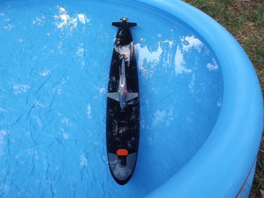

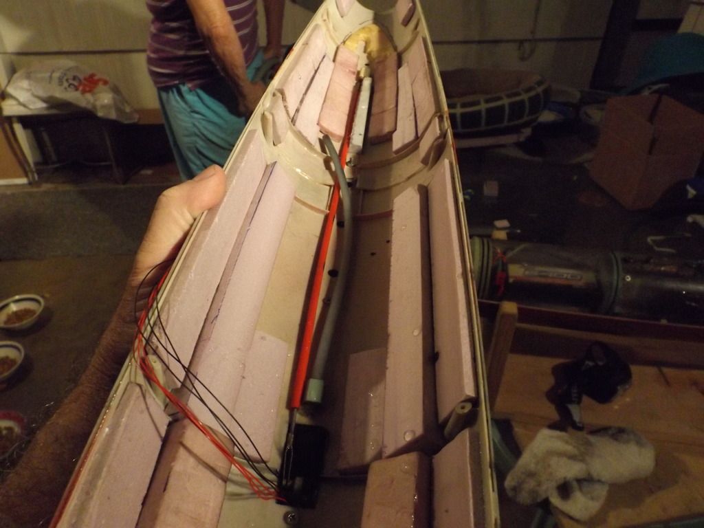

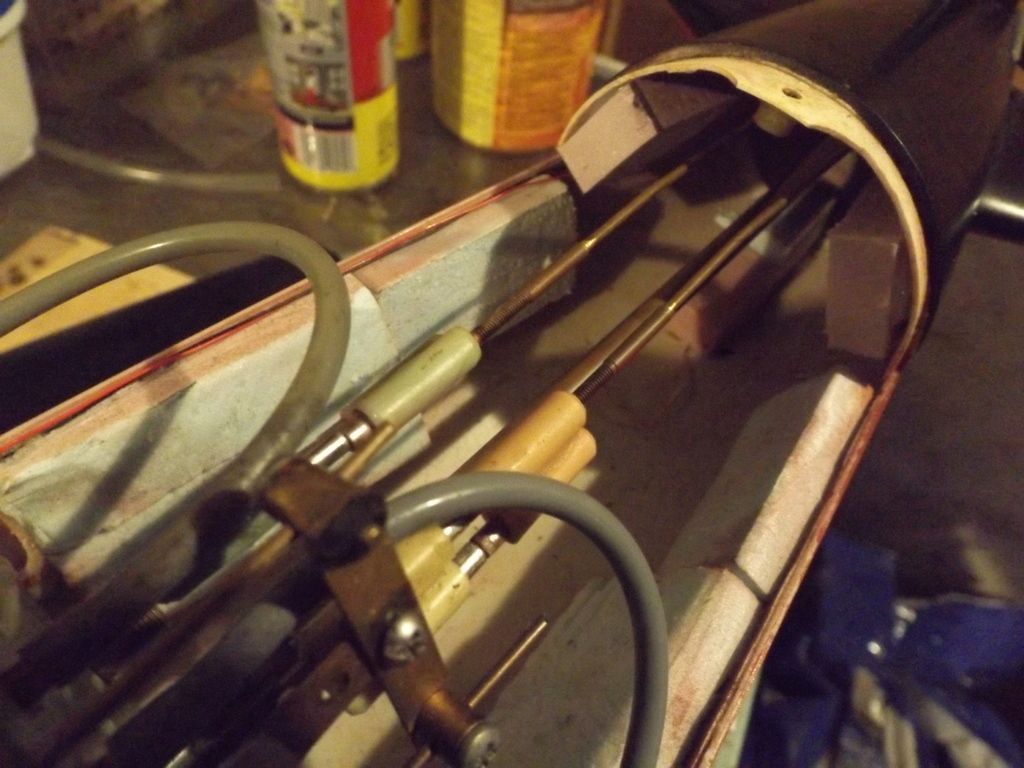

                  This afternoon I got her into the kiddie pool. It was not without incident. For some reason, the rear planes servo lost its centering capability, so I cut it out and replaced it with a similar sized Hitec metal gear servo, HS-82MG. Ive had very good service from these little guys over the years. Just install and forget about it. I think that this servo works in reverse to the servos I was using, I had to re-calibrate the ADF2. Then the hose blew off of the gas ballast back-up. So much for a quick easy trim job.
                  Because I added quite a bit of weight to her keel, it was soon apparent that I needed more foam. So tonight I added foam in various places. Tomorrow morning we will pick up where I left off from there. I am pleased with the brightness of the four LEDs. I am sure that it will help me to keep up with it in Duck lake.

                        I have outfitted this boat with a lot of foam. More of necessity than by design. I am still fine tuning, I wont put it away until I am happy with the set-up. We cant have it torque rolling.

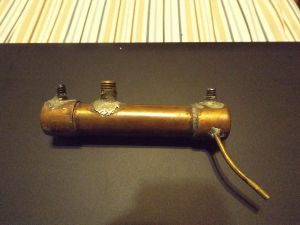

                            Also The Onboard gas copper reservoirs that you were making for your Sub-drivers. When I took one of them apart, I noticed at least on that particular one, the small output line was pushed all the way up inside against the roof. Is this to keep only gas, not liquid from coming out?
                              #644
                              Here is a picture of my home made shade-tree gas back up copper reservoir. Its only 1/2" pipe, to keep from taking too much volume away from my ballast tank. Remember this is an SAS system, Well my gas backup system did work but, as I discovered , it had a few flaws. One was that the outlet line was just that.....an outlet. According to Dave, it has to serve as a stand pipe as well. So it should go up inside all the way to the top, to keep, as much as possible, only the gas that boils off the liquid propel from going out into the ballast tank. He explained that if liquid goes out it can explosively damage bulkheads, not to mention , waste gas and give you far fewer blows. Well I didnt have any problems with damage but I did have only a few blows out of it.......which did cause me to almost lose the boat. Well also, Ive had problems with the hose from blowing off of the tube......repeatedly, so here I am to address those issues. Ive extended the tube all the way up inside as far as it will go and Im going to rough up the smooth surface of the tube to grip the hose more securely.
                              Also, I did not have a atomizer in the line. This helps slow down the gas entering the ballast tank. Im going to make one and install it.

                                Nice soldering job! What did you use ... hot coals? Yikes!
