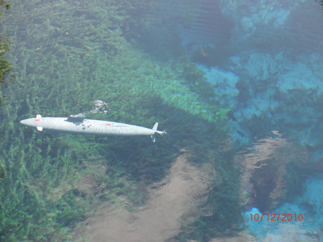

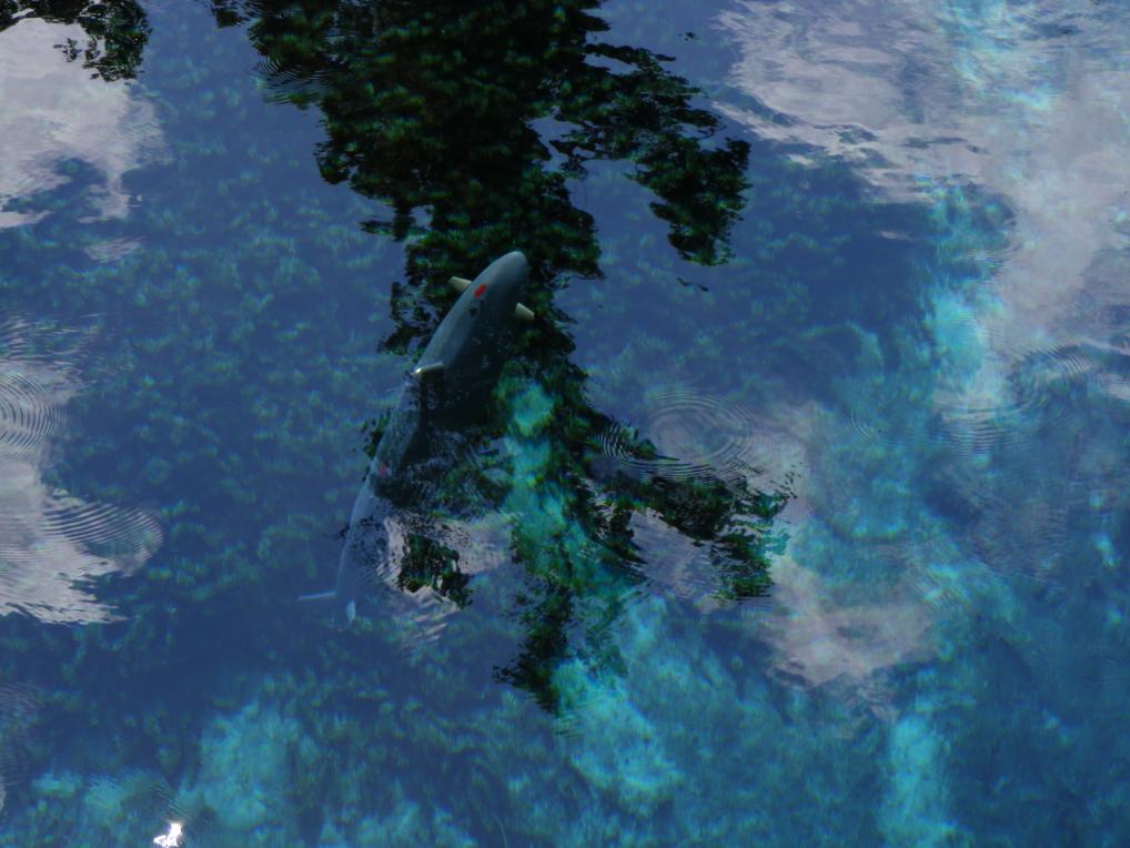

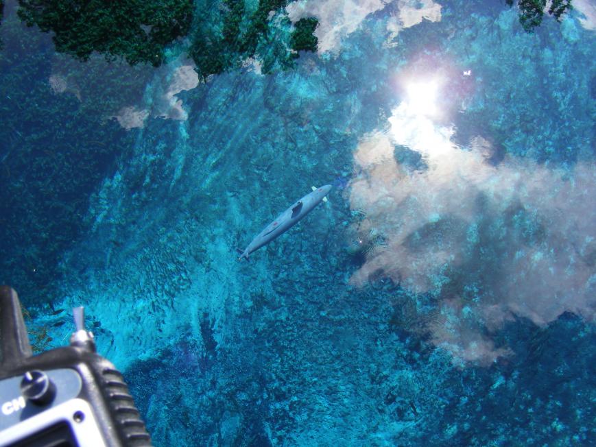

      Also I am pleased that I dont have a depth keeping problem like I had with the Albacore. You see, the Albacore now has two motors and two gearboxes and two propellors. Apparently there was just too much vibration to dial out and it was affecting the ADF too much, which was giving the highly sensative X-tail controls with their electronic mixer, too much jitter. What I ended up doing was moving the ADF up into the front battery compartment to try to escape those vibrations. When that didnt prove to be enough, I mounted the ADF to a thick piece of sheet plastic and then wrapped the plastic sheet in bubble wrap. The plastic ADF mounting board sits on top of the NIMH pack with a barrier of bubble wrap in between, effectively isolating those vibrations. You can see the X-tail stern here in these pictures. Now, the Albacore flies like the wind, like a thoroughbred straining at the starting gate, awaiting the bell. Another thing I like about it is the way it leans and banks into the turns. Very controlled and magical. Ill push the Scamper and see how she does and where that big sail will cause it to lose control.

ID:	89816 The Xtail gives extreme manueverability. Itll go straight up while spinning on its axis, howling its way to shallower waters and then dive straight down like a Banshee, until you lose your nerve and haul back on the stick like a fighter pilot trying to get an ME 109 off his back. Great fun! Of course you need deep clear water to do this. At any rate, part of the Skipjacks, or should I say the Scampers success in this is that its not an X-tail. Therefore, since its control surfaces are not 1/4 of the Albacores, its not so sensitive to jittering of the stern planes. Even so I want to keep them under control so that it doesnt develop into a problem. Like using the first hole on the servo horn closest to the mounting screw or no more than the second hole. Setting the ADF on the least sensitive setting.
