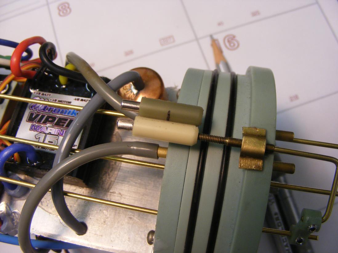

      Made this quick little bracket and CAed it in place. It helps a little but, I think that the bellcrank system that Dave used on the Gato Subdriver would be more suitable. To describe what Im talking about is that you move your stick three or 4 detents before it starts to move and then it jumps and catches up. Then you move about three or 4 detents more before it starts to move and then it jumps. Under the pressure of the water streaming over it I would think that it would be much worse. Not good for fine tuning periscope depth.

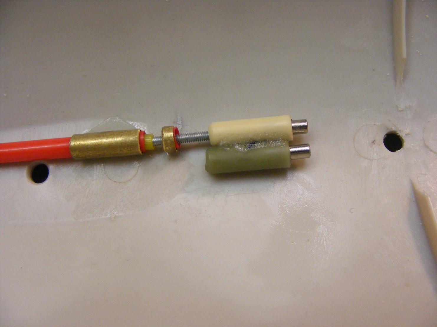

        Installed double magnets and a couple of sleeves to prevent unwanted movement during separation. Ill also move the pushrod engagement position on the servo horn from the third hole into the forth hole to see if that helps dial out some of the delay of movement of the planes when prompted. I can always dial back on the endpoints in the radio to prevent too much range of movement. Another thing that I noticed was that the aluminum tray that all the servos and stuff are attached to also has a tendency to flex and move when the servos operate. This will call for installing a gusset or two to stop that sort of thing.

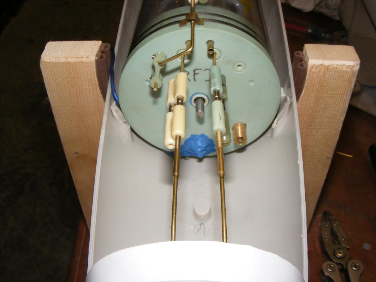

                    Dual magnet setup on linkages. When I put the top of the rear section on it, by design,it pinches the control surfaces. You will probably need to do some work here to prevent binding. I used a baby rat tail file and open up(a little bit) the holes that the dive planes shafts go thru on the plastic hull. You dont want to open them up too much because then your planes will flop around. But if you leave them as they are they will bind. You may have to tweak the white metal yoke that attaches your dive planes together so that the planes are perfectly in line(up and down, left and right) so that when it rotates it doesnt walk out. Also you may have to grind a little off the inside of the hull at that point too if the yoke binds there.Click image for larger version

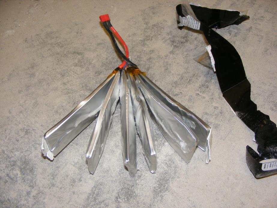

                            Not to change the subject or anything but, here is a 3 cell LIPO cut partially open. Note that there are six distinct sections. Apparently two together make one cell. This seems probable since each two are insulated from the other pairs. The silver is apparently aluminum foil.

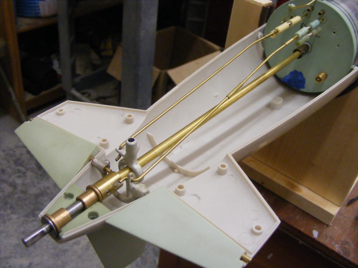

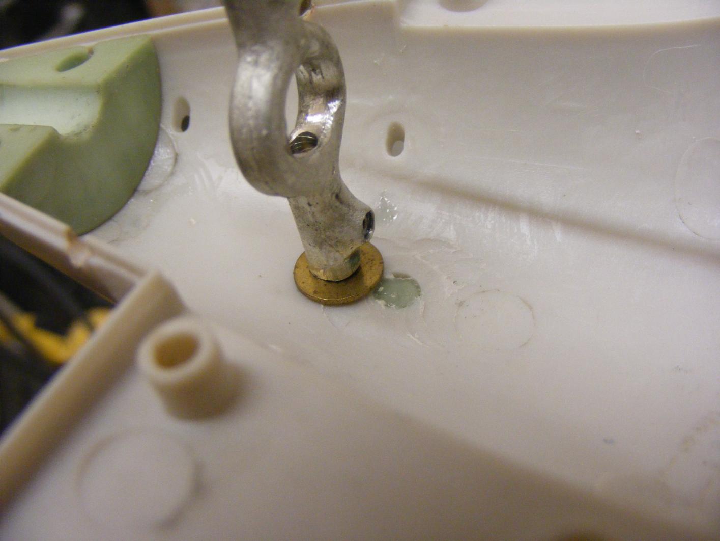

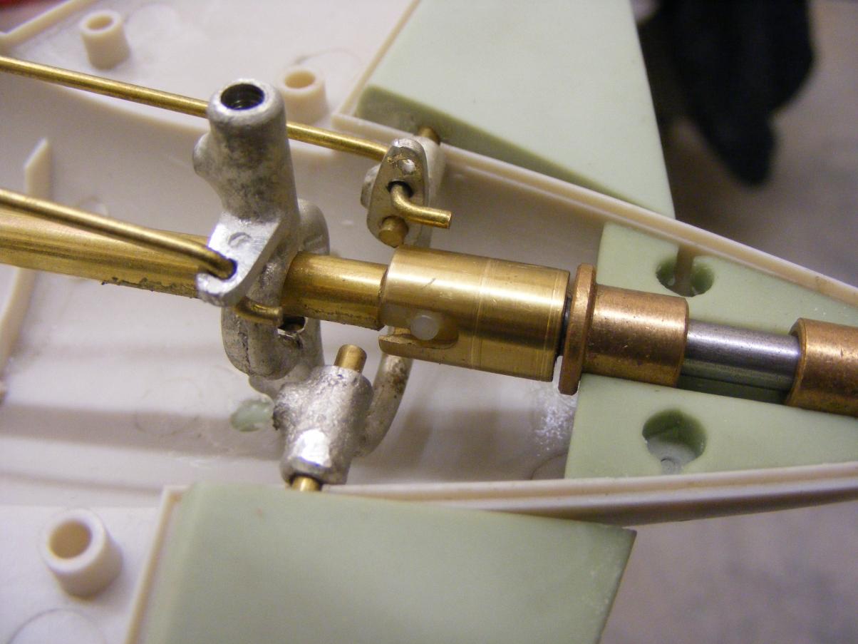

                              Here you can see Im making up the drive shaft. The tube used here is a brass 7/32". I cut mine at 8 and 1/2" long(actual brass length). Yours may vary due to exact placement of your subdriver. I make mine up to where there is just a little bit of slop between the Dumas teflon end and the brass drive dog. As my previous practice has been Im going to drill thru the shaft at the teflon ends(Dumas) and pin it with a small dia. brass wire and CA the wire to the brass tube.. You see, CA and Teflon dont cooperate well with each other, I have had these come loose before, thus this practice. A little insurance. Also, while I was at it I noticed that the white metal control yoke for the rudders sits too low in the sub.Checking clearance with the underside of the top cone, I installed this brass washer underneath the yoke and that took care of it. We dont want the yoke rubbing on the spinning drive shaft and at the same time restricting rudder throw. Also its nice that Dave has made flat spots on the control shafts. Less chance of them coming loose. Dont forget to blue loctite all the grub screws. The Allen wrench that fits them is tiny. .050.

                                Notice also in this picture that I have bent the pushrods so that the magnets meet in the same plane for better "stick". Also, its just "good form". Youll also notice the "band-aid". Yeah. When you goof and get your length wrong on the pushrods that you cannot adjust out, just cut them and splice it back with a piece of 3/32" brass tube. Set it at the right length and then a drop of thin CA at both ends will hold it fast. Mums the word.
