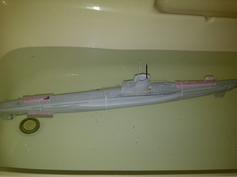

                the sub has officially been wet! first I had to re arrange all the plug in's to the RX as my old radio (a converted 35mhz) is backwards too Daves.
                this was as it first hit the water ... no foam other then in the "saddles" .. dunno if you can see it but it's stern heavy
                also discovered that the hosing for my SNORT was backwards LOL ... instead of rising my sub turned into a squirt gun ... the kid loved it, I just kinda stared at it sideways for a moment till it hit me... the gas backup however worked nicely and brought it back up ...
                heres basically what I came up with the foam needed... actually it's a little MORE then the sub needs... and I'll explain in a sec ..
                near the end of trimming I lost my rudder ... going nuts and fearing the worst I scooped the sub, stripped the foam and bands off the outside .. peeled off the top and started examing the SD expecting to see the engine/elec compartment full of water... it was bone dry (YAY) ... and then it was dinner time .. so the sub's been sitting on the counter for me to come back and resume ... I also would like to get some answers to a couple questions before I go back for the final tweaking to foam
                so Dave.. and any others:
                - how much of the tower should be sticking out of the water at full ballast (I do understand the slightly pos boyancy part.. but generally how much should I be aiming for?)
                - does the amount of foam appear to be excessive? as in... did I put a bit too much lead in the keel?
                - my auto leveler is backwards? ... when I tilt the nose up the rear planes go "down" aka to make the stern go down and make the sub go up... instead of trying to force the nose back down and keep the sub level?
                I also found out the hard way that the beauty wood deck wasn't sealed on the bottom side and had become water logged... so gotta let that dry out.. hopefully not crack all to hell and get the bottom side of it sealed

                  For starters work out submerged trim with about half of the sail sticking out of the water.
                  Yes, excessive.
                  If you're using the ADF-2 go through the set-up ... and this time read the *** instructions! If its the older ADF, you'll have to flip it within the SD.
                  That wood deck was a stupid move! Go back to the plastic.

                    Reckless - the stern is heavy submerged, is it still heavy with an empty ballast tank? If it is not aft heavy then your foam will go above the water line. Is it too much that you have there? I cannot say, but if it gets her level (submerged first, then surfaced), than I would say it is not too much.
                    As far as how much positive buoyancy, first your Snort has to be above the surface of the water, that is why I ran mine up the periscope to get it high. Then I have found that the closer I get the conning tower to the surface, the easier it is to dive (less thrust needed). If I have too much positive lift, it takes a lot of forward thrust to get her down and stay down. However, I have found on my Gato that even a 2-3 foot depth can make your slightly positive sub a negative buoyant sub (compression of foam and slight flex of tube). There are trade offs. So, make it more buoyant then add weight to adjust for the type of performance you want.
                    I am speaking from my recent experience, but I would ask David to correct me.
                    Last edited by trout; 05-20-2012, 10:45 PM. Reason: spell check made ballast into ballet

                      - will do
                      - alright.. I'll remove some lead
                      - alright alright .... wasn't important at this moment so I hasn't dug to far into it
                      - it was how I got it... wood deck and photoetched bits... didn't get the original plastic ... so I'll figure it out.

                        trout- sorry missed your post ... was probably as I was writing reply to Daves post...
                        the stern was heavy with no foam (other then in the saddles) with an empty tank... was just the initial throw in the water to start trimming...
                        the reason I asked if the foam was excessive (and Dave replied that yes it is... ) is I looked in the stern and fitting all that foam would be ..well... not impossible.. but damn near.. LOL .. just means I put too much lead in here keel I will have to take some out to lessen the amount of foam.
                        as for depth and foam .. yeah I can see that... for first trials in open water I will probably go a little more boyant than really needed and play from there... 2-3ft is probably the max depth I'll take this thing too ... and it won't be that often LOL .. my normal running place is fairly shallow, but it's also crystal clear. no pool runs around here.. and the couple other places it might visit are really murky water so diving past periscope sticking up just isn't gonna happen.

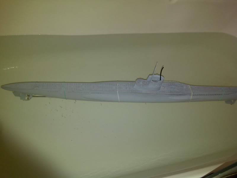

                            hit the tub again ... MUCH better ...
                            even managed to get a submerged trim in
                            now the conning tower ended up being a little loose in the shot... so it sits a hair lower down the tower then in the pic
                            so ... into the "home" stretch :D ... start buttoning the hull and stuff while I wait for a new servo ........

                              Excellent trim work! Well done.
