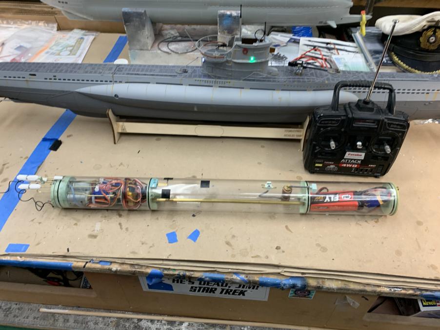

      Still a workin on the U-Boat. I'm not use to the Subdrivers as I built many of my own cylinders and used most BigDave RCABS. I do like this concept though. No bladder, pumped and snorted and best of all, no gas!
      It didn't take long to assemble David's new (to me anyway) WTC. Works like a clock when finished and Bob Martin was always there for me to answer my questions via text messaging.
      The build is moving quick and I figured before I went too much further I should assemble the WTC and get it in the boat working.
      I love the fact that the entire forward compartment is battery alone. Nice large ballast tank too. The APC works amazingly well. It can be mounted anywhere even on it's side and it zeros at start up and maintains level throughout.
      Very pleased with this build. Few problems encountered that could be fix easy and all in the kit. Not the WTC.

                    A bit more work still. I got the snort valve setup to fit inside the tower near the hatch. I had to remove some plastic inside for the scope tunnels. This meant I had to rip out some of the lighting wiring. In hindsight I should have mounted the valve first. Will reroute and clean up the wiring. No big deal. Now that all the business work is done I can finish off the cosmetics and call this boats done.
                    I did install the pigtail water tight cable for lighting in the forward compartment of the WTC. And yes Bob I will put in that brass tube and fuel tubing for linking testing. ;)

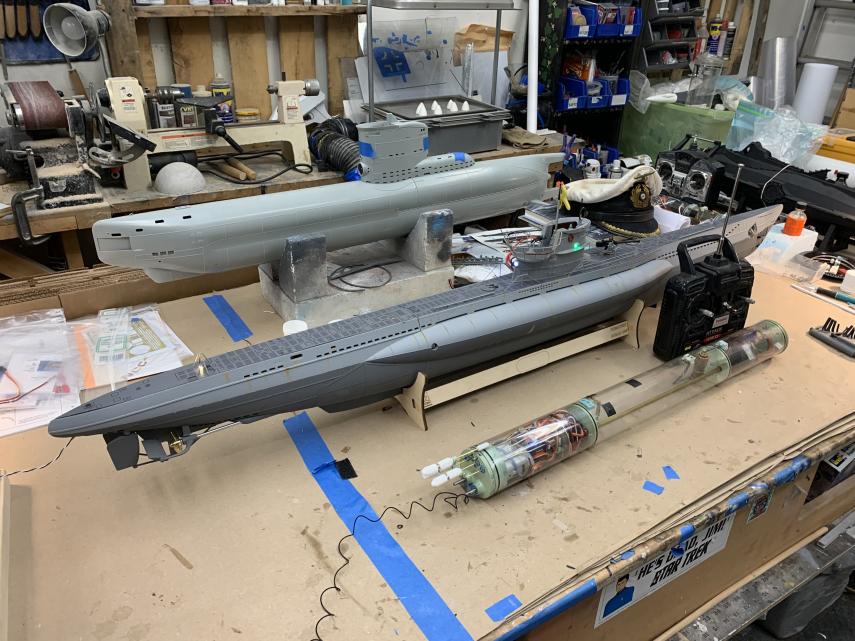

                    Started fiddling a bit on the Nautilus. I have built four of these now for customers this one is for me and will have all the bells and whistles. She is tiny but these run like bigger boats and are a real joy. Type 23 in the back will get the razor cut deck opening next.

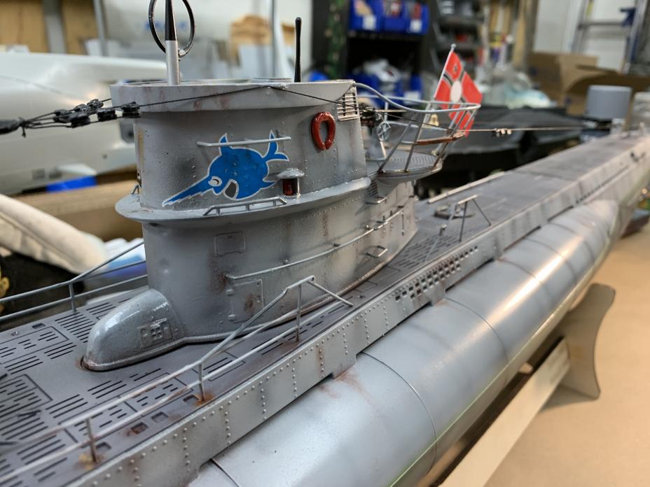

                            Thanks Rob and Darrin! Yes it is like the good ole days of building. I missed it. The hat is a www.warhats.com authentic reproduction hat of theirs. It was a gift from a few years back. I got two of the flotilla hat pins from U-96 yesterday from them. I realized I had inadvertently did that boat when I painted it. The Sawfish is on the left side of the tower.

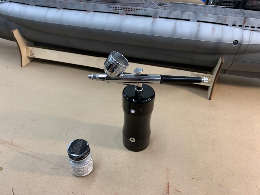

                              I got this new little handheld self contained airbrush to add to my ever growing collection of airbrushes. For 50 buckets this is really nice and perfect for touch up and weathering. You are free from noise and a long hose. The double action I have never got use to but I'm trying now. As a result my attempts to weather this boat are a bit heavy handed for my tastes. I'll be toning this all down as soon as my Vallejo rust kit shows up: https://www.amazon.com/gp/product/B0...?ie=UTF8&psc=1 .
                              She's cleared coated and ready for hot tube trials tomorrow. Ballast and flotation in. WTC tested and no leaks found. Tight as a drum. I'll be shooting video of the timing session for your amusement.
                              ​​​​​​​Got a Type 214 inbound I'll be building for a customer. Due in next week I'll start the Nautilus next in the interim.
                              Airbrush can be had here: https://www.amazon.com/gp/product/B0...?ie=UTF8&psc=1
