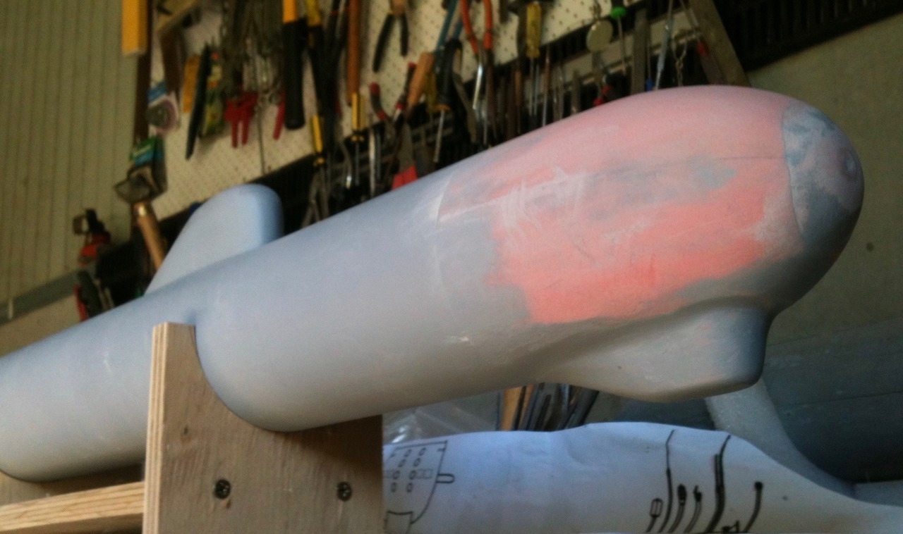

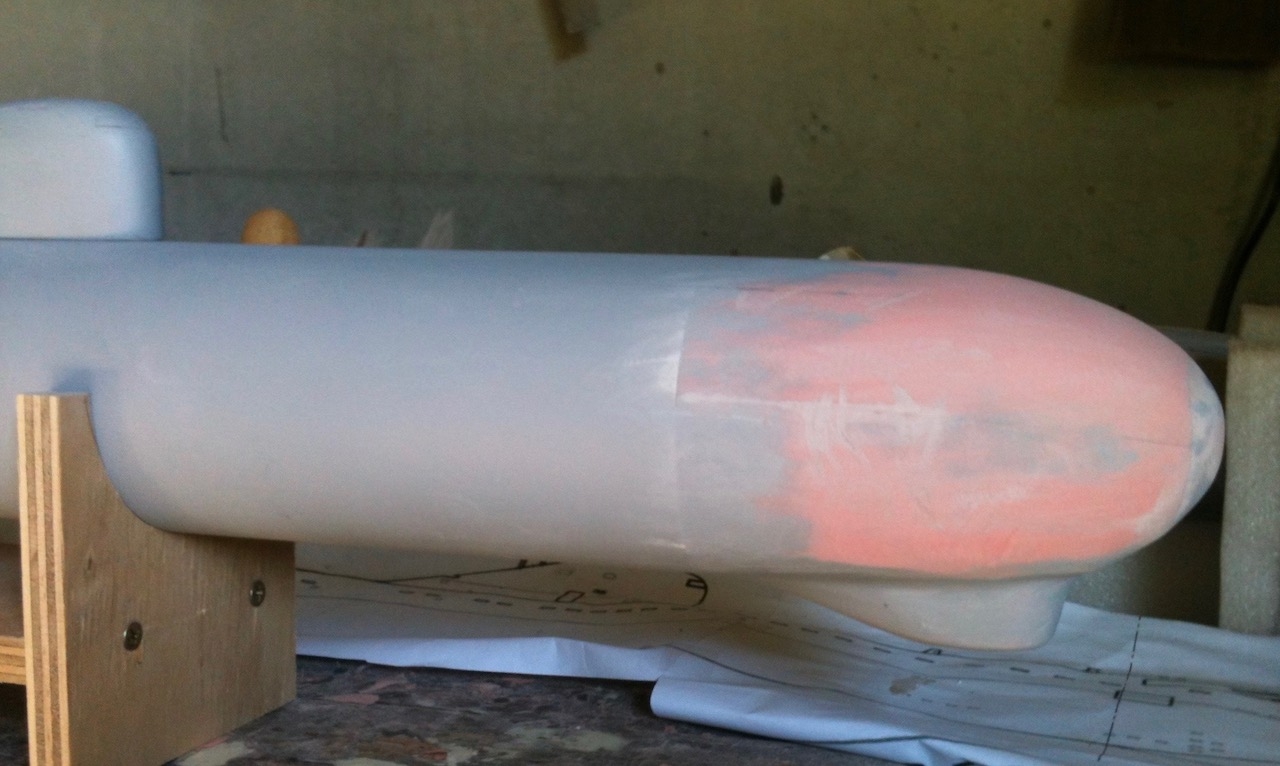

    Jörg, this looks a little better. Still sanding out the bumbs but the basic shape seems pretty close.

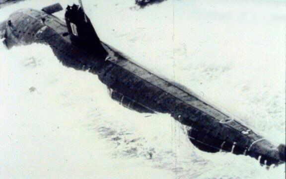

                    Let me make an atttempt, knowing that you and Jörg might already be well supported with good material. Click image for larger version

                      Another. Note however that this is the 645, (half sister). Click image for larger version

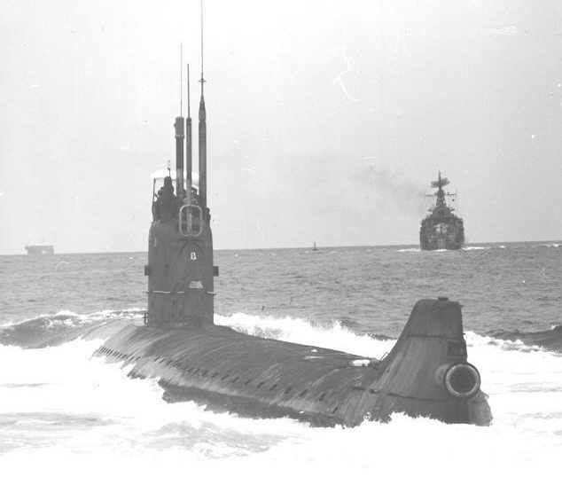

                        And a third. Click image for larger version

                        This seem to be the inspiration to the boxart for Zwezda model in 1/350

                            Thanks Fredrik. Great photographs and definitely well worth the digging. This gives me a much better idea of how the rear deck should look. I'm also feeling a lot better about that fat tail.

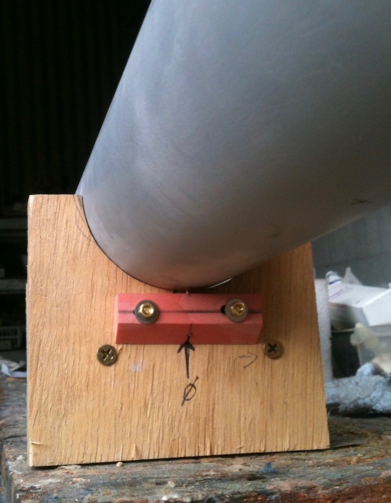

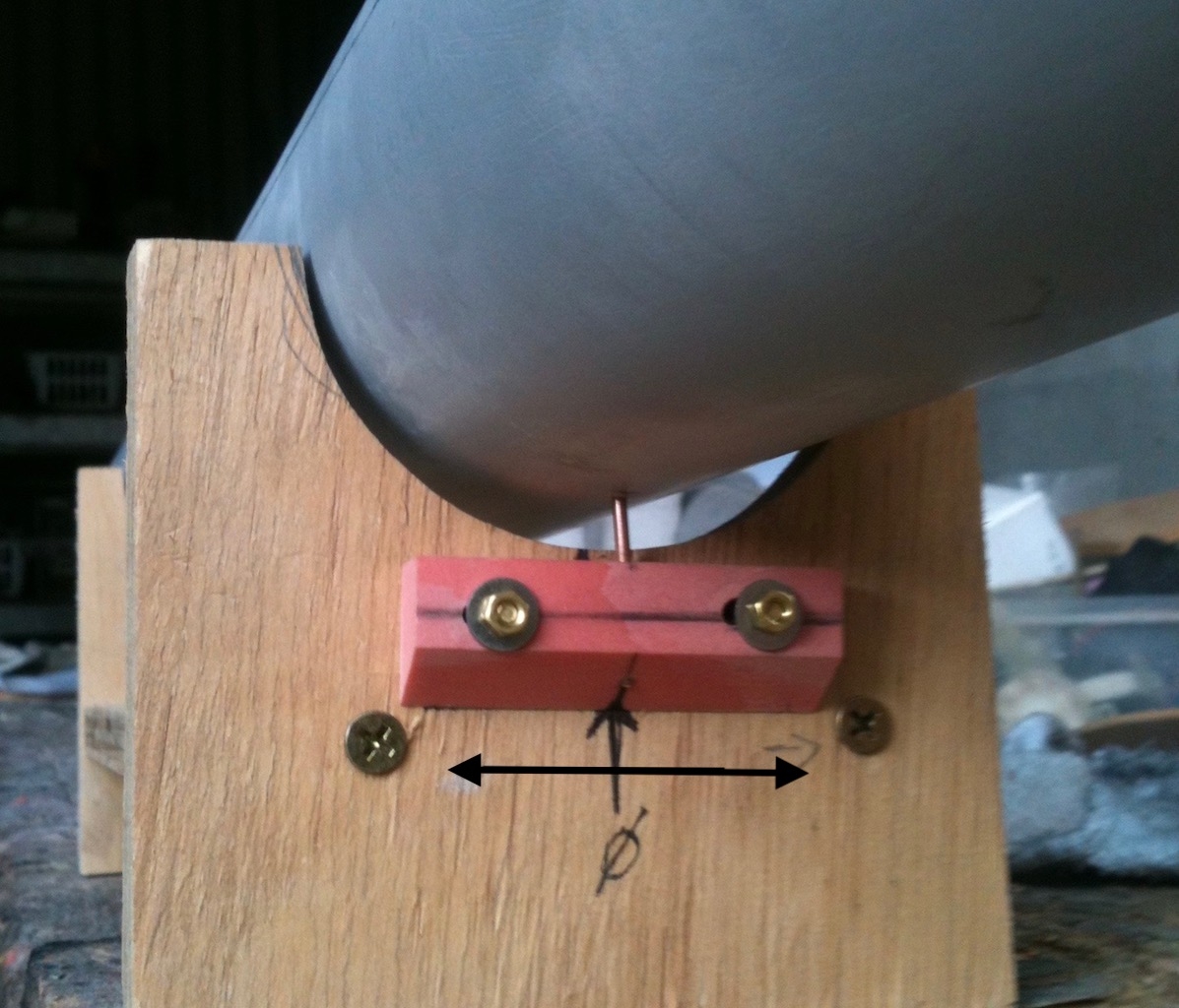

                            I'm getting into a bit of refinement now so I have to make sure that everything lines up and all those lines are true. This is a little adjuster made from a bit of left over renshape. It has a vertical pin that locks into the submarine centre line datum. The cradle is square and flat so once the sub in locked in and centered, everything is in alignment. A quick check with a level every so often is all thats needed to keep everything straight. (That's the theory in any case).

                              really like the bow now. cannot see if you already added the flat deck upon it. i would mark the bow plane recess first and then model the deck as the recess follows the same courve. by the way, anyone knows if these flaps were left open when the bowplanes were extendend? i know there is a half-hole on the upper and lower flap that should let the shaft pass through when the planes are out, but i have only seen pictures with bow planes extendend and open flaps. Tirfing, the 2nd pic shows a 627 i believe. 645 would show a triangular-shaped bow and the sail would be much longer. enough klugscheißing for now ;-)
