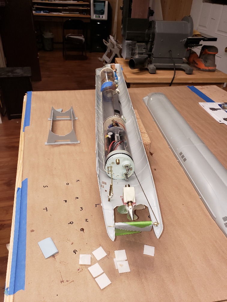

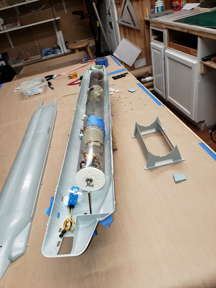

ID:	128123 OK this is a test email photos from my cell to my laptop down loaned all photos

      David I have tried to separate the hulls this way, the way Bronco makes them, have you tried this way before , this is the wrong WTC just for test
      Bill
        #33
        Bill
        No, Bill, I have not tried that -- on anything. Dumb move. RTFI!

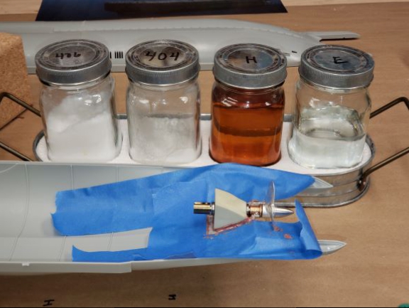

ID:	128131 Here you can see that I used West System Epoxy to secure the Propeller shaft stern tube assembly Bill
              Good, clean work. And it looks like you resolved the photo issue, Bill.

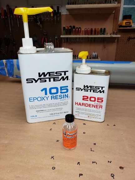

                  #38

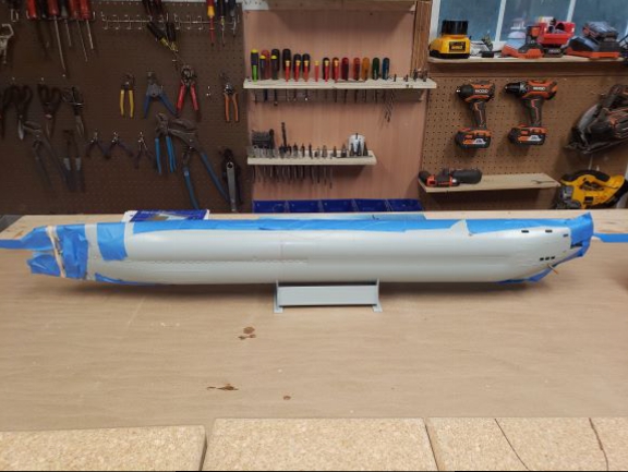

                  Here I glue the two hulls together with Plastruct Plastic Weld goes on with a small brush . Make sure you snap the half's together all along the keel and deck, let sit over night Click image for larger version  Name:	24.jpg Views:	1 Size:	154.8 KB ID:	128136
                  I did not take photos but I installed the rudder and the rods for the bow and stern planes,will take photo when I cut her open tomorrow

                    #39

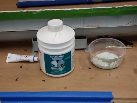

                    Here you will see the glue and Epoxy that I used for the hull and Stern tube assembly
                    Yes David have my photo problem fixed was just too large of a file Click image for larger version
                      #40
                      Tom put you straight on the photo-size issue -- took me months to figure that out.
                      Only use the cohesive cement on styrene to styrene unions, Bill. You get a proper fusion (weld) between the parts with that. And use stretched sprue and styrene strip as 'welding rod' to melt within and fill any significant gaps between parts being glued together.
                      And scrub all the plastic parts with scouring powder and water followed by a good rinsing. The injection forming process leaves oil on the parts surfaces and that will bugger up bonding and painting.

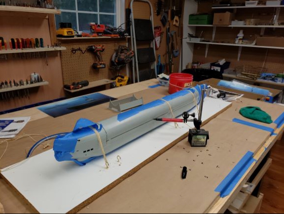

                                #45

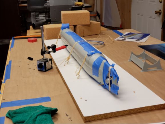

                                Here I set up my boat on a board, and marked my lines Click image for larger version
ID:	128146Click image for larger version
ID:	128147Click image for larger version
