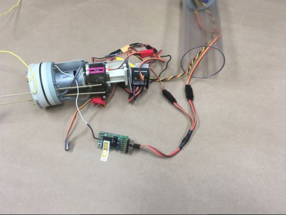

      You stated that channel 5 would be for ballast, did you mean that the Pump and the Vent via a two plug go to channel 5 one button for the Vent and one button for the pump?
      I got this from the Caswell site under SAS Sub-Driver, just want to make sure I under stand it right took photo but my cell has lost internet for some reason
      Are the Vent and the pump call the Ballast system?
      Bill

        Yes, a Y-lead is used to run the ballast servo and LPB (through it's MPC) in parallel. The input side of the lead makes up to the fail-safe (BLM) output.
        Yeah, let's see a picture of your wiring when you can get that phone-camera to work.

          #109
          Used my iPad this is what I have on channel 5 Vent and pump
                You got the right idea there, Bill. With the three-position switch in 'neutral' the ballast servo remains in neutral and the vent valve is closed, and the LPB does not run. With the button at the top depressed the servo goes hard over but the vent valve remains closed, and the LPB runs. With the lower button pushed the servo drives the vent valve open, and the LBP does not run. If need be, reverse the ch-5 servo direction to get the desired sequence of operation from the buttons.
                Set the ch-5 endpoints like so: Vent -- 100% servo travel. Blow -- 40% servo travel.
                I see you don't have a fail-safe between the receiver and Y-lead. Before this thing operated the Type-23 make sure you install such a device and set it up properly.
                  #113
                  …..….… And get some heat-shrink around that receiver before you shuffle your feet on the carpet, touch the bare side of the board, and blast those chips to smithereens!

                    Did you see my last photo did I do the vent and pump right?

                              Looks good Bill.
