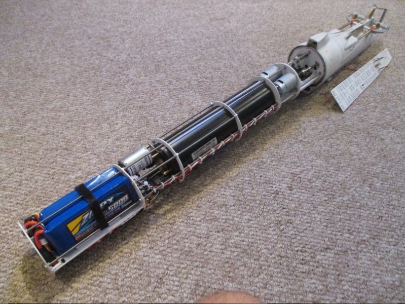

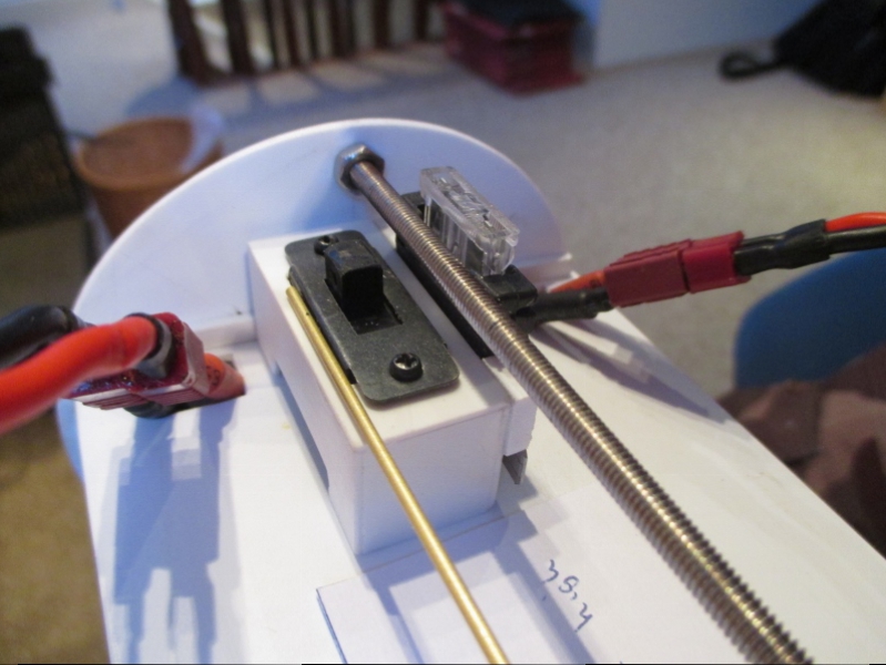

      Here is the start of the internal wiring. The main on/off switch is built into a styrene holder, and the main fuse installed beside.
      Click image for larger version  Name:	image_37433.jpg Views:	1 Size:	208.8 KB ID:	126634Click image for larger version  Name:	image_37434.jpg Views:	1 Size:	264.2 KB ID:	126635
      The on/off switch pushrod will have to run the entire length of the WTC, paper templates are used for the electronic components.
      Click image for larger version  Name:	image_37435.jpg Views:	1 Size:	279.8 KB ID:	126636

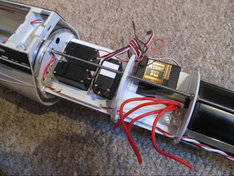

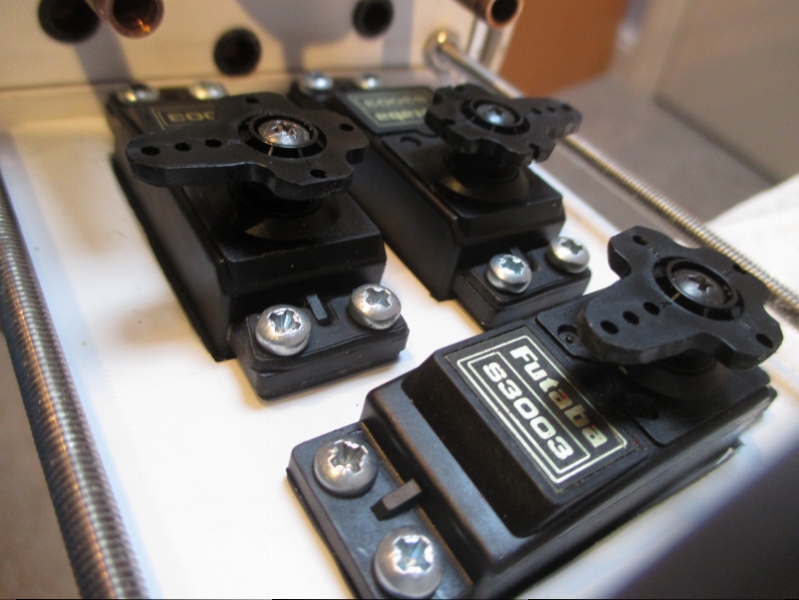

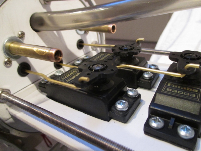

      The three servos are installed and pushrods added, the rear plane servo (the side ways one), needs to be dropped lower.
      Click image for larger version  Name:	image_37436.jpg Views:	1 Size:	277.0 KB ID:	126637Click image for larger version  Name:	image_37438.jpg Views:	1 Size:	284.0 KB ID:	126639

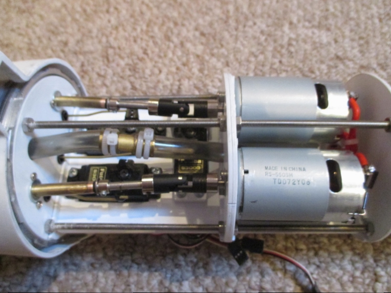

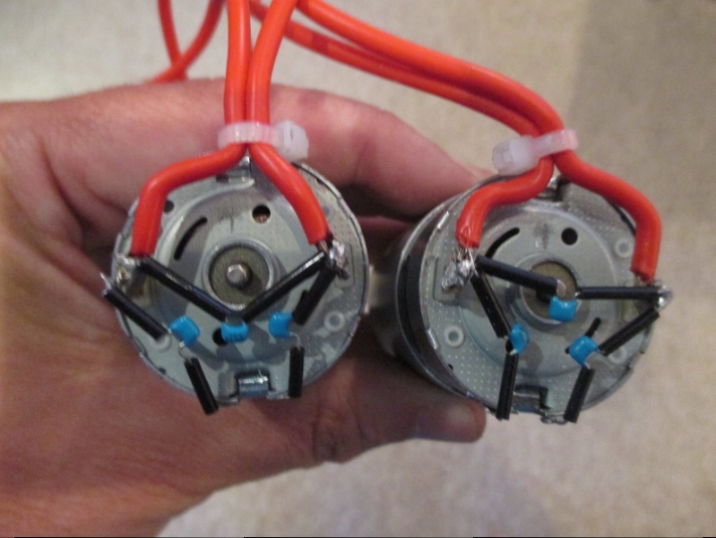

      The motors get wiring and supression kits.
      Click image for larger version  Name:	image_37437.jpg Views:	1 Size:	278.0 KB ID:	126638

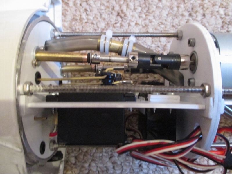

      This the rear end of the WTC, upside down, the price for the 900ml piston tank is very tight clearances around the prop shafts and servos, I added a joint in the water inlet as I have to take the servos in and out frequently to get alignment.
      Click image for larger version  Name:	image_37439.jpg Views:	1 Size:	294.3 KB ID:	126640Click image for larger version  Name:	image_37440.jpg Views:	1 Size:	297.0 KB ID:	126641
      Right way up, the wiring for the speaker and lights is led down the WTC towards the batteries, and there's just space for the Receiver, and the space beside the 4 block connector will take the pitch controller. The rear plane servo is sitting up against the top tech tack rod, the two pieces of plastic help hold it in place. The motor wiring comes through the floor and will be sorted next.

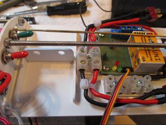

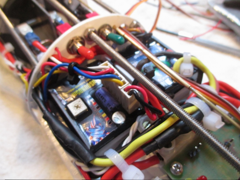

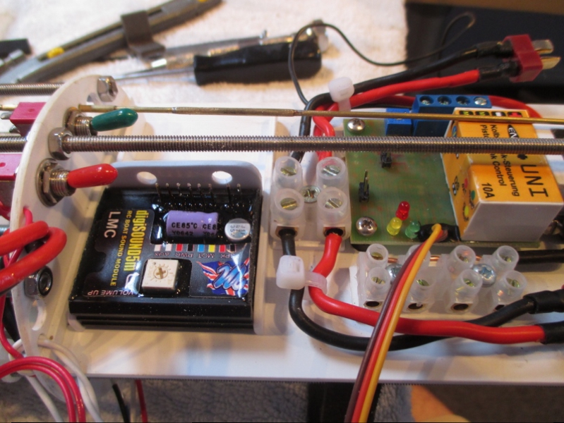

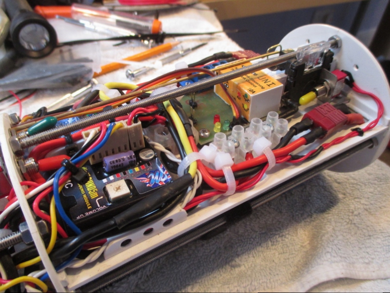

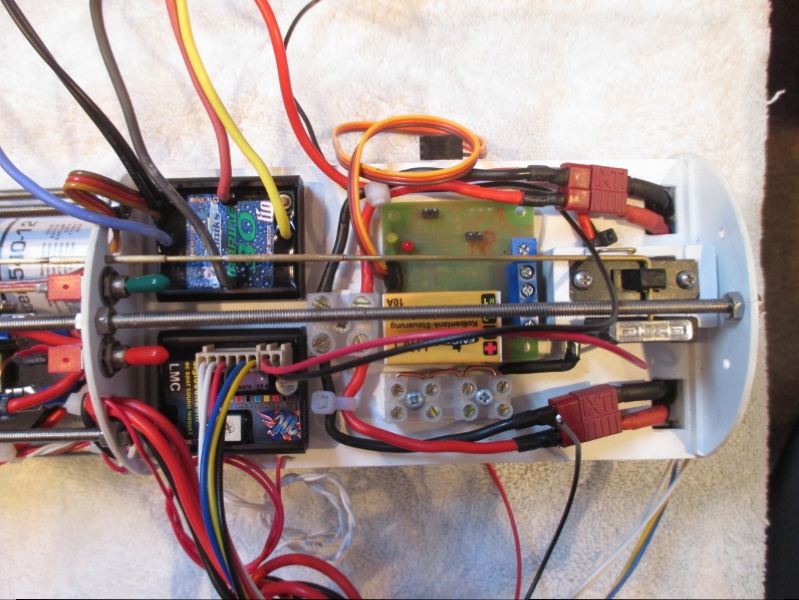

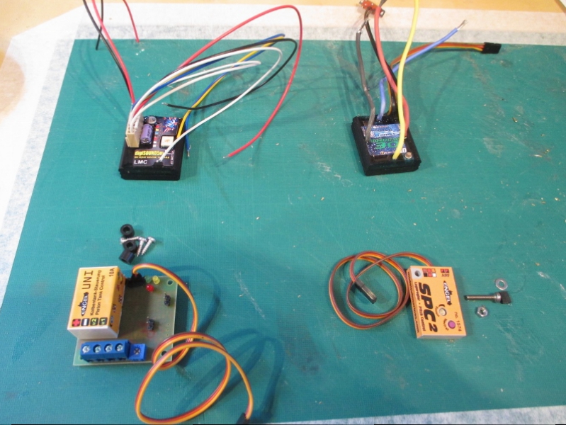

            Progress slowed a bit over the summer, but I finally got the electronics sorted.
            Here are the four modules.....
            Click image for larger version  Name:	image_37568.jpg Views:	1 Size:	329.4 KB ID:	127044
            Mtroniks sound, Mtroniks 40amp ESC, Engel Ballast Tank switch and Pitch Controller.

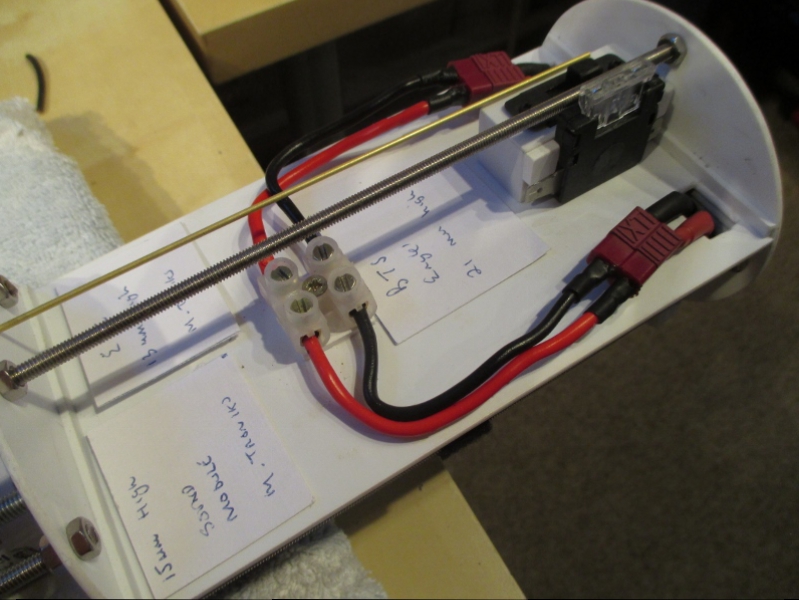

            They just about fit on the equipment tray over the batteries, the Mtroniks units are held in place with a plastic surround and the Ballast switch is screwed down.
            Click image for larger version  Name:	image_37569.jpg Views:	1 Size:	361.6 KB ID:	127045Click image for larger version  Name:	IMG_1716 (800x600).jpg Views:	2 Size:	338.3 KB ID:	127054
            Click image for larger version  Name:	image_37570.jpg Views:	1 Size:	287.4 KB ID:	127046

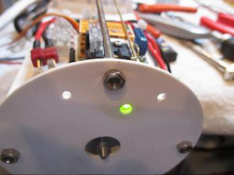

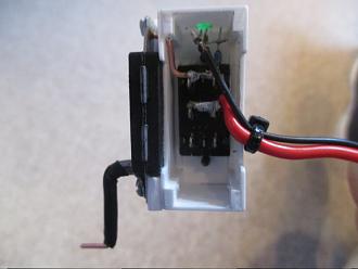

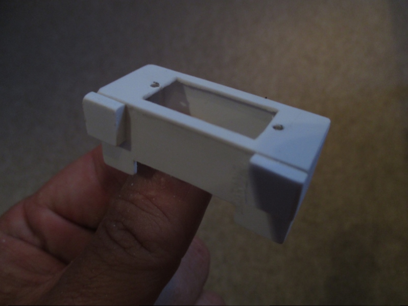

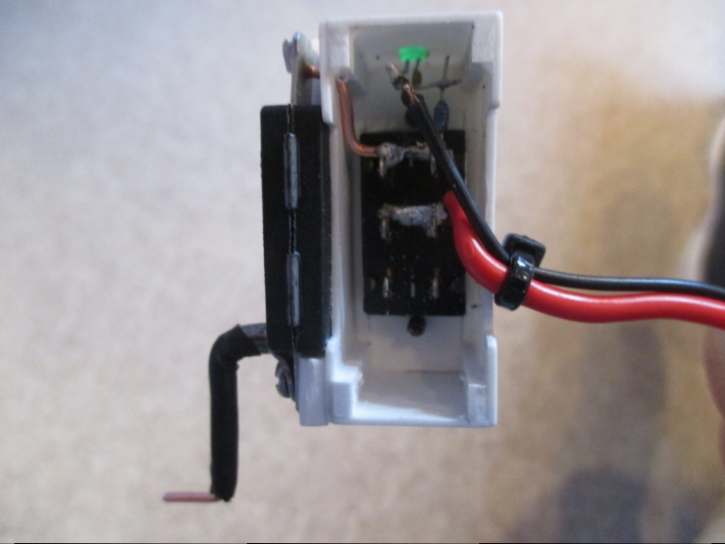

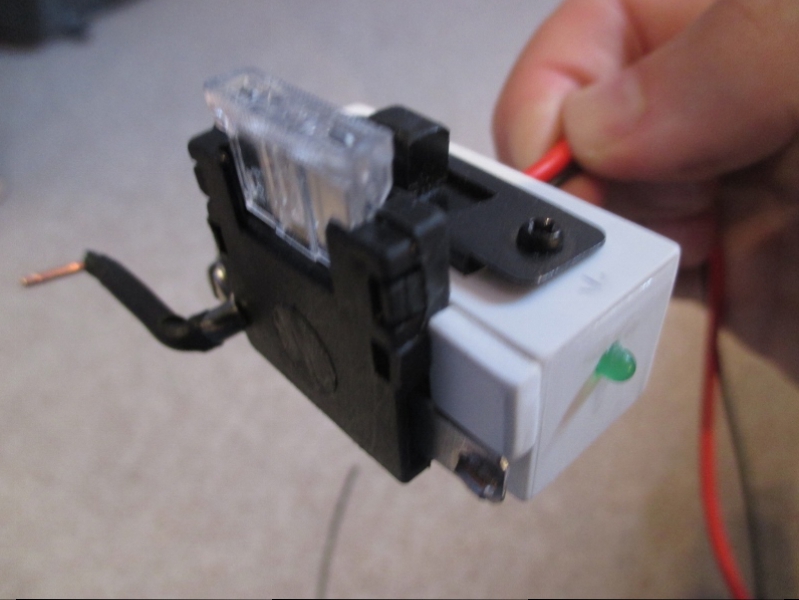

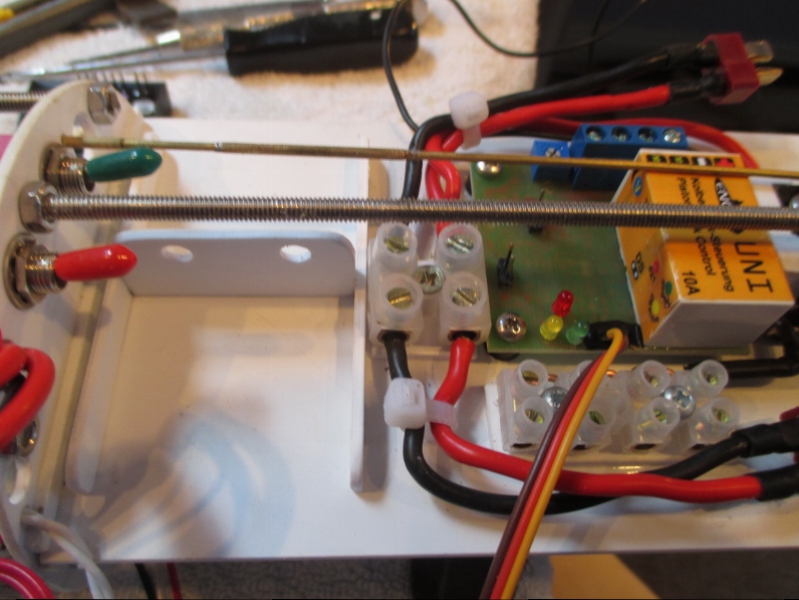

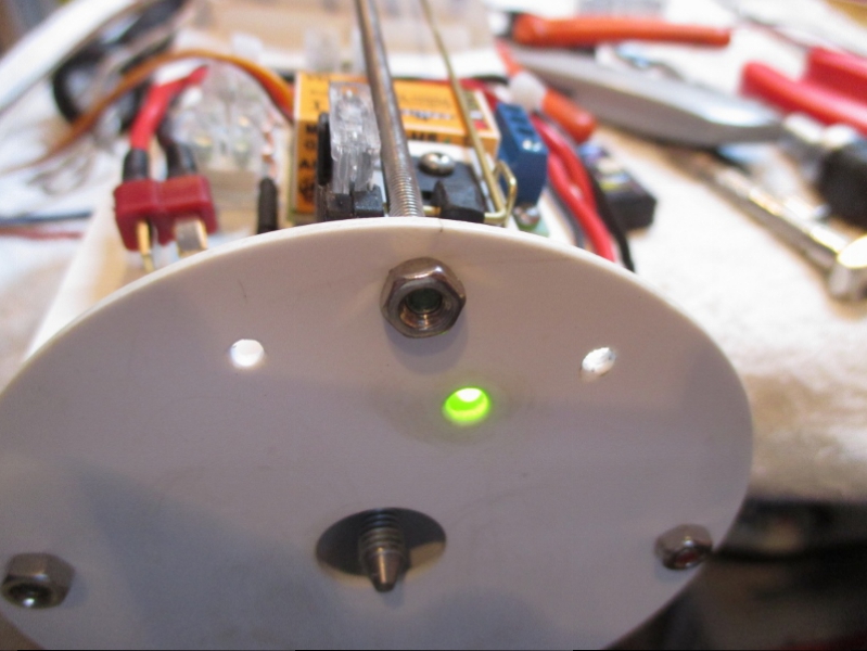

            I made a main switch from styrene, with a 25amp fuse and a green LED to indicate power is on, it shows through the end plate as the Ballast Tank Switch blocks the other end.
            Click image for larger version  Name:	image_37566.jpg Views:	1 Size:	227.7 KB ID:	127042Click image for larger version  Name:	image_37572.jpg Views:	1 Size:	248.7 KB ID:	127048
            Click image for larger version  Name:	image_37567.jpg Views:	1 Size:	227.5 KB ID:	127043

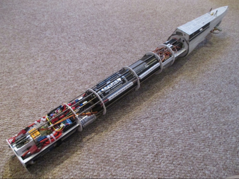

            Here is the final install.
            Click image for larger version  Name:	IMG_1718 (800x600).jpg Views:	2 Size:	329.8 KB ID:	127055
            The positive bus bar is under the Ballast Tank Switch. The green switch turns on the ESC which also powers the Receiver, the red switch the lights and the yellow switch the sound system. Effectively this means all items are separately switched as the main switch turns on the Ballast Tank unit. For normal operation all ancillary switches will be left in the on position, and the main switch {via the brass pushrod to the rear and exiting the boat} will only be used.
            Click image for larger version  Name:	image_37575.jpg Views:	1 Size:	316.9 KB ID:	127051Click image for larger version  Name:	image_37574.jpg Views:	1 Size:	374.0 KB ID:	127050
            The negative bus bar is behind the red and green switches out of the way.
            I went overboard on the wiring, it's all 17amp automotive, as with two large motors, I want a bit of a margin for overheating. All sound and and lights is just 5amp.

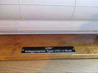

            I got a name plate made by my usual maker to match my other models.........
            Click image for larger version  Name:	image_37576.jpg Views:	1 Size:	249.8 KB ID:	127052

              Click image for larger version  Name:	IMG_1723 (800x600).jpg Views:	1 Size:	251.6 KB ID:	127156
              The On/Off switch is stabilised with a small fitting, that can be removed to change the bellows.

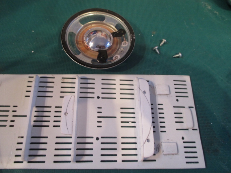

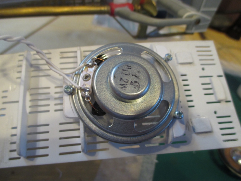

              The speaker for the sound module is a fully waterproof 2inch item (2 bucks from China), and is located under the aft deck.

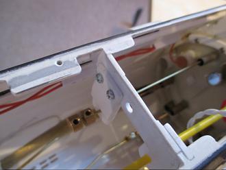

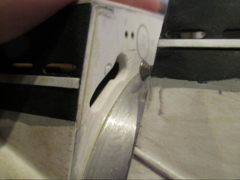

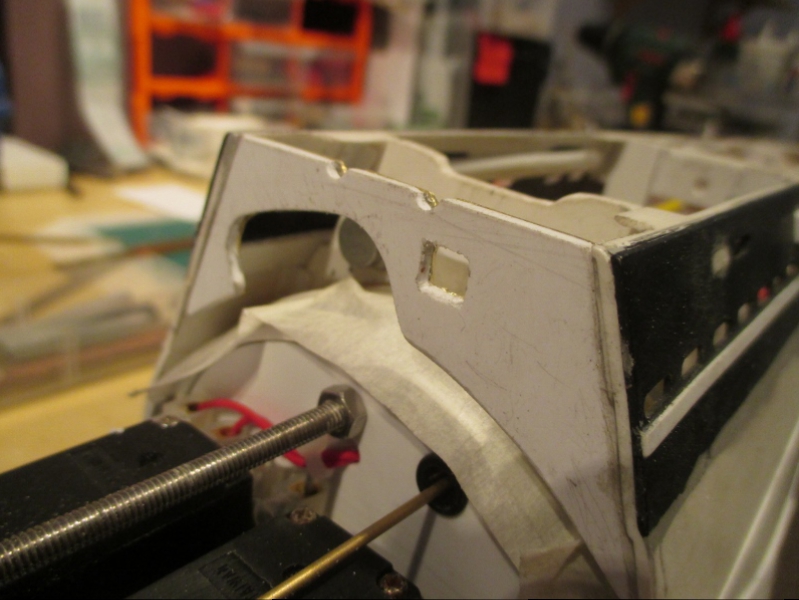

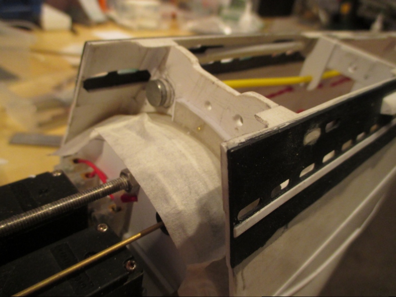

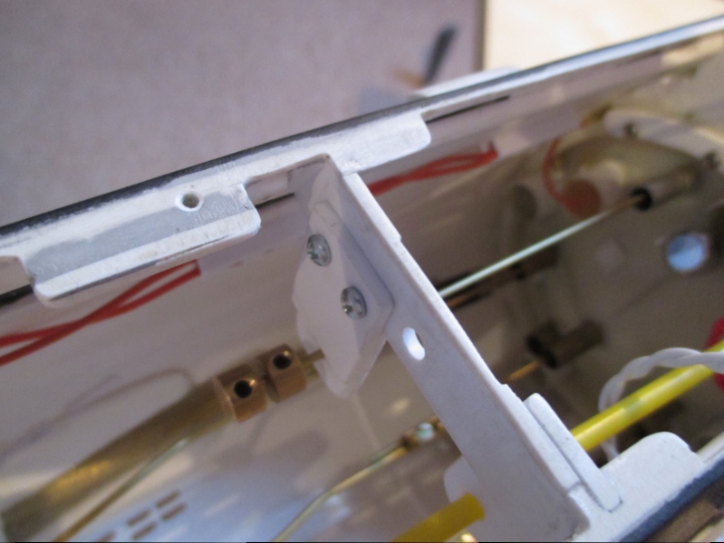

              I re-made the support at the hull break, it was flimsy from all the cutting and hacking. The new one is styrene backed with a 0.5mm brass plate for strength.
ID:	127160Click image for larger version

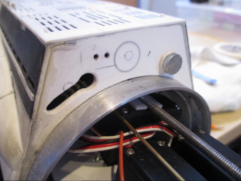

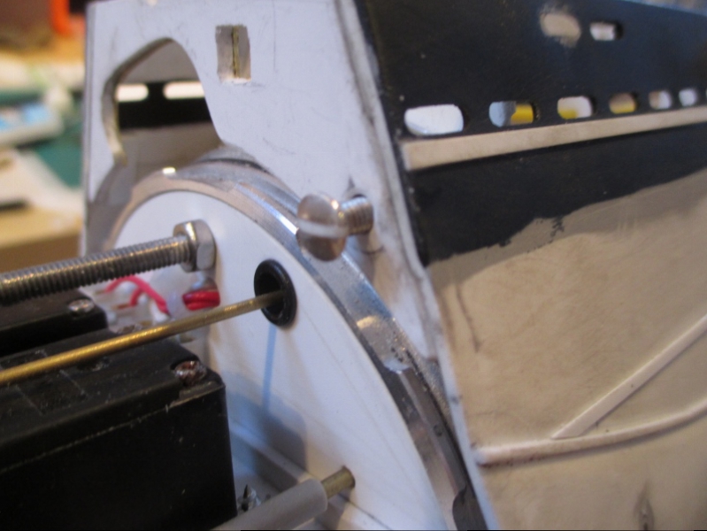

              For added security I added a locating pin of a 3mm machine bolt with 6mm head that locates into a slot in the fore section.
ID:	127162Click image for larger version
              Here it is about to locate in the slot, it stops any attempt at missaligning the two hull sections.

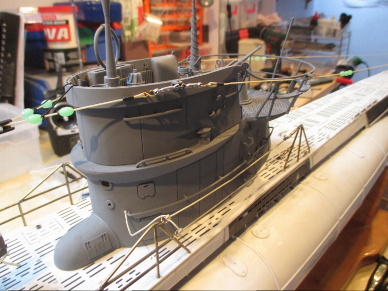

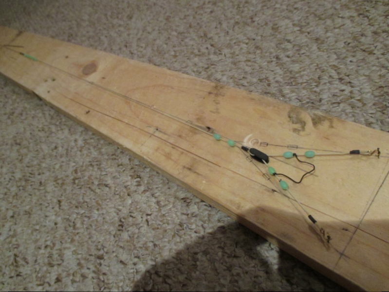

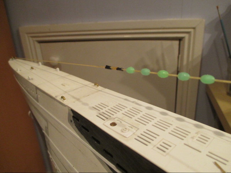

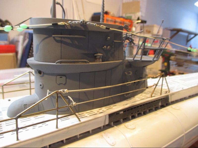

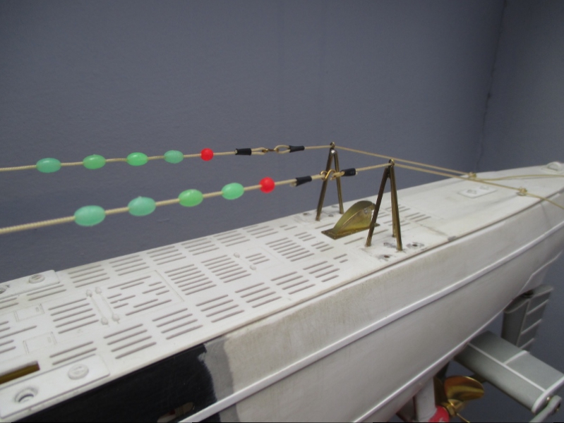

                Now for the rigging, an area that can make or break most model boats.
                Thankfully, it's just the three aerials and the four safety wires around the conning tower.
                I used a wooden board to get the lengths right and not damage the sub during construction..........
                Click image for larger version  Name:	image_37654.jpg Views:	1 Size:	304.7 KB ID:	127212

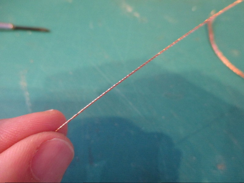

                ..... and used the 0.75mm good quality rigging cord (which I hung from the ceiling with heavy weights for about three weeks to remove as much tendency to stretch) that came with the model and some oblong fishing line items for the insulators.
                Click image for larger version  Name:	image_37651.jpg Views:	1 Size:	316.4 KB ID:	127209Click image for larger version  Name:	image_37652.jpg Views:	1 Size:	260.4 KB ID:	127210
                As the aerials will stretch with time, I have left a short section at the end on all three aerials that can be replaced rather than re-do the whole thing. The oblong insulators look daft in bright colours but will be toned down during painting.
                Click image for larger version  Name:	image_37655.jpg Views:	1 Size:	231.2 KB ID:	127213 Click image for larger version  Name:	image_37653.jpg Views:	1 Size:	308.3 KB ID:	127211

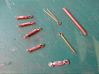

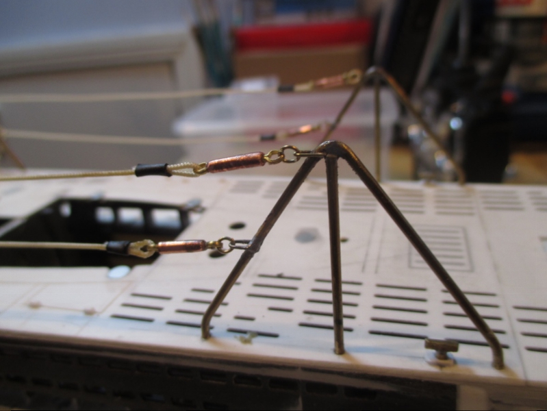

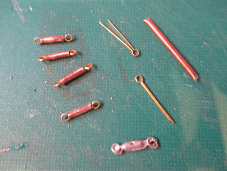

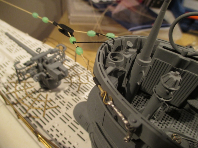

                All the rigging is terminated by a loop with a 5mm length of 2mm heatshrink sleeve and a dab of superglue (no knots!), once a bit of heat is applied the heatshrink squashes the superglue and makes a tight fit.
                The safety wires terminate in bottlescrew tensioners, the items I had in my spares box were whitemetal but were poor quality, so I made my own from 1.5mm brass tube and some pins.
                Click image for larger version  Name:	image_37656.jpg Views:	1 Size:	313.0 KB ID:	127214

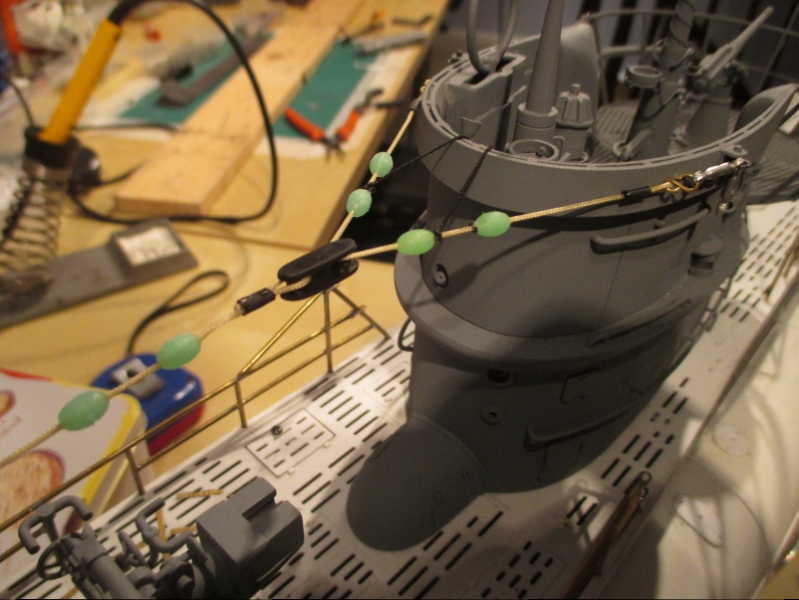

                They are temporarily attached to the model with one end just tied as they will need to be tensionsed on the final model once painted.
                Click image for larger version  Name:	image_37657.jpg Views:	1 Size:	225.7 KB ID:	127215Click image for larger version  Name:	image_37658.jpg Views:	1 Size:	299.4 KB ID:	127216
                Not as ardous as my last model ship that took 3 months to rig, the final piece will be the three jumper wires from the tower to the aerials, but again they cannot be sorted till the model is finished.
                The rigging will be all permanently attached to the tower with figure-8 wire loops, but removeable at the ends as the tower comes off.
                Click image for larger version  Name:	image_37659.jpg Views:	1 Size:	345.5 KB ID:	127217

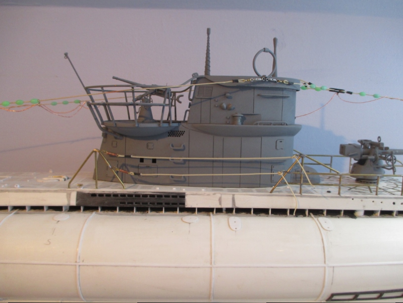

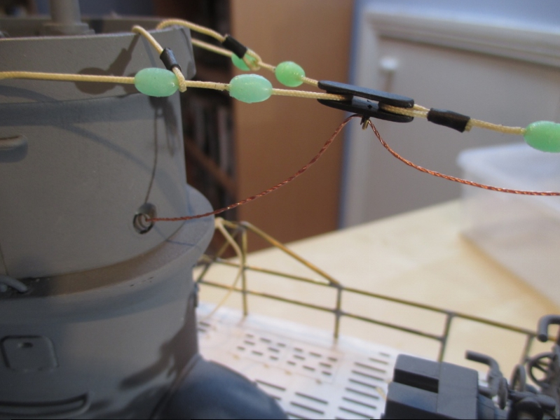

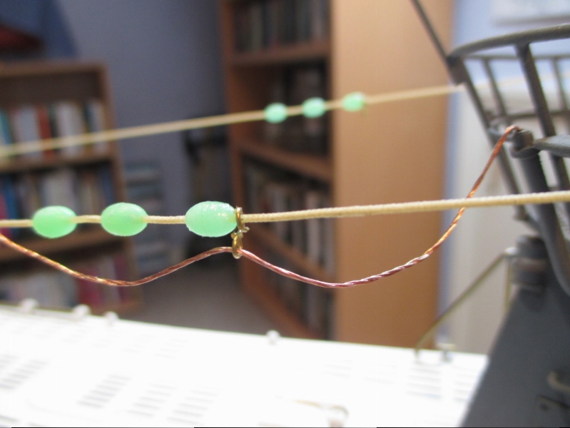

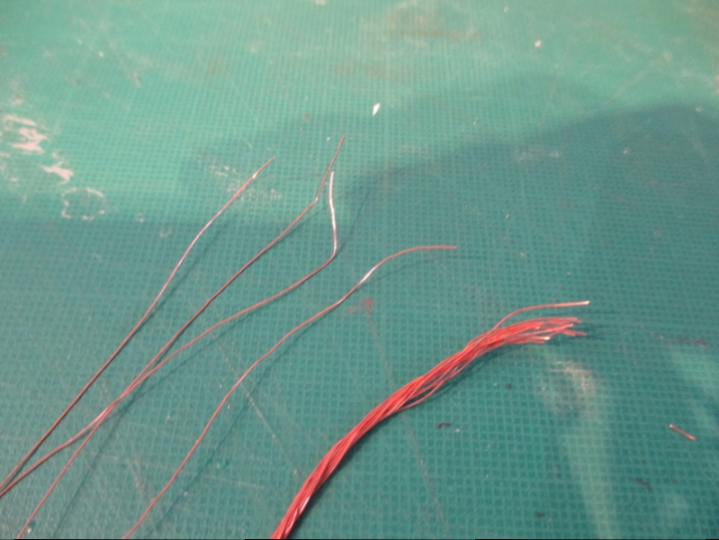

                  To finish the rigging, the three jumper cables need to made from stripped cable, four wires are wound using my dremel, and then thye are flooded with super thin superglue to keep them together. Thread or light rigging cord won't work, it would be too fragile plus it will never hang like real cable.
                  Click image for larger version  Name:	IMG_1753 (800x600).jpg Views:	1 Size:	280.5 KB ID:	127367Click image for larger version  Name:	IMG_1755 (800x600).jpg Views:	1 Size:	228.6 KB ID:	127368
                  There's a balance between scale appearance and functionality, the wires are routed from the insulators via brass eyelets to the aerials.
                  Click image for larger version  Name:	image_37752.jpg Views:	1 Size:	219.4 KB ID:	127358Click image for larger version  Name:	image_37753.jpg Views:	1 Size:	229.6 KB ID:	127359
                  The tower is almost complete now.
                  Click image for larger version  Name:	image_37754.jpg Views:	1 Size:	257.9 KB ID:	127360

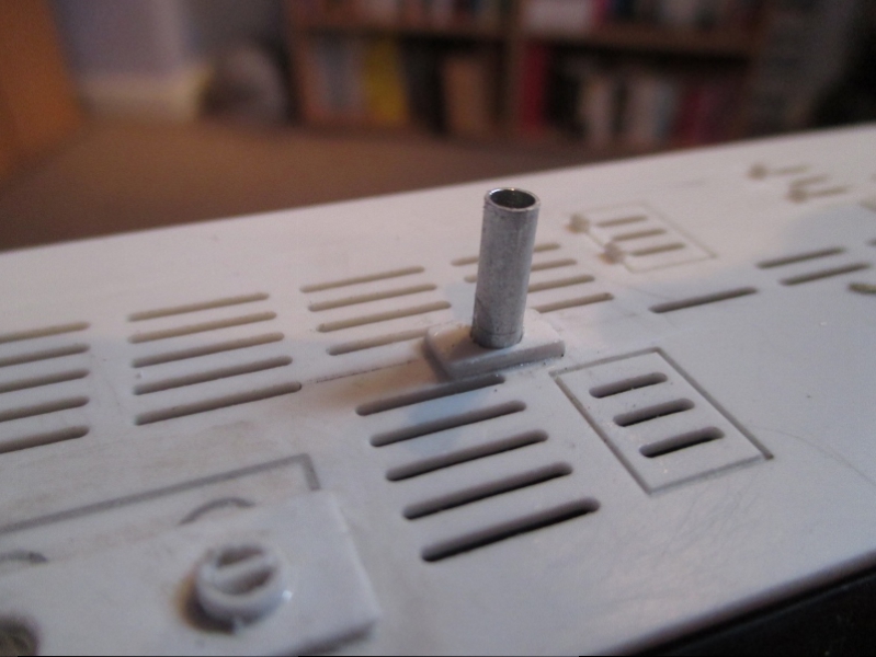

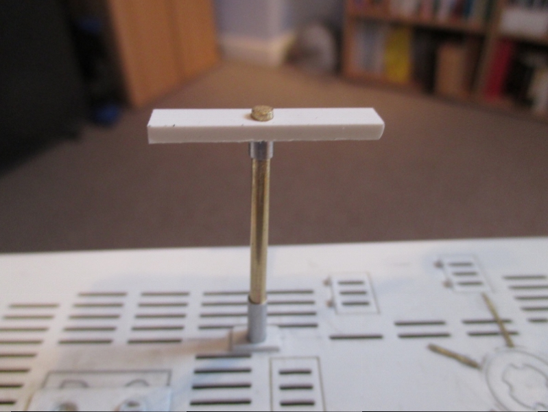

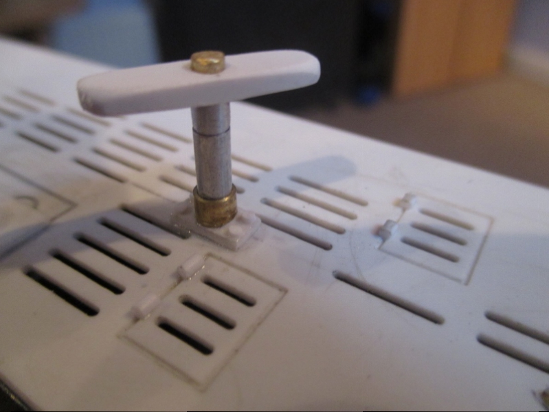

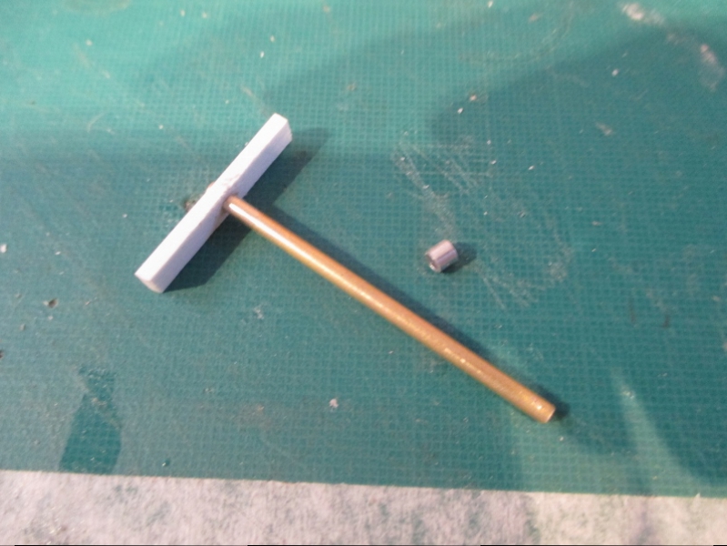

                  The rotating KDB (Kristall-Dreh-Basis) on the fore deck was a listening device that could be rotated around 360 degrees (but only functioned for 340 degrees due to engine noise).
                  I've decided to model this and make it work. The KBB itself is easy to make, a short length of tube is inserted thtough the deck and a rectangular base added.........
                  Click image for larger version  Name:	image_37755.jpg Views:	1 Size:	230.7 KB ID:	127361

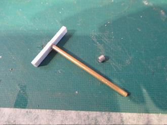

                  .......the rotating part is a 3mm brass rod, with a styrene top and a small collar to bear on the base.
                  Click image for larger version  Name:	image_37756.jpg Views:	1 Size:	278.2 KB ID:	127362Click image for larger version  Name:	image_37757.jpg Views:	1 Size:	226.6 KB ID:	127363
                  It's finished with bolt heads and base support..............
                  Click image for larger version  Name:	image_37758.jpg Views:	1 Size:	230.6 KB ID:	127364
                  ....................making it work will be a whole different battle, as the motor will be outside the WTC.
