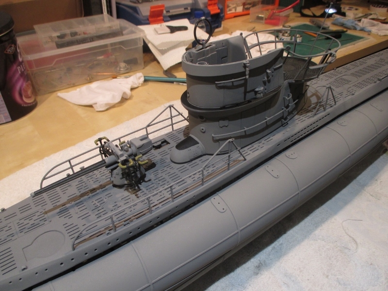

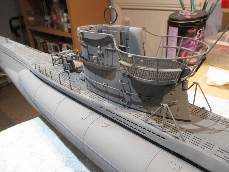

                            As I start the paint job, I've taken those tips on board, I've had to add some extra vents on the saddle tanks, just too much air was trapped below. Not prototypical, but it's a trade off between scale and not effing working properly.............practicality won in the end!
                            Click image for larger version  Name:	IMG_1843 (800x600).jpg Views:	2 Size:	239.5 KB ID:	129461
                            The sub gets a coat of Halfords primer from a rattle can, I'm using a slightly heavy paint for the first coat which will be sanded back and subsequent ones will be a lighter primer..........

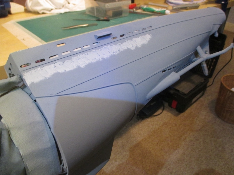

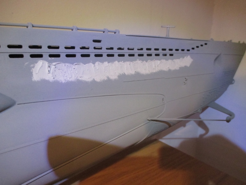

                            .............plus intermediate steps of filling and sanding the blemishes, mostly the seams are an issue......
                            Click image for larger version  Name:	IMG_1845 (800x600).jpg Views:	1 Size:	252.0 KB ID:	129463Click image for larger version  Name:	IMG_1846 (800x600).jpg Views:	1 Size:	275.6 KB ID:	129464
                            ........but it is a massive relief after almost two years to see a uniform colour, all the odd shapes and colours have blended. With the hull sections I expect to paint/fill/sand/repaint around four times, I should have all the blemishes sorted by that stage.

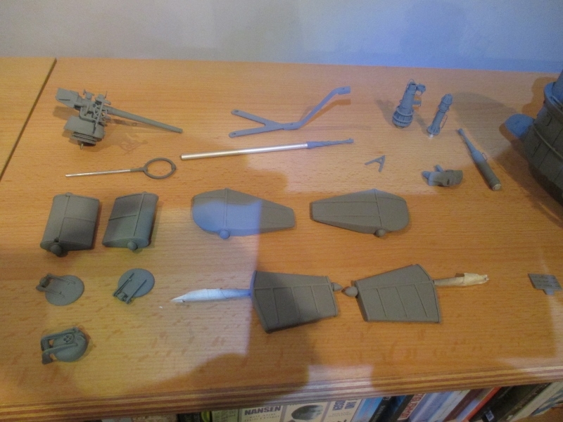

                            The additional parts get a coat of primer also.
                            Click image for larger version  Name:	IMG_1847 (800x600).jpg Views:	1 Size:	286.2 KB ID:	129465
