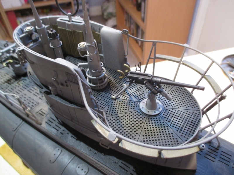

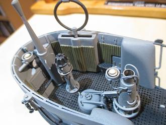

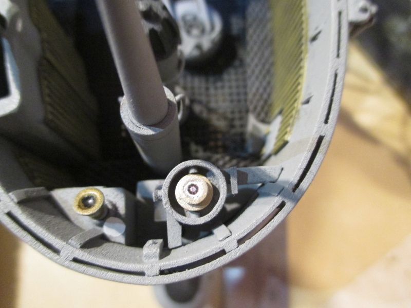

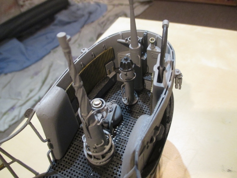

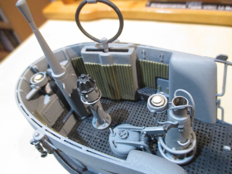

            Painting is taking way more time than I anticipated.
            I was optimistic in thinking I'd have to fill/sand/spray/repeat the hull sections four times, I've lost count of the number of times at this stage, there were endless nicks and marks from so much scratch building.
            Anyway, as each of the hulls dries, I've finished the tower (except for the gun which I broke).
            Click image for larger version  Name:	IMG_1852 (800x600).jpg Views:	1 Size:	299.4 KB ID:	129672
            After the Halfords Car Primer, I used Humbrol acrylic spray cans for large areas and small tins of their enamel with a brush for everything else. The tower deck and the boat deck were wooden over thin metal and covered in a thick black preservative over the wood. I hand painted with black enamel and I've added some brown shading, but it will need more.
            Click image for larger version  Name:	IMG_1851 (800x600).jpg Views:	1 Size:	290.8 KB ID:	129673Click image for larger version  Name:	IMG_1853 (800x600).jpg Views:	1 Size:	293.2 KB ID:	129674
            Apart from weathering the wooden seat and tower side pieces with a dark wash, I'll leave weathering till the Matt Varnish (Rustoleum) has dried. Won't be going for a very distressed look (I don't have the skills for that anyway), as the sub depicted is from early 1941, it doesn't require a heavy weathering. The most important thing is that it all knits together, so I will tone down any jarring colours (the white of the compass dial windows is a bit too white).
            Click image for larger version  Name:	IMG_1857 (800x600).jpg Views:	1 Size:	254.4 KB ID:	129675

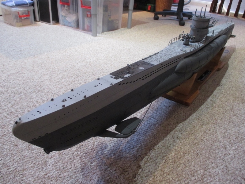

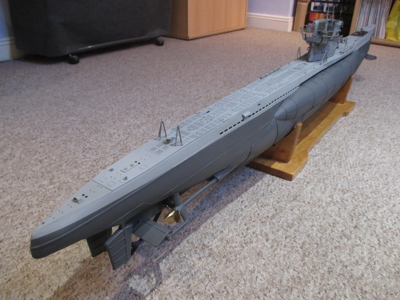

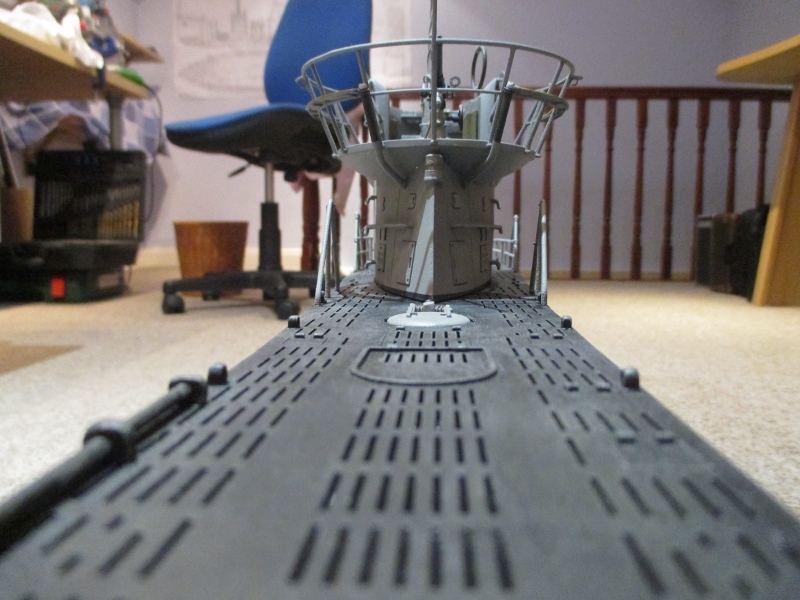

              Finally got the hull painted, ten days of work. Click image for larger version  Name:	IMG_1860 (800x600).jpg Views:	1 Size:	329.7 KB ID:	129690
              It's a bit bland at the moment, will have to highlight the weld doublers and a few other features. Click image for larger version  Name:	IMG_1864 (800x600).jpg Views:	1 Size:	331.7 KB ID:	129691
              For the purists (those that know their 'dunklegrau' from their 'hellgrau'), I went with what I could get (Humbrol Acrylic sprays light grey 64, and dark grey 67). Are these the authentic colours for U557? It's unlikely these are exact matches, but I don't care. The argument over precise pigmentation is muddied by the scarcity of colour pics, the conditions under which the few colour pics were taken and even the camera exposure at the time (no digital photography in 1941!!!!!)
              Click image for larger version  Name:	IMG_1859 (800x600).jpg Views:	1 Size:	366.3 KB ID:	129692
              The hull split point is fairly well hidden in the two tone paint.
              Click image for larger version  Name:	IMG_1861 (800x600).jpg Views:	1 Size:	366.6 KB ID:	129693
              On to paint the deck, a very complicated masking job will be required.

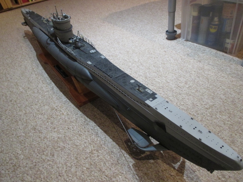

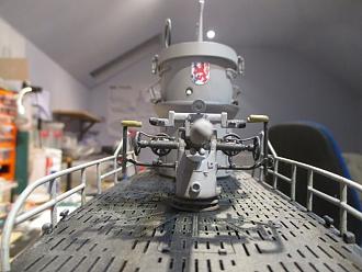

                          Finished the deck painting...............
                          Click image for larger version  Name:	IMG_1875 (800x600).jpg Views:	1 Size:	371.5 KB ID:	129793
                          Click image for larger version  Name:	IMG_1877 (800x600).jpg Views:	1 Size:	372.3 KB ID:	129794
                          Click image for larger version  Name:	IMG_1876 (800x600).jpg Views:	1 Size:	374.6 KB ID:	129795
                          Click image for larger version  Name:	IMG_1880 (800x600).jpg Views:	1 Size:	304.5 KB ID:	129796
                          ..........however, all has not gone to plan.
                          There is a good deal of variable finish, some flat, some semi matt etc., no idea why this has occurred. Despite three coats of flat matt varnish it perisists, will set it aside for a few days to thoroughly dry then sand the deck back to black and go again............a mystery............and a pain in the ass!

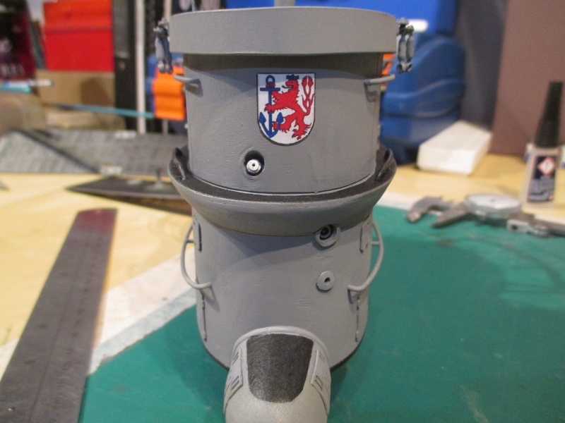

                            Down to the final details.

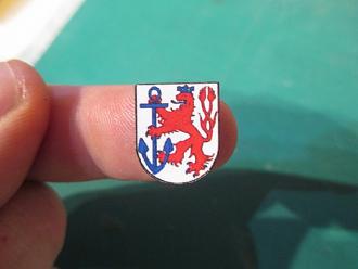

                            One of which is that U557 had a distinctive crest on the tower, the town emblem of Dusseldorf. No picture I've seen has this clearly, however I'm using the position from U201, the most common position for a crest design. In fact for U201, the boat had the crest eventually cast as a metal plate and bolted to the tower, whereas most tower art is painted on by crew and workers at the re-fit.
                            Click image for larger version  Name:	6b88f7ceec2fbbdeff3d2c6ce6118098[1].jpg Views:	1 Size:	180.8 KB ID:	129825

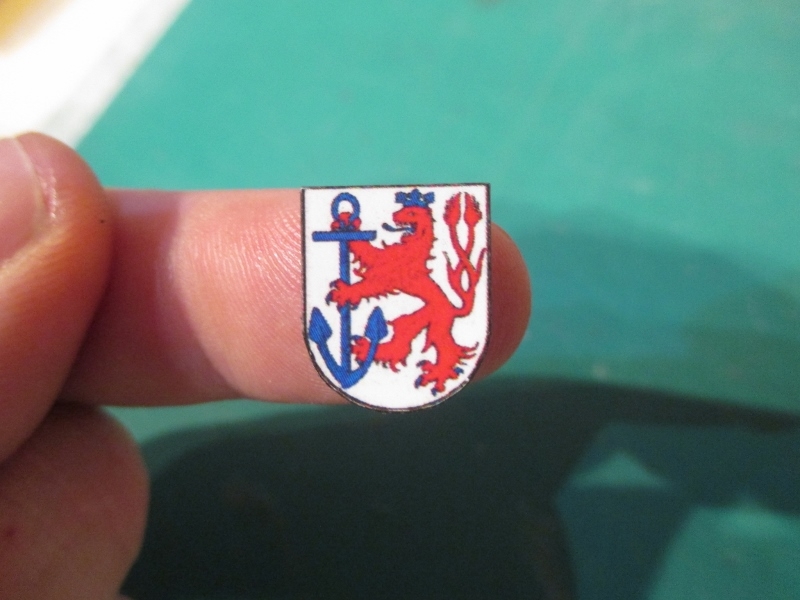

                            So the Dusseldorf Town emblem will go in the tower centre front above the spray rail. I downloaded the crest from the web and made various sizes to print onto matt vinyl adhesive paper, which I varnished with acrylic spray to fix the design once carefully cut out.
Name:	IMG_1881 (800x600).jpg
ID:	129826Click image for larger version
Name:	IMG_1882 (800x600).jpg
                            Once stuck in place, it gets a shot of sealer and I will tone it down later as part of the weathering process.

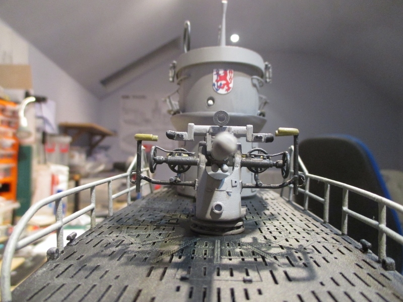

                            That's the tower fully finished.
Name:	IMG_1885 (800x600).jpg

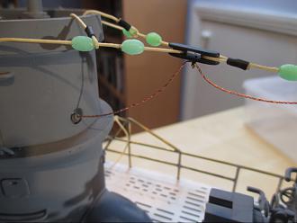

                                So I made a set of aerials/rigging earlier in the build.
                                Click image for larger version  Name:	image_37753.jpg Views:	1 Size:	229.6 KB ID:	127359
                                But these now appear crude now that the paint job is finished.
                                I've assembled a kit of parts to make more scale aerials....................left to right............ Click image for larger version  Name:	IMG_1886 (800x600).jpg Views:	1 Size:	339.2 KB ID:	129845
                                ..........................3mm heat shrink sleeves, walnut blocks for the insulators, a plastic piece for the triangular join of the forward aerial, plastic pieces for the tensioners, four bottlescrews for the deck protection wires and 1mm brass s-shaped wire for connectors (have to sacrifice the scale look in order to get the aerials off).
                                The aerial wire itself is good quality 1mm rigging thread, 20 feet of it is hanging from weights from the ceiling to take any stretchiness out of it, plus it's layed with a bees wax block to smooth out any loose hairs. The bare wire is fine copper wire twisted in a drill for the jumper wires from the tower to the aerials.
