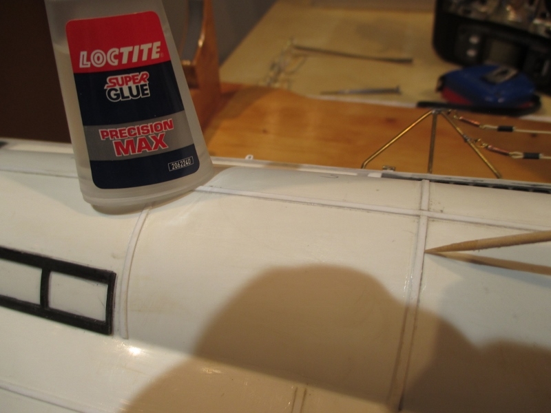

          I had to surrender on making the KDB rotate on the foredeck, just couldn't get it to work, tried waterproofing servos, step dwon 12v motors, waterproof boxes etc. etc. Only project in 5 years that defeated me!
          So I've completed re-enforcing the weld lines and doublers, a boring job of 'spritzing' every one with thin superglue with a cocktail stick, and re-sanding. Top tip that I got from Dave M. on the Forum.
          Had to be done, the poly cement will not be enough with rough handling.

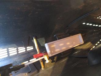

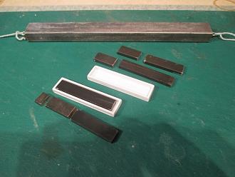

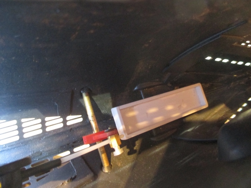

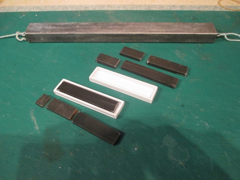

          To prepare for trimming, I've created fore and aft subtrim cradles, plastic slots to take varied lengths of 12 x 5mm steel bars.
Name:	IMG_1820 (800x600).jpg
          There is one each for the front and back sections with open access. My theory here is that with my Skipjack build even a slight change (for example, a different servo), affects the trim (especially submerged trim), so I've made various lengths of these subtrim bars to complement the 10 inch solid keel ballast that comes with the kit. A magnetic arm is used to drop the weights into the cradles once glued inside, I'll start with two full cradles for trim tests as it's easier to subtract weight incrementally than add it later.

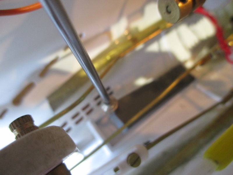

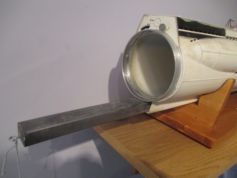

          The large keel weight is slotted down the lower hull, with string attached to front and back so that it can be joggled along to get the trim right. Given all the extra components in the WTC, this weight will almost certainly have to be cut down, but I'll have to wait for test tank results first.
Name:	IMG_1826 (800x600).jpg

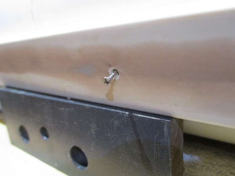

          Once the position inside the hull is determined, the only thing required to hold it in place will be two stainless steel 2.5mm countersunk screws hole through the bottom of the sub as it's a very tight interference fit and cannot move in any plane other than lengthwise along the keel.
Name:	IMG_1828 (800x600).jpg
          Once I get the surface trim correct, I will never see this ballast again, so it'll get a final coat of enamel paint for final installation. Submerged trim will be by foam above the waterline and the small subtrim ballast weights fore and aft.

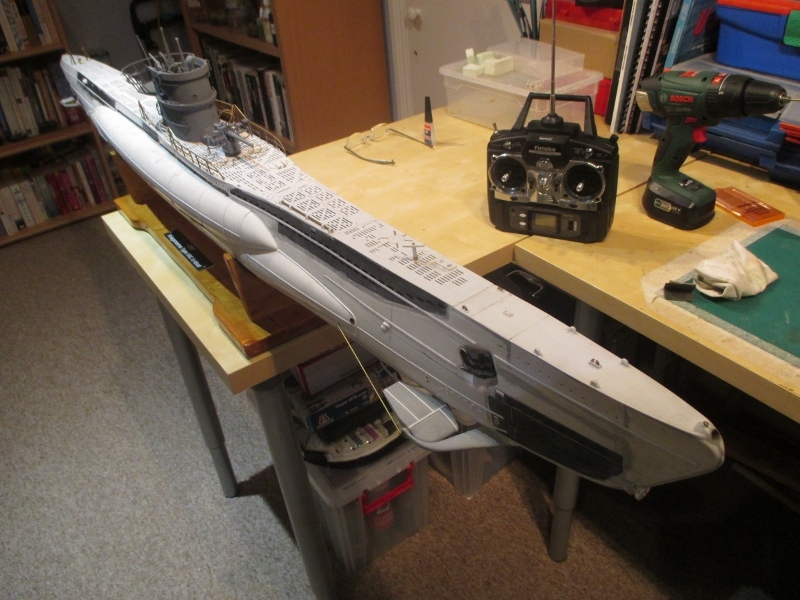

          And that's it!!!!!!!
          U-557 is finished the construction phase....... from April 2017 to date, I'm having an ice cold beer tonite to celebrate. Sure, there's painting and lots of on water tests to carry out, and wiring to be tidied up and I'm getting some expensive digital servos delivered (at 1,600 bucks I'm not scrimping on cheap servos), but there are no more bits to be stuck or screwed to U-557.
Name:	IMG_1830 (800x600).jpg
Name:	IMG_1829 (800x600).jpg
          I did address most (not all) of Robbe's U-47s shortcomings, and with a half decent paint job, the remaining issues will only be known to the absolute purists. Given the challenges it presented (and a housefire) during the build, this is not a project for beginners.
          Off to the test tank this weekend..............

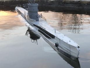

                    Here is my Test Facility for U557, buddies fish pond in his front garden.
                    Click image for larger version  Name:	IMG_7302.jpg Views:	1 Size:	3.6 KB ID:	128748
                    Click image for larger version  Name:	IMG_7305.jpg Views:	1 Size:	3.3 KB ID:	128749
                    The elastic bands hold the lead keel under the boat till I trim it to size, then it is inserted inside.
                    And here is U557 on the waterline..........
                    Click image for larger version  Name:	image_38279.jpg Views:	1 Size:	12.1 KB ID:	128750
                    ...................took 3 hours of in/out of the water and cutting small bits off the keel weight till it was balanced.
                    The Boattrainman

                          I didn't weigh the main ballast bar, but I ended up removing around 1/3 of it before final installation to get the sub to the waterline.
                          Click image for larger version  Name:	IMG_1826 (800x600).jpg Views:	1 Size:	260.9 KB ID:	128680
                          Plus I had 2 X 25 gram weights fore and aft, and a 70 gram weight within the WTC offest to the starboard side to get the boat level (it counteracts the weight of the motor on the piston tank which is slightly to port).
