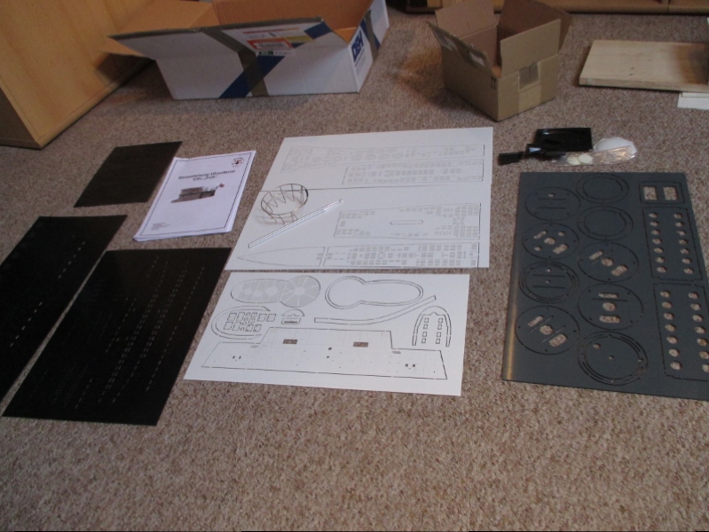

    Combined with a 900ml Engel Piston Tank and their Bayonet Lock with Accurate Model Parts decals and the Modellbau-Wikinger upgrade parts.....................
    Click image for larger version  Name:	IMG_1091 (800x600).jpg Views:	1 Size:	315.1 KB ID:	121886Click image for larger version  Name:	IMG_1092 (800x600).jpg Views:	1 Size:	309.2 KB ID:	121887
    ............ which includes scale decks, flood/drainage holes, conning tower, railings (Wintergarden), scopes, and a 'Tech Rack' designed for Engel internals (total 320 Euro).

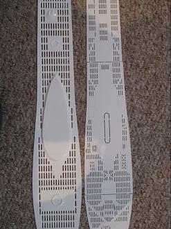

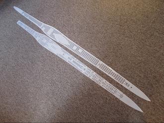

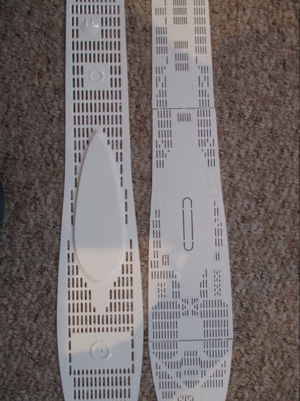

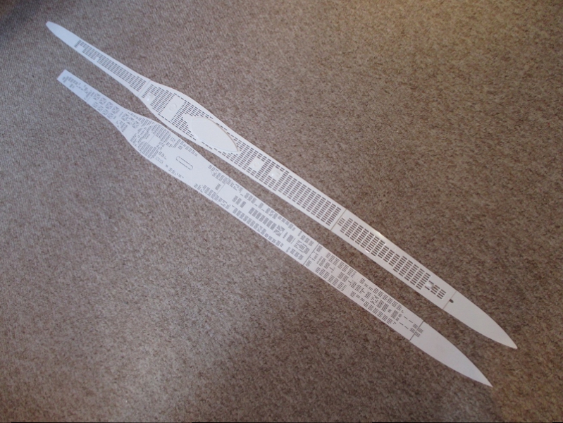

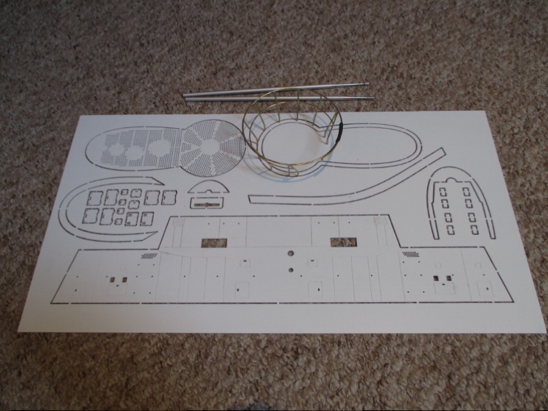

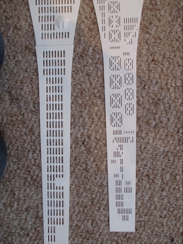

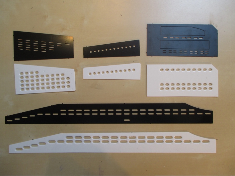

    Interesting comparison between the Robbe and Wikinger parts. Here are the two decks side by side, total length 1700mm.
    Click image for larger version  Name:	image_35155.jpg Views:	1 Size:	396.9 KB ID:	121891
    There is superb moulded on details on the Wikinger parts.
    For CNC cut plastic the details are great compared to the 'coarse' scale Robbe deck.
    Click image for larger version  Name:	IMG_1097 (600x800).jpg Views:	1 Size:	356.7 KB ID:	121893Click image for larger version  Name:	IMG_1098 (600x800).jpg Views:	1 Size:	398.3 KB ID:	121894
    The flood/drain slots are good too, I may be wrong but the Wikinger parts in black look modelled on the Revell 1/72 kit upgrade available in brass.
    Click image for larger version  Name:	IMG_1099 (800x600).jpg Views:	1 Size:	243.2 KB ID:	121895
    There was a brass deck for the Robbe U47 a few years ago, but I hear it was a bit on the heavy side, despite being a stunning piece of kit. Despite this upgrade kit some of the slots are still wrong depending on boat choice.

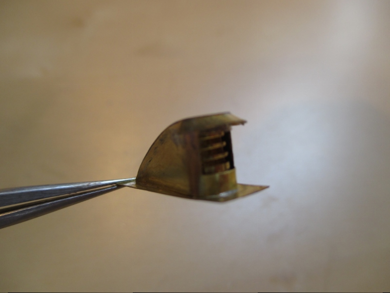

      Just one example of the Photo-Etched parts that are available, this is the rear deck light.
      Click image for larger version  Name:	IMG_1100 (800x600).jpg Views:	2 Size:	183.8 KB ID:	121902

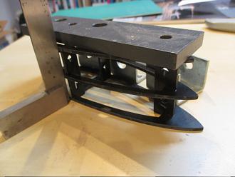

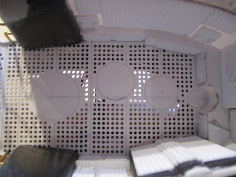

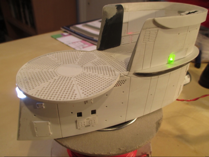

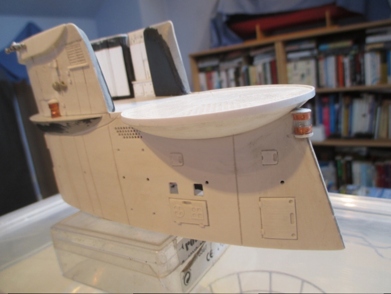

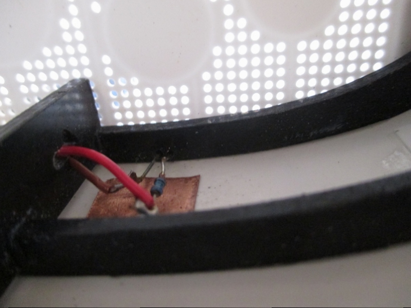

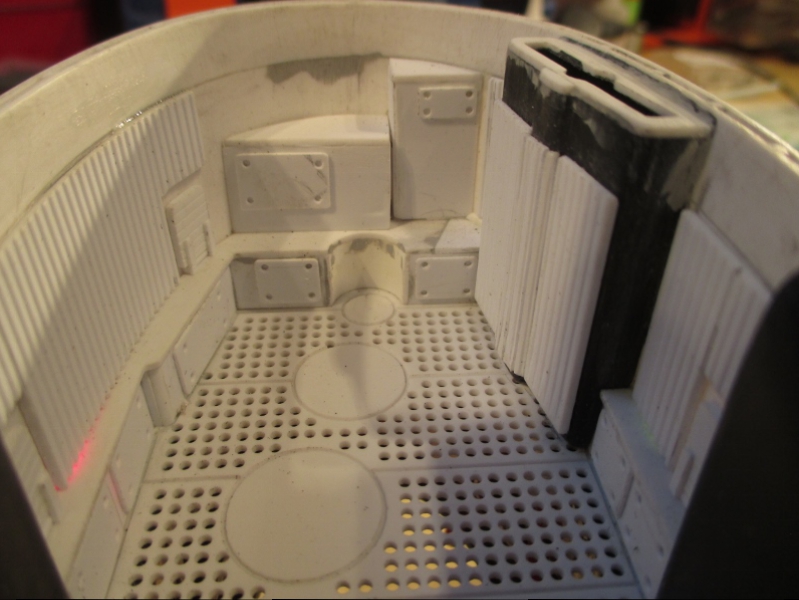

          A start is made on the tower which will be 'Turm 0' early period, although the Wikinger upgrade item has some mistakes which need to be sorted.
          The three piece frame is made around which the plastic tower is wrapped.
          Click image for larger version  Name:	IMG_1101 (800x600).jpg Views:	1 Size:	262.7 KB ID:	122007

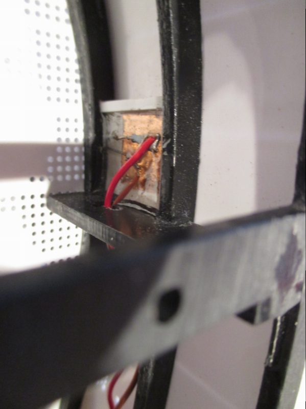

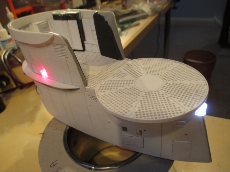

          The lights are my standard fit of connections, brass heat shield and reduction resistor encased in epoxy.
          Click image for larger version  Name:	IMG_1102 (800x600).jpg Views:	1 Size:	235.6 KB ID:	122008 Click image for larger version  Name:	IMG_1103 (600x800).jpg Views:	1 Size:	230.2 KB ID:	122011
          The lights are Robbe plastic lenses with 3mm LEDs, once working I will build a scale surround on each.
          Click image for larger version  Name:	IMG_1104 (800x600).jpg Views:	1 Size:	247.8 KB ID:	122012Click image for larger version  Name:	IMG_1105 (800x600).jpg Views:	1 Size:	253.6 KB ID:	122009

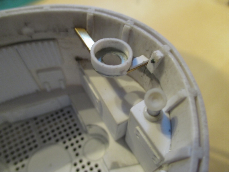

          The light housings, wind deflector, seats, wooden insulation on the inner walls and forward instrument area are all scratchbuilt.
          Click image for larger version  Name:	IMG_1106 (800x600).jpg Views:	1 Size:	256.4 KB ID:	122010

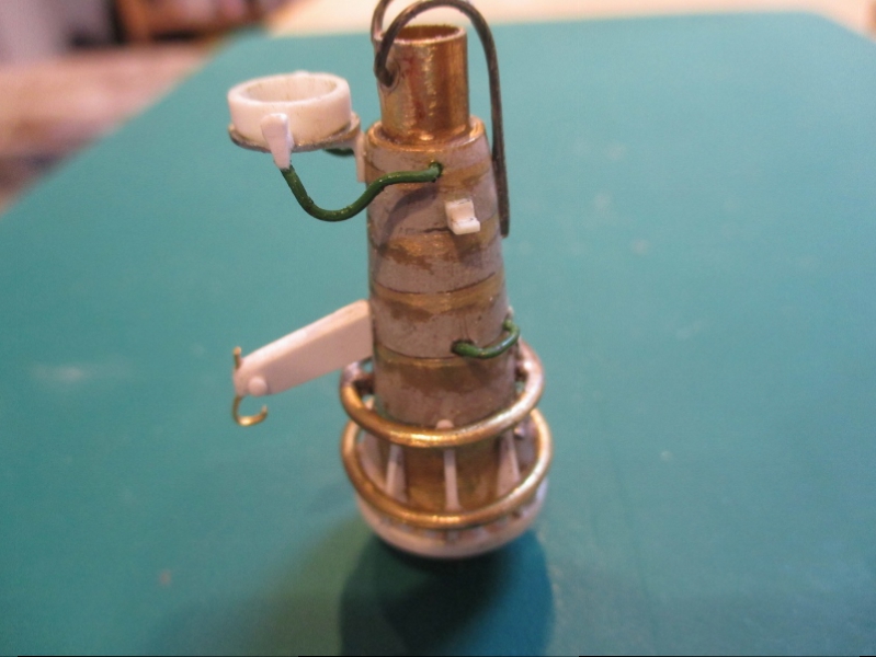

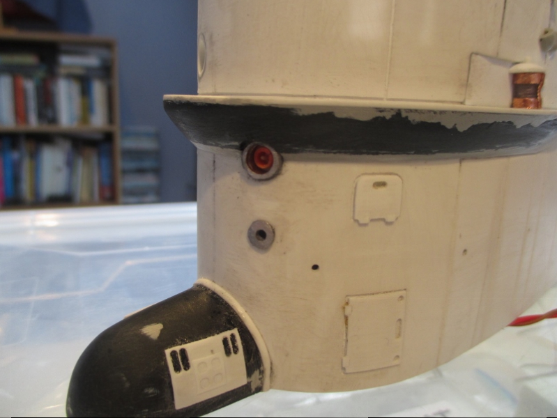

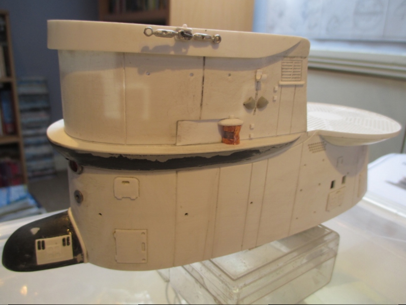

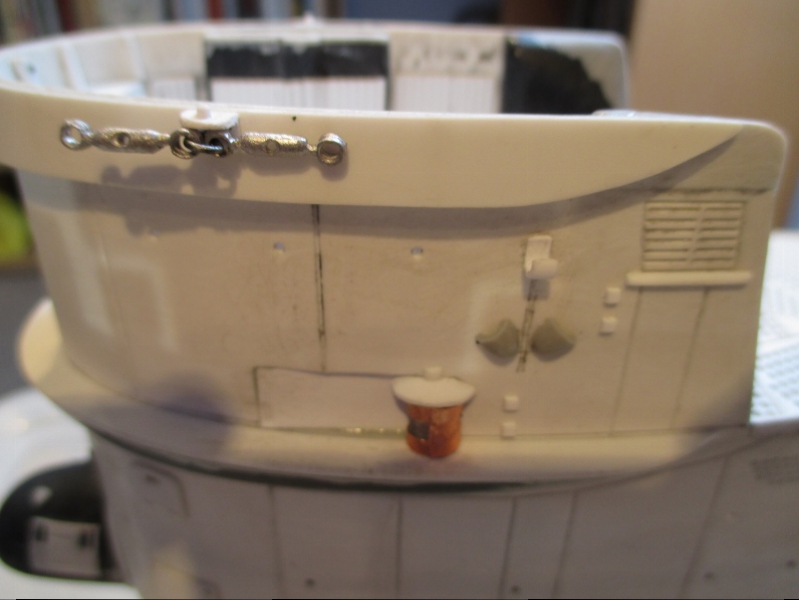

            Some more detail is added to the Tower. The side and rear lights get thin brass surrounds and plastic hats.
            Click image for larger version  Name:	IMG_1108 (800x600).jpg Views:	1 Size:	226.6 KB ID:	122027Click image for larger version  Name:	IMG_1109 (800x600).jpg Views:	1 Size:	236.8 KB ID:	122031
            The attachment points for the lifebuoys and aerial rigging (spare white metal parts), the metal strip under the grill plus four raised marks as per photos.
            Click image for larger version  Name:	IMG_1110 (800x600).jpg Views:	1 Size:	217.7 KB ID:	122028

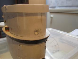

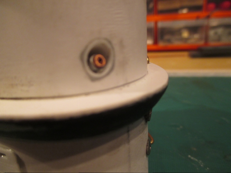

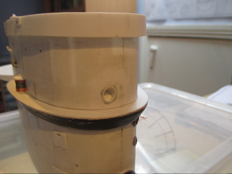

            The fog horn in the larger forward port side hole is a small piece of round plastic with a cocktail stick as the speaker horn.............
            Click image for larger version  Name:	IMG_1111 (800x600).jpg Views:	1 Size:	227.5 KB ID:	122029
            ..................and the hole for the aerial wire inlet is round plastic tubing inserted at an odd angle and sanded flat to the tower. I'll sort the insulator later.
            Click image for larger version  Name:	IMG_1112 (800x600).jpg Views:	1 Size:	203.4 KB ID:	122030

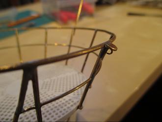

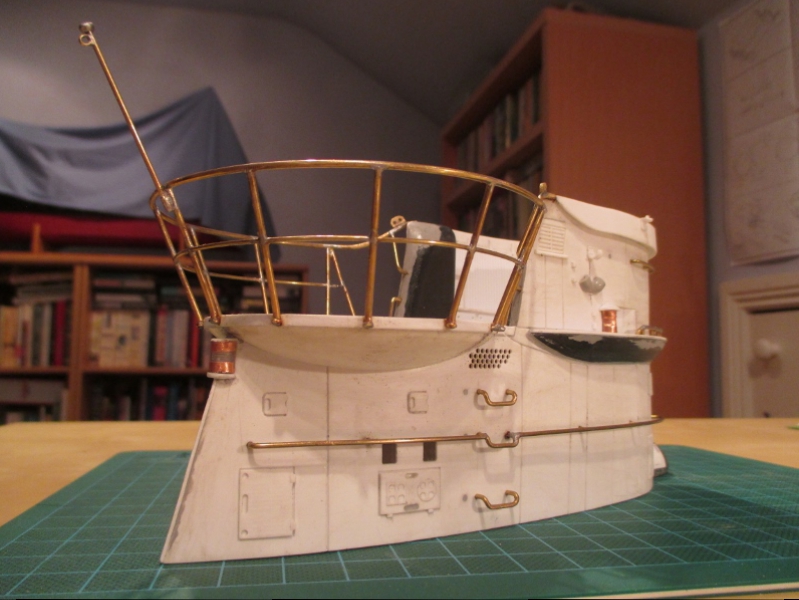

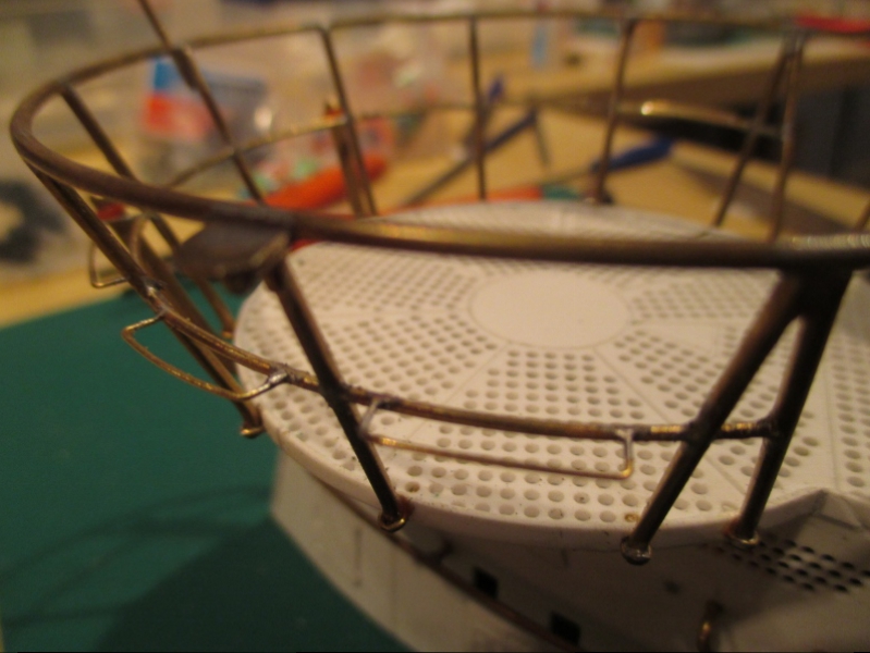

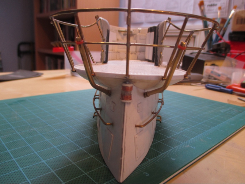

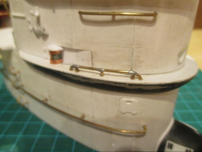

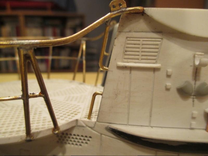

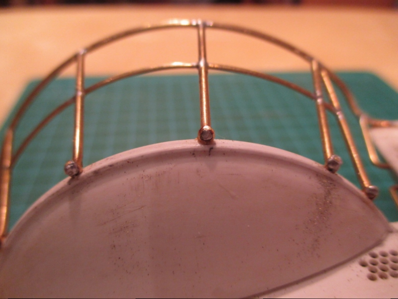

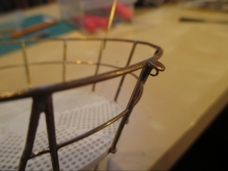

                  The handrails are now completed.
                  Click image for larger version  Name:	IMG_1113 (800x600).jpg Views:	1 Size:	272.0 KB ID:	122210Click image for larger version  Name:	IMG_1115 (800x600).jpg Views:	1 Size:	248.2 KB ID:	122211

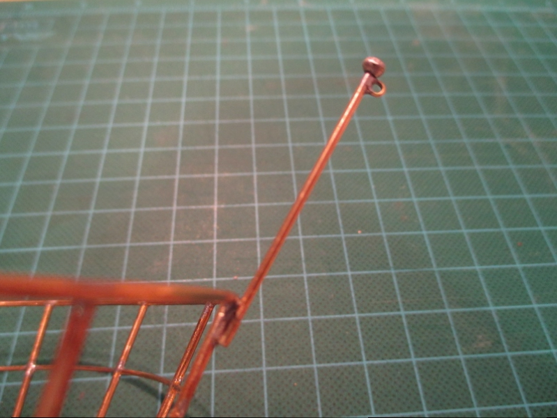

                  The smaller details include the jackstaff and the fitting on top of each rail for the torpedo loading equipment.
                  Click image for larger version  Name:	IMG_1114 (800x600).jpg Views:	1 Size:	269.5 KB ID:	122213Click image for larger version  Name:	IMG_1116 (800x600).jpg Views:	1 Size:	269.3 KB ID:	122212

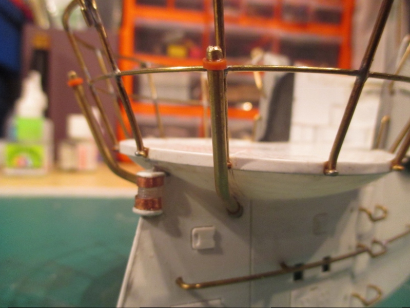

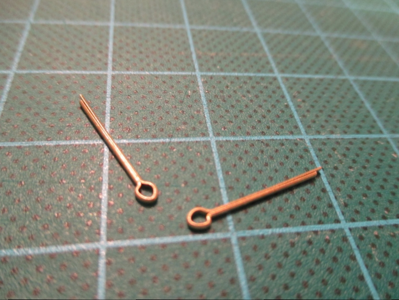

                  A major concern was the attaching of the vertical rails to the base of the circular Wintergarden, photos show these are welded to the sides, but gluing metal to plastic is problematic and would be vulnerable to breaking.
                  The solution was split pins with the same diameter hole as the railing, inserted into holes and the vertical railings inserted into these and trimmed and soldered.
                  Click image for larger version  Name:	IMG_1117 (800x600).jpg Views:	1 Size:	322.6 KB ID:	122214Click image for larger version  Name:	IMG_1118 (800x600).jpg Views:	1 Size:	254.7 KB ID:	122215
                  Some of the railings are a bit over 'scale', this is deliberate as I want them as strong as possible to avoid damage.
                  Click image for larger version  Name:	IMG_1119 (800x600).jpg Views:	1 Size:	282.8 KB ID:	122216

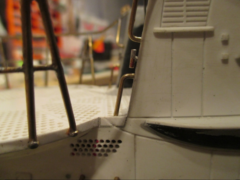

                        The aerial inlets/insulators are bent tube for the rear pair, and three small diameter tubes inside each other for the forward.
                        Click image for larger version  Name:	IMG_1126 (800x600).jpg Views:	1 Size:	264.2 KB ID:	122274Click image for larger version  Name:	IMG_1125 (800x600).jpg Views:	1 Size:	217.3 KB ID:	122275

                        Click image for larger version  Name:	IMG_1124 (800x600).jpg Views:	1 Size:	292.5 KB ID:	122276
                        Have to fashion the slit surround for the rear light.

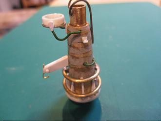

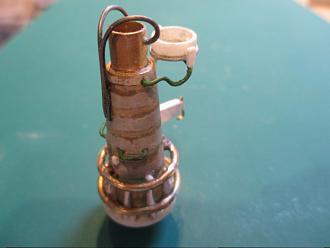

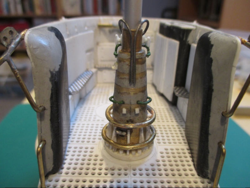

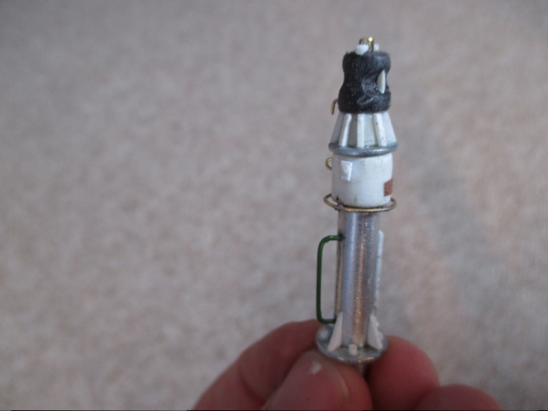

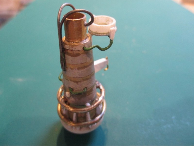

                          Next up is the attack periscope base, the rear of one is below.
                          The problem with this item is it's very fiddly, with lots of parts that could be damaged when in use, the challenge is to make it tough, and also insure the periscope will function out of the top.
                          Click image for larger version  Name:	stebetojai[1].jpg Views:	1 Size:	96.2 KB ID:	122290

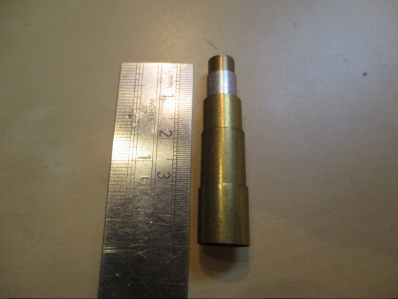

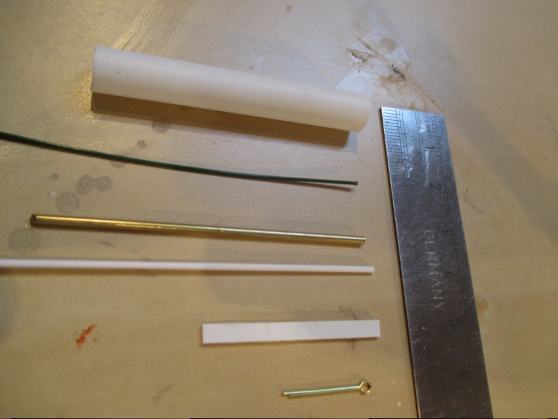

                          To make the basic shape I used metal tubes sleeved to give an approximate shape, glued together and then covered with filler and sanded.
                          Click image for larger version  Name:	IMG_1128 (800x600).jpg Views:	1 Size:	239.0 KB ID:	122291
                          The basic components were..............
                          Click image for larger version  Name:	IMG_1129 (800x600).jpg Views:	1 Size:	257.1 KB ID:	122292
                          ............ plastic tube for the compass gimbal, two gauges of soft/brass wire for the handrails and footrails, plastic rod for the bolt heads to deck, plastic bar for the V strengtheners at deck level and a split pin for the hatch holding mechanism.
                          Click image for larger version  Name:	IMG_1130 (800x600).jpg Views:	1 Size:	232.8 KB ID:	122293Click image for larger version  Name:	IMG_1131 (800x600).jpg Views:	1 Size:	234.2 KB ID:	122294
                          (looks like a robot holding a plate to me!!!!)
                          Here it is on the model, similar view to the actual one above, by comparison the navigation periscope base is a simple aluminium tube with wire handrails.
                          Click image for larger version  Name:	IMG_1132 (800x600).jpg Views:	1 Size:	288.0 KB ID:	122295Click image for larger version  Name:	IMG_1133 (800x600).jpg Views:	2 Size:	294.5 KB ID:	122297
                          I had to cheat in one or two places to keep it strong, and with over forty parts it took three nights work to make, but it is very strong which is important for a working model.

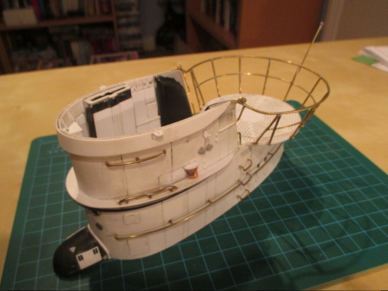

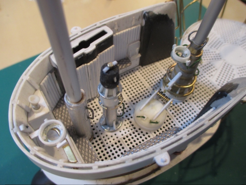

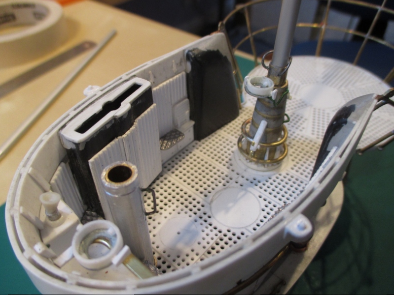

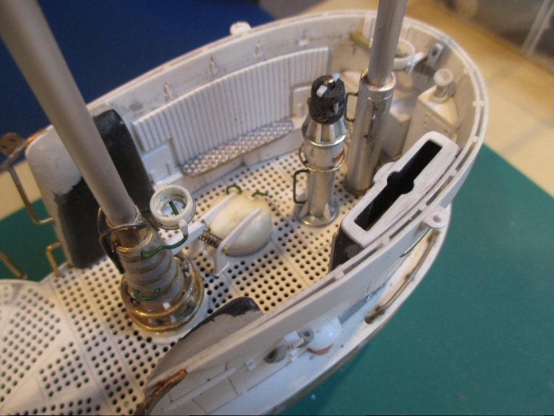

                            The final pieces of tower equipment other than the gun are the UZO with the top mount for the binoculars.
                            Click image for larger version  Name:	IMG_1134 (800x600).jpg Views:	1 Size:	212.3 KB ID:	122314
                            Complete with the hatch and scopes, still more small details to add around the tower before it's finished.
                            Click image for larger version  Name:	IMG_1136 (800x600).jpg Views:	1 Size:	304.2 KB ID:	122315Click image for larger version  Name:	IMG_1137 (800x600).jpg Views:	1 Size:	303.9 KB ID:	122316

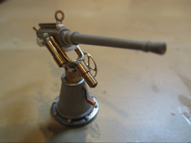

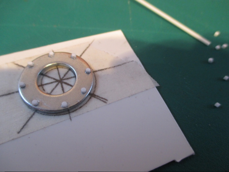

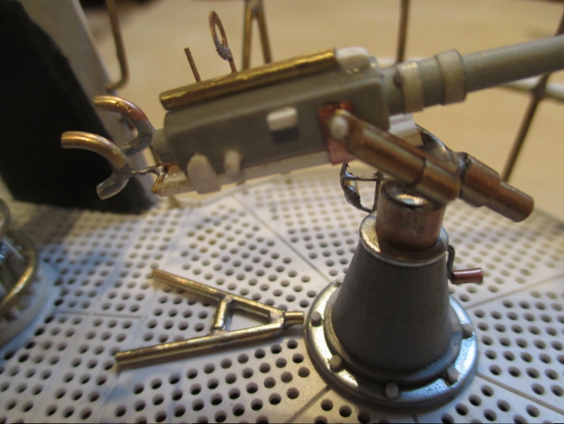

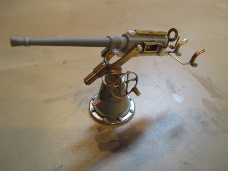

                              The final large item is the 2cm AA Gun, the supplied barrel and base is used, all other parts are discarded.
                              mg301
                              The base is cut down and gets a new floor from a washer and round styrene as bolts.
                              Click image for larger version  Name:	IMG_1142 (800x600).jpg Views:	1 Size:	236.9 KB ID:	122342
                              Lots of small parts in plastic and brass are added to give the gun some detail, thin masking tape is wrapped around the barrel for ribs.
                              Click image for larger version  Name:	IMG_1143 (800x600).jpg Views:	1 Size:	249.7 KB ID:	122343Click image for larger version  Name:	IMG_1144 (800x600).jpg Views:	1 Size:	215.5 KB ID:	122344
                              Finally the gun fixing tripod is made from brass.
                              Click image for larger version  Name:	IMG_1146 (800x600).jpg Views:	1 Size:	290.7 KB ID:	122345
