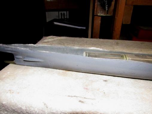

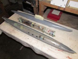

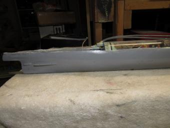

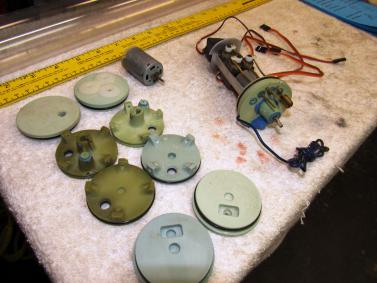

      These shots will demonstrate what we have in the way of the SD for your fine looking ZULU:
      In the hull is a 2" diameter Lexan tube, off-hull is a 2.5" SD
      See how high out of the water (in surface trim) the 2.5" cylinder is? Yuck!
      Here's the 2" SD cylinder -- its top just about even with the designed waterline. This is more like it!
      Ready to start 2" SD fabrication, Scott. Waiting to hear from you. Note the three gears on the upper, right bulkhead -- that's how I'll get three outputs from one input.
      The single-shaft 2" motor-bulkhead to the right illustrates how your get your unit: servos and pushrods installed. Before it gets out of here it will be tested for water tightness and function. All you'll have to do is populate the SD with the usual devices and non-sense.

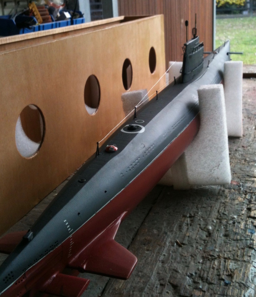

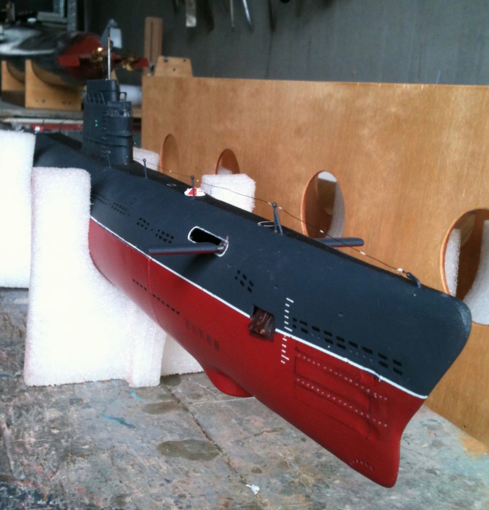

              Fitted the fore and aft safety lines and the rear antenna support.

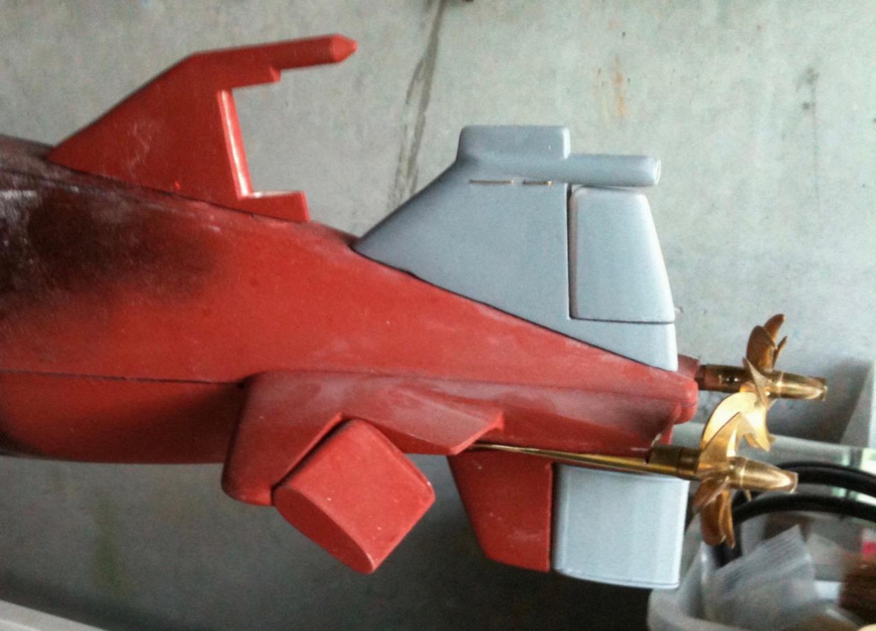

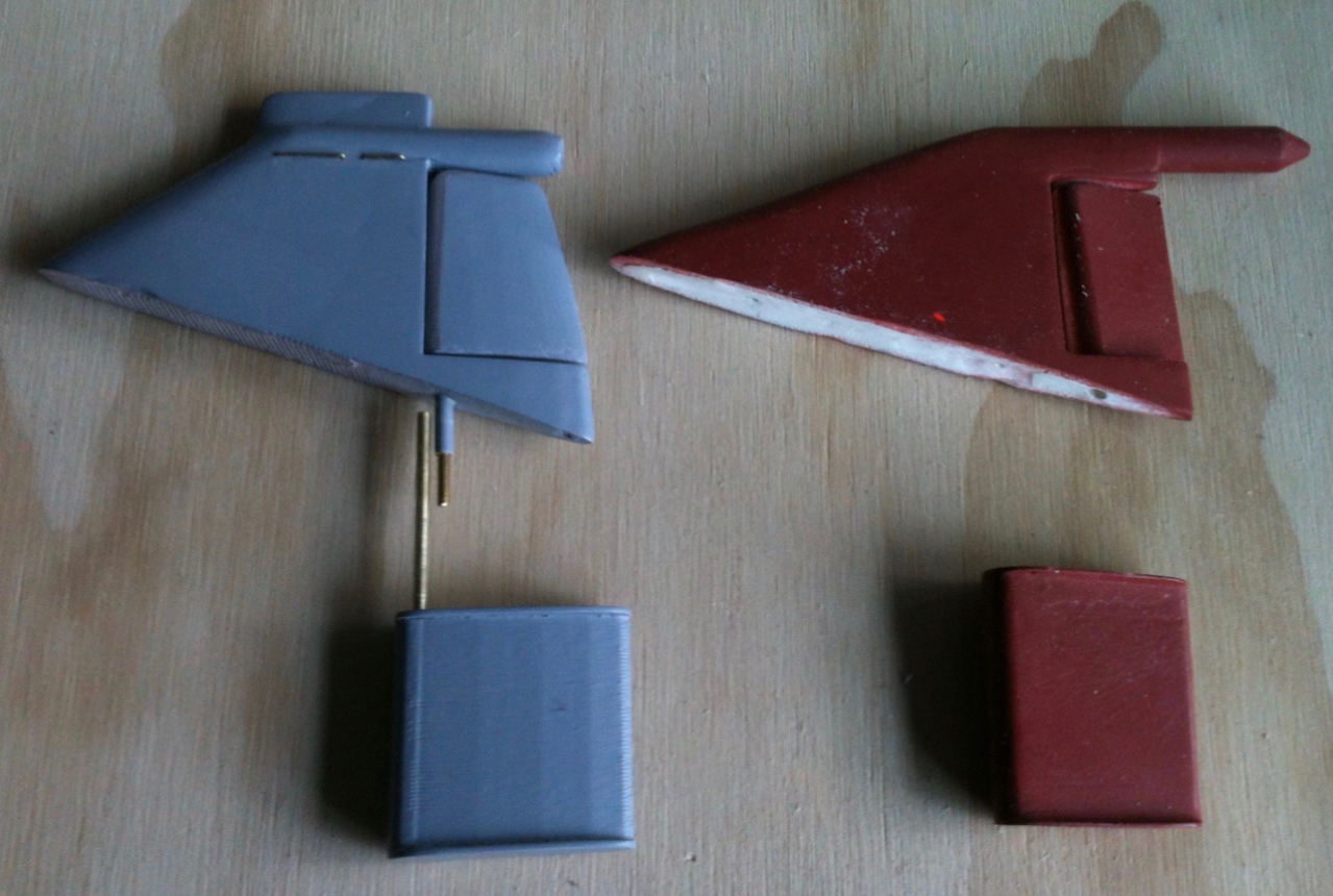

                Not really Zulu but its filling in the time between Zulu tasks - the new tail for the Delta III.
                Much better mate......think you are infected with the “rivet counter” microbe.
