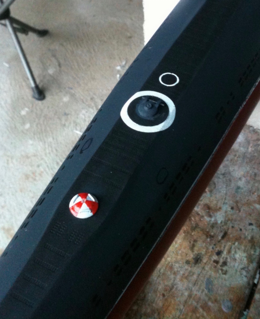

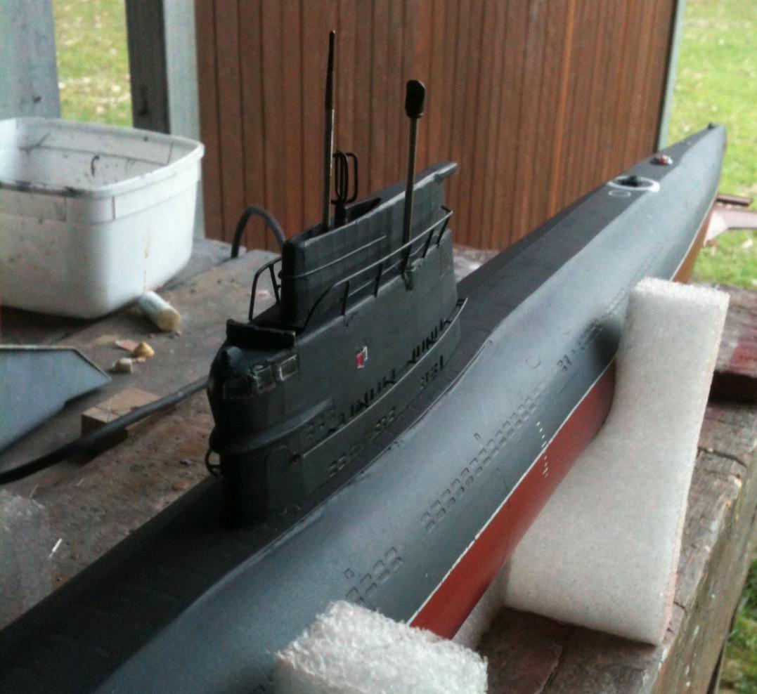

          Got the windows fitted today. Bit of filling required now.
          Also fitted the emergency buoys.

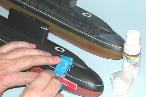

            #110
            Originally posted by Tirfing
            Beautiful! How did you add the White lines? Is it decal or just masking and a steady hand?
            I sent you a PM. Better read it.

              #111

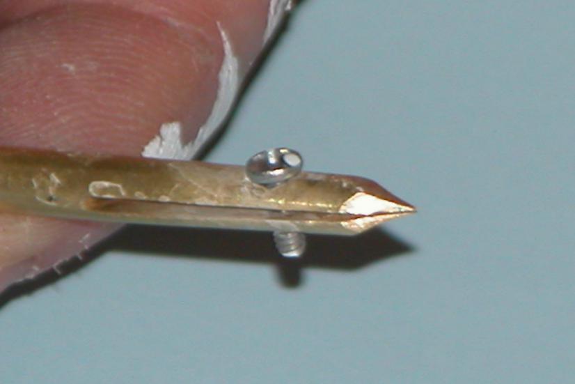

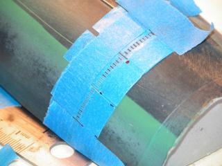

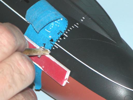

              Some ways to achieve draft marking bars:

                #112
                Hi David. Really interesting stuff, your markings. How do you do in the first photo? Are you cutting the tape to shape the lines?
                  • 13982

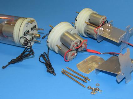

                  Can do. I'll pick up some 2.5" Lexan this week. Gas it is, sir.
                  OK, I got a length of 2.5" Lexan in the shop. How about this: five inches for the after dry-space (the three-motor motor-bulkhead is shorter than the other motor-bulkheads); five-inches for the ballast tank (even with the big gas bottle you have nearly nine-ounces of ballast water); and a six-inch long forward dry-space for the battery (which can be shortened if you go with a tighter battery pack if you wish).
                  The above comes in with a cylinder length of seventeen-inches (two-inches longer than the fifteen-inches you stated, but you can cut off some of the forward cylinder to make the fifteen-inches if needed).
                  I don't want to cut Lexan till we agree on the division of the three dry spaces (by the way, the seventeen-inches accounts for the thickness of the forward and after ballast bulkheads). So, Scott, get back to me ASAP and I'll start in on the two SD's (one for me, one for you).

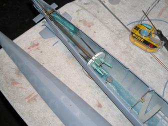

                  Here's the 1/72 FOXTROT and its three-motor SD -- pretty much like the unite I'll be working up for our ZULU's.
                  Click image for larger version  Name:	IMG_0131.JPG Views:	1 Size:	18.2 KB ID:	123027
                  Click image for larger version  Name:	DSCN0120.JPG Views:	1 Size:	16.0 KB ID:	123028
                  Click image for larger version  Name:	DSCN0117.JPG Views:	1 Size:	13.6 KB ID:	123029
                  Click image for larger version  Name:	030.JPG Views:	1 Size:	11.2 KB ID:	123030
                  Click image for larger version  Name:	DSCN0113.JPG Views:	1 Size:	15.4 KB ID:	123025
                  Click image for larger version  Name:	DSCN0123.JPG Views:	2 Size:	14.9 KB ID:	123026

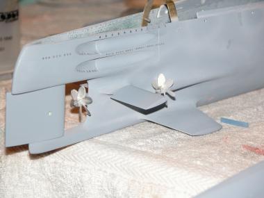

                              Not really Zulu but its filling in the time between Zulu tasks - the new tail for the Delta III.
                                • 13982

                                Scott,
                                OK, got your ZULU kit broke out and examined. First, pal -- a big improvement over your neat little ROMEO. You are on the 'fast' learning track, sir! Good job. And no significant warping of the GRP hull parts. And I love your breaking the upper and lower hull at the waterline.
                                Speaking of waterline ...

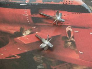

                                ... A 2.5" cylinder is way too big. One-third of it will be out of the water in surface trim. So, our SD's will be of the 2" flavor. I'm currently working on a gearing that will give us the three propeller shaft outputs from one single motor. Trust me, it will work. Pictures soon.
                                A 6" long ballast tank, using the 2" SD cylinder -- even accounting for the displacement of the gas bottle and conduit tube and other happy horse-**** inside it -- will give us a floodable volume of six ounces. By the way, I came up with the same above waterline weights (assuming that the GRP and resin have a specific gravity close enough to 1 as to not matter) as you did. We're on the same page.
                                I'm cutting Lexan tomorrow -- so get back to me if you have any heart burn with this arrangement, Scott.
