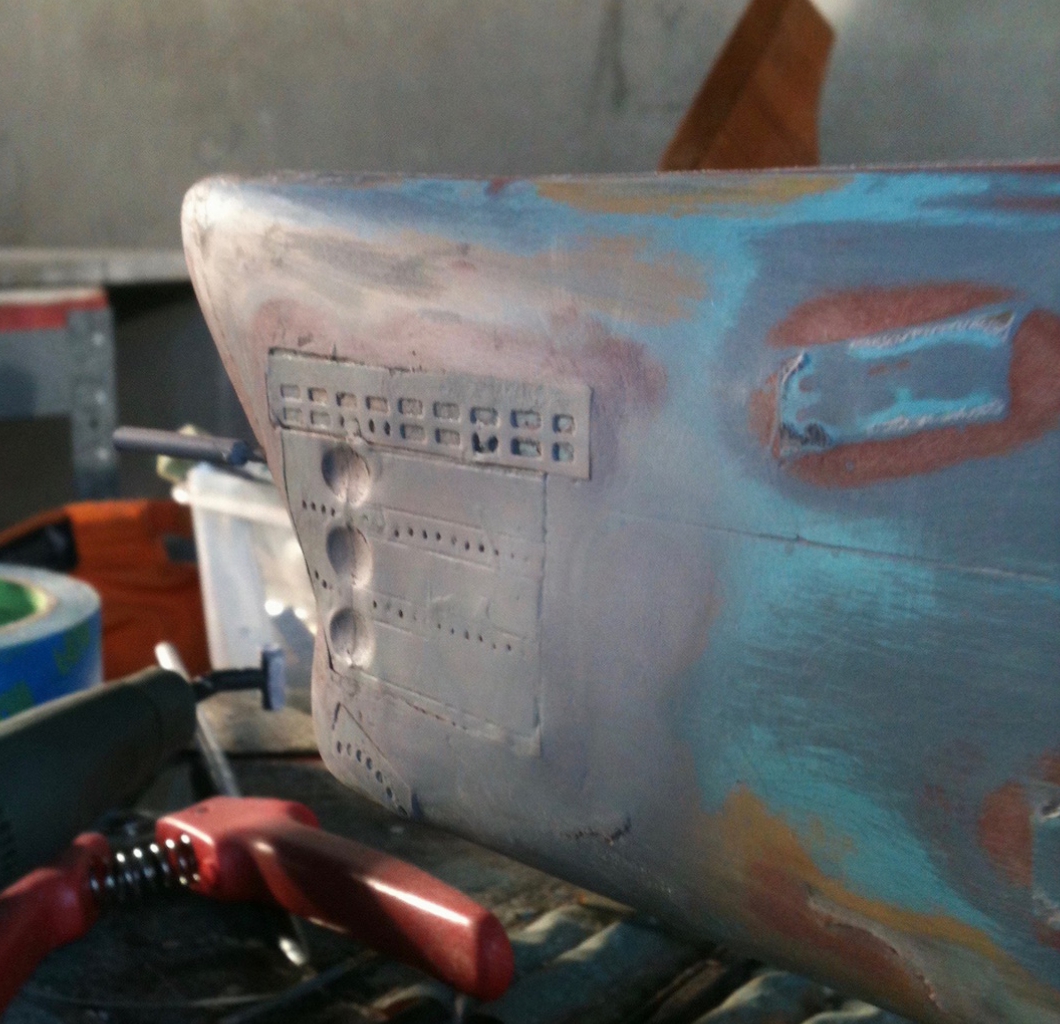

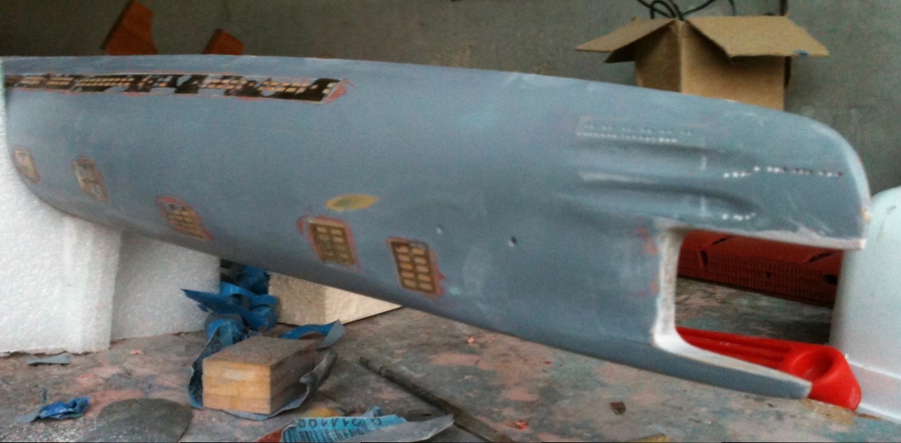

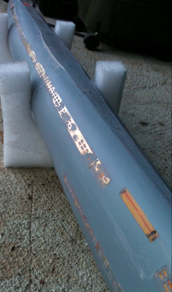

      The last few weeks have been spent finishing the brass etching and sticking the bits on the plug. Today it looks like this:

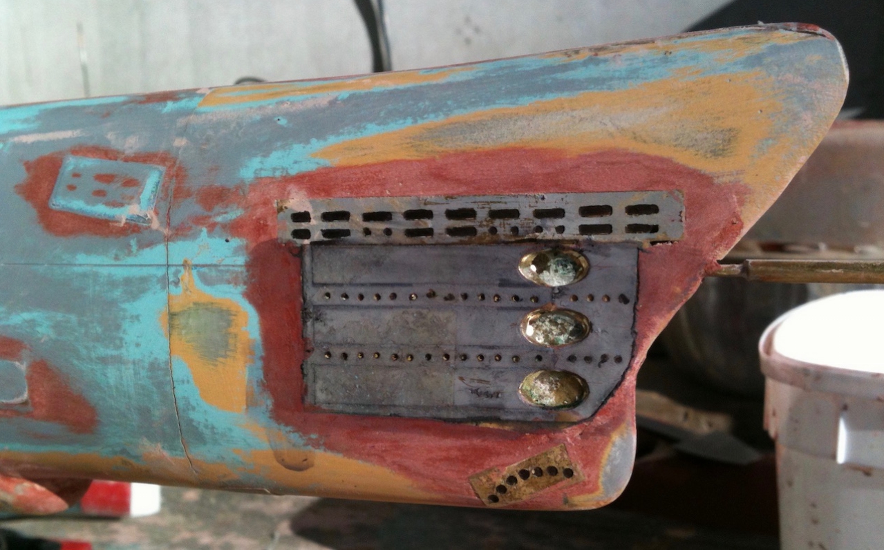

      I spent quite a long time getting the forward torpedo doors right:
      Still lots of sanding and filling to do but the basic idea is there.

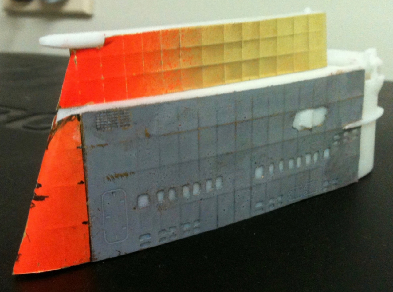

      I've also been experimenting with a technique of oil canning the sail. Not perfect yet but it shows some promise.

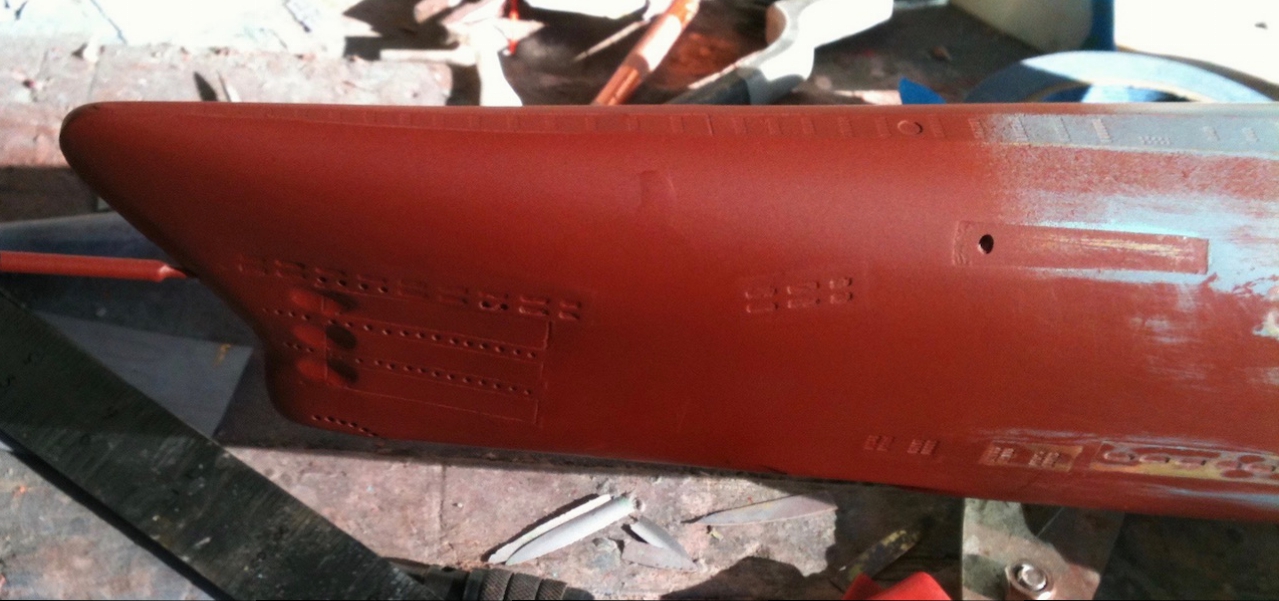

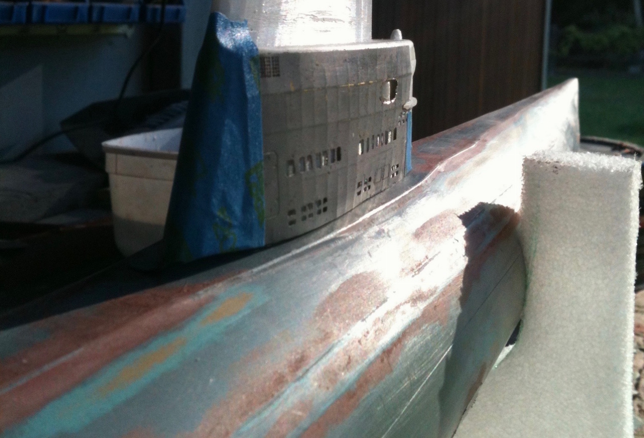

            More filling and sanding today.

              Starting to come together, pal. So .... give up how you did the sail dishing, already!
                #52
                Etched both sides of the brass sheet. On the rear I etched a grid pattern then used the end of a paint brush to press the brass against a flat surface. Instant dishing!

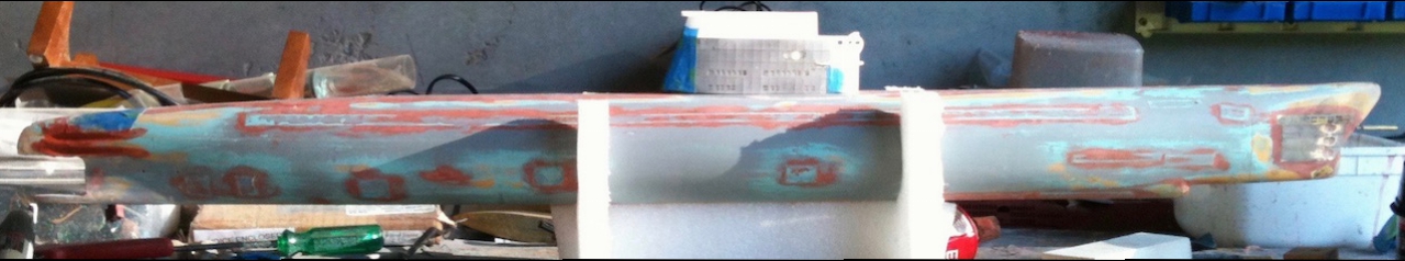

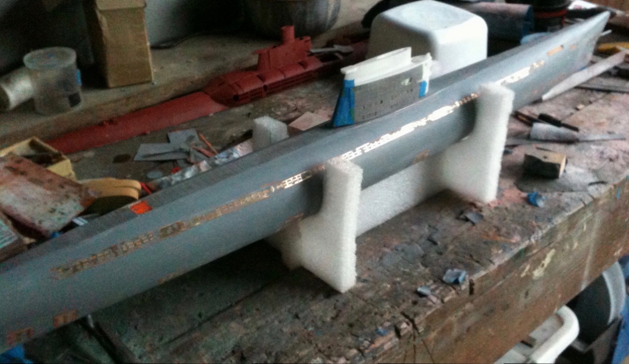

                  Sanding and filling, sanding and filling, sanding and filling etc etc and then repeat.

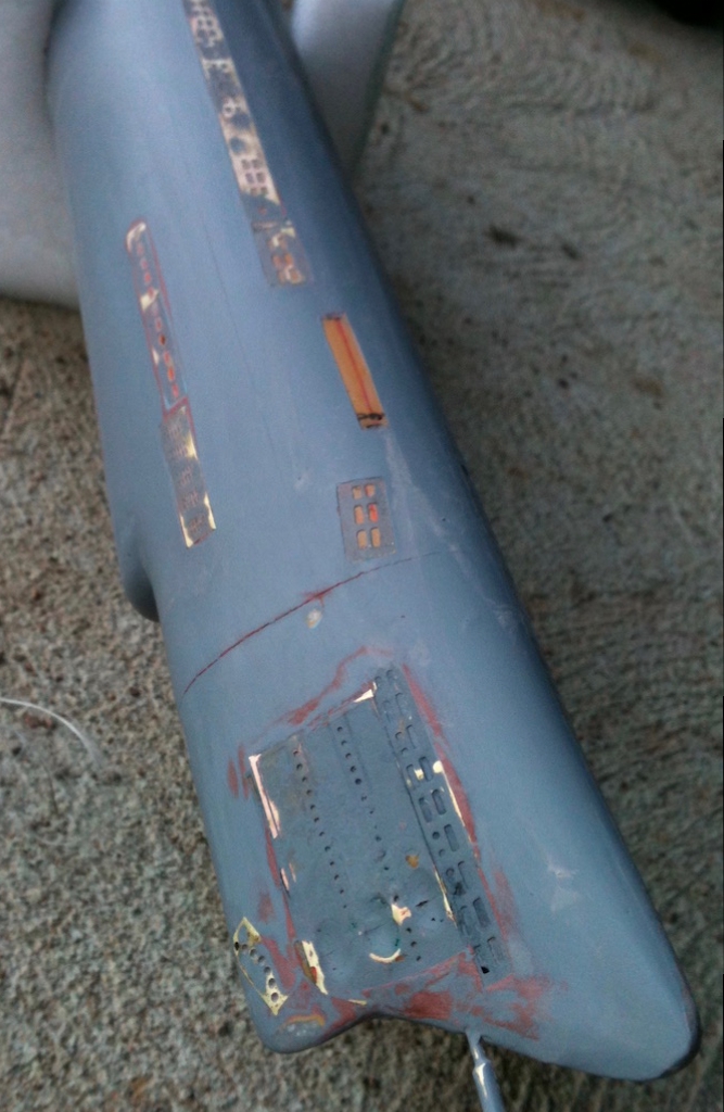

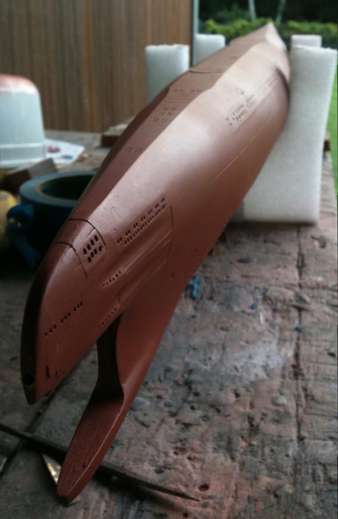

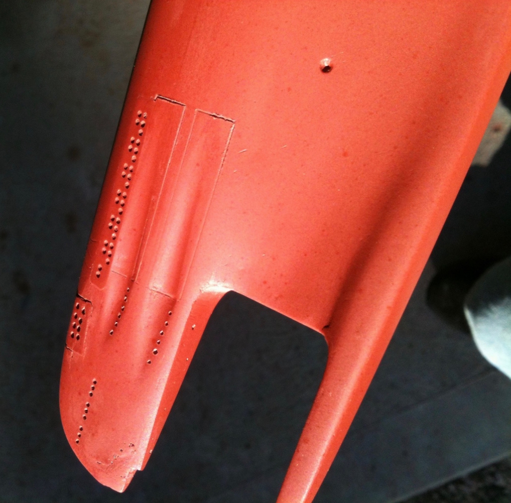

                        More work on the torpedo tube outer doors today.

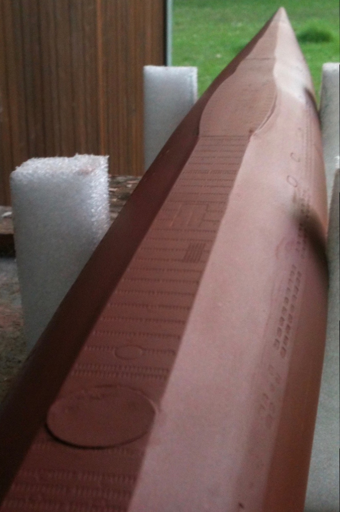

                            Getting closer.

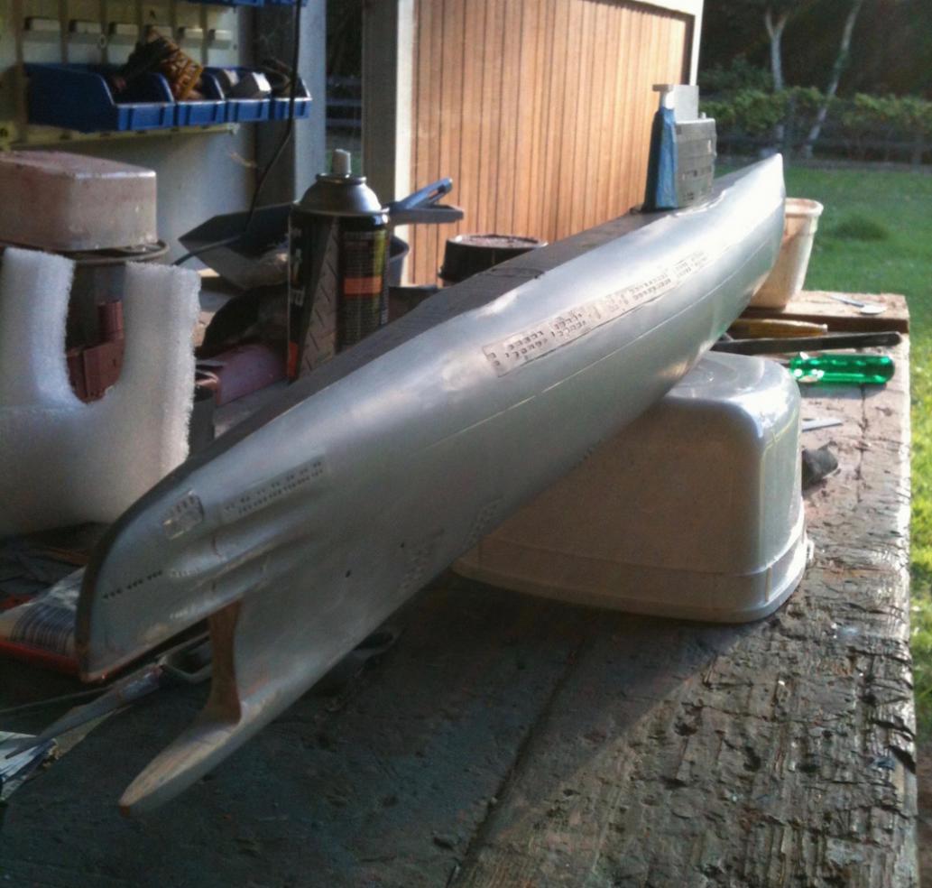

                                #60

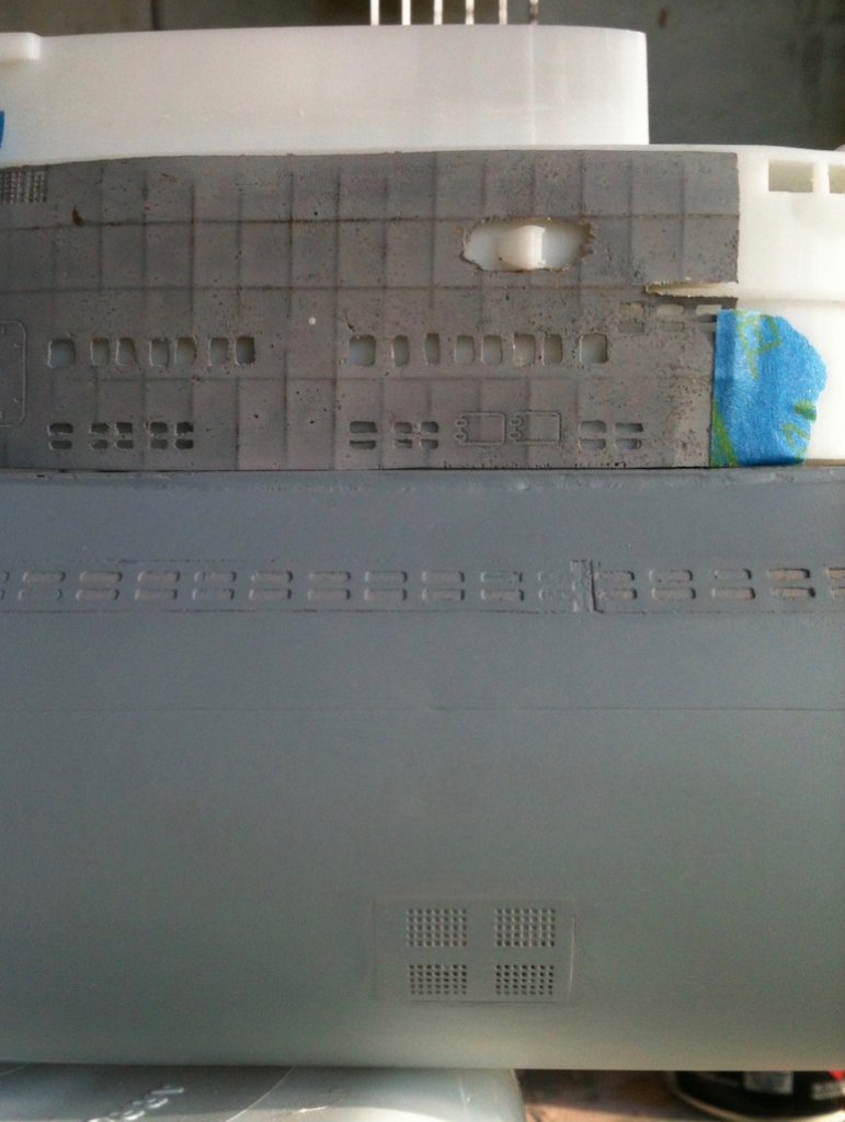

                                Some more work on the sail today.
