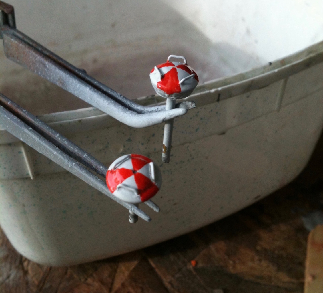

      Wobbly painting on the emergency buoys. Less drinking required.

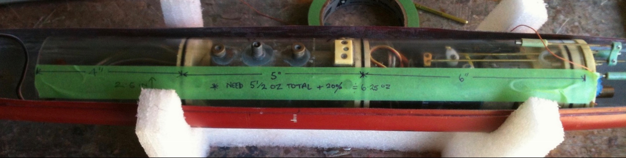

                Its a deal. I'll get over to the shed in a minuter and start slinging glass. The total weight of the above water bits is 5.25 Oz. If we add a 20% margin for safety that comes to 6.3 Oz of boyancy needed. This is a test fit of the 2.5 SD from my Alfa:
                There is plenty of room to make the SD longer if necessary.

                  Can I also ask a favour - can we make the new SD gas only please. I don't need the extra bits; gas works just fine for me.
                    • 13982

                    Can do. I'll pick up some 2.5" Lexan this week. Gas it is, sir.
