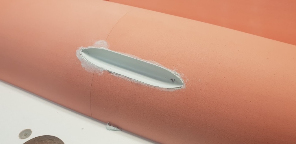

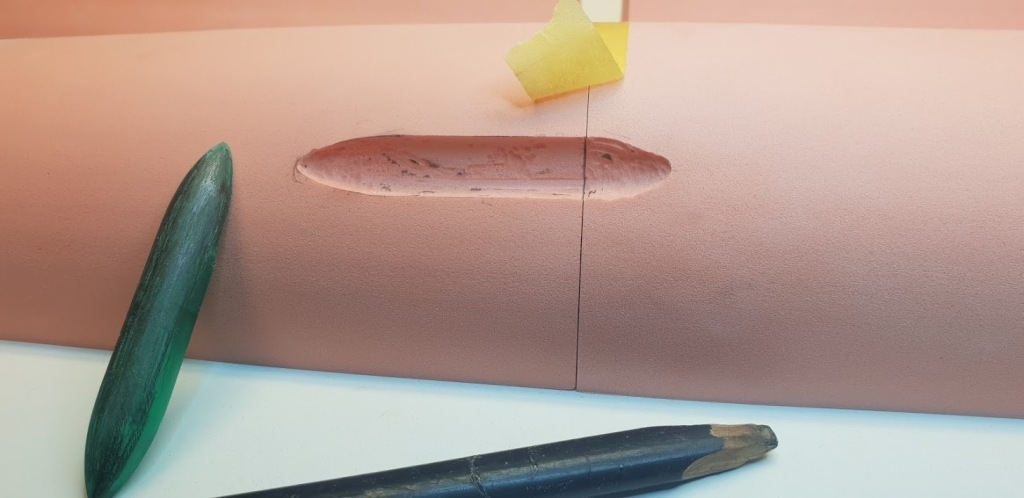

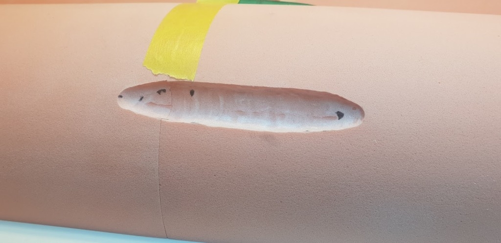

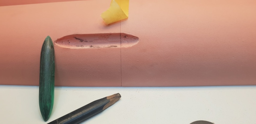

                    Scoop Recess:
                    Before gluing the hull pieces together I had to make the recess for the inlet scoops in the hull.
                    Hull pars were taped together.
                    Recess was roughly milled out with a proxxon hand grinder.
                    To mark the high spots of the recess the scoop was colored with a pencil and nested in the recess, a rolling motion was carried out, the high spots showed off clearly as black dots and can be grinded off. The process was repeated several times until the scoop was nested deep enough in the recess.
                    Hull parts were then clued together.
                    Release agent was applied on the scoops, EUREKA putty was applied (polyester finishing filler) in the recess and the scoop was pressed in, excess filler was squeezed out and scraped away. When the filler started to harden out the scoop was gently removed from the recess, the result is a recess that is a perfect footprint of the scoop.
                    Grtz,
                    Bart

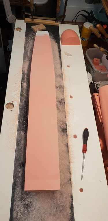

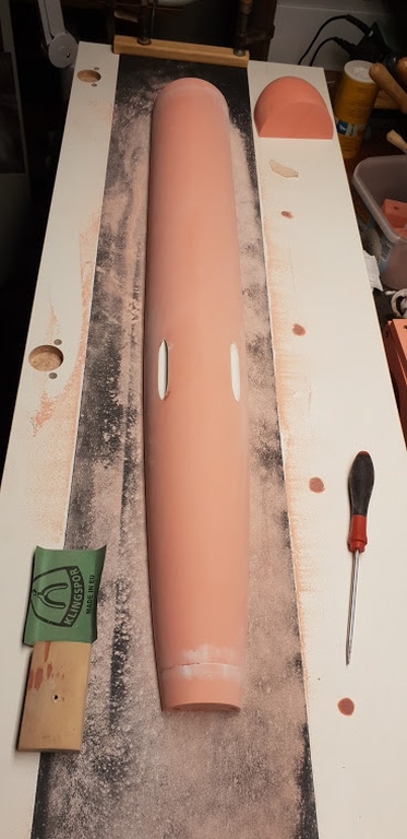

                            As my surface table that I had constructed for the AKULA turned out to small I had to fabricate a new surface surface/table that would fit the V3 hull’s.
                            All sections (4pc) of the lower hull were glued together. The small aft section needed some TLC, EUREKA putty was applied to level up the piece with the other sections.
                            The mating surface of the lower hull was then sanded completely flat on the surface table.
                            It took me quite some time to purchase the grinding paper you see on the surface table, yeah it is one piece.
                            The seams of the different sections were dressed up with the same putty and sanded down.
                            The lower hull is ready to take her first coat of primer.
                            Tomorrow the upper hull will take the same treatment.
                            Grtz,
                            Bart
