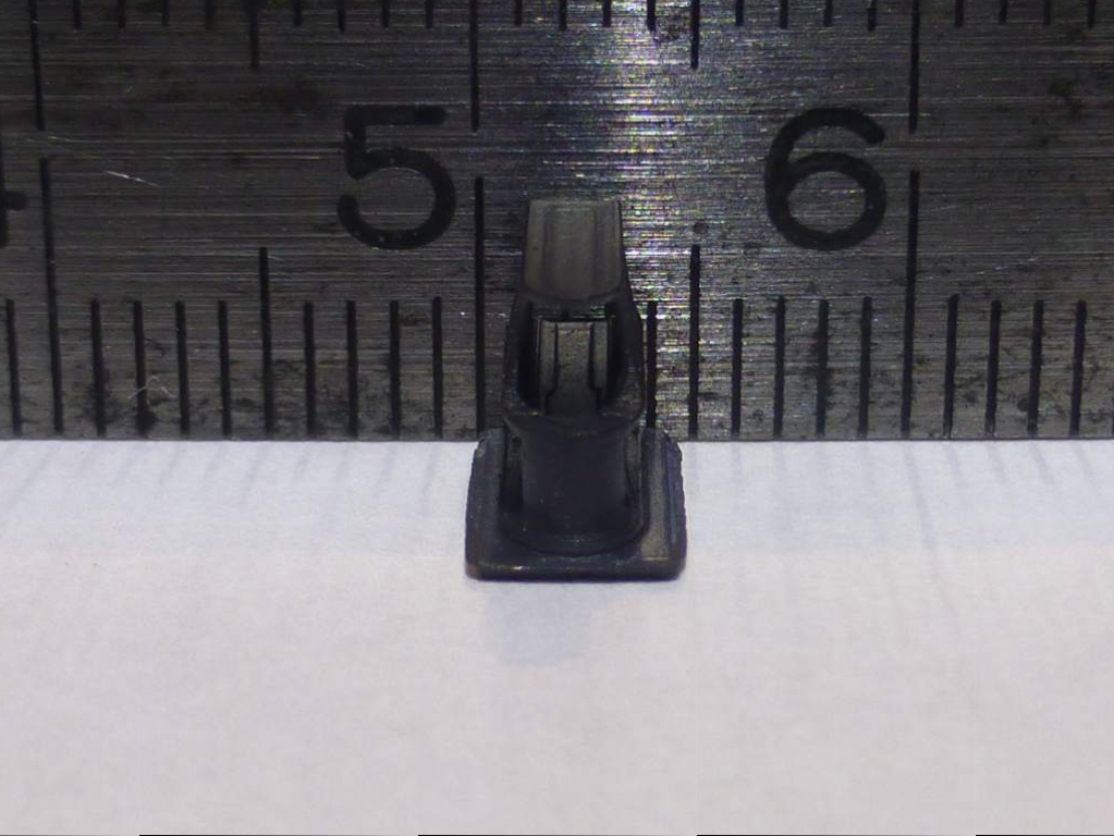

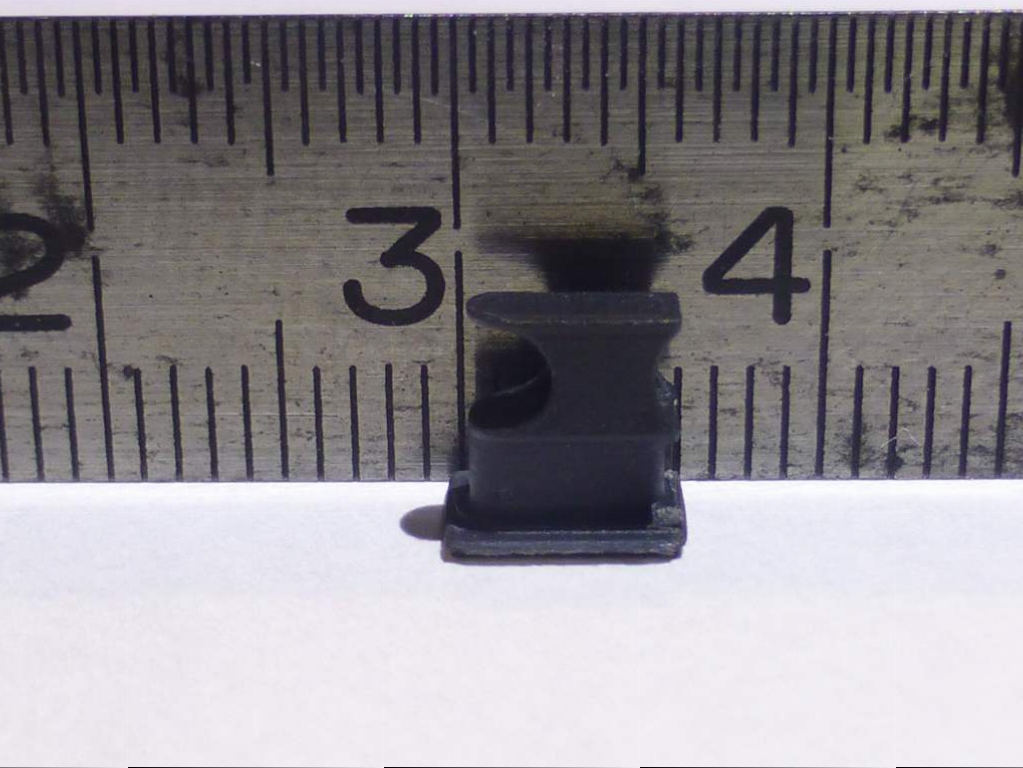

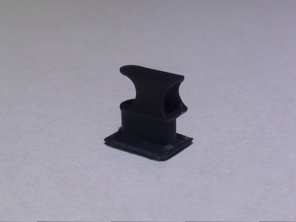

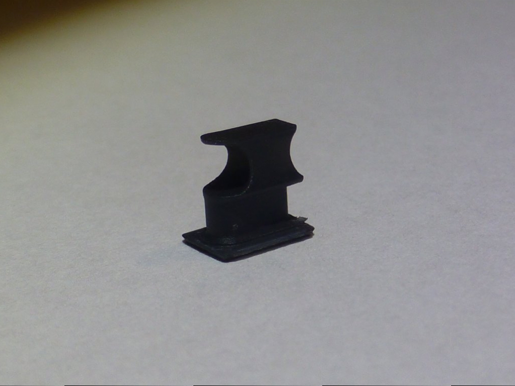

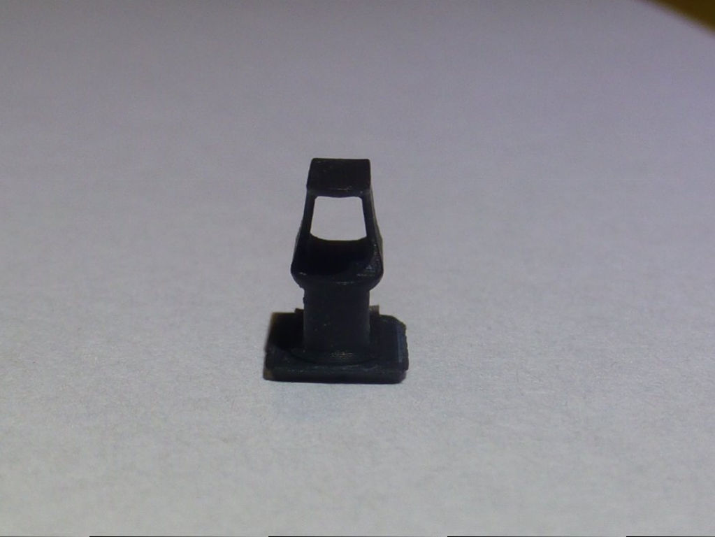

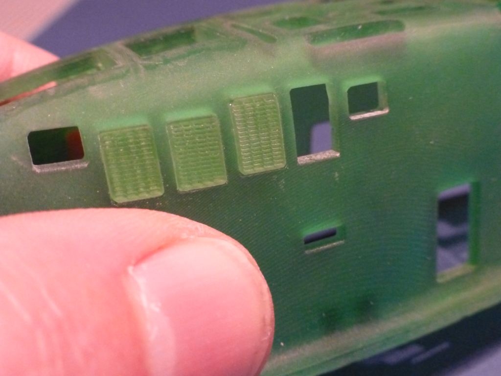

              When I say high detail, I actually mean HIGH DETAIL.
              One of the SOKS censors (yes I went over the top, yes I’m crazy)
              Pictures were taken with the macro setting of the camera, dimensions are in mm.
              All credits to "the machine"
              Grtz,
              Bart

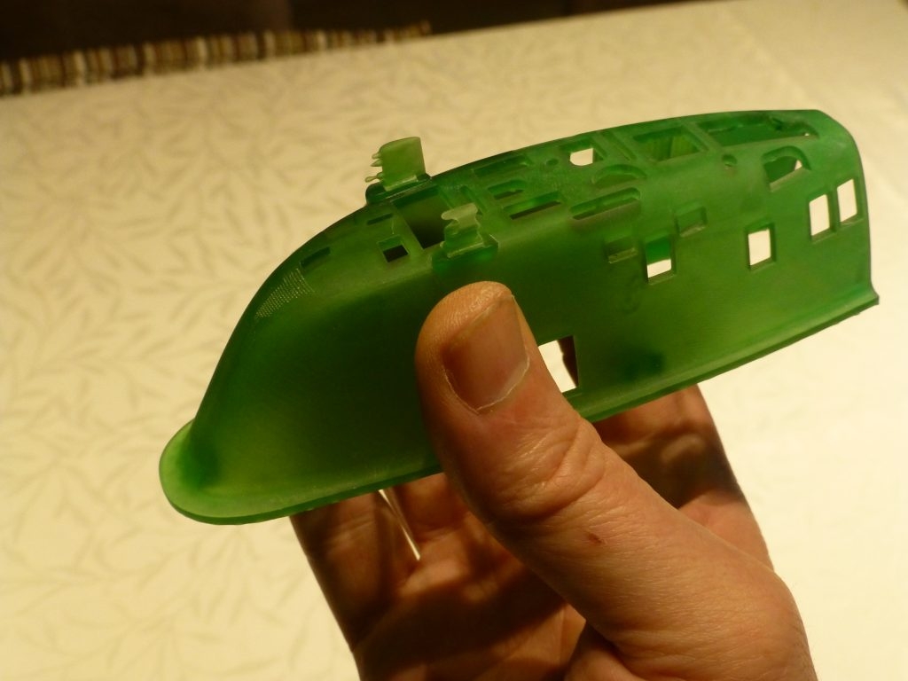

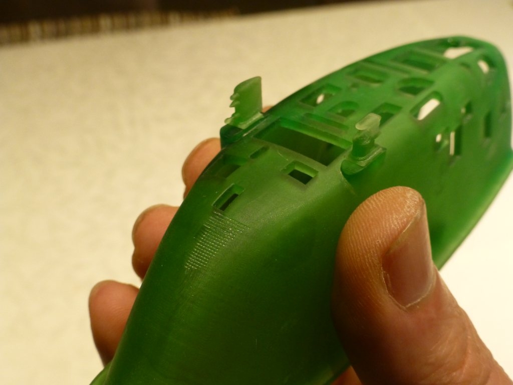

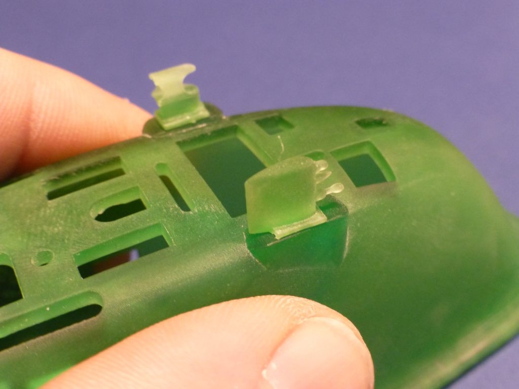

                Concentrating on the sail now. Test-fitting the SOKS and making the louvres fit.
                Grtz,
                Bart

                  Outstanding! How did you make the louvers? AND, did you cut the holes ans slots or cast them - I can't tell.
                    • 3768
                    #114
                    3D printing,Skill!
                        Everything was done by the machine this time Scott....I only assembled the parts, made them fit.
                        The sail will be cast with the holes......louvers will be after fitted.....hatches and doors you must do yourself.
                        My idea behind it is that you can chose if you want certain pieces in open or in closed position......radar, periscopes,.....
                        Grtz,
                        Bart
