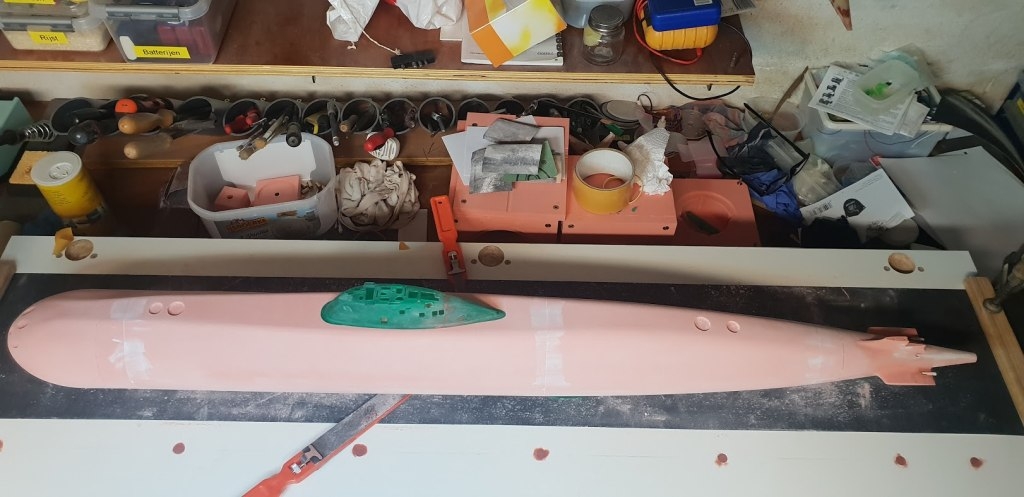

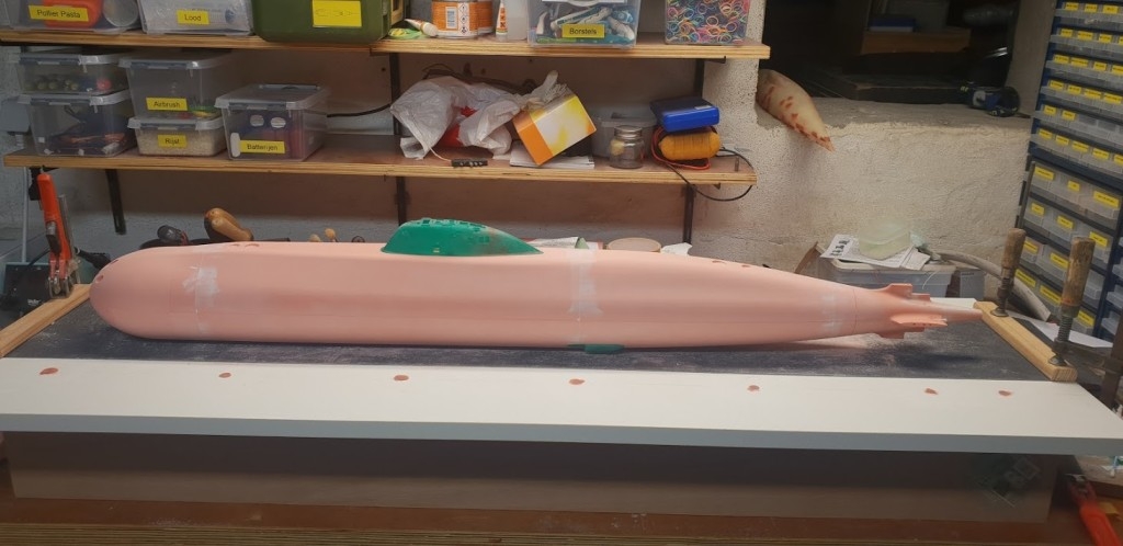

      First time the hull parts were mated....yeah she looks beefy.
      The transition of the bow/stern and hull was sanded till all was smooth.
      Saterday next all will be primed.
      Grtz,
      Bart

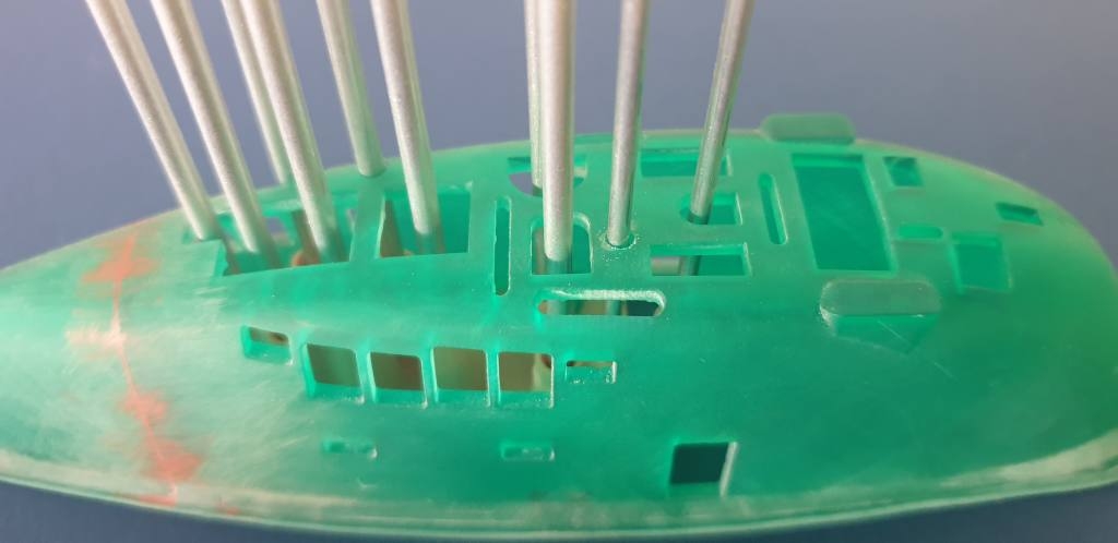

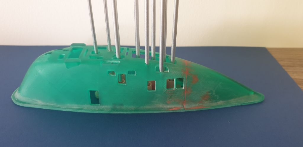

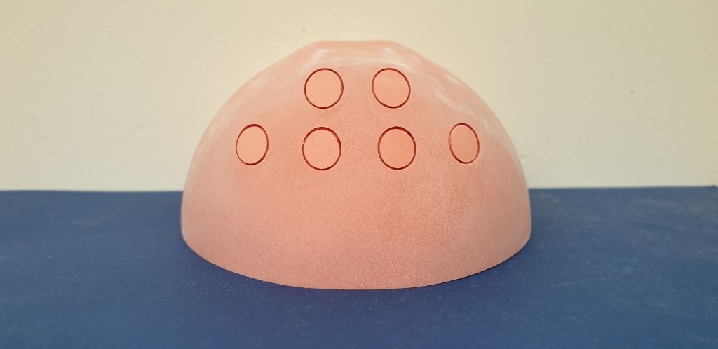

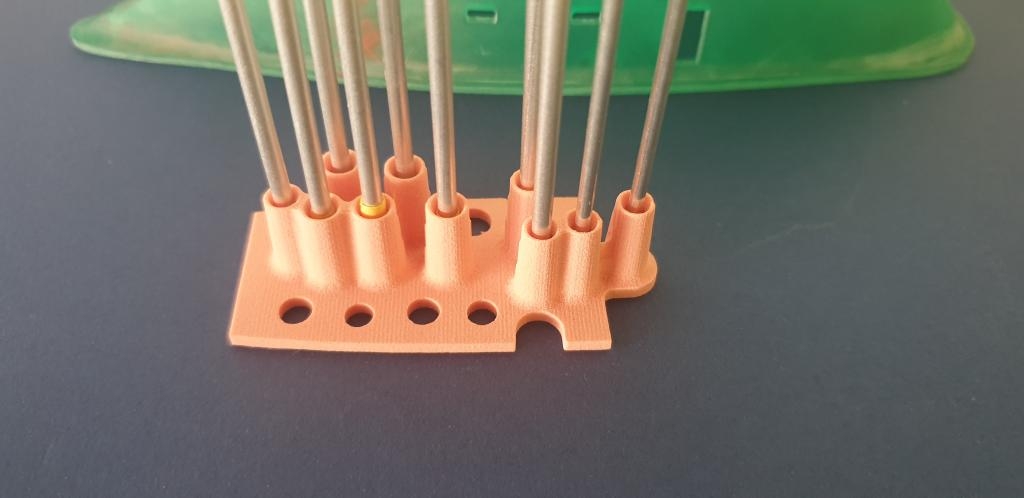

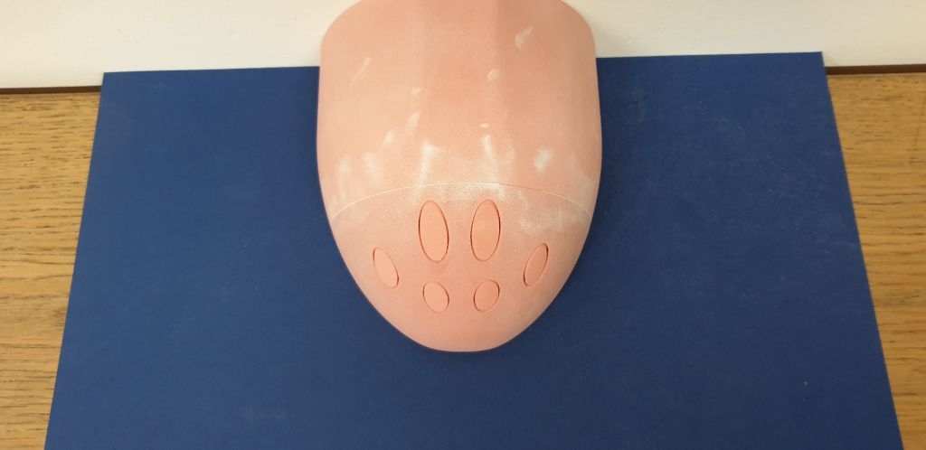

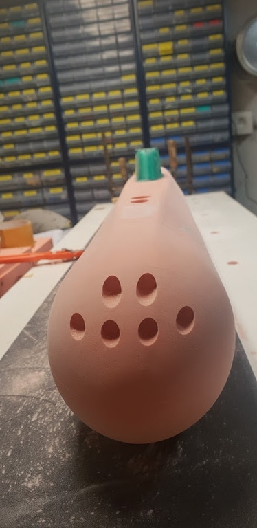

                Where I left it.....I have been quite busy on the job, I truly had no time left to do anything else.......I took some time off now……..reunited with my V3 this weekend.....don't worry I spare you guys the details.
                Been working on the mast support…….now I’m working on the torpedo hatches.
                Grtz,
                Bart

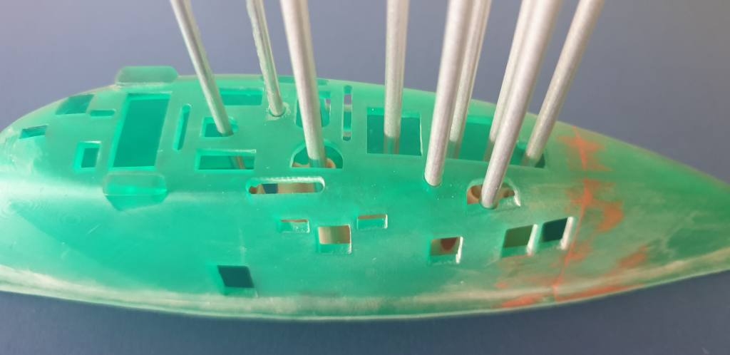

                Made a support for all the masts….the most challenging was to get them positioned in the center of their specific hatches.

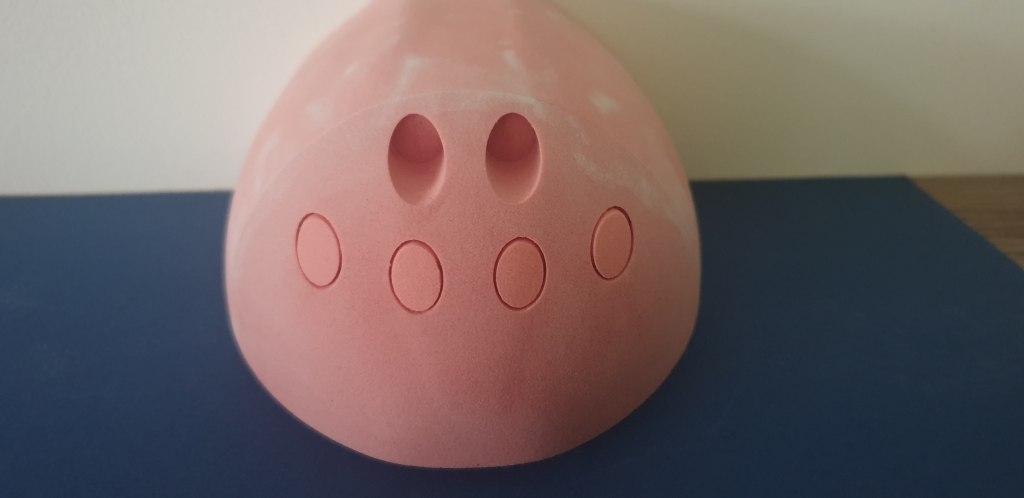

                Test fitting the lower torpedo hatches….probably I will glue them in place tomorrow.

                  #143
                  That looks great! How did you make the mast support?
                  • bwi 971
                    • Jan 2015
                    • 940
                    #144
                    Milled it......drawn it first to get all the dimensions right.
                    grtz,
                    Bart
                    "Samuel Smiles"

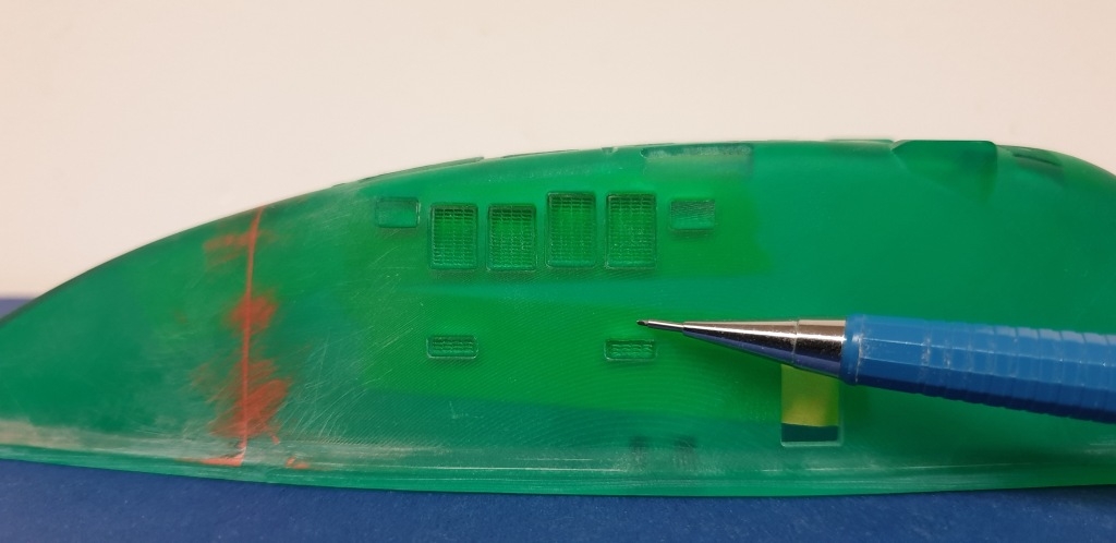

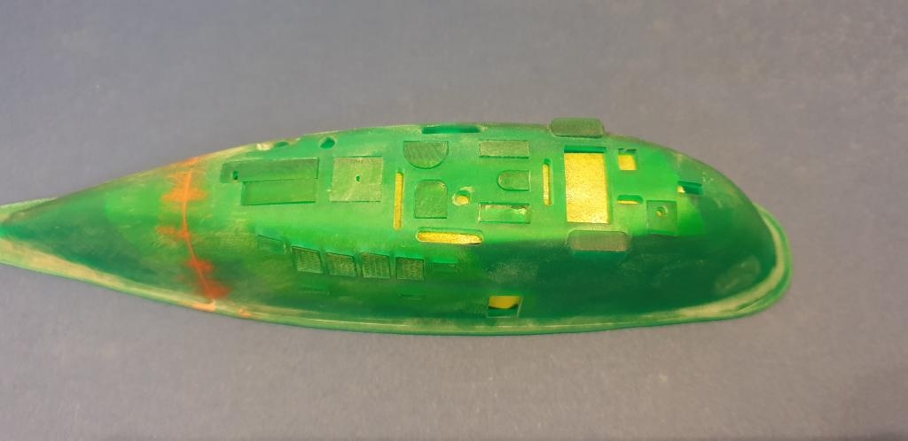

                          So glad I’m back here with you guys.

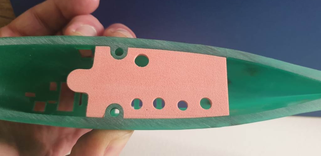

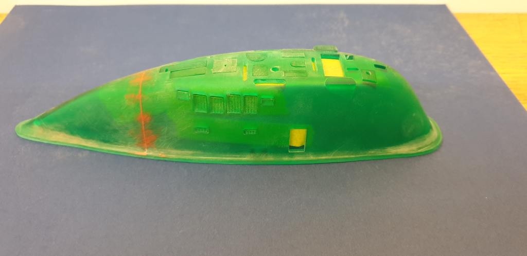

                          Finished the upper torpedo doors.

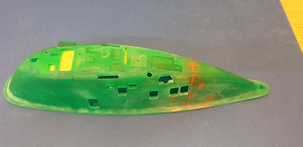

                          Started preparing all the hatches and gratings in the sail. The gratings will be integrated in the sail for casting all the upper hatches will be casted separate so one could choose to place them in an open or closed position.

                            #148
                            Oh good grief. I'd forgotten what a MANIAC you are! Its only when I see that pencil next to the sail that I realize how finely detailed it is. Great work Mate.
                            • bwi 971
                              • Jan 2015
                              • 940
                              #149
                              If I ever go larger then scale 1/72 it will kill me for sure.
