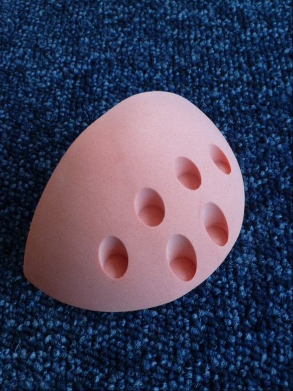

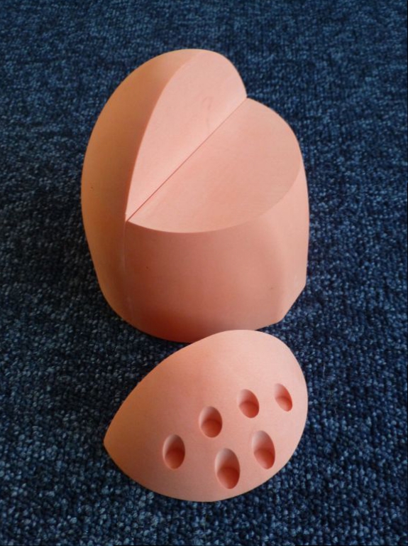

            OK, Bart. Lets see the drilling jig you made to get those holes just right.

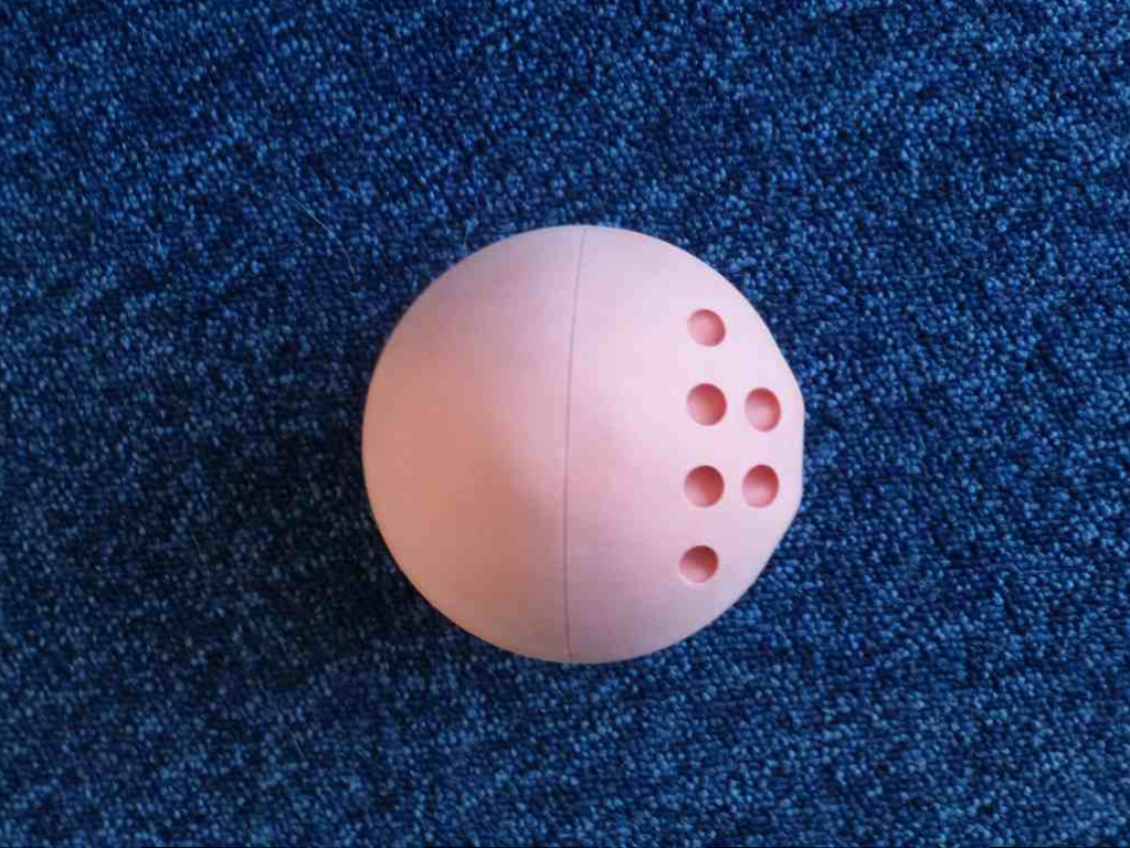

            I did not use a jig David
            I designed the bow piece with the torpedo tubes as a separate section. This way I had a stable & rigid platform with a very low profile.
            My first thought was to fabricate some plugs that go into the tube holes, 0.5mm smaller in diameter, so I will obtain a scribing effect. But looking at them now I think they look awesome without. For the potential assembler is would be nice that he could chose, leave them open or put the plugs in.
            However, the later will mean that I have to integrate them when I layup the bow with fiberglass, probably I can only pull that off is by using chopped glass fibre.
            Grtz,
            Bart

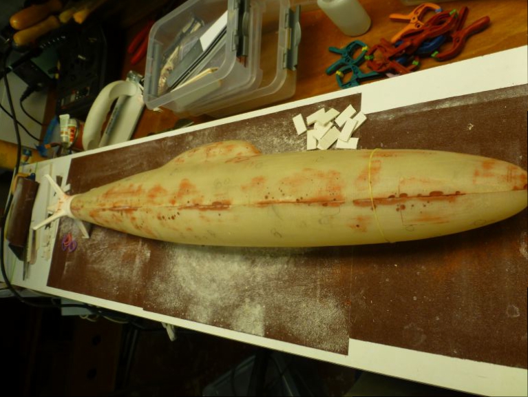

                      Continued since last monday on the VCTOR III and started to work on scott's BELUGA.
                      Cut off the excess and sanded the parting lines on the hull halves, they match perfect good Job scott
                      Filling the pinholes with putty at the moment.....think I will finish it today.
                      Tomorrow I will post the progress on the VICTOR III
                      Grtz, Bart

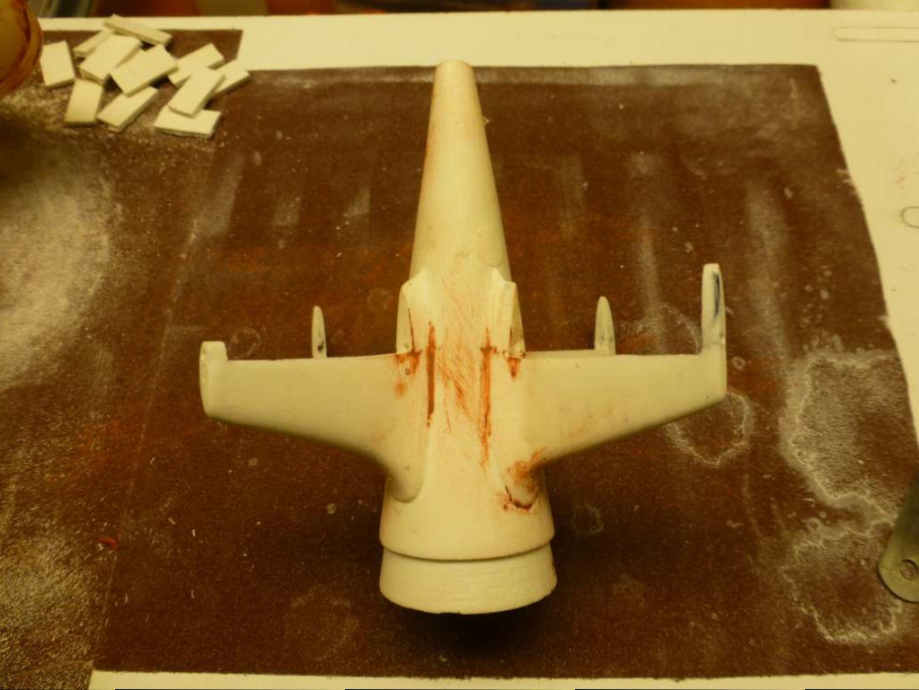

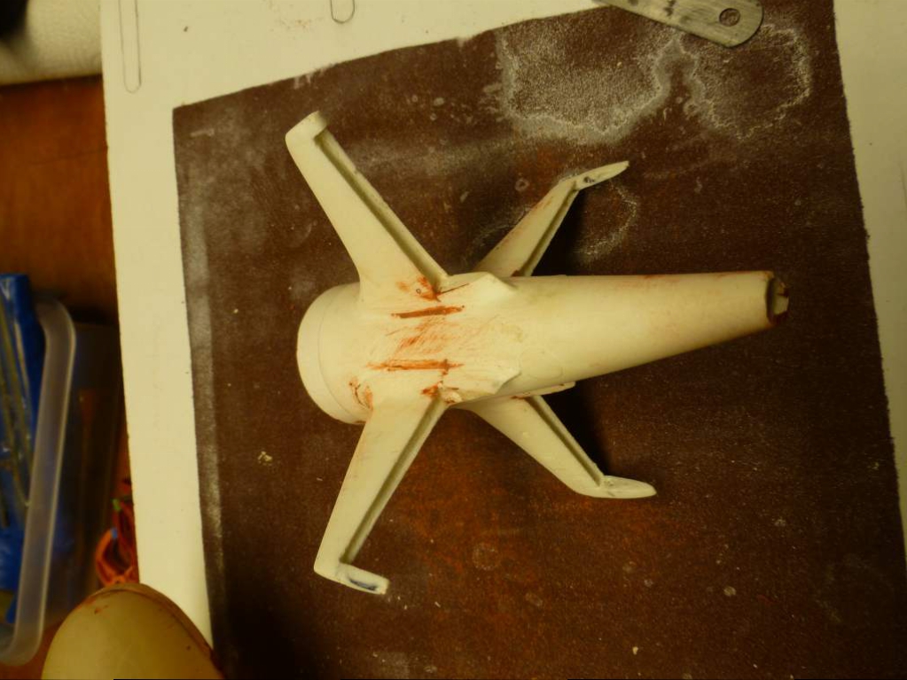

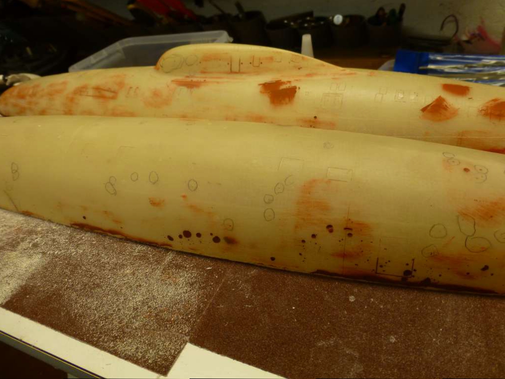

                      Parting line.....easy life.....just sanded it down to the transition line gelcoat-cloth Click image for larger version  Name:	P10502064.jpg Views:	1 Size:	267.4 KB ID:	128015
                      Click image for larger version  Name:	P10502075.jpg Views:	2 Size:	229.0 KB ID:	128014

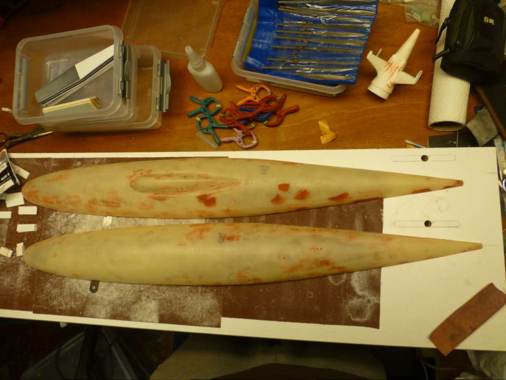

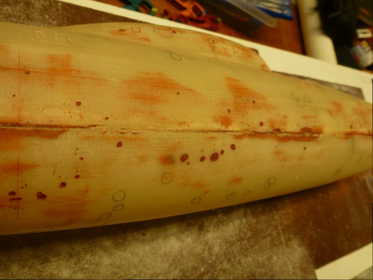

                      Filling the pinholes....some done......others discovered and marked with pencil.
                      When sanding all the scribing Scott did pop out clearly, amazing how much detail there is. Click image for larger version  Name:	P10502042.jpg Views:	1 Size:	408.2 KB ID:	128018
                      Click image for larger version  Name:	P10502053.jpg Views:	1 Size:	390.6 KB ID:	128016
                      Adressing the tail piece that came along.....well done.....will make life easy assembling this beauty.....darn I love this sub already.....this will be my daily driver for sure. Click image for larger version  Name:	P10502101.jpg Views:	1 Size:	412.4 KB ID:	128011
                      Click image for larger version  Name:	P10502086.jpg Views:	1 Size:	191.5 KB ID:	128012
                      Click image for larger version  Name:	P10502097.jpg Views:	1 Size:	387.5 KB ID:	128013
                      "Samuel Smiles"

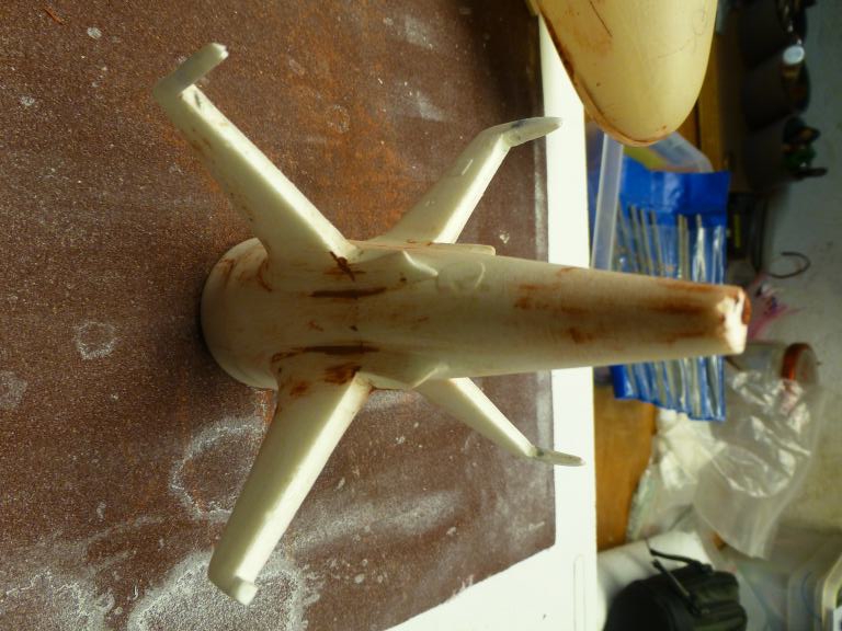

                                • 2642
                                #90
                                That first picture suggests the boat would look great with an an x-tail configuration. Not scale, but I bet it would a hoot to drive, especially with full flying control surfaces. Crossfire-Beluga!
