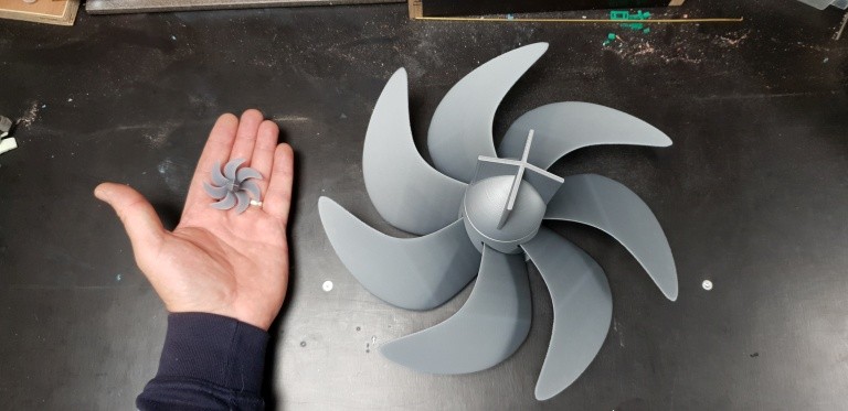

    Why and how did you print the large one?
    • bwi 971
      • Jan 2015
      • 940
      #272

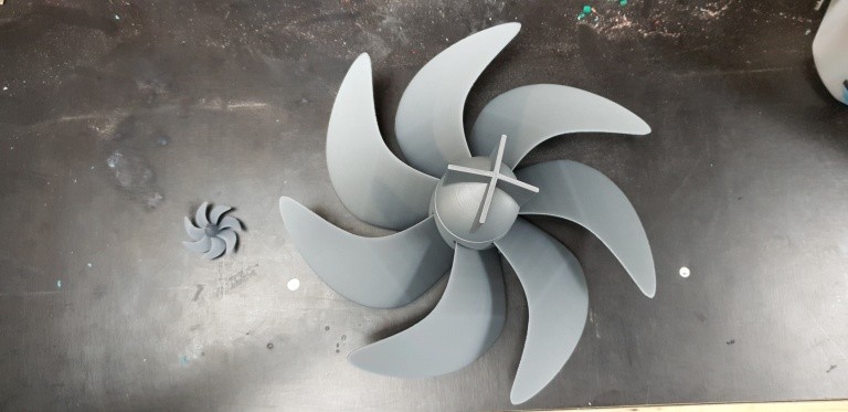

      Just to see if I could.......I will hang it on the wall in my workshop.....on a FDM printer......I used supports......27hr and 3 attempts later I popped it of the bedplate.

        Originally posted by bwi 971
        48 vs 288mm.

        Holy Crap!!!!!

          Novelty deskfan for the warmer weather.
            • 3767
            #275
            Ohhh or ceiling fan......Very cool Bart!

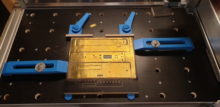

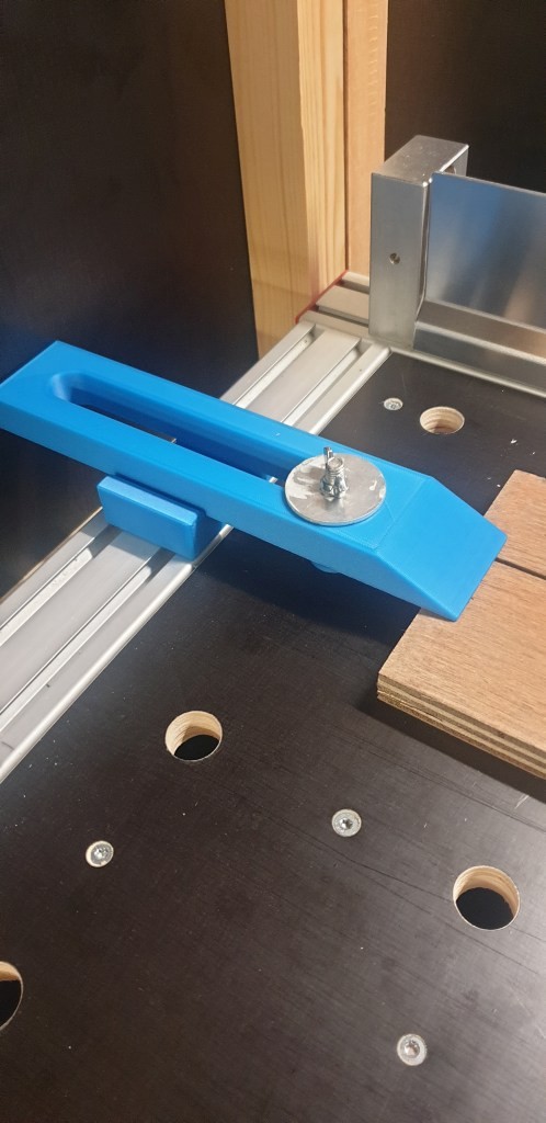

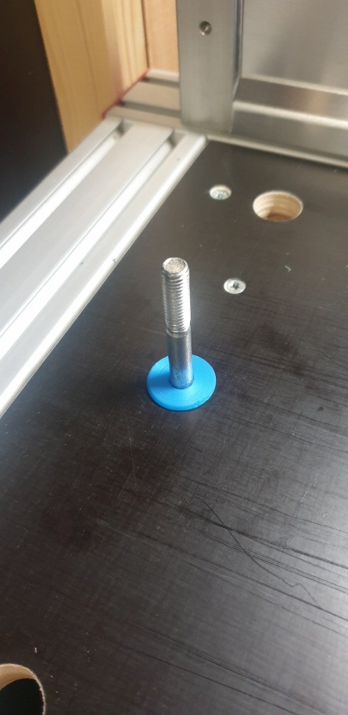

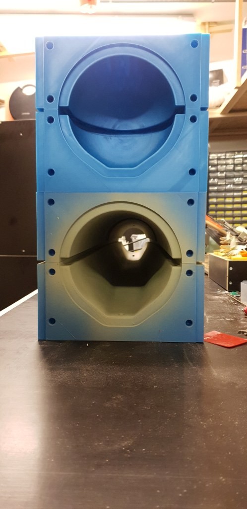

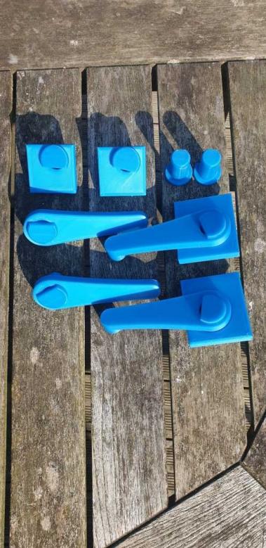

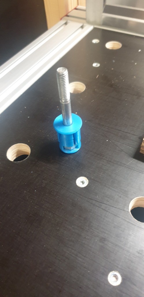

                Crazy times at my real job, workload is like a sinus......I did manage to do some various works over the last weeks.....most of it was making jigs and tools.
                Designed various dog clams for the CNC (excentric and normal clamps, pins,.......), I needed them to make the brass stribing stencils.

                Clamps at work

                Finished the mother glove hard shell tooling to take the silicone.

                  Never considered printing clamps and holding jigs - now I feel stupid. What a logical idea and very well done. I shouldn't be surprised though, when I had ships in Cebu the yard engineers used to make most of their own tools. They'd take two paddle pop sticks, a piece of tin, some alloy rod and a rubber band and have a fully functioning turbo encabulator by the end of the day!

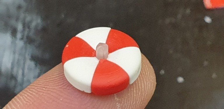

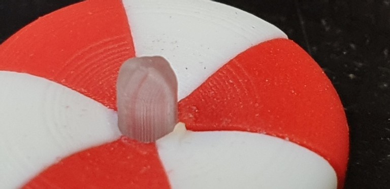

                        Hi Guys,
                        What I wanted to change from my AKULA built was the painting of the escape module hatch and emergency buoy. It was a PITA to mask and paint the red and white sectors.
                        This is the result on my efforts to work around that.
                        The buoy is provided with a light, I managed to add the protection bars for the light.
                        Also included the bolts on the escape module hatch.
                        Grtz,
                        Bart
