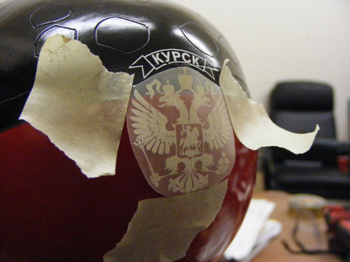

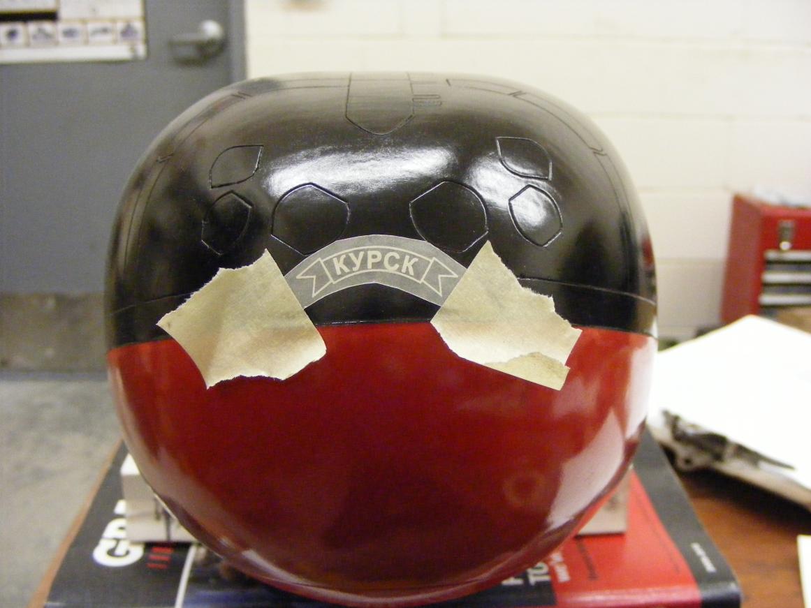

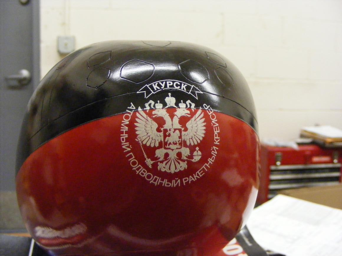

      VICTORY!!! The middle one posed the problem. After anchoring it with tape to keep it in alignment I started in the middle and worked myself out and around.Pressing the wrinkles down with my fingers and burnishing the surface with the end of a small artist paint brush. It came out well. You can see a space in the neck of the right side bird. Ill get some white paint on the tip of a fine tipped paint brush and touch it up. It could have been a disaster but it all worked out. Before I can put the decals on the sail the next thing will be to install the window frames on the sail.

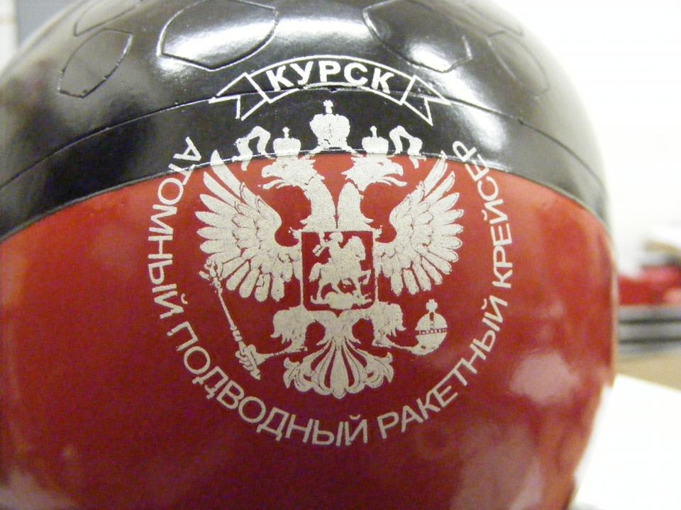

                      Here is a picture of one of the Oscars with its coat of arms applied, its a little smaller and mounted a little lower than the one on the Kursk..Click image for larger version

                        Shame they stuck it that low down - only see it in drydock views.
                        I guess however if you could readily see it in surfaced running, it being individual art, would be like taking out an ad for Nato as to the exact boat. A nice detail nonetheless.

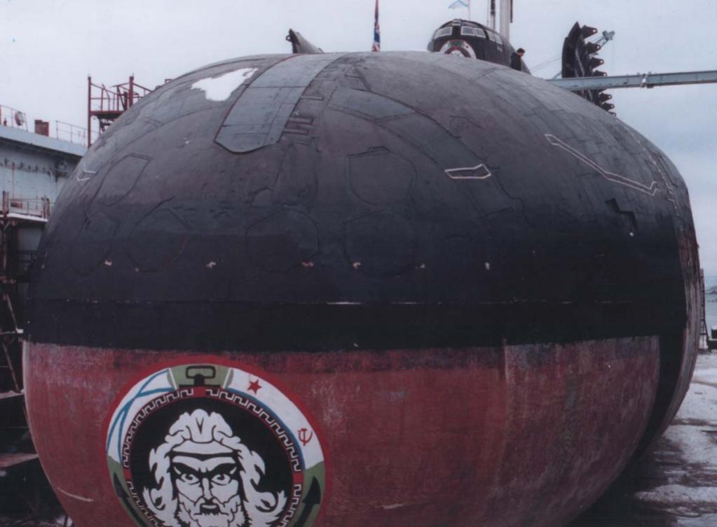

                            This is a shot from Scaleships. Note how they blacked out the roundell where the front crest on the bow goes. I dont know if that is scale or what , the drawings dont indicate. Its too late anyway, and that thin white line indicating the waterline is too much of a pain for me to attempt. Ive got bigger fish to fry..Click image for larger version

                              Looks to me as though Vladimir's put his crest on too low, and by the photo I've got it ought to be gold not white. (But the black paint inside the crest appears correct though.)
