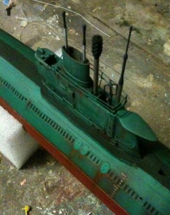

        A frustrating day at the cave dealing with other ****. Hopefully I'll get it in the water tomorrow. Meanwhile I have been playing with the safety bouys.

          #139
          And the other one that didn't show up for some reason?
