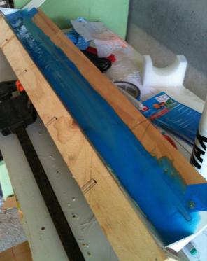

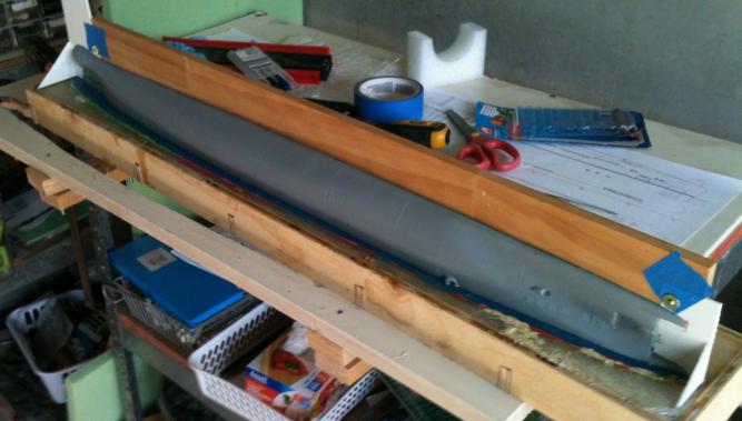

      Getting on with the bottom hull halves. Click image for larger version
      Thos is the lower right half in the moulding frame.
      And post gloop. The gloop in question is a two part silicon rubber with a thickening agent. Once it goes off I'll add some structural support and fibreglass to create the lower right mould. I'm in for some fun later on however, because I FORGOT TO SPRAY THE BLOODY THING WITH RELEASE AGENT!!! The silicon will part with the plug and the other bits and pieces but it will stick to the silicon in the upper mould like **** to a blanket.

        #93
        No sweat, use a very sharp knive to follow the lines from your topmold, offcourse before you start to reinforce the lower mold, happened to me with making my divingplanes from the V80 , simply used a knive, it saved me making another mold.
          #94
          I read about your diveplane casting mishap and STILL I managed to forget the release agent. A sharp knife it is.

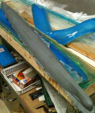

            #95
            This is the lower left side - about to be glooped.

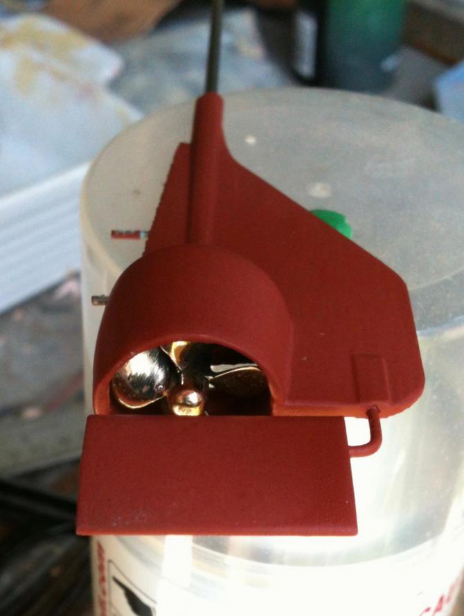

ID:	119111And the rear appendages are coming along too.Click image for larger version

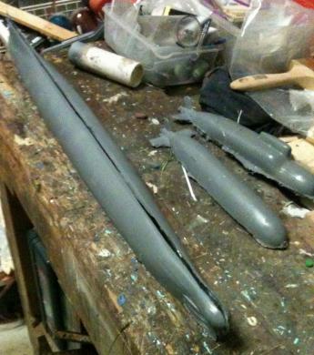

                Just out of the moulds. Click image for larger version
                All the detail is there and they came out pretty well. I did some practice first using the old Losos moulds before doing the left and right hull halves.
ID:	119237I'm going to join those up this afternoon and have a go at moulding in some SD saddles in the process.
