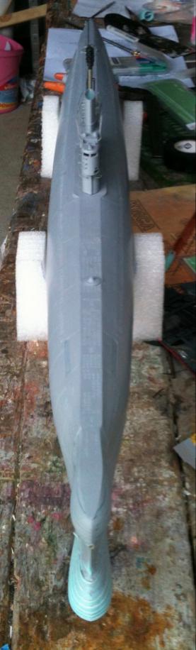

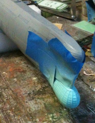

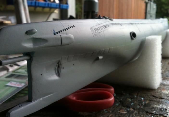

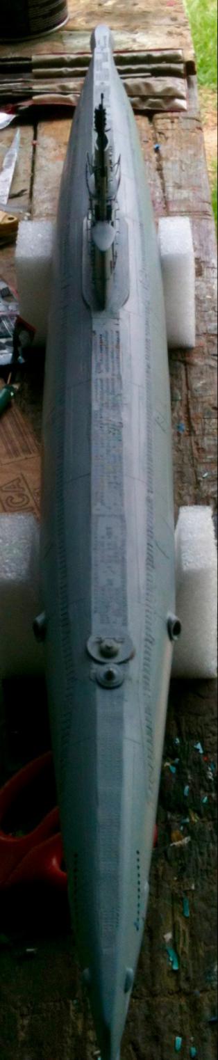

              Its a rather warm 45 degrees C in my workshop this afternoon. (That's 113 F for you trogladites who refuse to be dragged into the metric age). Not much happening as a result other than a few experiments to see how things might go. Still haven't found an acceptable way to replicate the coverings on the sonar domes.

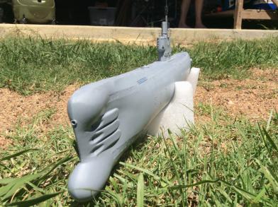

ID:	118789 Nice work Scott,
                I am am hanging for this much anticipated southerly to come through, beach was packet this morning. Sweltering here even our air conditioner is struggling, Good to see Romeo yesterday, great to see even further progress,

                  #68
                  Who's that dude in the background with the chicken legs? Oh, it me!
                    #69
                    Geeezzzz Dave, do you own a photo editing program - just sayin'

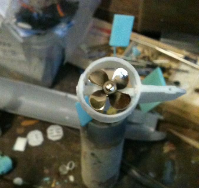

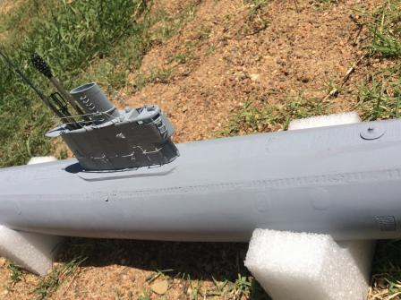

                      Props arrived today. Hurrah!!!

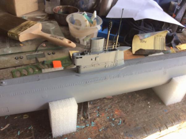

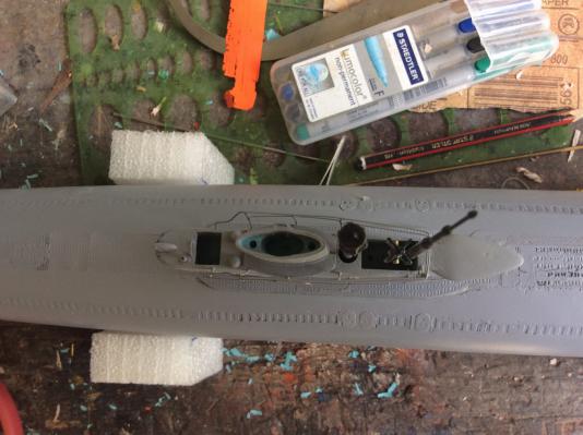

                      And I have devised a plan to do the dome. I'm going to sand the bejesus out of this once it dries and see what it looks like.

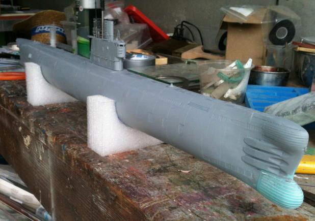

                        I don't often fawn all over someone's project. But .... I must say: Wow! This ROMEO is a real piece of work. Well done, sir! Love the dishing between frames and stringers effect you achieved on the two domes. This attention to detail, and credible representation, is an eye catcher. Oh, yeah, you'll have to paint this one green. You know that, right?
                        OK, enough kissing your ass. Finish it!

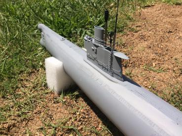

                                I think I'm done. There could be a lot more scribing (and repairing of scribing) but its heading for overkill. Waiting for the silicon to arrive.
