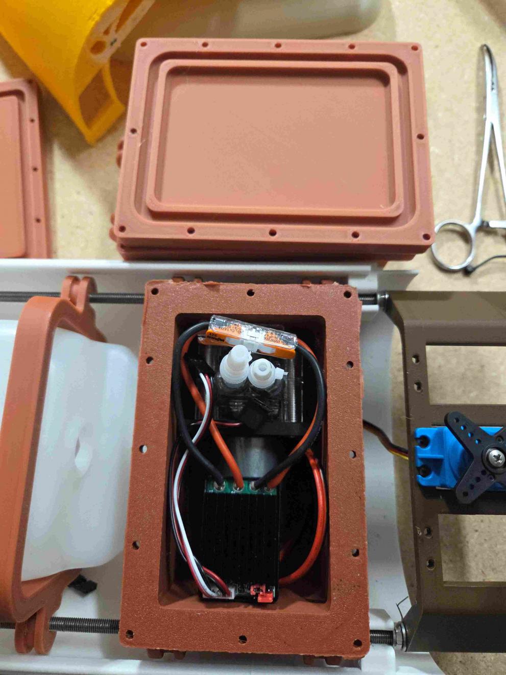

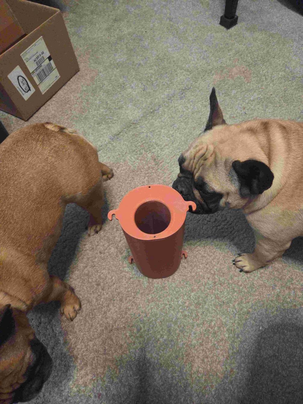

              My pump module in final stage of completion, fits like a glove, just need to pass wires and tubing.

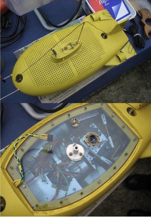

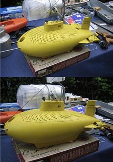

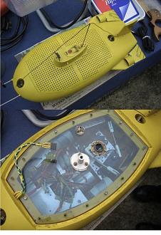

                    Uncanny resemblance
Name:	Screenshot_20260216_123125_Adobe Acrobat.jpg
ID:	193701 Click image for larger version
Name:	Screenshot_20260216_122938_Adobe Acrobat.jpg
ID:	193702 Click image for larger version
Name:	Screenshot_20260216_123006_Adobe Acrobat.jpg

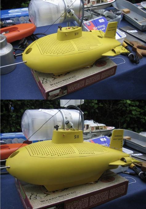

                      That is Colin Gross's model of Deep Quest, although he named it Ross Winan's

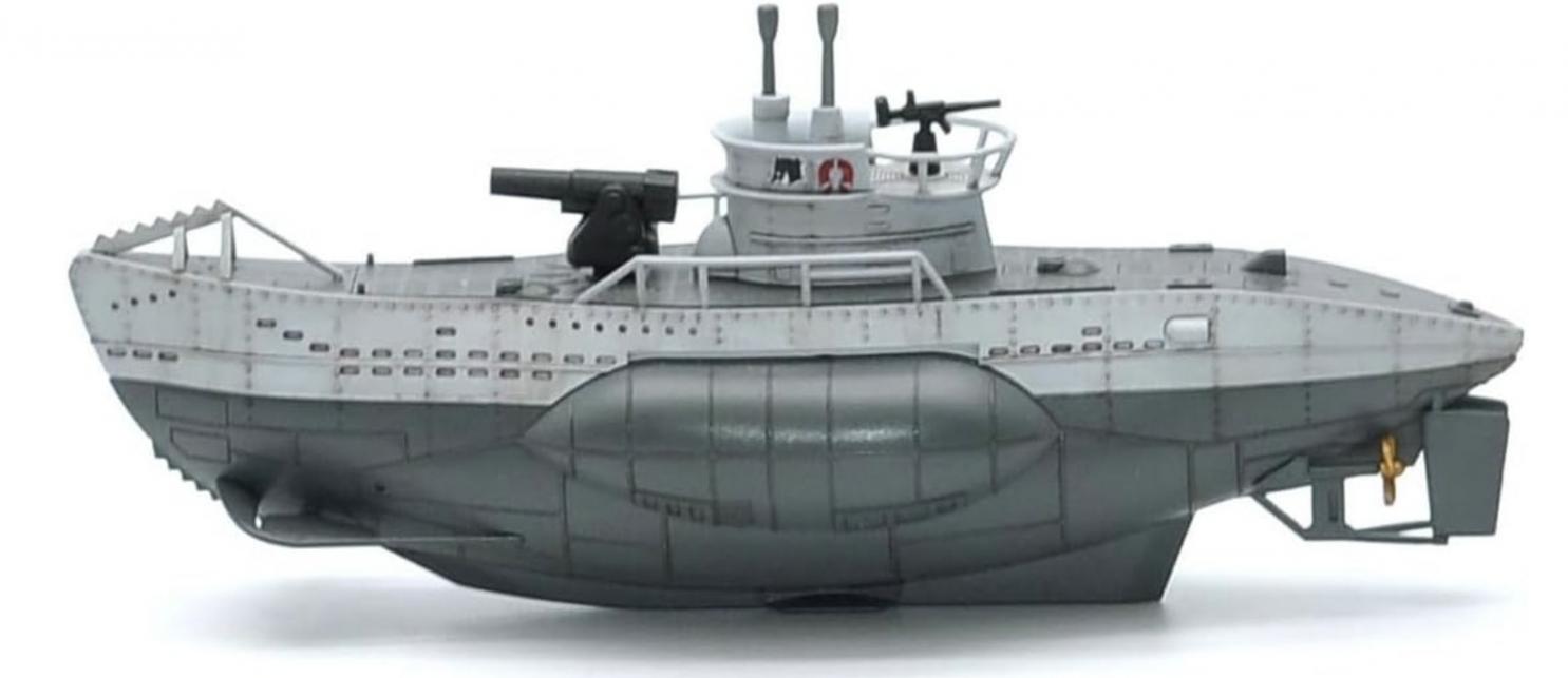

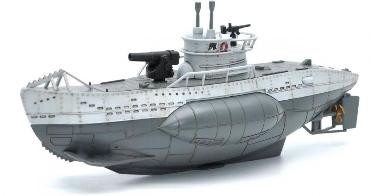

                        Loving this project! I have plans to do the same, but with a Type VII to make it more cartooney. Maybe put a cartoon crew aboard, lights, et all...
                          [QUOTE=RCSubGuy;n193750]Loving this project! I have plans to do the same, but with a Type VII to make it more cartooney. Maybe put a cartoon crew aboard, lights, et all...
                          [/QUOTE.............

                            That's what inspired me! I have one sitting here on my desk.

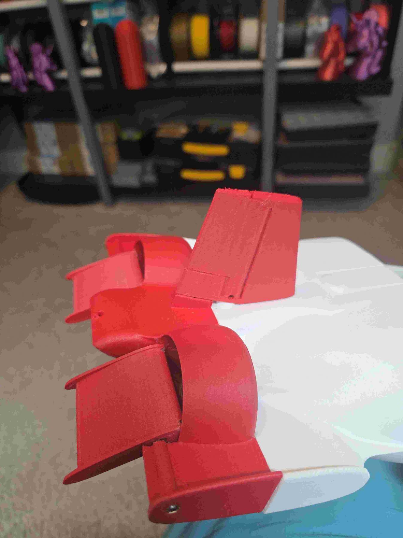

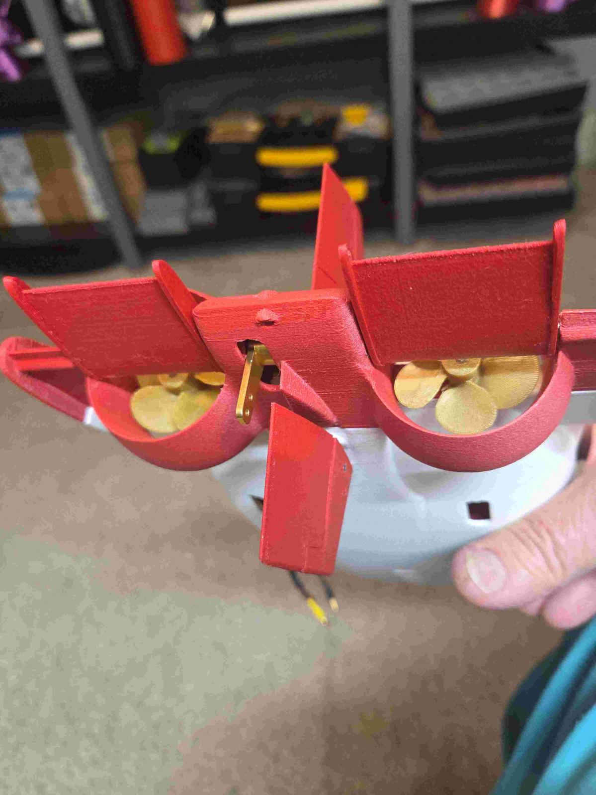

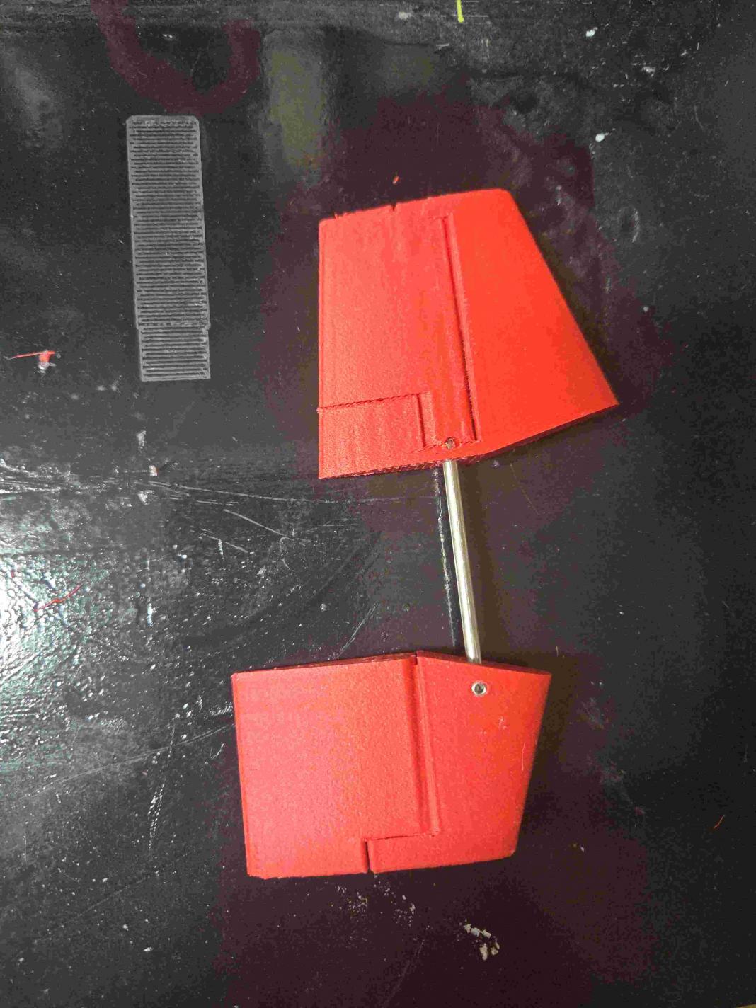

                              Finishing up stern, rudders and planes. I combined the two parts of the upper and lower rudders so they are now one piece each and attached to a common rudder post. Stern planes lengthened to 150%. Also installed set screws to all planes and rudders. Finally got a radio and sorted things out so I can start connecting moving parts and testing.

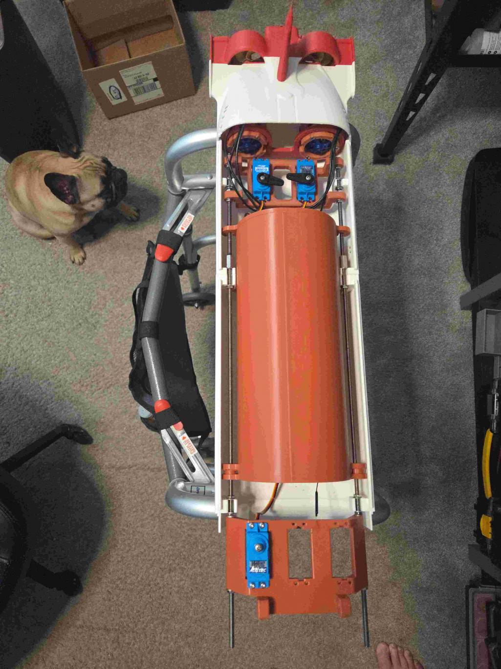

                                Project moving along, I decided my modular process didn't leave enough space for components. I went back to my original plan to print a tubular design, the center tube is dry for electronics and battery. I plan on using epoxy to seal the tank from the inside. Filled ballast section - 36 oz. water.
                                My SubSafe inspectors at work.
                                I am working the project from the outside - in and acquiring needed components as I go so process is slow. Just got battery and FrySky receiver, able to connect RC and test, so far working great.
                                Edit: The threaded rods are great, allows for easy modifications and changes. I still haven't glued the hull sections together just the bulkhead for the motor mount is glued in place. If the hull was longer the motors could be mounted on the same section as the aft servos.
