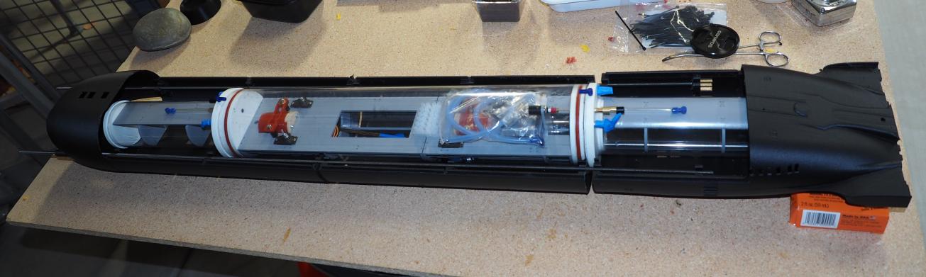

    Needed buoyancy, got some foam from Home Depot started to cut and hack some shapes - what a mess so I decided to print some blocks. Still experimenting, ordered some sealer to coat shells and hopefully prevent leakage.

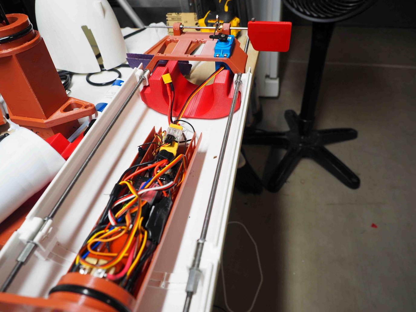

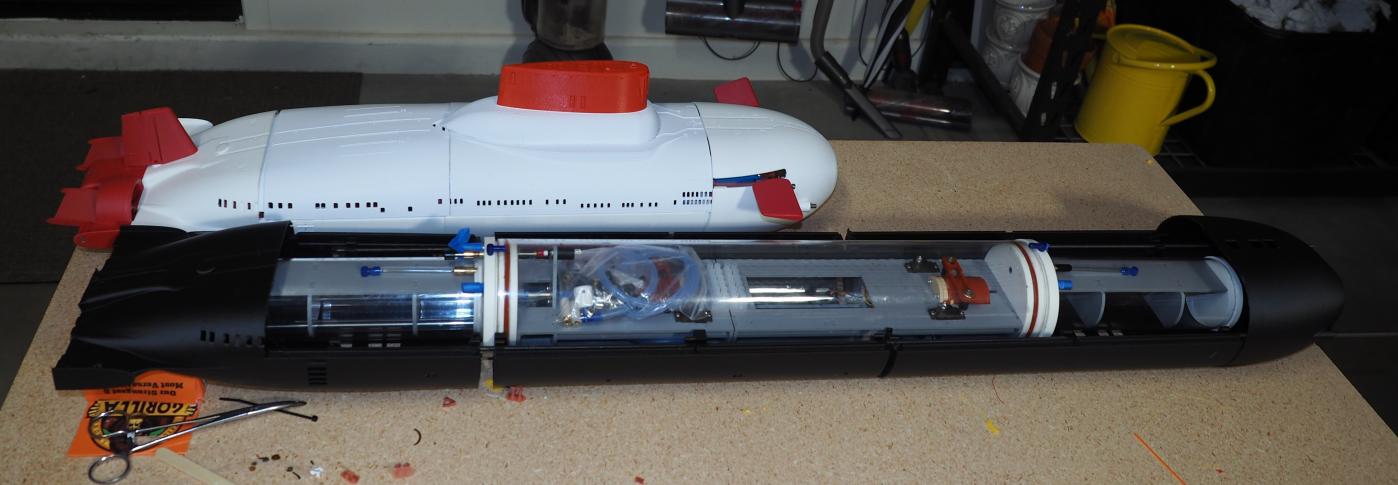

            Something new growing from my printer. Pretty much sticking to original STL's, I am installing threaded joining rods, and putting motors in the wet side of the stern, everything else will be in the cylinder which I need to shorten about 4 inches.
            If interested I will post progress in a new feed.

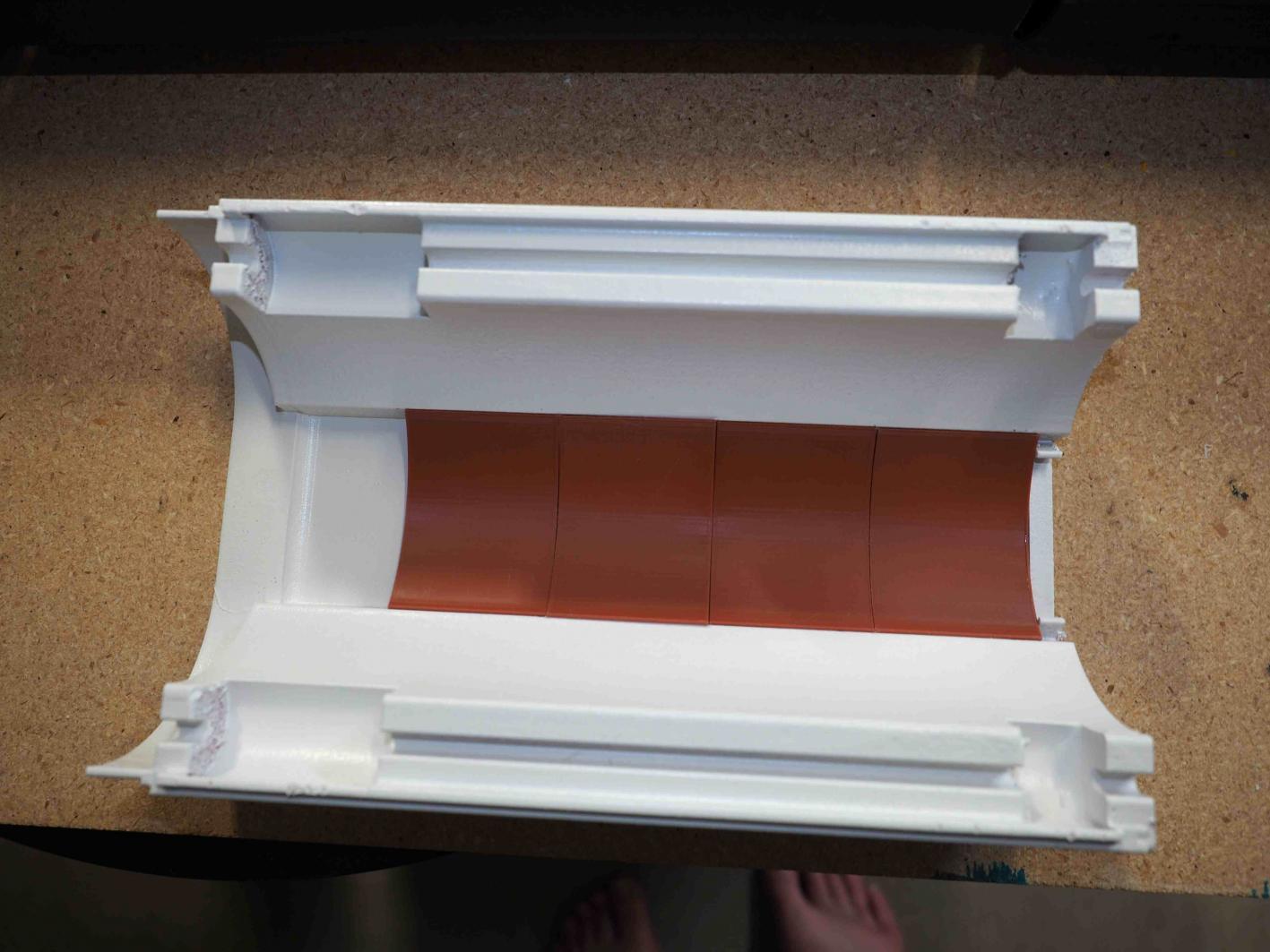

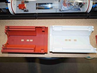

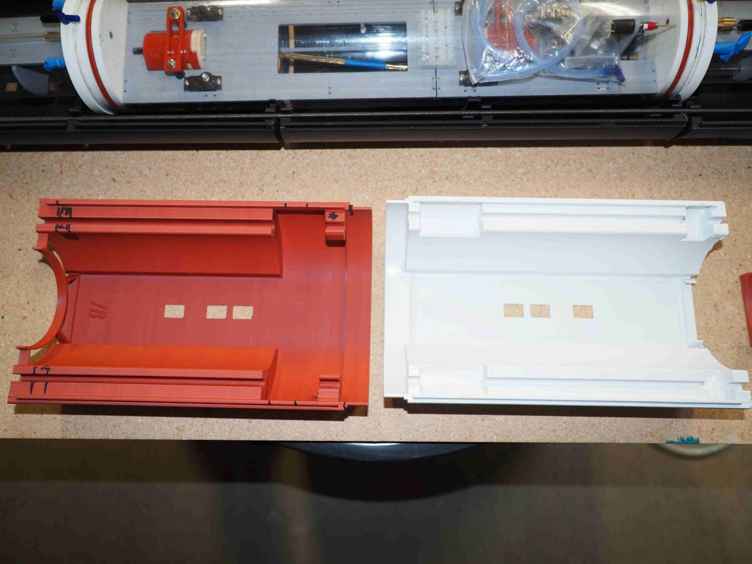

              Center hull section, left as printed. Right coated with white Seal Flex, great results, no way to test but looks promising since boayancy tanks are static.

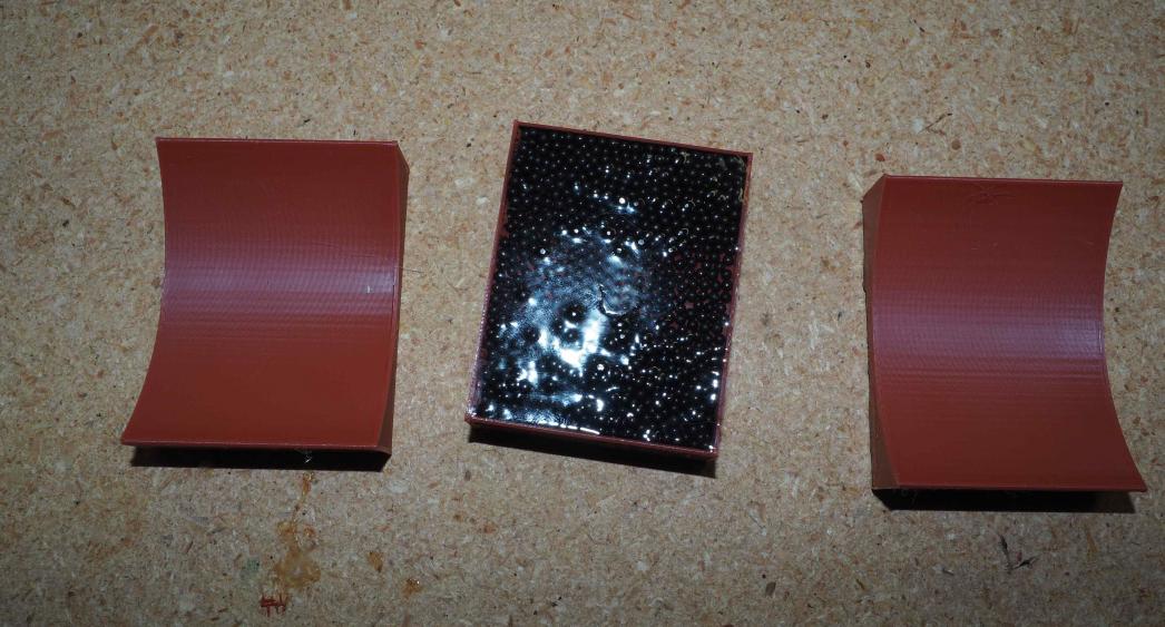

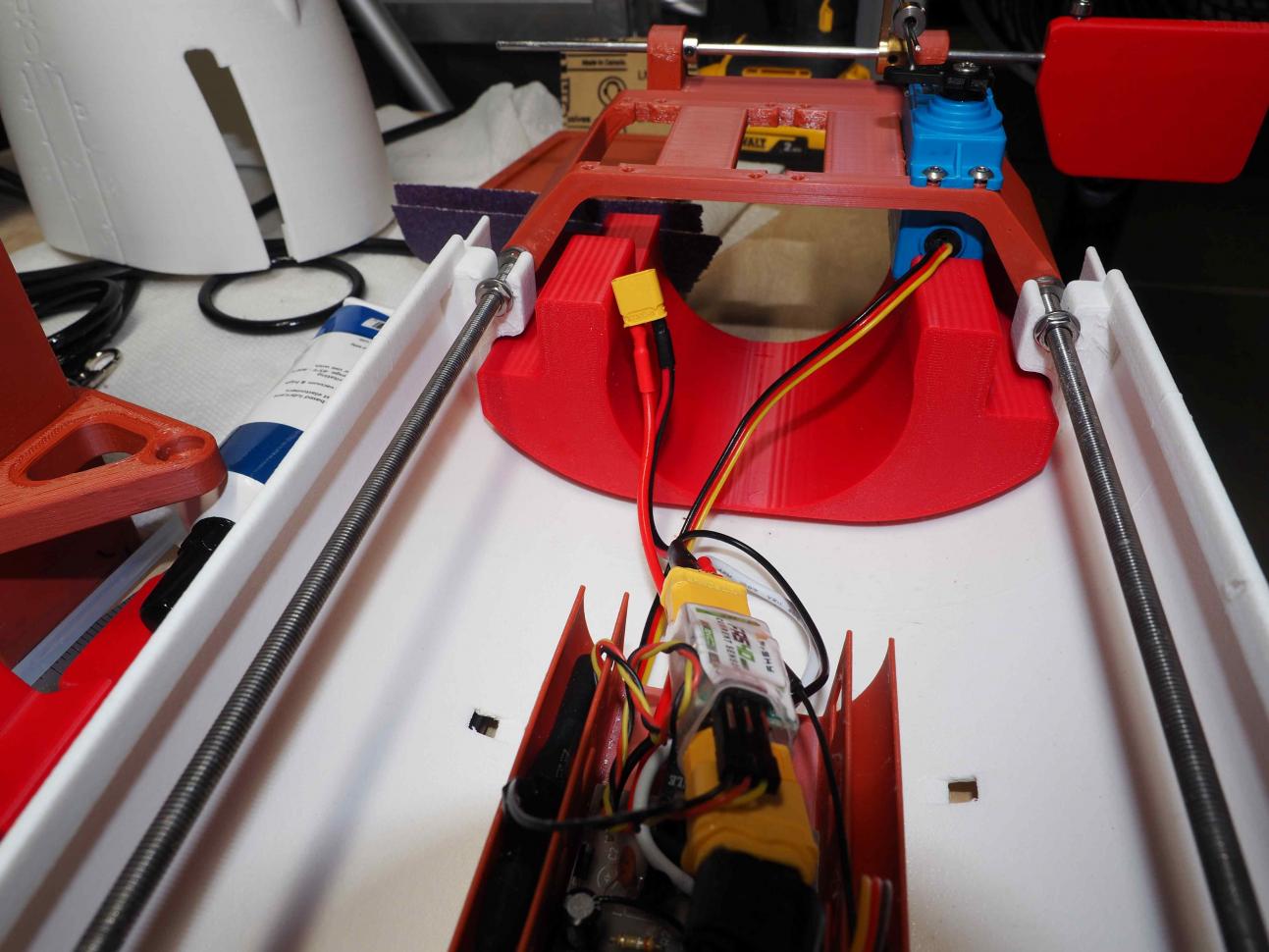

                Printed ballast shells filled with lead shot and resin and installed in hull.

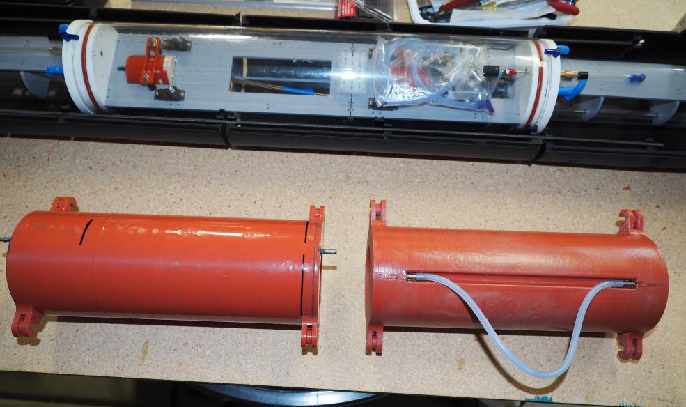

                  I redesigned the ballast tank. the center section for the dry components was oversized and the O-Rings were not tight enough to seal. I had the air vents coming out of the ends making it difficult to rout the tubing. Now recessed in center/top of tank. Tubing installed while leak testing. Also printed entire tank in one print, it was a two piece design with a separate end cap that was glued in place
                  Yes it does leak, sprayed with magic clear Flex Seal and works as promised, almost not visible, just a little hazy from over application. Takes several coats to seal but looks presentable.
                  At this point I am doing trim tests and liking results. 3D printing from scratch is pretty difficult but I like to design and print - and things just evolve during the process. The 3D printed ballast tank is great for a small application but I would use clear tubing on anything larger - just print endcaps. Maybe change this one to clear tubing if I could find a source.
                  Also 3D printed weight shells and buoyancy tanks are great if you have a way to create the files and custom fit them. Buoyancy tanks do need a seal coat, created in CAD as a solid, I print them with 3 outer layers, 4 to 5 top and bottom layers with 5 to 10% infill using Orca Slicer to make adjustments. They come out very light weight and easy to resize in Orca Slicer.

                    #54
                    Short, sport Typhoon next to standard size for scale. Click image for larger version
