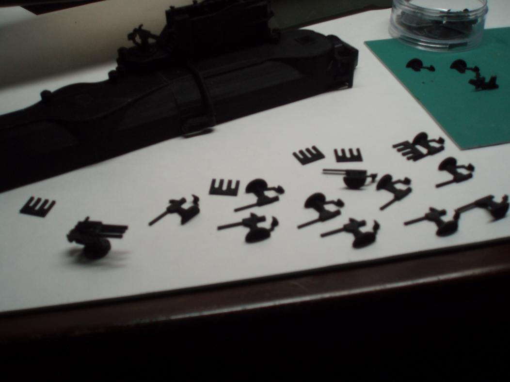

    Well I got the supports off, but one of the gun sights broke off. I going to need to thicken the bar that holds the sights. Everything else seem to have come out fine. I-400 AA gun. I also still want to add a little bit more detail to the rear of the guns.​

    Since the sights are most likely adjustable or removable you might want to shorten them closer to the horizontal holder. Picture from WEB.

      Yea there a lot of versions of the AA gun, land, train,ship, and sub. Sad part one sub had different versions from its sister sub.

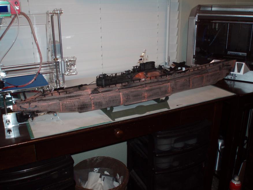

            I wish I would have hat a resin printer when I built my I-400!
Name:	i-401 deck guns 2.jpg
ID:	173716 Click image for larger version
Name:	i-401 fimished 3.jpg
            All 3D printed with PLA on my 3D40 Dremel.

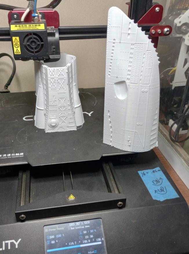

              I have a model of a type VII C on my Creality cr10s now.
                Originally posted by Wizzard033
                Nice! It looks great.
                    Can’t help but notice that there’s seems to be some gaps between the hull walls, what infill % are you printing with? You should be printing at 100% infill to avoid water seeping into the air gaps.
                    • Wizzard033
                      • Sep 2023
                      • 41
                      Actually 0% infill. I plan to dissect the hull and fiberglass the interior with 2oz cloth. Also I will open all the scuppers and such from the backside.
