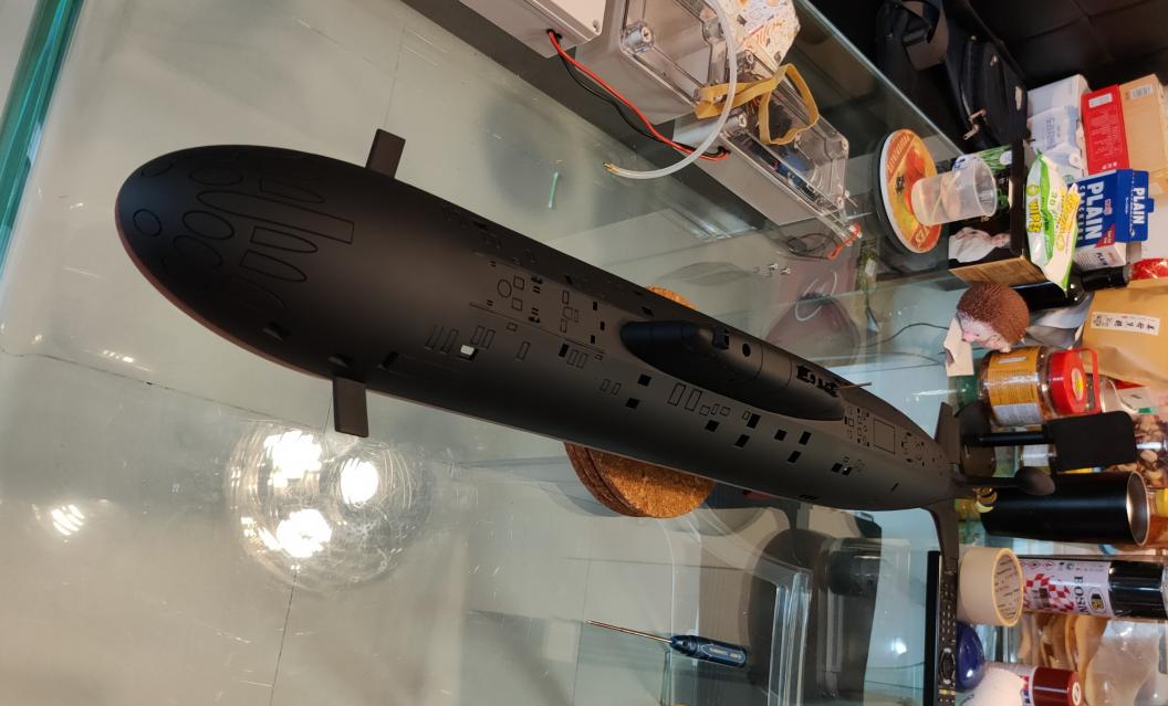

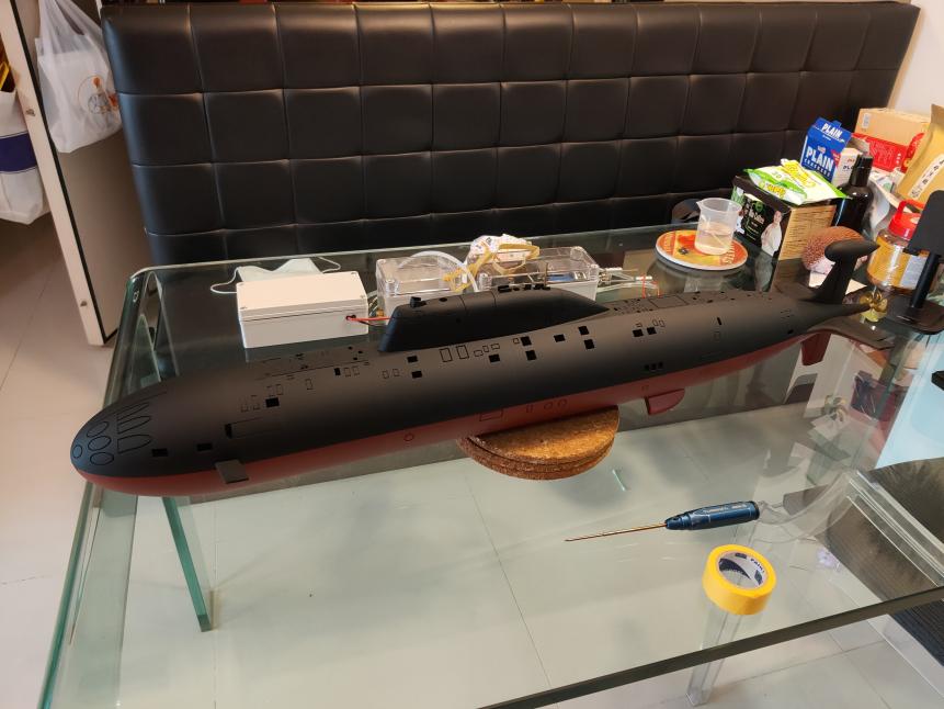

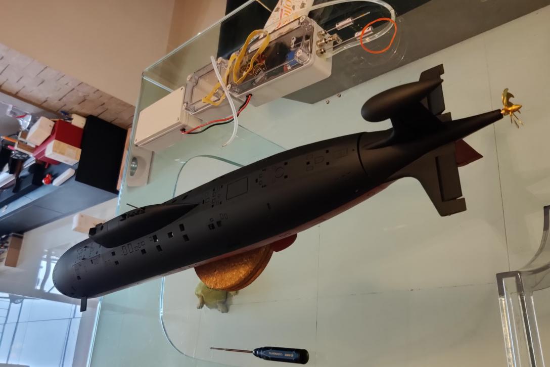

      To the paint shop today. Using Tamiya Hull Red and Flat Black.
      Click image for larger version Name:	IMG20220507141033.jpg Views:	0 Size:	62.7 KB ID:	161543
      Click image for larger version Name:	IMG_20220507_141413.jpg Views:	0 Size:	78.2 KB ID:	161544
      Click image for larger version Name:	IMG_20220507_141439.jpg Views:	0 Size:	65.3 KB ID:	161545

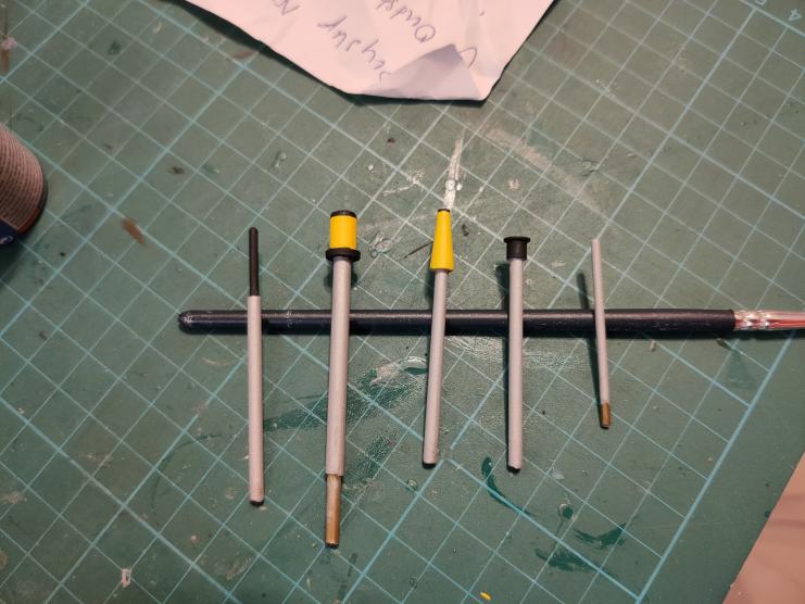

      Painting masts...
      Secondly, I probably have addressed the main engine compartment leaks problem. As expected, the gland nut moved anitclockwise when the drive shaft is turning in same direction. Will apply some locktite and hoped no more leaking occurs doing further tests.
      miloo123,
      That is one nice looking boat! Your flat finish and color scheme looks great! Well done in my opinion!
