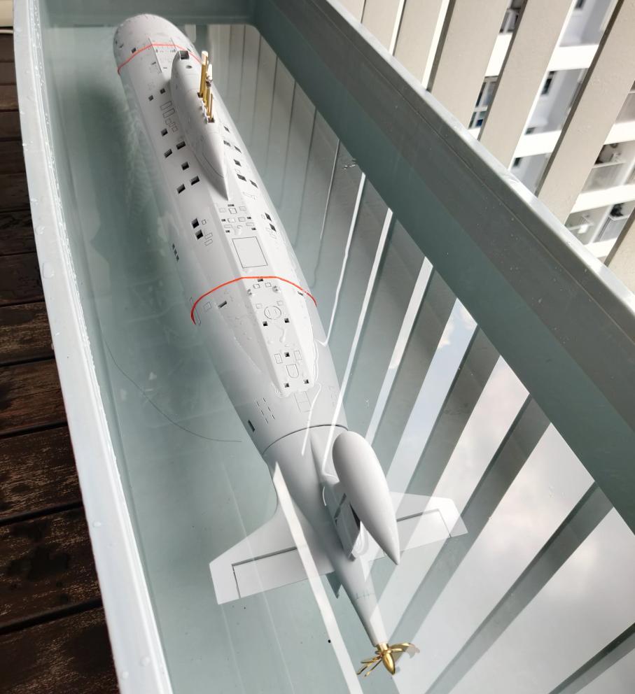

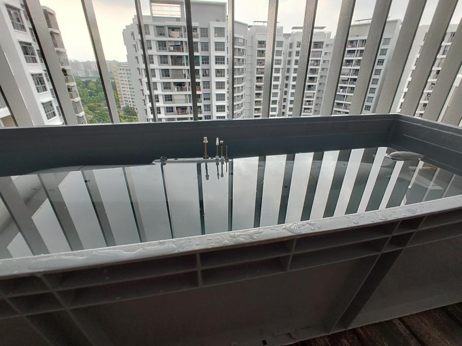

                        #41

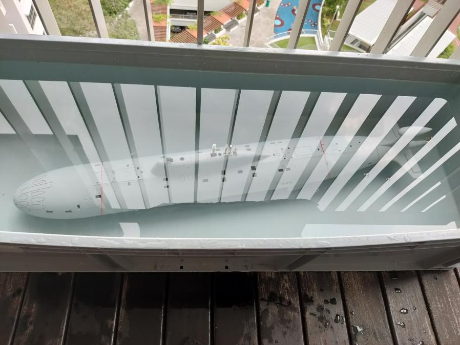

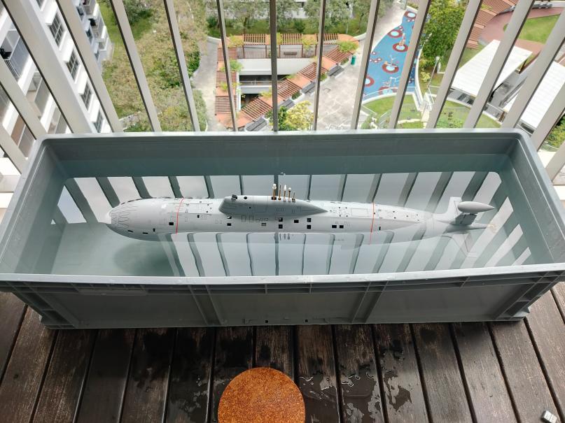

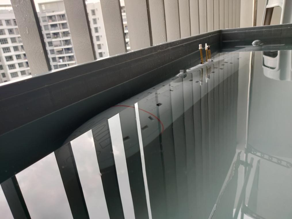

                        Re-posting...
                        Done some tests with my mini water pool...
                        Periscope depth. Not perfect due to ballast tank not centralized located and bow will pitched down when adding more ballast. Tried add flotation foam at bow but ballast capacity limited to bring lower depths unless add more ballast weight to lowered waterline much more when surfaces... Any tips?

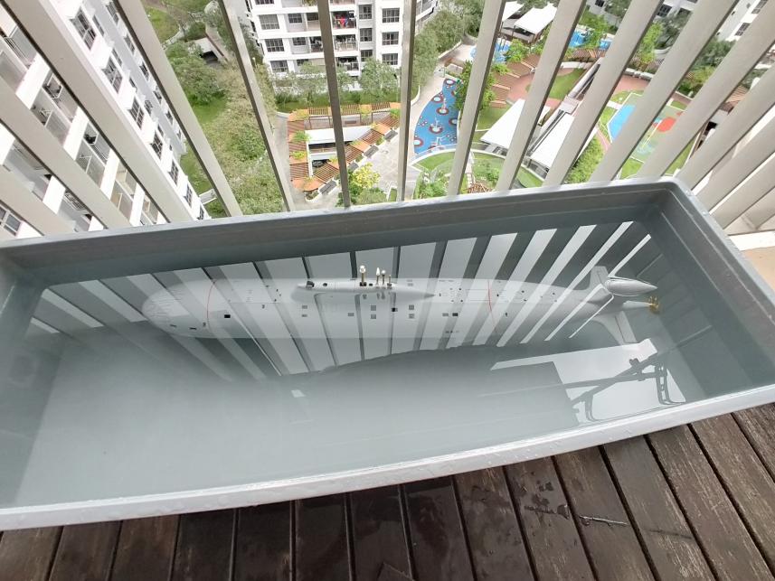

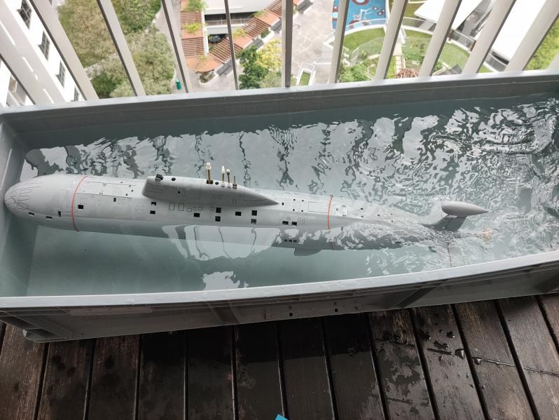

                        Full dive...

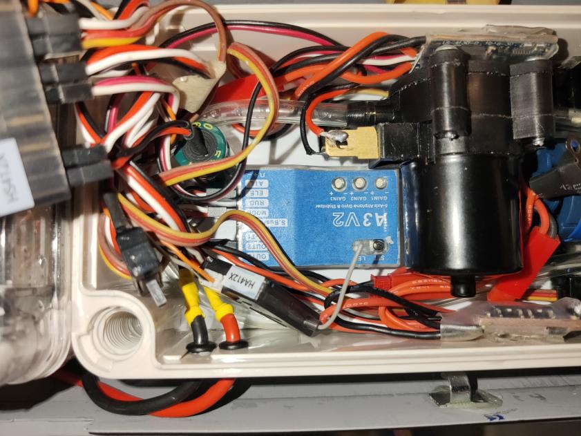

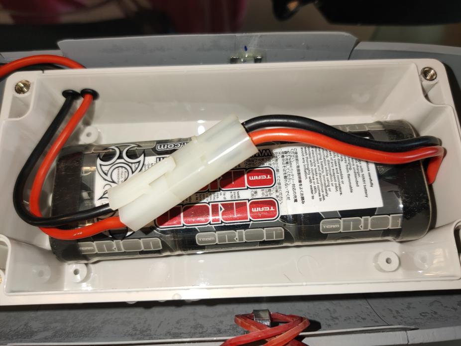

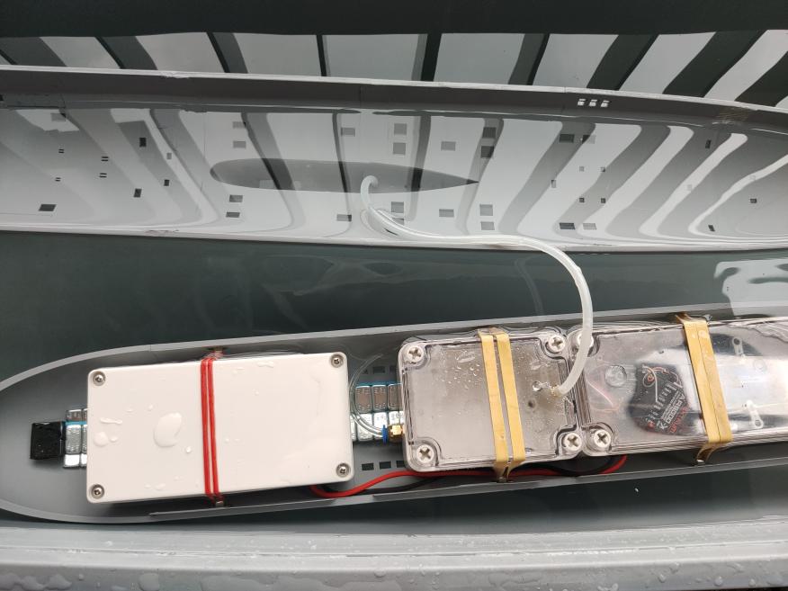

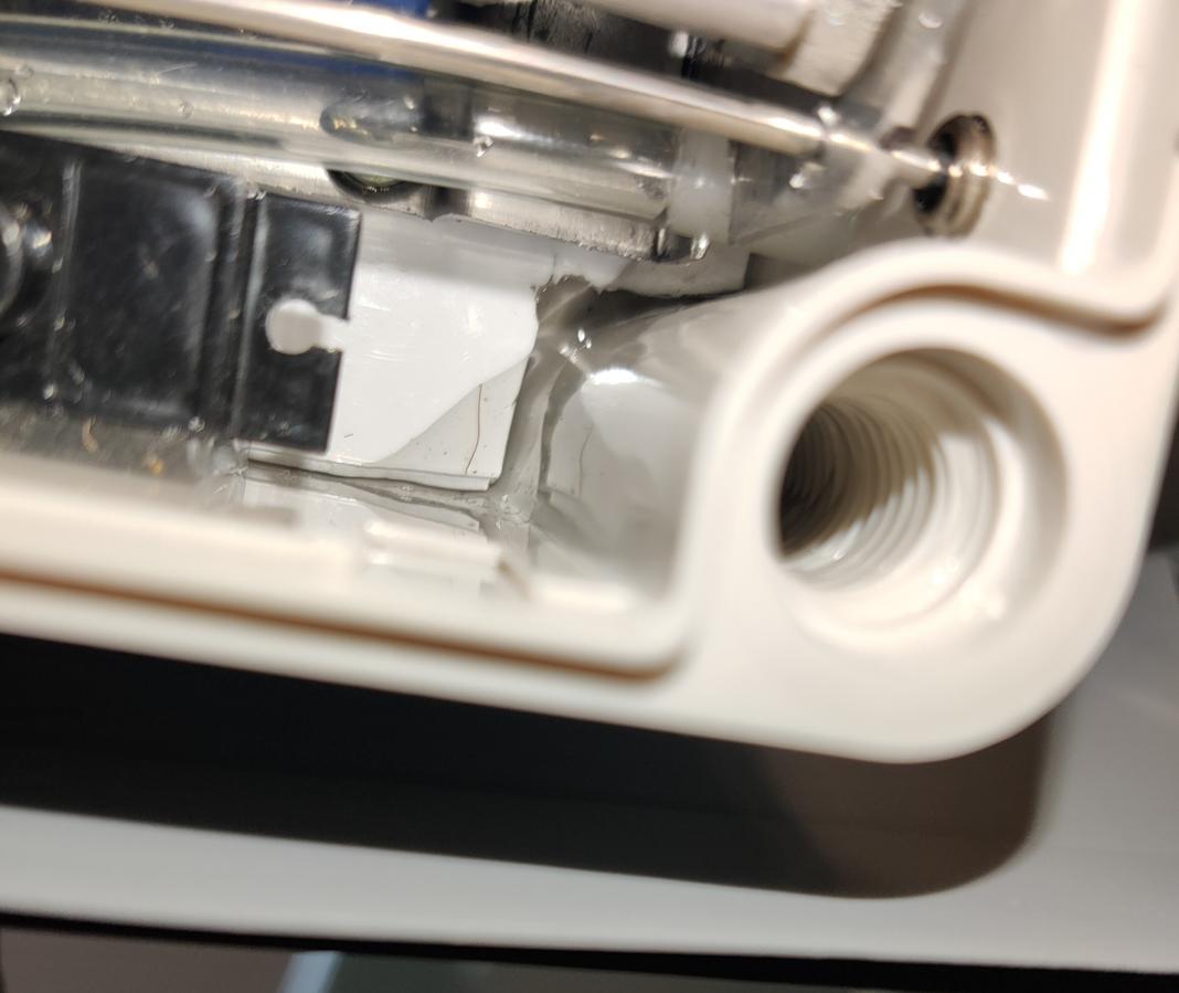

                        End of trimming test, next checking water leaks on WTC.
                        Tests results shows battery compartment is bone dry. The main engine/pump room has slight water ingress. Highly suspect from the gland nut seal of main shaft as no signs of water on the lid seal surrounding area of the transparent cover. Need to further address the seal leaks to minimum.

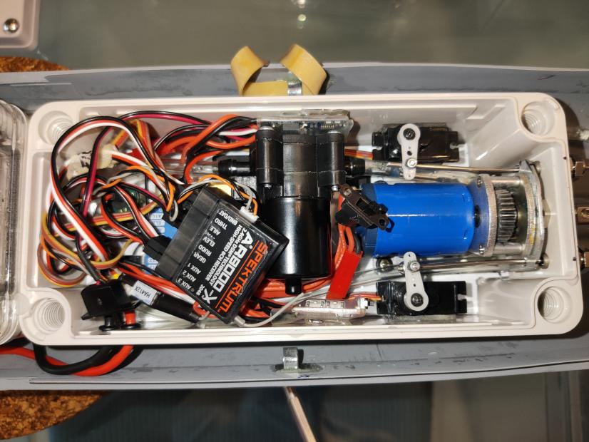

                        Airplane gyro for the level planes and it functions as it is. Also shown the 12V auto windshield pump running on just 7.2V battery pack.

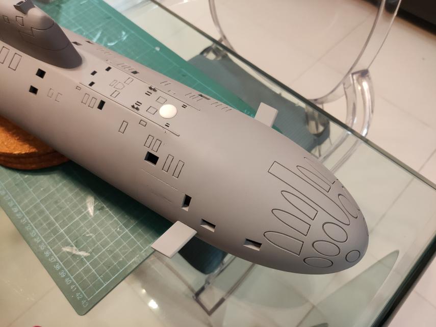

                                Added non functional bow planes. Also found a wooden cabinet hole plug which is perfect size for the rescue buoy raft!
                                Next will be final finishing black/red paint scheme.
