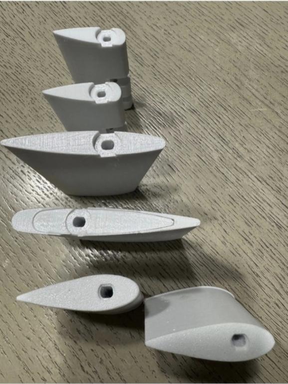

    The builder has essentially given up, saying it a "disappointment" and "discouraging" because vendors don't stock "oblong shafts" to match his 3D print.
    Click image for larger version  Name:	Screenshot_20260404_091558_Google.jpg Views:	1 Size:	70.3 KB ID:	194377
    a perfect example of a "CAD-induced" crisis. He designed a hole (or used a file) that assumes a specific, non-standard geometry, and now he's treating a simple mechanical interface like it's a proprietary aerospace component.
    This is pretty much a DIY hobby, if the part doesn't exist, you make the part—or better yet, you don't design a hole that requires a unicorn to fill it.
    He did the 90% that requires high-tech hardware and software, then got "stupefied" by the 10% that requires a hammer and a file.

    Off the shelf fix that doesn't require machining or additional work would be to use K&S brass stock.
    Find a square brass rod or tube of the correct width that fits into the oblong 3D-printed hole perfectly. The flat sides of the square provide a massive mechanical lock against the flat internal walls of the print. No slipping, no "oblong" magic required. The gaps on the sides provide space for RTV or epoxy.

        A bit of basic work with some free software like Fusion 360 and you can have whatever shape and size of orifice he likes in those hydroplanes. Alternatively, a bit of basic benchwork with a file to whittle away at some round stock.

            Yes, I found it inappropriate for the 3D designer (rcsubs.cz) to complain to the whole world about such a trivial matter.
            I even replied with an obvious solution, which must not have been to his liking since he didn't react at all.
            A file, a brass rod, and the problem was solved...
            On a group frequented by experts and artists in the RC submarine community who all share their work (i.e.solutions), it's pathetic.
              Maybe I'm missing something, but I'd just drill the hole out round.
