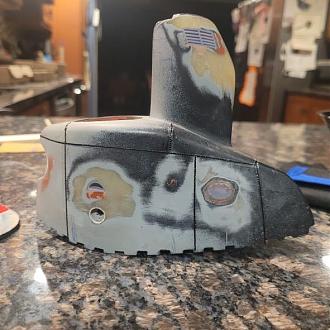

    Getting an accurate depiction of these common features is problematic, at best!! Could some of you more accomplished modelers share your methodologies here in Tips'N Tricks. We great and unwashed masses would much appreciate that! Thank you!!

    You talk'n about the openings in the sides of the superstructure acting as foot and hand holes?
        Indeed he is Dave. We have had this conversation several times. My filing game is ok, but I can stand to learn some more.

            Nice! That's why your the best Dave.
            I took a slightly different approach on the Kaiyru tho. Theough my research if found that those ateps were acrually closed on the backside. I 3D modeled them and yes I printed them, then did the same as you demonstrated above.

              Penetrations, weld lines, access plates, and even overall geometry of these boats was as varied as the sub-contractors and yards that horridly slapped these things together in anticipation of the eventual amphibious landings that were to befall the Home Islands. Two eggs put all that to rest.

                Yes, the semi-circular holes! The bar type thingies are more correctly known as "grab irons". I see you teasing me with the master hull for the Foxtrot! You *******!!!! Currently working on her sail. That's where I want to replicate those steps. I do use the drill hole, insert half-round plastic rod, glue trim, fill, sand, repeat on the larger scale hulls. The cast resin sail isn't as easy as one would think it to be, due to thickness and the rough inside of the sail half. I'll get 'er though!!!!!! BTW, know where I can get an anchor for her? There was a missing sprue tree and some other stuff not included when this beast was purchased, way back when.
                Thank you, David, just what I was hoping for!
                  True. That's what makes these nice to model. It's your choice, nothing within reason is wrong

                    Tooling on the 1/72 FOXTROT was never completed, Bill. But all masters and what tools I did make are in Bob's hands. What I was working on was my GRP hull, not the master, I assume Bob got them when Mike Caswell turned the business over to him -- but I'm not sure of that. Check with Bob.
