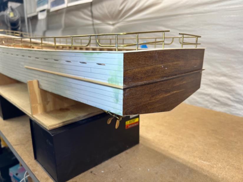

      A few fast updates
      The aft rub rails are epoxied in place.
      Click image for larger version  Name:	IMG_0043.jpg Views:	0 Size:	54.5 KB ID:	175268
      The upper deck rails are soldered up. The rails are 3/32" brass tubing and each joint is pinned with a 1/16" brass rod.
      Click image for larger version  Name:	IMG_0044.jpg Views:	0 Size:	58.2 KB ID:	175270

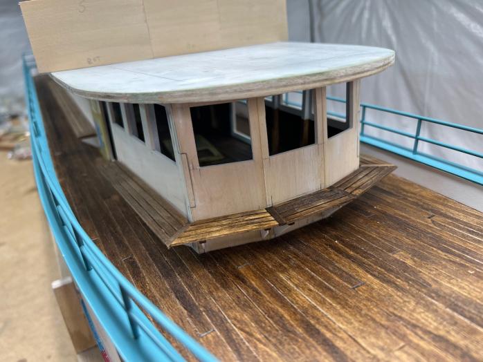

          I have no detail pictures around the deck so I have to guess what things look like or how they operate. The cabin doors appear to be on slides and not open like a traditional door. Since they don't make brass channel the size I need it I had to make my own. I took a pieces of square stock and removed one side with an abrasive disk and cleaned it up with a file. I needed short smaller sections to fit on the top and bottom of each door and longer next size up sections to act as the section the doors slide in. Determination.
          Click image for larger version  Name:	IMG_1375.jpg Views:	0 Size:	52.5 KB ID:	175274
          The doors are nice thin GRP. Each door will get a section of acrylic for the window. Here you can see the smaller brass sections slipped onto the doors.
          Click image for larger version  Name:	IMG_1515.jpg Views:	0 Size:	58.4 KB ID:	175275
          These are the parts that will be mounted to the cabin which the doors will slide in. The bottom section will be glued to the cabin sides. I soldered studs onto the bottom ones to help give those a more solid way to adhere with the glue. So that I have a way to insert the doors after everything is painted and to service them should they ever need servicing the top one have 080 size studs soldered on them which a nut will hold them in place hidden in the cabin. I just cut the head off of the 080 machine screw then solder it to the channel. Get the jist of that?
          Click image for larger version  Name:	IMG_1521.jpg Views:	0 Size:	56.6 KB ID:	175276

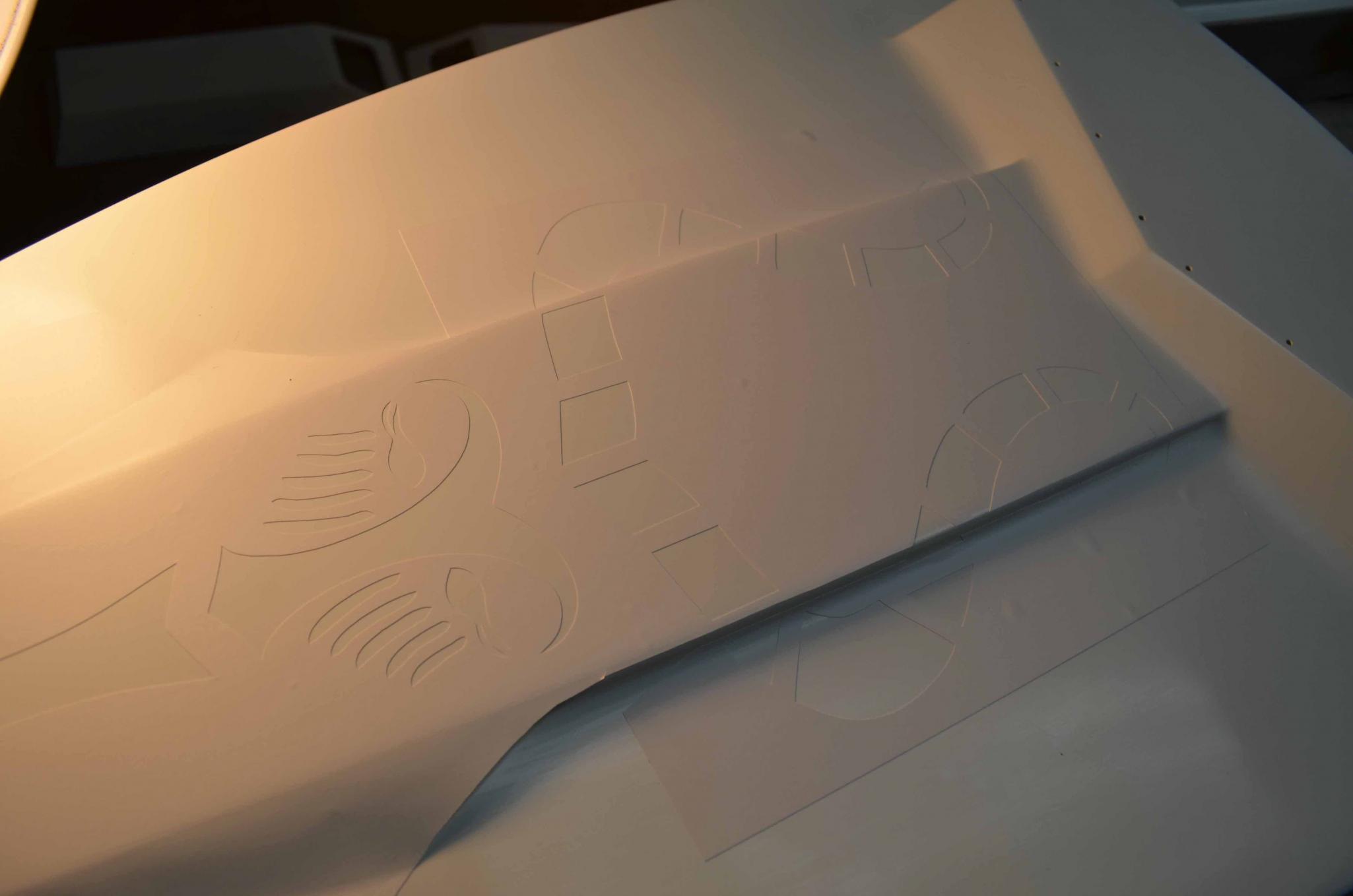

                      The graphics templates were done by Callie Graphics. We had many emails between us to get the graphics to my satisfaction. For this template, you peel the backside, adhere it to the model, press and press to be sure of the adhesion, then peel the front side, mask around the template, spray, then remove the masking and template.
                      You can also see here the detail of the 'planking', nice job on the railing paint, the drip rail and the worn, used bollards.
                      Click image for larger version  Name:	IMG_2210.jpg Views:	0 Size:	55.2 KB ID:	175400

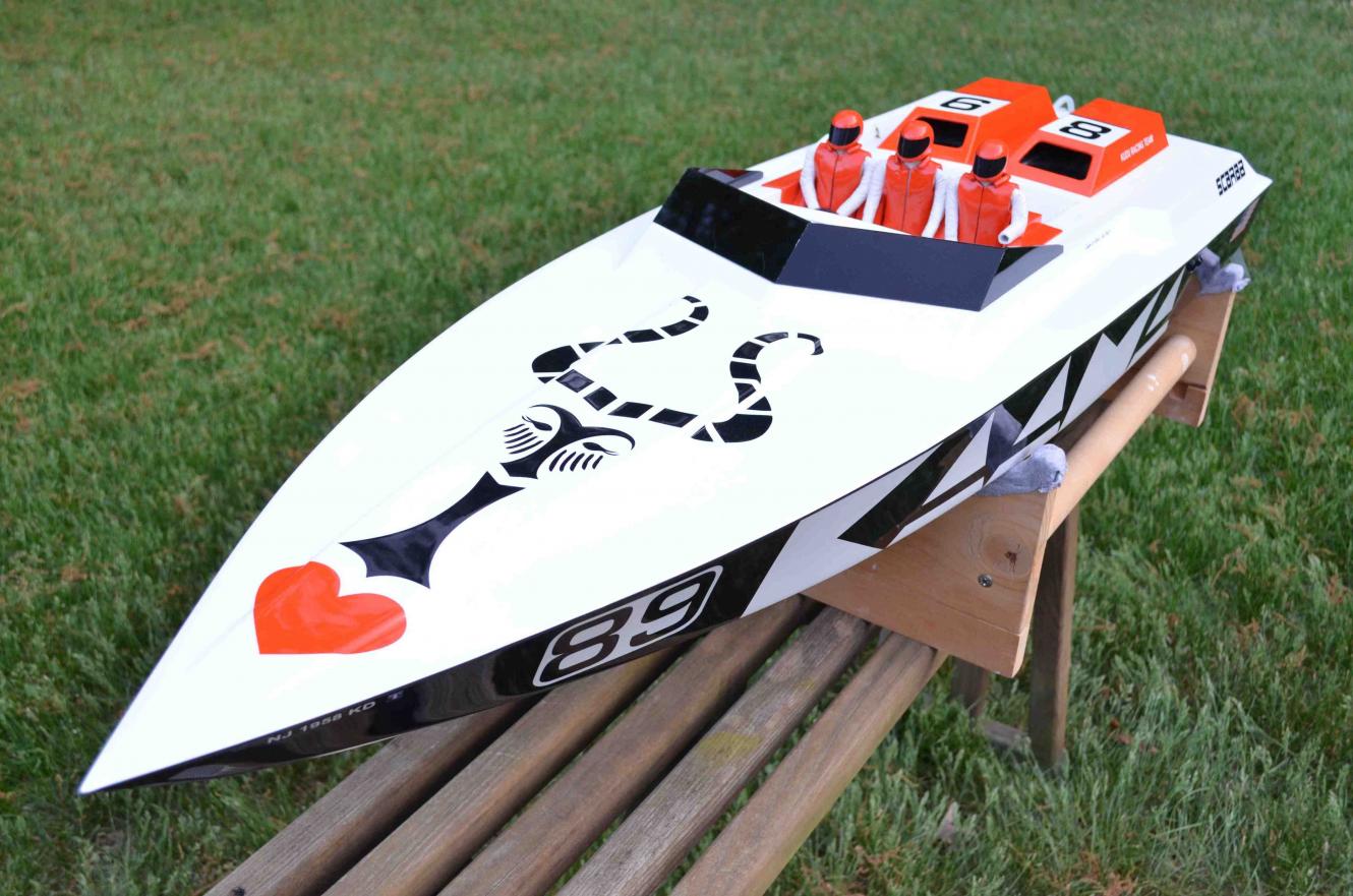

                            Originally posted by Bob Gato
                            Did you have you her cut extras in case you mess one up... I did with the boot stripes but I never asked her to do the extra logos I guess I'll be holding my breath on those...
                            The first set she sent me where back lettered decals, she knew I needed it as a stencil, minor oops. She resent a pair of them as stencil, I only asked for two. If I messed up figured I can ask for more.
                            I did this stencil thing before on the bow of KAAMA.
