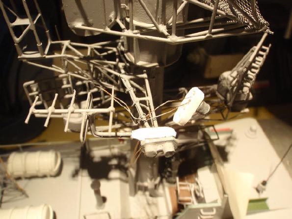

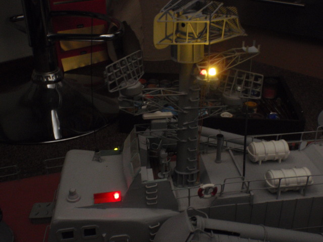

    I'll show you what went sour David, i replaced the mast, checked if the leds where in working order and made the wiring inside the upperstructure tidy, everything ready for again a victory of Manfredizing. Click image for larger version

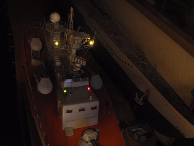

    Victory!!!!!, at last. Click image for larger version

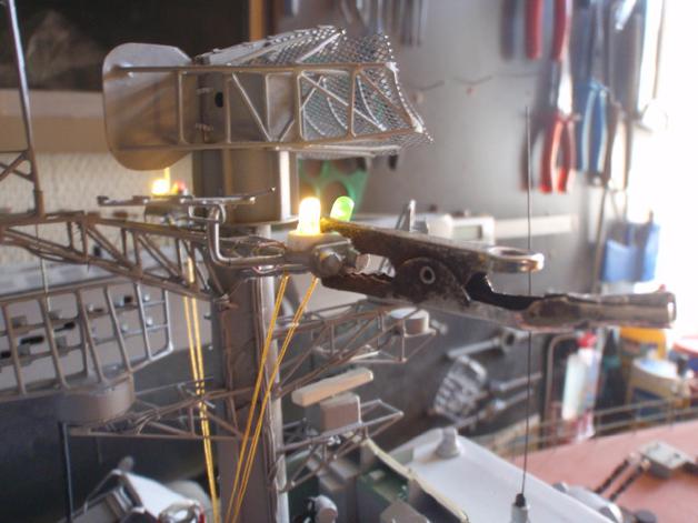

    F**K!!!!!, the white led was down, re-checked the wiring, nothing wrong, the led went dead. Click image for larger version

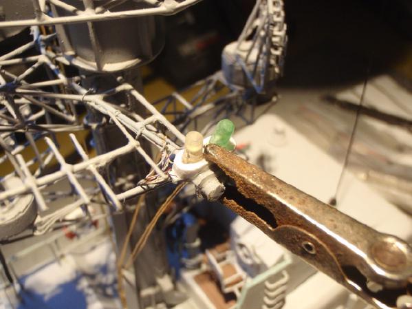

    It took me a few days before i got the gutts for breaking it open, luckely i used epoxy-glue and not styrene-glue. Click image for larger version
    Managed to get a new led inside, only drawback was, those wires where getting shorter, twice the connections on the led broke loose, and the story had to begin from the start, anybody says modelbuilding is a relaxt hobby has got a wire loose inside his own brains. Click image for larger version

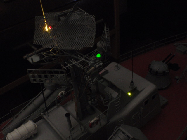

    And finally there was light, still had to rebuild the armature and do a paintshop. Click image for larger version
    Once you stated this was a boat of terror, yes she is, in this chase, for me!!!!, for now i have to wait for the spring, she will be covered in foil against the dust, also made a vid which i will download, be patient.
    PS, shortly after this picture the green nav-light on the upperstructure went dead, arghhhh, such pleasures of the hobby!!!!!

      Oh, man! You had to re-string that armature wire all the way down the mast, and into the hull. Ouch! Maybe you should increase the value of your current limiting resister(s)? Damned LED's are supposed to be good for 60 some years if run at the right current (how the egg-heads came up with number, I can't imagine).
      Looking good, pal.
        • 1651
        #78
        Restringing those wires into the mast?, hell no!!!, i got lazy, had a tolerance of about 10 mm in the cables, so one light has a nice loop and the other less loop, i usually use 3K resistors, they work fine, i guess by using the soldering-iron so close at a led's base it received too much heat, thus shortening the lifespan of my led.
