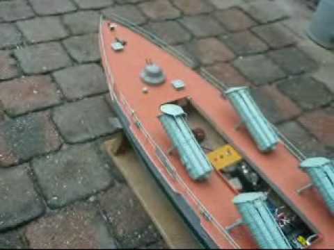

    Last video from the past, and some more work on the radarmast, also made a start with the radar itself,
    Rebuilded the launchtubes for giving me a better trajectory, still needed some tinkering on the hatch on one of the tubes.
    The last holder was a bit tricky due to the angles, needed three tries to ge me a symmetrical pair.

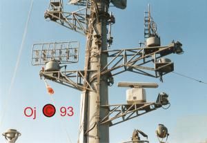

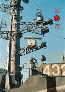

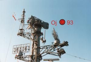

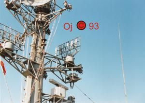

            Some pics of the real thing which i'm building now, it's a task, but i have good hope it will turn out nice,
            As you can see lot's of stuff to add, those rectangular radars look the same like my Fumo radar on the type VII, at least builded that once before, some modern radar and a gps system, you can also see those cable protectors at the beginning of the mast.
            That strange thing pointing up behind the big radar, no idea for it's function, looking at the construction it will give me some grey hairs and some burned fingers, you gotta love your hobby.
